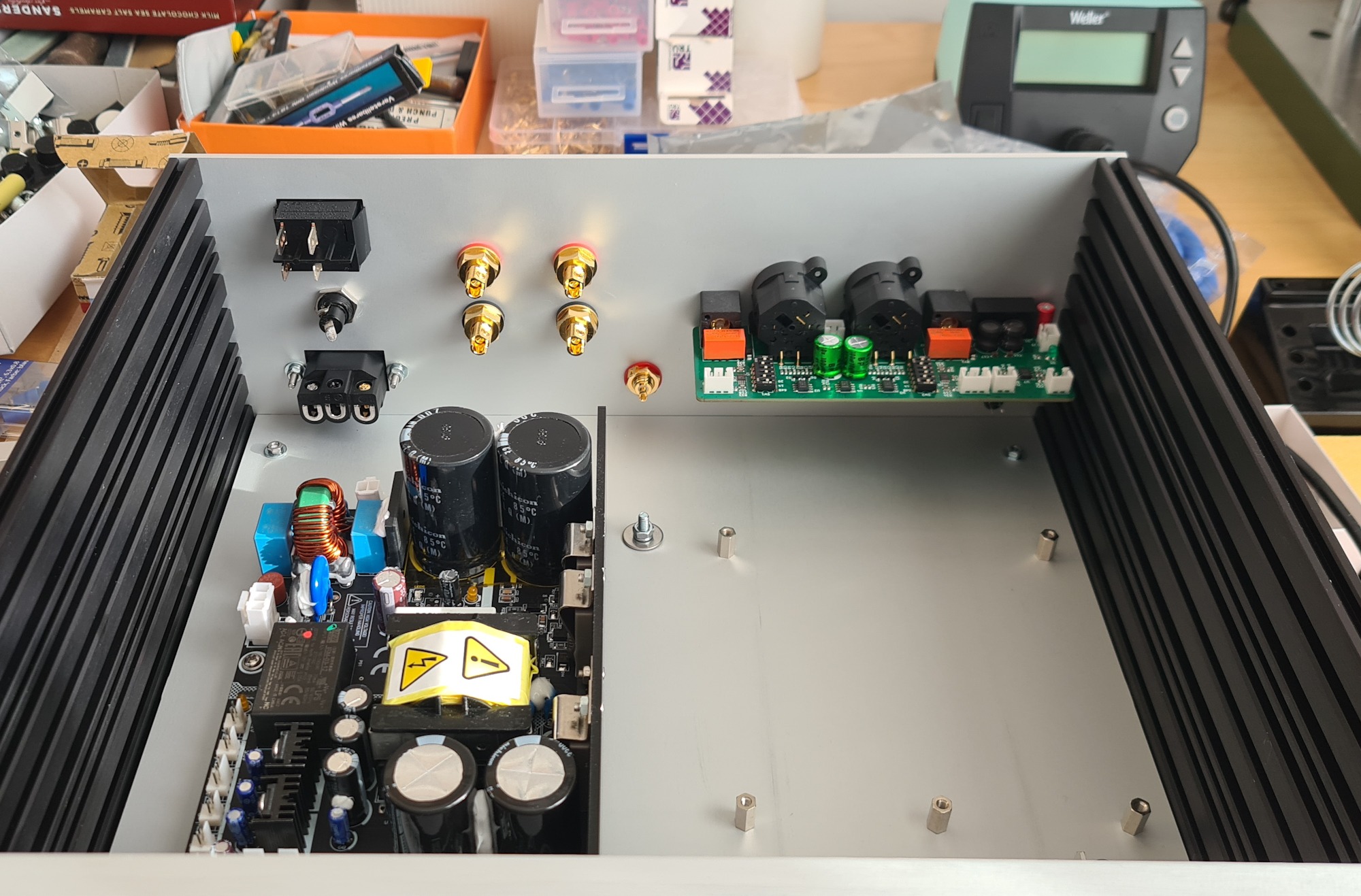

The first two parts of the chassis will arrive today (base and rear plate) so I can start with the assembly - I'm really looking for it
The other chassis parts will arrive next week, so I hope I can finish the amp soon (but it could also mean weeks, will see).

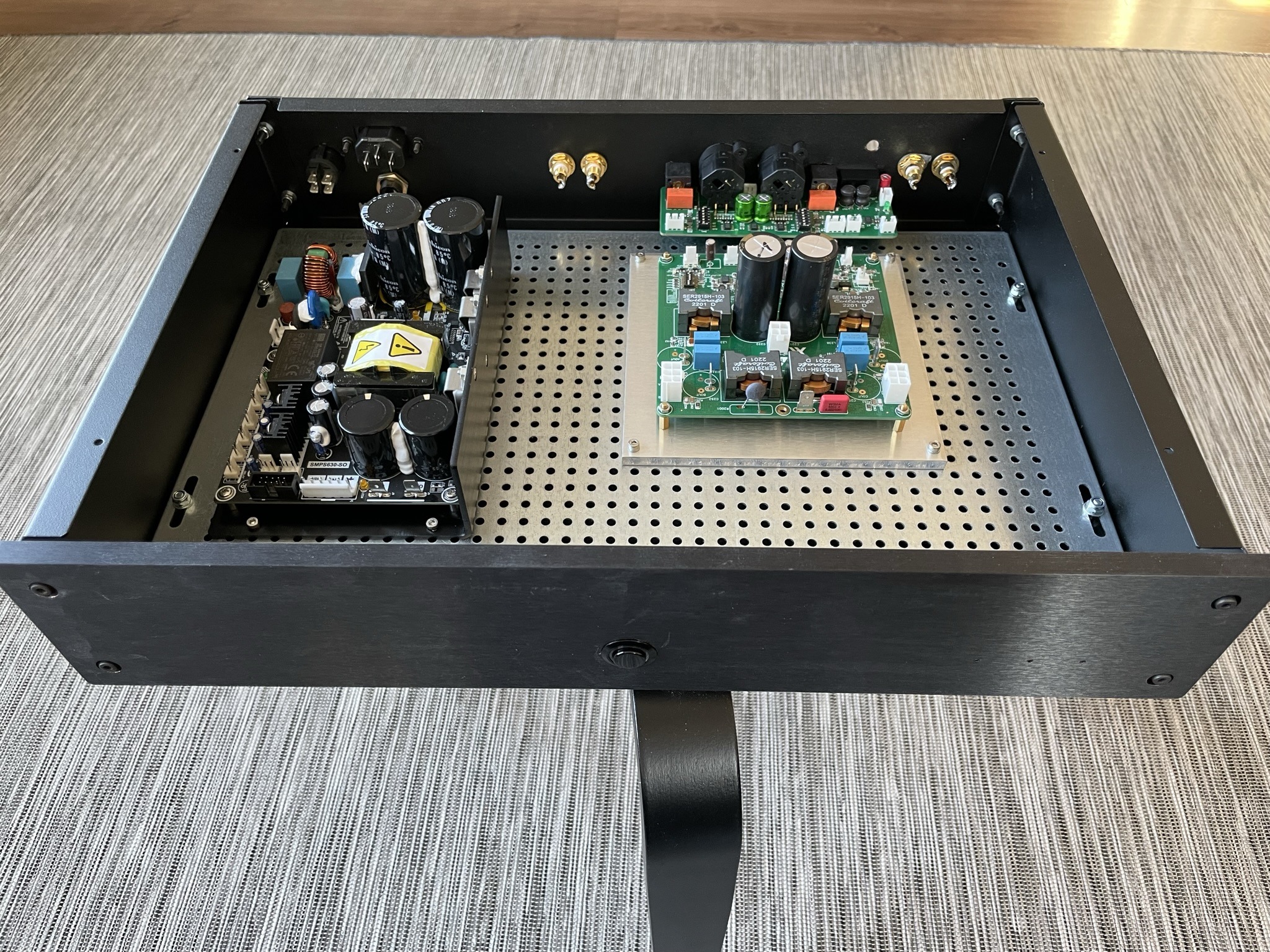

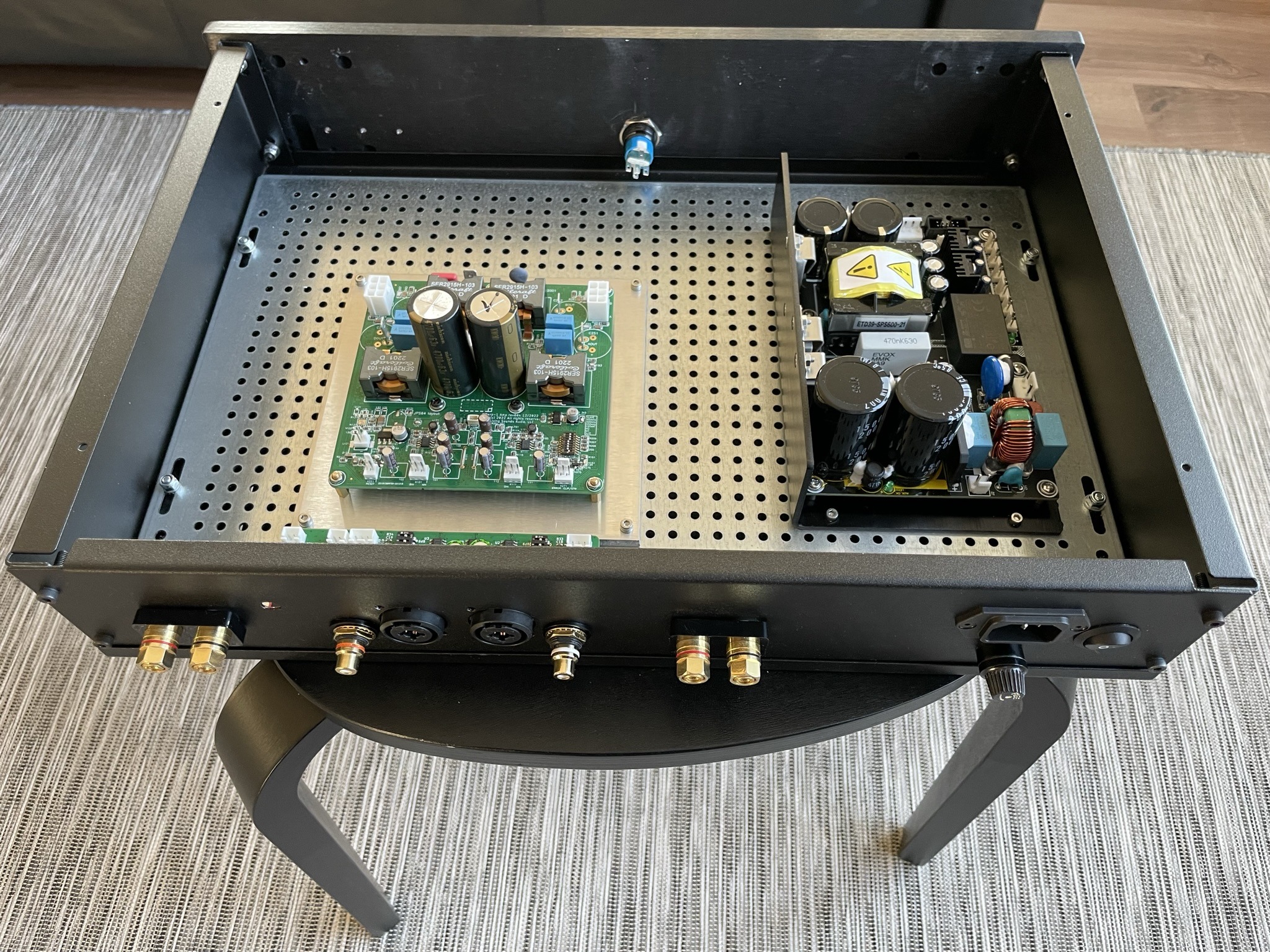

I purchased a Pesante 2U chassis and a friend helped me in drilling out the holes on the front and rear panels. Per X's recommendation, I mounted the amplifier on a 1/4 inch thick Aluminum sheet and bolted that down to the Pesante's base plate. Now that most of the mechanical work is complete, I have to wire up everything.
Yes, I think too that I will enjoy it glad to read you like it that much!@Plott, I think you really enjoy the sound of this amp. Can't wait to hear your impression and assessment. Next to my 'First One' amp I built a few years ago, this one is next to the top. X did a fine job with this amp.
The missing parts of the chassis (two-piece front plate, cover) will arrive tomorrow, so maybe I can finish it this weekend, I'm really looking for it.
Yesterday I hooked up the AC mains wiring (IEC inlet - fuse holder - mains switch - psu connector) with an 11 awg Elecaudio OFC wire with silicone insulation. Surprisingly no issues with this thick wire in the board connector (picture will follow).

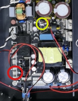

Hi X,
I had some confusion until I read (again) the instructions for the SMPS.
Obviously, my SMPS has a slightly different configuration without DC-Error connector for an led (yellow circle in the picture of your amp, and I think it´s rather a PSU error connector) - instead there is an led on my SMPS board, so I can´t (?) use a PSU error led on the front panel (too bad that the front panel is already finished).
The DCER connector (red circle) of the SMPS is a trigger input where it takes a signal from the amp in case of a critical error of the amp and the SMPS goes in PROTECT mode - in your case this connector is not used (?).
Any idea how I can display the PSU error on the front panel (I know, with optical fiber from the led on the board )?
