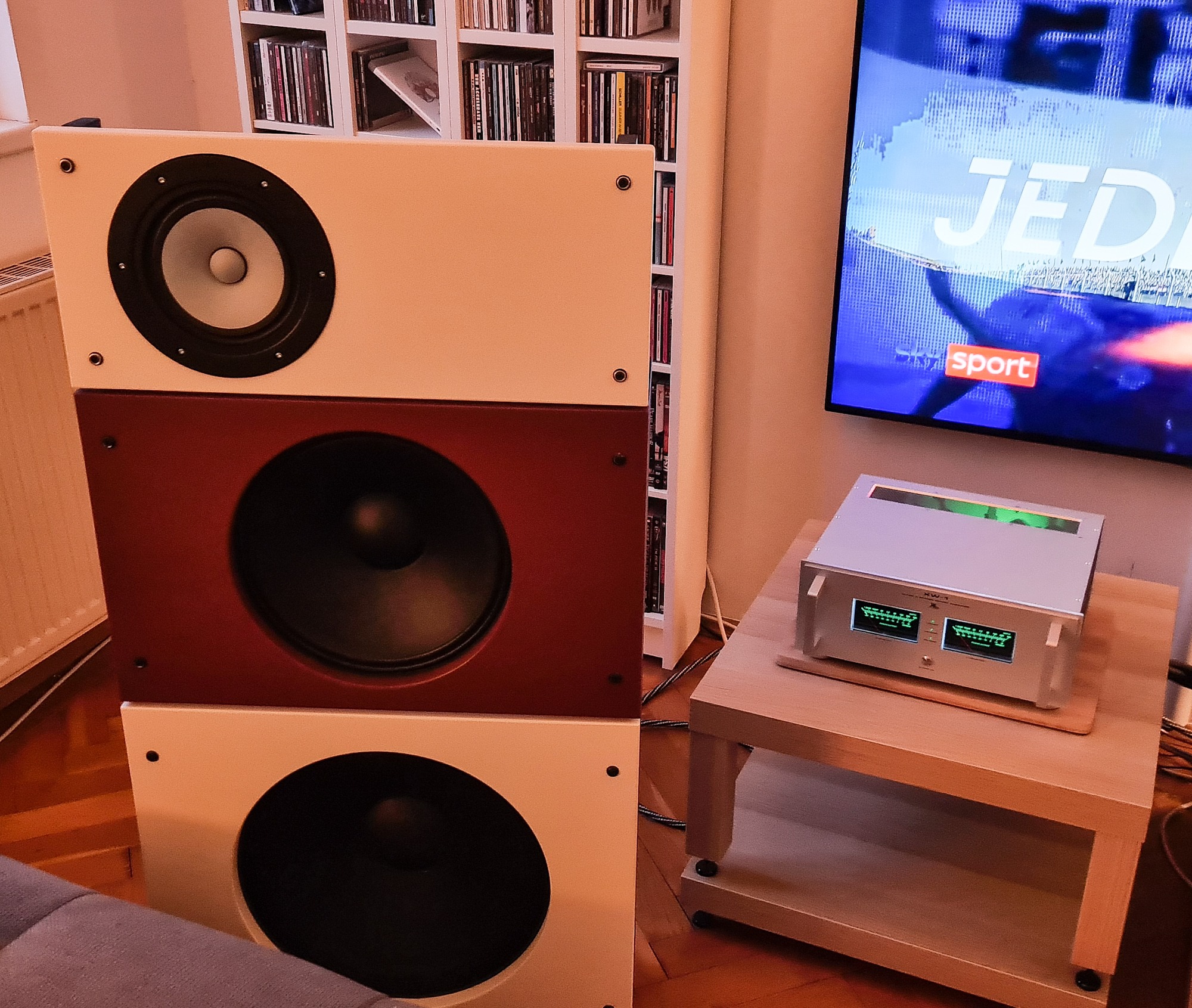

It was the lightning strike that tipped me off ☺️Many thanks @bonjonno
Yes, photography is one of my other hobbies but this pictures were made with a mobile phone.

Here a picture with my self-developed open baffle
