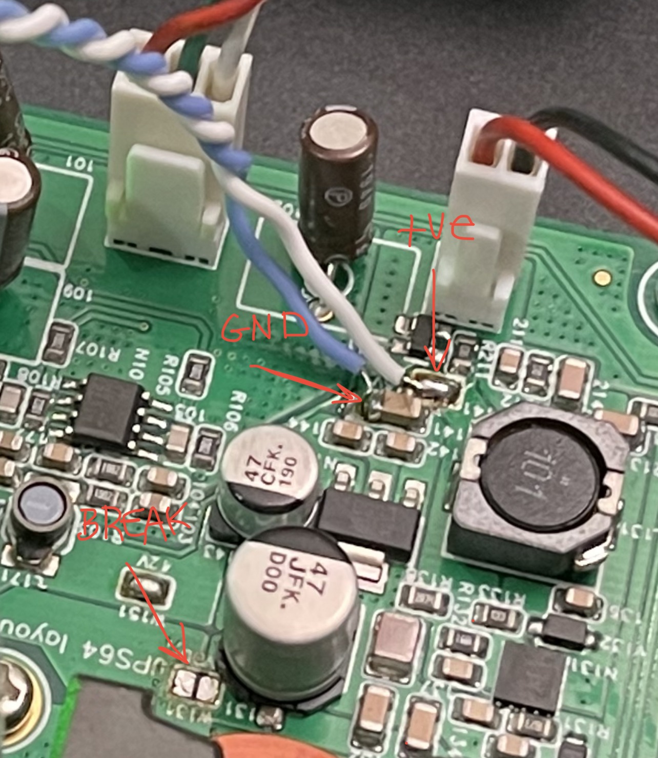

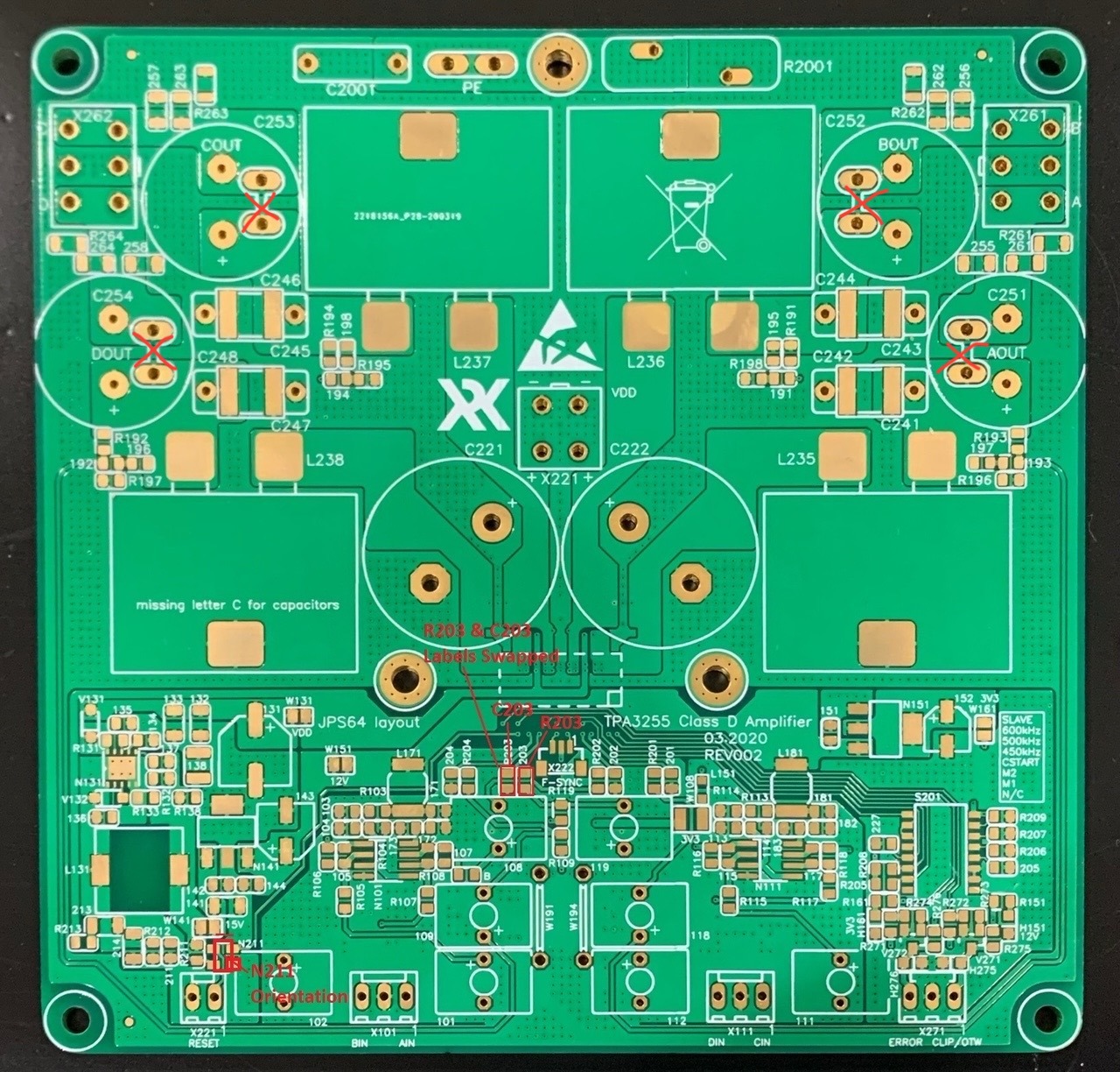

For those wishing to bypass the on board buck converter (due to failure) or if you cannot find one then it is not populated. You can solder the external 15v supply like this:
On the supply, add a 2200uF rail cap for the 15v, this ensures that the opamp supply stays up longer than the amp bleed down to prevent turn off thump from opamp rail collapse.

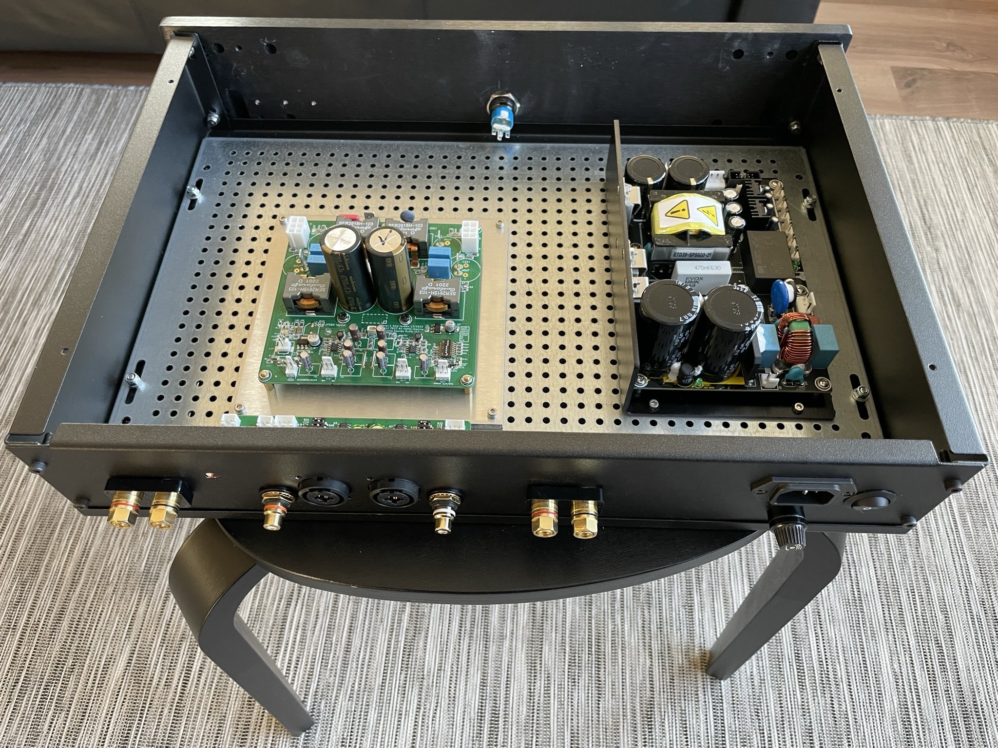

I'm almost across the finish line on this amplifier project. The only last assembly is connecting the fault/error LEDs on the front panel.

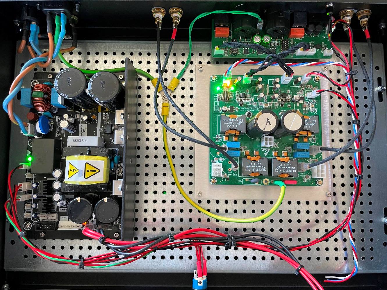

Between traveling on business and splitting my time between two residences, I was able to get a lot done with wiring the MicroAudio SMPS630-SO, the XRK971 BTSB SE/balanced buffer module and the amplifier itself. For whatever reason, my power supply did not come with the insulating sheet that is inserted between the power supply module and the SMPS heatsink, so I found some FEP (Teflon) sheet, trimmed it down and fashioned some hole so that it fit like the insulating sheet that was supposed to come with the power supply.
I had another hiccup when I tried using some M3x10mm screws for mounting the Neutrik XLR connectors onto the rear panel. I bought these through Amazon, and they broke in half as I was applying torque to them. There was no way to extract them from the mounting bosses on the Neutrik XLR connectors, so I had to buy replacement connectors, desolder the stock connectors, and install the new connectors. This time, I bought genuine Neutrik A-Screw-1-8 fasteners and they worked fine.
After getting everything wired up (except the fault/error LEDs). it was time to test the SMPS, and everything was fine with measuring the various output voltages required to power the amplifier: +12VDC, +15VD and +51VDC. I did note that the orange error light was lit. I hadn't connected the +51VDC voltage, since I don't have any 8 ohm dummy load resistors to insert across the speaker binding posts.

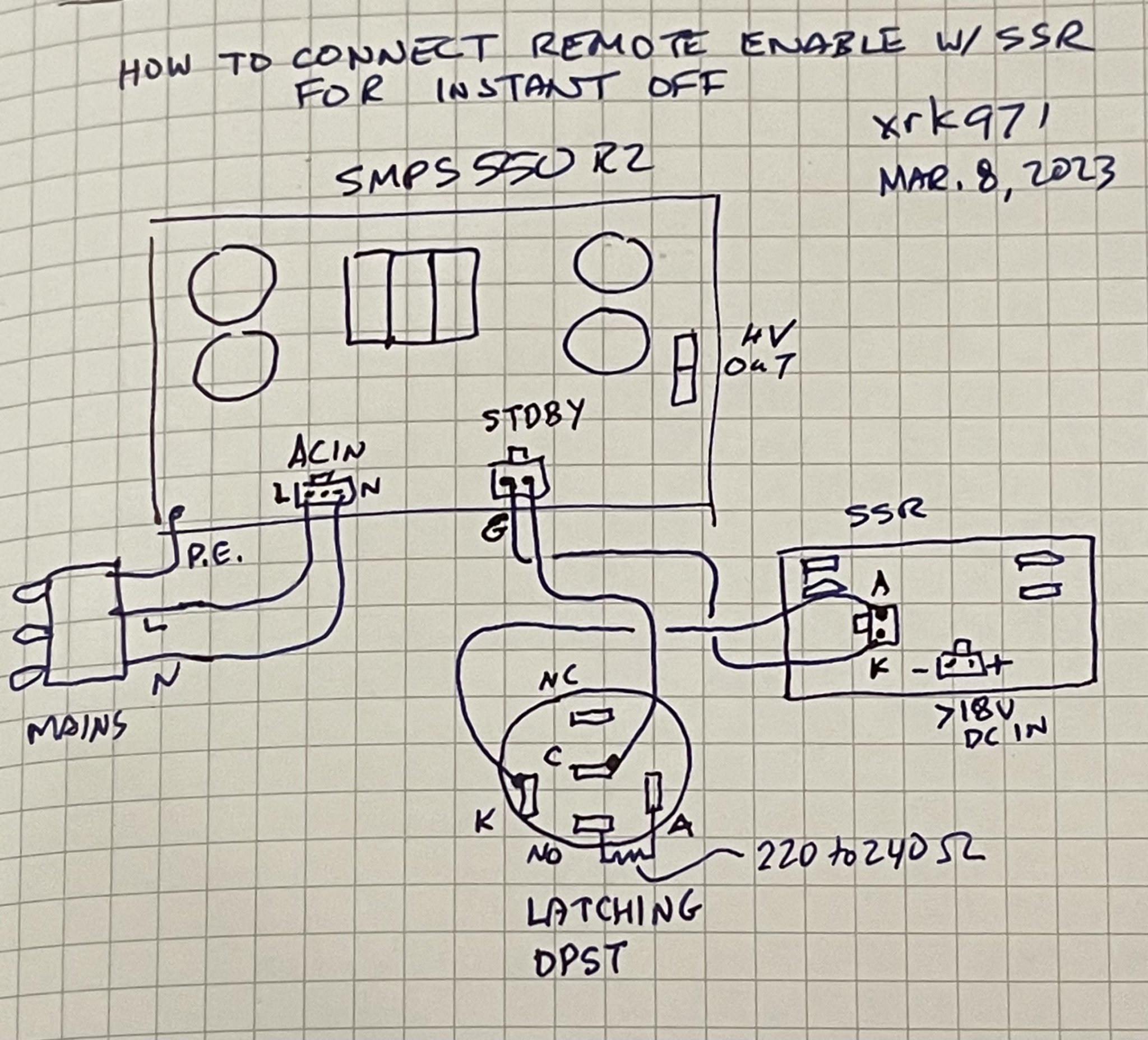

I also couldn't get the front panel latching power switch to work with the Standby mode on the SMPS, but I think that might be a wiring error. When I switch the rear panel AC mains rocker switch, the power supply is completely on, and not in Standby mode. That said, is the amp safe to trying playing some music?

Good job!
Re switch, it must be a wiring issue, you almost surely use the opening contacts of the switch, instead of the closing one. In this case, the amp should go in standby when you push the button.
You can connect the 51v (I did it too) without dummy load, and try the amp. The smps and the amp have built-in protection.
I did it the same way without issues.
Well Plott, I took a deep breath and connected the amp to my system. Voila! I have music--good, clean, detailed and nice sounding music!
I'll need to figure out the latching switch wiring. I want the LED to turn on when I push the button in to switch from Standby mode into full power mode, and then turn off, when I push the button again to switch it into Standby mode.

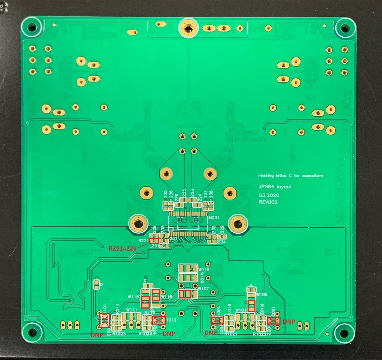

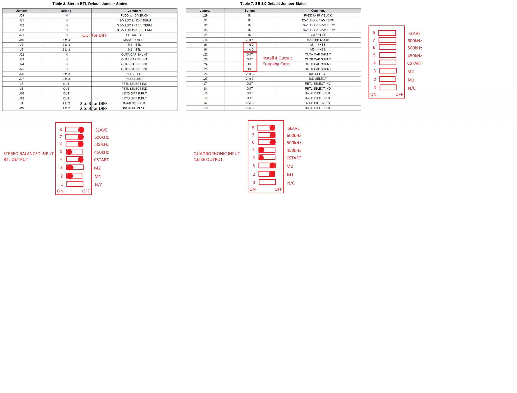

Where can I find J5 and J6? Do I have to connect w141, w151 and w161, w131?Here is a diagram showing how to setup the DIP switches in case you want a different mode of operation. Note that Cstart can work in either position for stereo BTL. For 4 Ch SE output you need to install DC blocking caps where the Faston output tabs are located.
The solder bridges need to connect like this:
I am not sure what you mean by J5 and J6. There are no “J” designators on the PCB. Only X for connectors and W for solder jumpers. For quad SE output, you install qnty 4 x 1500uF 63v coupling caps where the Faston output tabs are. Faston tabs need to be removed (where X is):
Oh, that table was taken from the TI TPA3255 EVM schematic, so their designators are different than mine.
J4 is M1 selector, J5 is SE/DIFF and J6 is M2 selector.
Those J selectors in EVM are implemented by hard wired solder bridges on my PCB.
