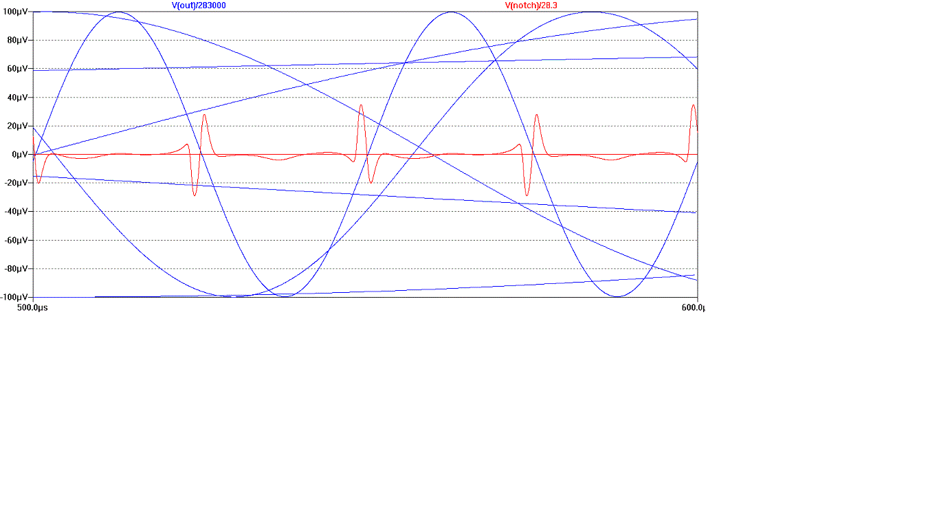

I think I answered with " but here I've got less oscillation if connected across Q13".
If you.param prb=0
- use my Blameless4.asc from #173
- change C3/5 back to your 100p/330p
- remove U1 the THD meter
- connect V2 to InP
- edit the SPICE directive to just say
.tran 0 11m 0m 1u
you'll find oscillation on only some of the negative peaks.
This type of instability may come & go in 'real life'. It often doesn't show up in 'linear' stability measures like PM, GM, Bode, Nyquist etc.
Actually, if you decrease the maximum time-step to, for example, 0.1us you'll see oscillations in every cycle. So this is not an instability that occurs from time to time (which, in a SPICE simulation, would be something really odd to get).
The fact that this cannot be detected with "linear stability measures" puzzles me considerably.... I'll take a look at this in more detail in the next few days....

Thanks for this Damir.In my simulation I've had some oscillation only on the verge of clipping, and when I simulated as you suggested I had oscillation on some negative peaks. This should not be provoked by non adequate TMC but somewhere else. By increasing C4(parallel to the Vbe multiplier) from 1nF to 0.1uF oscillation disappeared and remained some clipping oscillation(on positipe peaks). With lower VAS degeneration(R22) from 22 ohm to 15 ohm or even 10 ohm all oscillation desappeared.
This is now the best of all the TMC versions and only 6dB from the #173 'pure Cherry' version's THD at 20kHz. I expect 'Little Gem' to have excellent performance with a simple circuit and I have commented on this before.

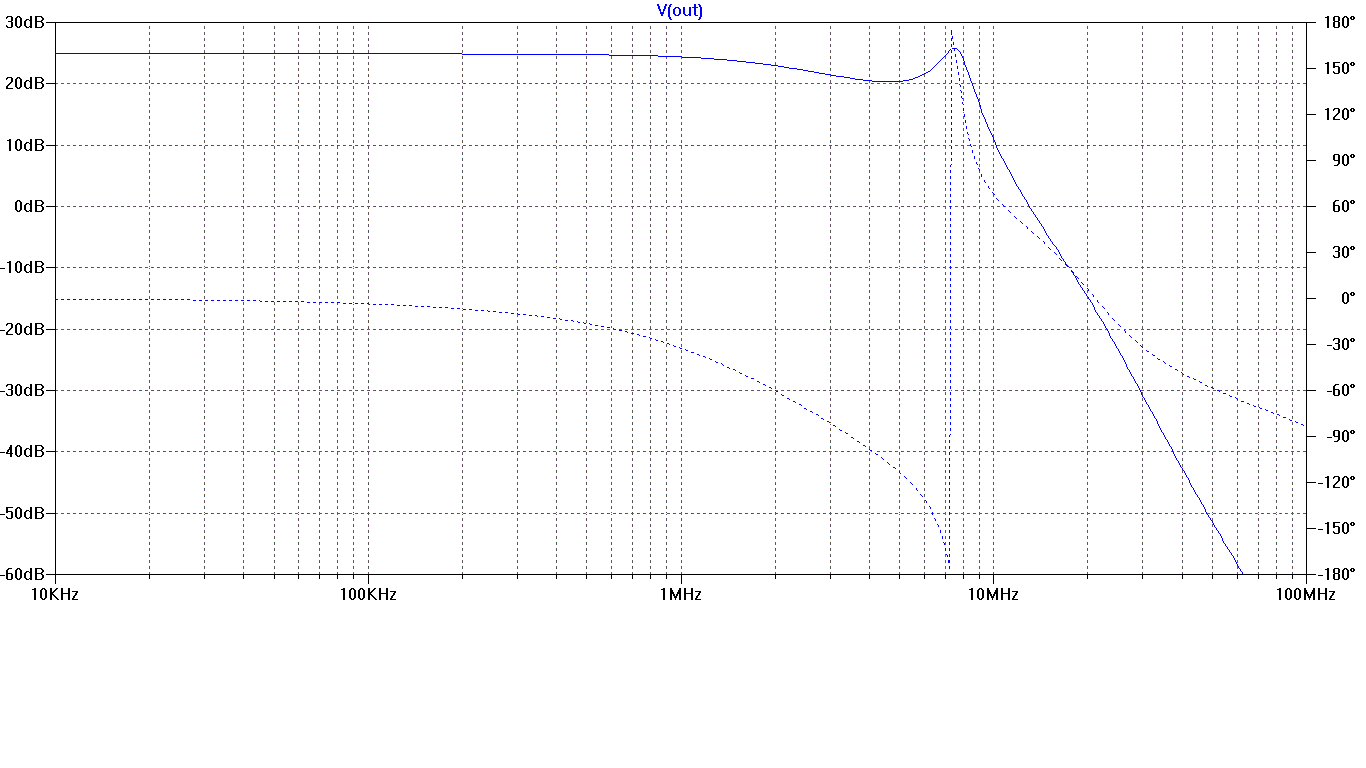

The Closed Loop response still shows some peaking. Damir2CL.gif is with a pure 1n8 cap. load but the peaking is still there with just 8R. You may want to do some work to reduce this.

Yes, but that’s the reason why you must run several AC analysis with the amplifier at different operating conditions (i.e. no only at quiescent conditions).
I’ve done this for your example in two conditions: maximum output voltage (where there is no oscillation visible in the transient analysis), and at the point where oscillations are visible.
In the max output voltage case the phase margin is ~58º, but the gain and phase characteristics do not look good near the unit gain frequency (UGF). In the later case there is a peak in the gain characteristic after the UGF, which causes the gain to rise above 0dB in a range of frequencies where the phase is already below -180ºC -> in this situation phase margin in -36º, which is why you have oscillations.
The presence of oscillations can always be detected with a properly done AC analysis.

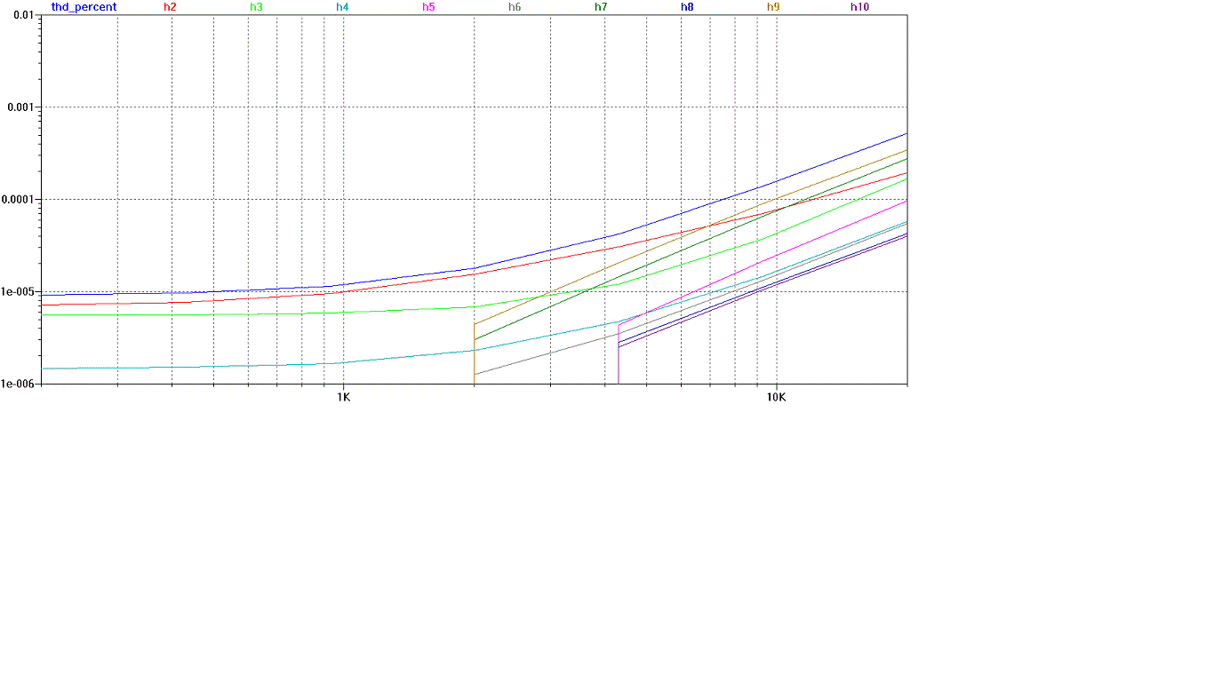

THD Analyzer
But I only started playing with it this year .. to see if it could simulate some stuff I used to see in 'real life' Jurassic times when the design of amps was of real importance to me. I have been a real beach bum for nearly 1.5 decades.
The code for the THD Analyzer and all the parameters are in 'Analyzer_Controlls.txt'. I won't pretend to understand it all .. but it appears to do THD by rms sum of harmonics from the FFT.
The notch is done by removing the fundamental from the FFT and then IFT. There appears to be a 'settling time' which affects the residual of the first few 'frequencies' but by the time we get to 20kHz, the notch output appears exactly as we expect. The THD sum appears always good.
This is of course the sensible way to do THD in da 21st century.
jcx might like to comment as I believe he had something to do with the code.
My own poor efforts at THD by FFT have been inconsistent. I can't get a consistent FFT noise floor.
When I do, the results coincide with THD Analyzer.

[pedantic]The strict condition is that Nyquist encircles (-1,0). Phase can be 180 and Loop Gain a zillion and .. as long as this happens very far from (-1,0) it doesn't matter.[*] There are several simulation results I've posted on this thread where this happens. eg #84/85.[/pedantic]
[*][even more pedantry ..]The strict condition counts how many times (-1,0) is encircled. Google Nyquist curve. This is of interest to control specialists but for us unwashed electricians ... usually only one encirclement is of interest with Power Amps[/pedantry]
Just picking you up on your As you are obviously a Nyquist guru, you'll know this isn't strictly true. I DID say I was being pedantic. And you can check my quoted examples for this![]()
I said that I know what it is, not that I'm a guru.
Yes, it is possible to have a stable negative feedback system where the Open Loop Gain >1 when phase =180 degrees. But that happens in "exotic" situations which typically do not occur the design of amplifiers. For example if the amplifier has a non-monotonic phase response passing through 180º several times in such a way that, in the Nyquist plot, point (-1,0) is encircled the same number of times clockwise and counter-clockwise. Or, for example, if point (-1,0) is encircled once but the open-loop response of the amplifier+feedback network has a pole in the righ-half plane (which, you surely agree, would be something unbelievably idiot to try.)
An indication that these are "exotic" situations is that if you check books on electronic design (for example from Sedra/Smith, Razavi, or Gray/Meyer) some them mention simplified versions of the Nyquist criteria, but all conclude that one must ensure the loop gain must be <1 when phase=180º.
Given that we are in an Audio forum -> check Self and Cordell books, they have lots of practical experience, and their books don't say you need Nyquist plots. Finally, for what it's worth, in my ~15 years of doing analog design of integrate circuits I've never encountered any such "exotic" situations.
Note that for the sake of robustness even in a "well behaved" amplifier you must ensure a decent phase margin (PM). For example in a two pole system a PM=45º still has some ringing in the step response, and it takes a PM near 75º get rid on overshoot.
Now going to the case we were discussing: I believe what I said is actually strictly true, given that AC simulations show phase decreases monotonically. This means that point (-1,0) is encircled, at most, just once. If that encirclement exists, then according Nyquist criteria the closed loop response is unstable (unless the open-loop response of the amplifier has poles in the right-half plane...)
