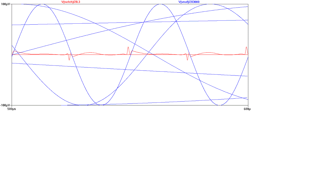

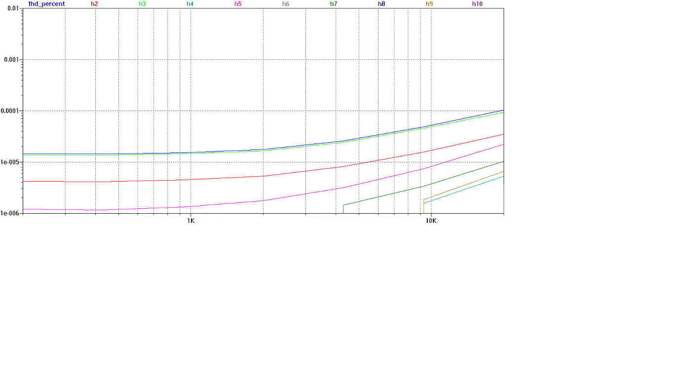

My analysis of the Little Gem, Cherry version, that Damir posted in #210. LittleGEMpureCherry.ASC is his circuit as is.
It appears to be necessary to have C2 330p, the input roll-off, always connected. This is in line with ‘real life’ for amps with zillion MHz bandwidth.
There is a 50-55MHz glitch which comes & goes with each invocation of LTspice. It’s easy to see it in the Bode plots & ignore it but it appears in .TRANS too. In fact it appears on all types of compensation and even no compensation at all !
GEMcherryTHD.gif & GEMcherry20k.gif show the good distortion performance … 2-3 ppm at 20kHz for 50W 8R. The 20k residual plots show 2 cycles of 20kHz at a level of 0.01%

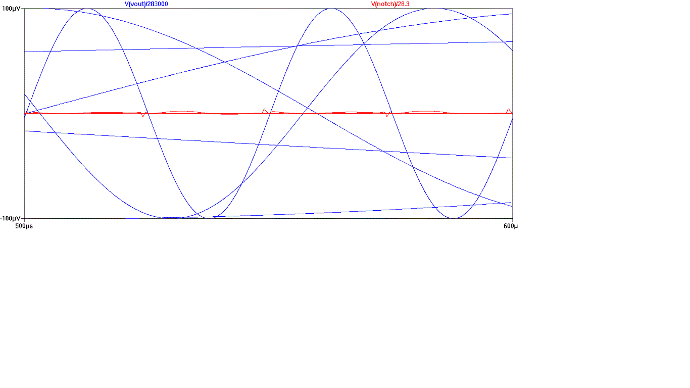

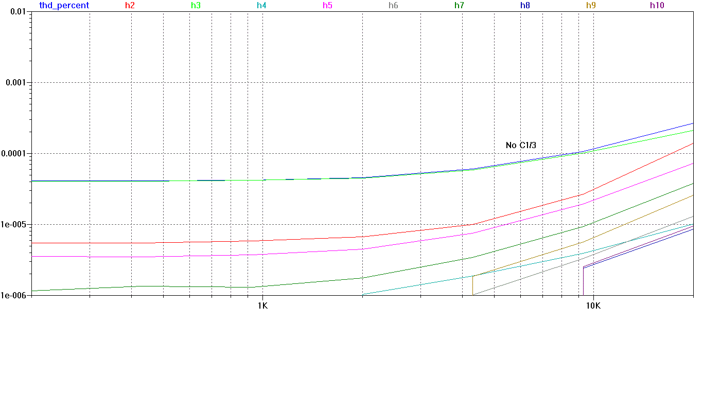

GEMcherry.ASC shows my mods.
It’s likely the only difference between the 2 versions to be seen in ‘real life’ would be slightly better THD20k, particularly a less spiky residual. Layout, decoupling & grounding have to be 1st class to see even this.
Both the ‘Inner’ Loop Gain with the Tian probe on base of Q7, the VAS i/p … and the ‘Main’ Loop Gain at base of Q2, the –ve i/p, are good for both versions with exotic loads. Closed Loop response drops nicely monotonically except for the 50-55MHz glitch.
The original is –3dB @ 1MHz with my modified version, at 400kHz.
The ‘non-linear’ stability tools with .TRANS give both a clean bill of health.
I’ve also
A more important change, which again has little effect on THD, stability or overload behaviour is replacing MOSFET M1, R20 & R25 with a 2k resistor. This is in keeping with my Muntz philosophy.

- Remove R30/31 C8/19, decoupling the bases of the Drivers to earth.
- C13, the Cherry cap, becomes 47p
- R8/10 becomes 47 to restore LG for the main loop
- add C22 220p, decoupling the VAS emitter resistor
I’ve also
- moved R18/26 to the output bases
- reduced C10 & removed C16
- increased R15/16 to 270 on the CM
