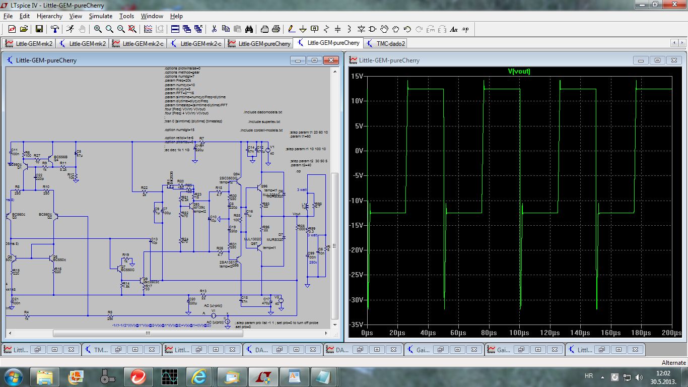

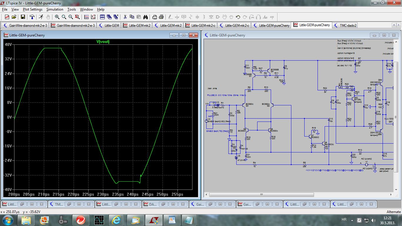

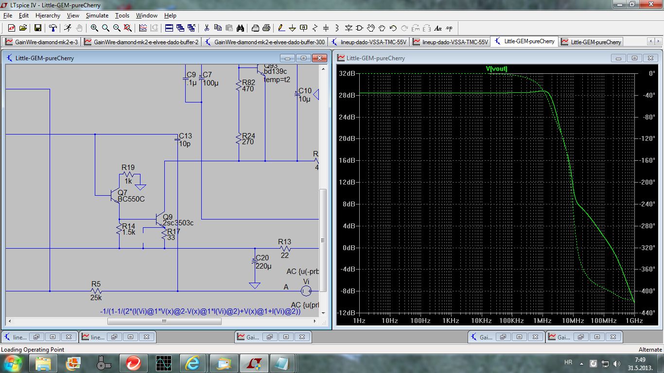

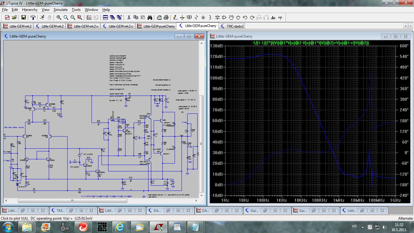

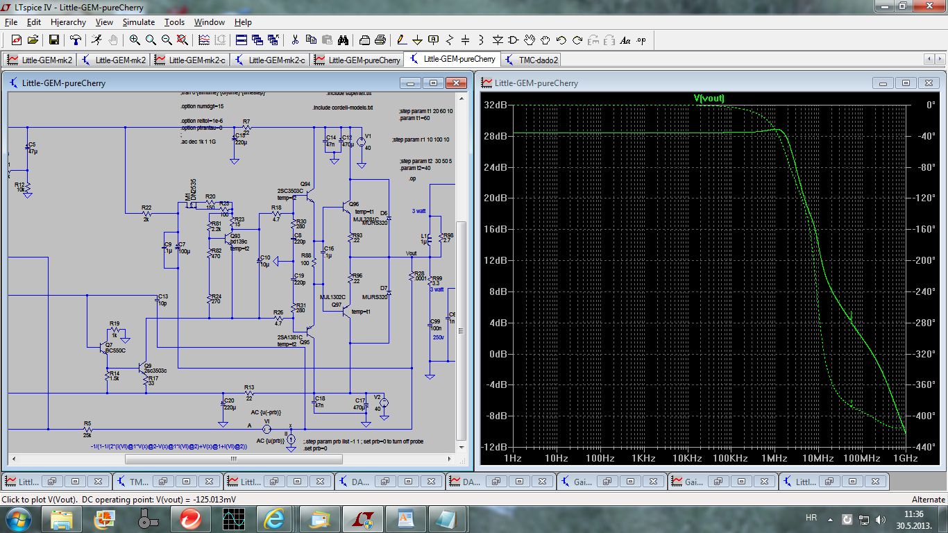

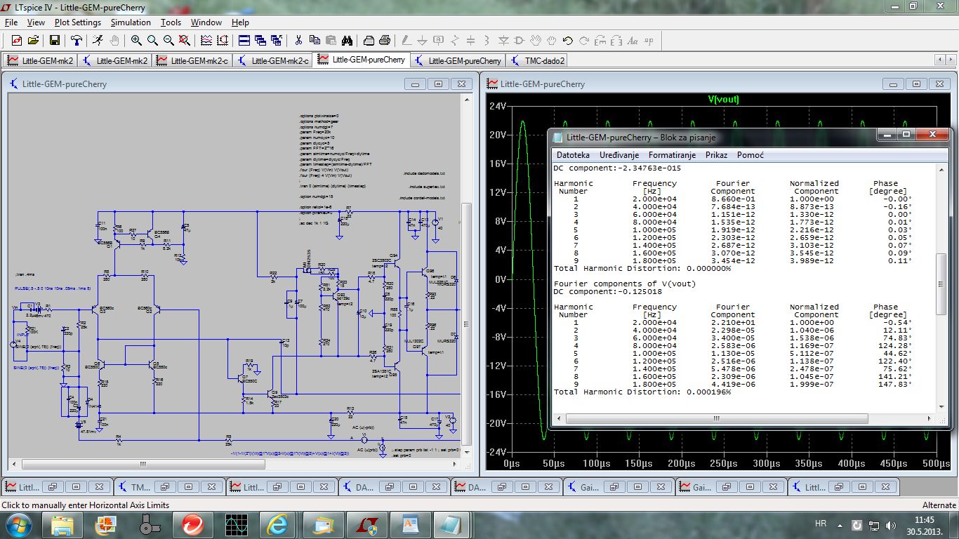

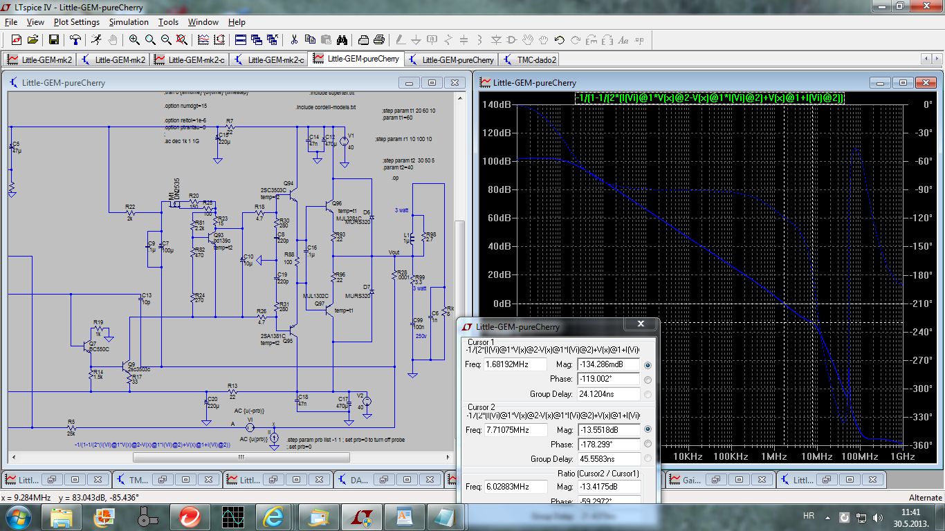

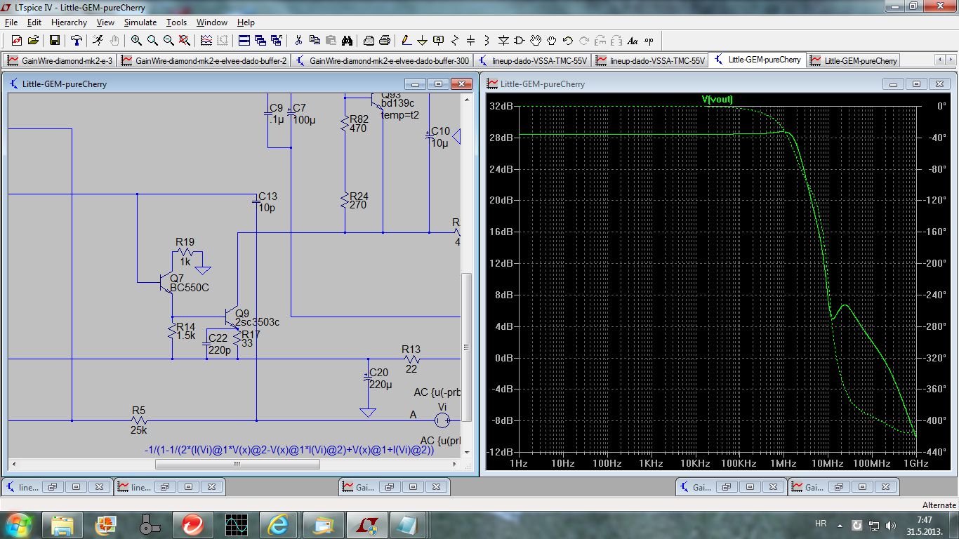

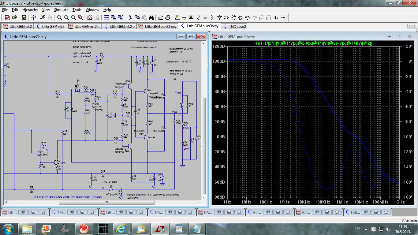

Here is my attempt with pur Cherry. I used my Little GEM as a start point. From look of the close loop gain it should be stable except strange kink at about 55MHz.
This kink is more visible in local stability simulation. simulation with .tran does not show any stability problem. I tried to tame that kink but at the moment with no success. Included zip file with all needed files, so if you like to try it and find better solution.
In my opinion pure Chery gives a bit lower distortion then TMC but not easy to tame.
Best Regards Damir

It's good to do this looking at the Nyquist of your Inner Loop. This is good whenever you are tweaking stability. You need to expand the region around (0,0) & (-1,0)

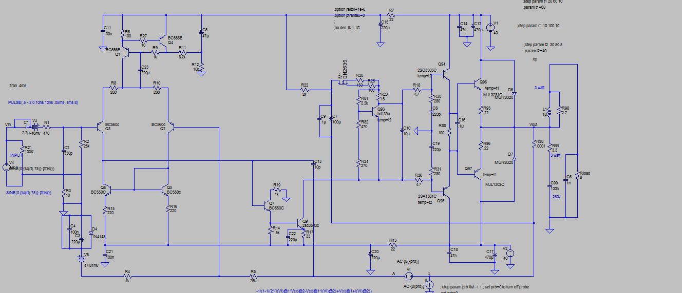

I find it very difficult to read your schematics.

Yes. The VERY BEST TMC versions can get to within 6dB of 'pure Cherry' THD20k. In fact only you have achieved this. Most of the others are about 20dB worseIn my opinion pure Chery gives a bit lower distortion then TMC but not easy to tame.
Even then, you'll see the THD residual is a lot less spiky (less High Order Harmonics) with 'pure Cherry'.
I'm hoping this thread will help people tame it.
Here is my attempt with pur Cherry. I used my Little GEM as a start point...
Hi Damir
I really like your work but it is so hard to read.
I add my request to please make it easier for people.
And you will receive better feedback too
Best wishes
David
Dadod, try removing the RC's at the VAS output before you add the degeneration decoupling.
Also, concerning the decoupling. Pay attention to the Rm*C corner frequency. It should probably be higher then the ULGF. Rm is emitter resistance and is 27mV/Iq for the VAS. This may help if the sizing of this cap is a bit ambiguous.

I know how to get better readable shematic, but here the point was on the plots and how I've got it, and I attached .asc and models files so it's easy to open it and see the schematic.
I tried decoupling VAS resistor and the best result I've got with 220pF, but still that kink at 55MHz was there.

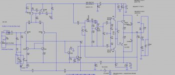

Here is schematic for those who don't use LTspice.
BR Damir

Strange when I repeated the simulation there was that glitch at 55MHz no more, some simulation artifact??

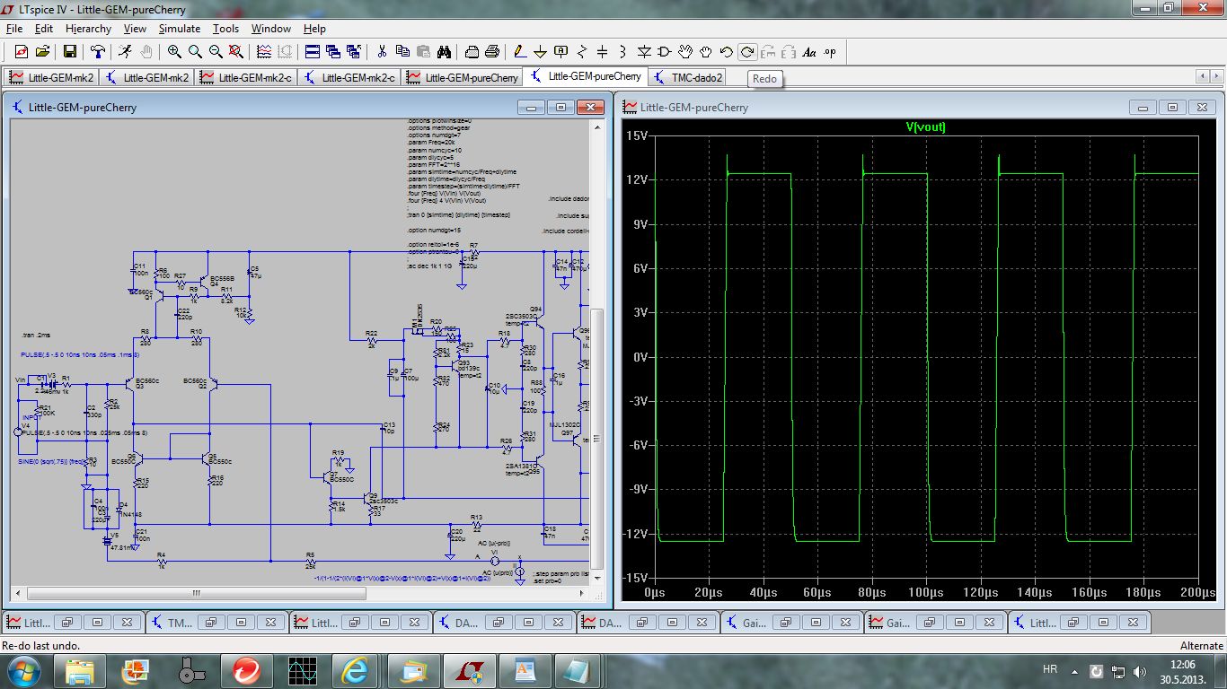

Here are close loop simulations with and without 220pF parallel to the VAS degeneration resistor.
Damir

This is essential when looking at stability of main or inner loops.
The 50MHz kink is there with other (or even NO) compensation schemes too.

I have run minor loop gain sims of your beloved Cherry circuit with my models and the loop is still unstable.
As I noted previously, it's enclosing the output stage singularities within the Miller loop that causes the instabiltiy, regardless of the type of output stage.
In other words, the second stage continues generating gain greater than unity long after the output stage poles have taken effect; this causes greater than 180 degrees phase shift long before unity loop gain frequency is reached.
Thus, Cherry's output inclusive compensation is simply unworkable without fairly draconian shunt compensation at the second stage's output as I have previously established.
