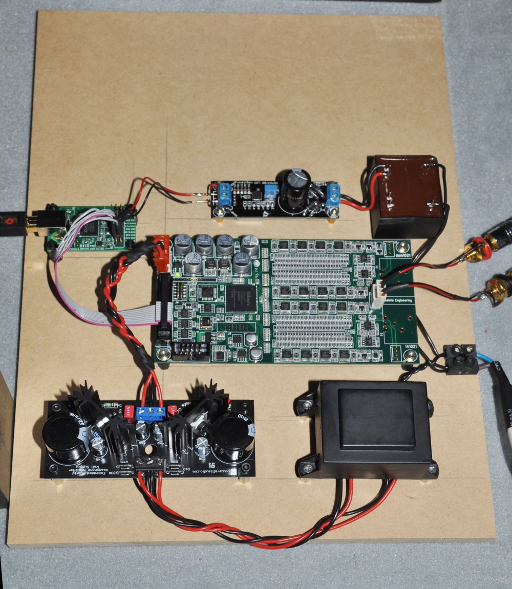

Aleš, just finished hooking up one of your dual boards to power the two sections of my JLSounds USB board;
Nice and steady at 5.02V. I plan to use the sensing but the solder pads under the PCB were already bridged so I'll remove the board and fix that later. Also, I had some small self-adhesive heatsinks that I was going to use on a RPi so I've used them on the regulator devices to complement the heat bridge block.
I just need to do something with the output of the USB board now!

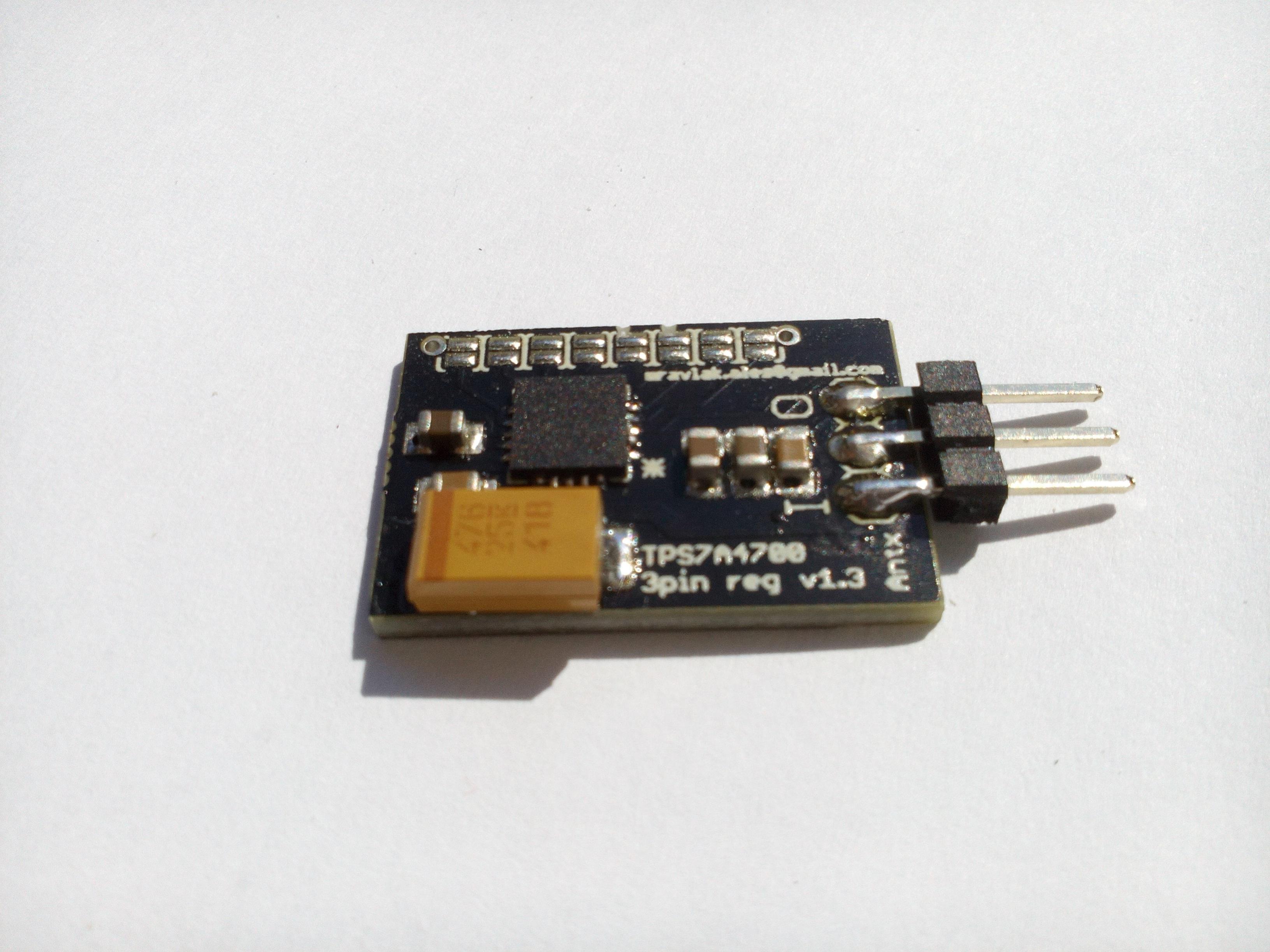

Hello Ales,
does the 3pin have sensing possibility? And how about the heatsink?
Ronny
Hello Ronny,
this version of 3pin regs do not support sensing. Heatsink isn't included, but there is adhesive doubleside thermal tape on the back side of the PCB so you can attach your own heatsink.

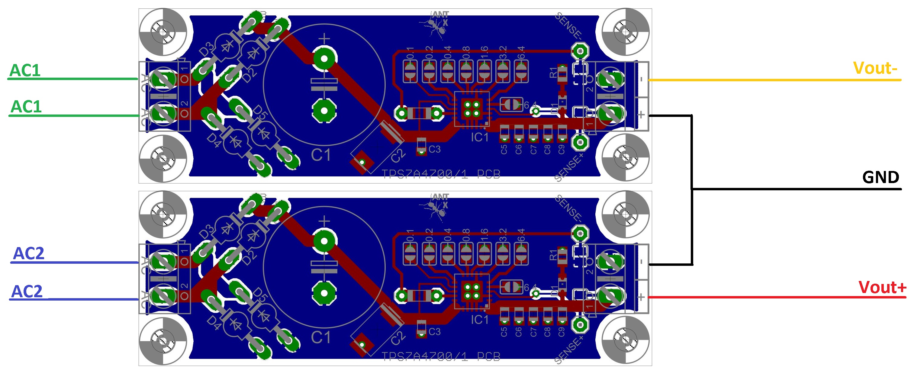

Quick question...I just purchased a few of your single TPS7A4700 kits off eBay and was curious how to set a single board to negative voltage (I plan to use two singles for +15v/-15v).
Thank you,
Todd
Todd,
I attached picture how to connect two single PCBs together to get symmetrical voltage output. Please note that you do need transformer with dual output and not center tapped one.
Best Regards,
Aleš

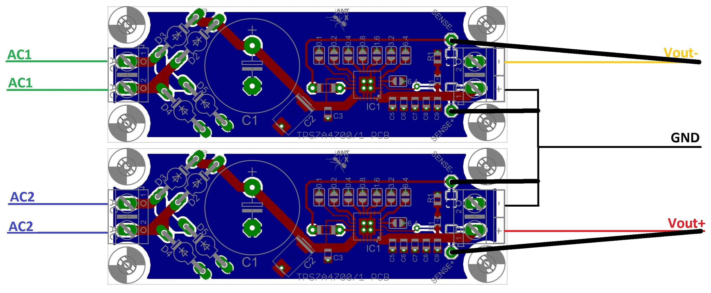

Thank you for the diagram Aleš. One more quick question....Is this how I would setup sense on two PCBs configured for symmetrical voltage output? Thanks for your help![]()
Todd,
yes, this is the right connection when using sensing.
