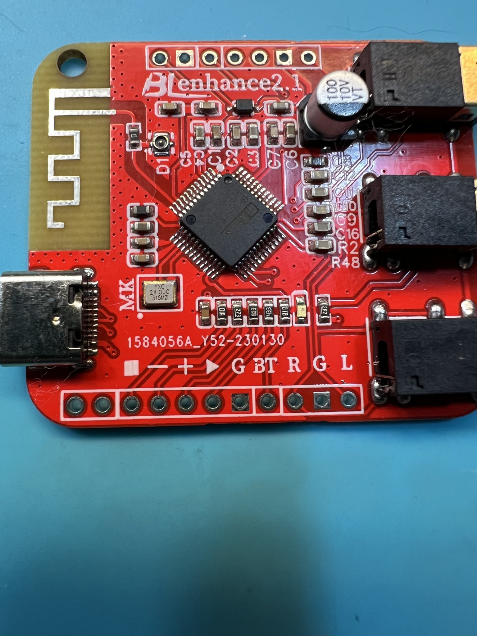

Can you post a photo of the board in question?I'm having trouble with one of the boards, where it will not work other than with USB. I can't select any other inputs, and BT does not activate at power up. LED never lit.
I contacted the seller about it and got this, so I thought I would post it here:
Also, are you trying to POWER the board with USB, or do you have it properly connected to DC voltage…
It's the same as in your first picture above. One worked (powered by usb) and the other one is like I described.
After being plugged into usb and then disconnected (running ACP or not does not matter), my boards will flash rapidly when powered with 5V.

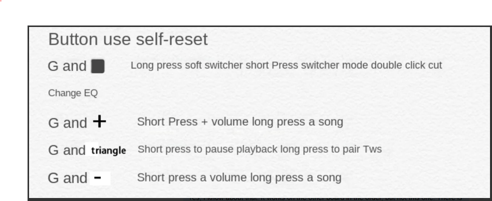

A short press ground+stop will then switch to BT mode. Sometimes this failed, and the probable reason is that I accidentally did a long press.
Thanks for this info about short/long presses!

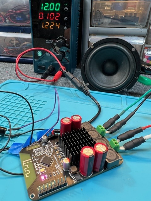

I never tried powering with USB other than for programming, so I really recommend you try 5V power instead if you cannot switch modes when the USB is connected.
BTW my TPA amp is dead silent, but as soon as I connect the BLenhance (even without 5V power) it seems to pick up surprising amounts of noise from the environment.
It sounds like some digital radio chatter, and is audible several meters away from the loudspeakers.
Anyone else having this? I tried winding the audio signal cables around a toroidal core but it did not really help. The cables are very short but maybe they need to be shielded...

Try triggering the “G and SQUARE” button - “to trigger the soft switching” - that might have changed its input mode or something similar.It's the same as in your first picture above. One worked (powered by usb) and the other one is like I described.
Also, check out post #199 in this thread - I think that person had a similar problem and fixed it with that STOP + ground command.I'm having trouble with one of the boards, where it will not work other than with USB. I can't select any other inputs, and BT does not activate at power up. LED never lit.
