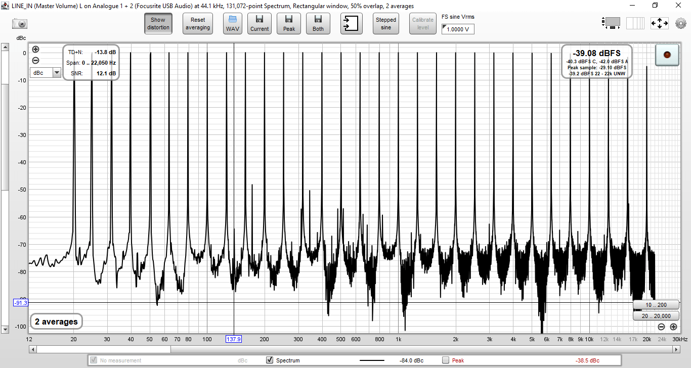

I've played around a little measuring one of the 'preamp boards', and the best I can achieve with multitone is abt 70dB S/N when optimizing gains a bit. I have some spikes that I can't explain, since they are not mains hum related. They seem to disappear when I turn off the multitone. ARTA and REW give similar results.
This is USB in and analog out. I doubt BT would be better.
