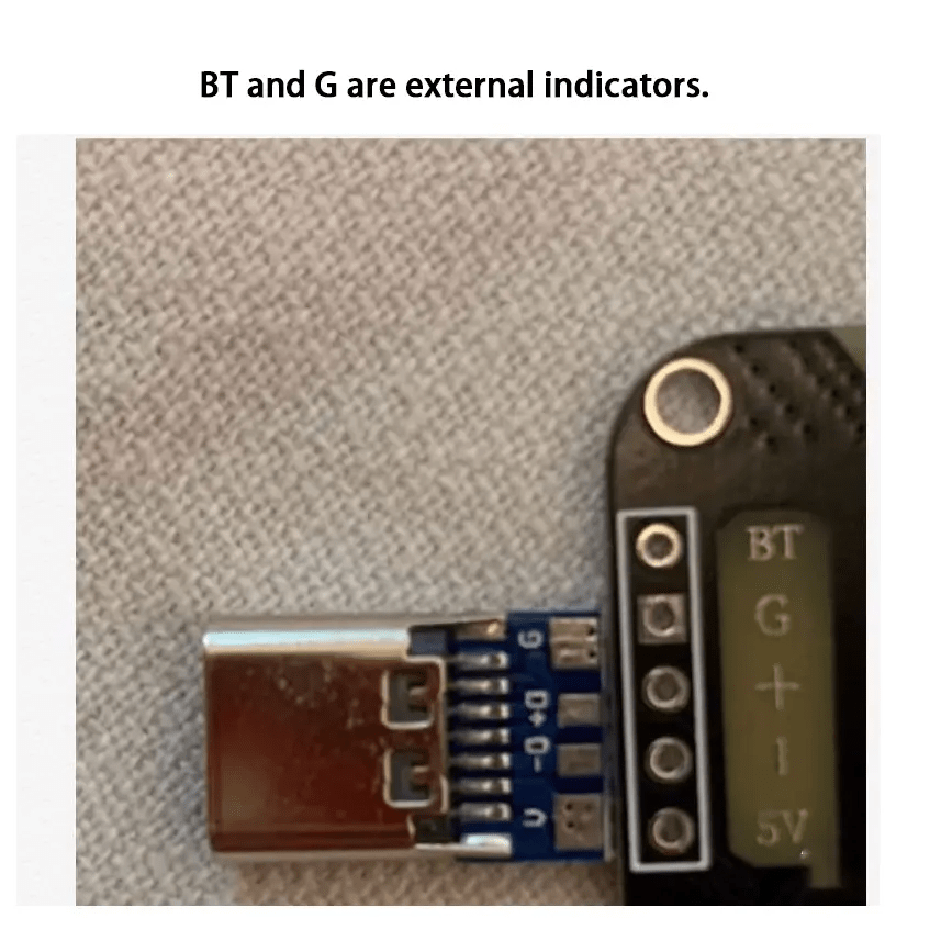

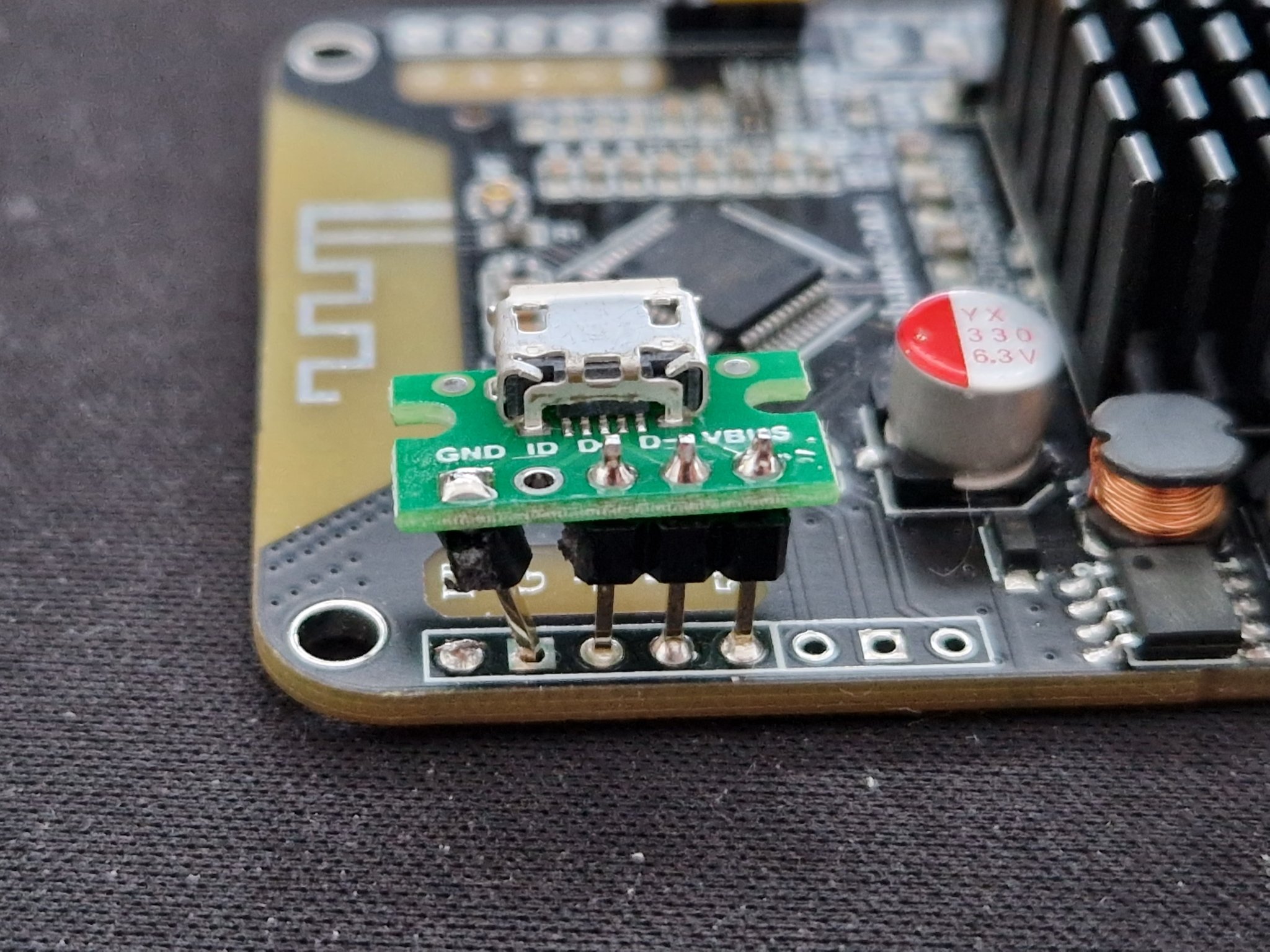

I tried connecting one of the TPA3118 boards with a microUSB breakout board, but couldn't make it work. The plain DSP boards work fine.
Any ideas apart from better soldering? 🙂 (the leftmost pin is soldered from below)
The markings on the board are BT, G, +, -, 5V from left to right

You have to connect power supply to the amplifier. It will not work with USB power only.I tried connecting one of the TPA3118 boards with a microUSB breakout board, but couldn't make it work. The plain DSP boards work fine.
Thanks for the suggestion, unfortunately that was the first thing I tried 🙂
I got inspired to try the same thing with my second board and second breakout board but still no luck. Also tried three different USB ports and two different cables. I asked the Aliexpress store and they just sent me the picture with a USB-C breakout board soldered on similar to mine 🙄

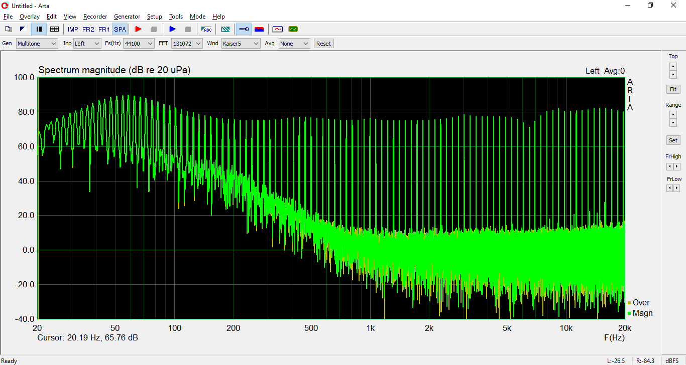

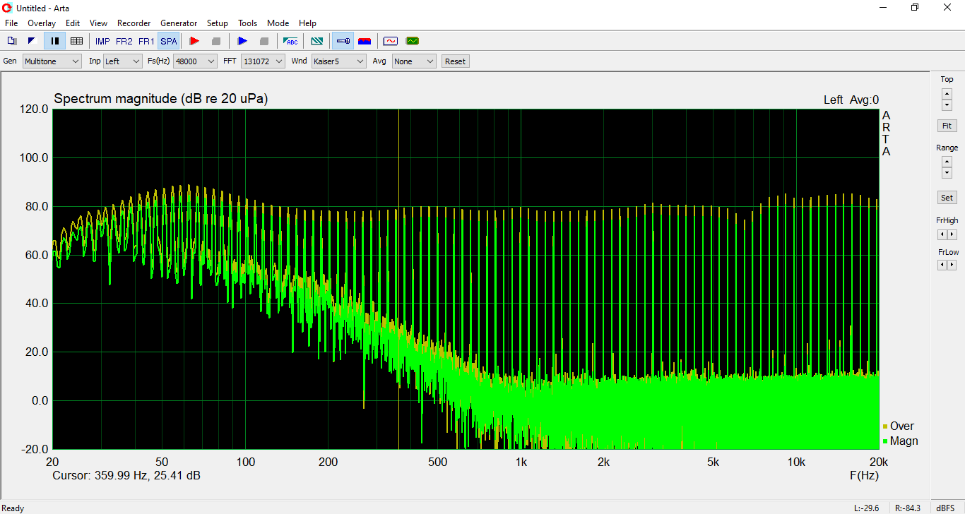

This is what one of the 'plain' boards is putting out on L & R channels, so there is some 'bass enhancement' & EQ active. S/N is not great, but it could also be my quick and dirty setup for measuring too. There is significant distortion in the bass from the 'enhancement'. It can also be seen when measuring LF sine. Trying a 1k sine the distortion is buried in the noise.
EDIT: This is using it as a USB sound card. Have not tested AUX or BT.

Did the same on the board with the class D amp, and they seem to have the same settings loaded as default.
