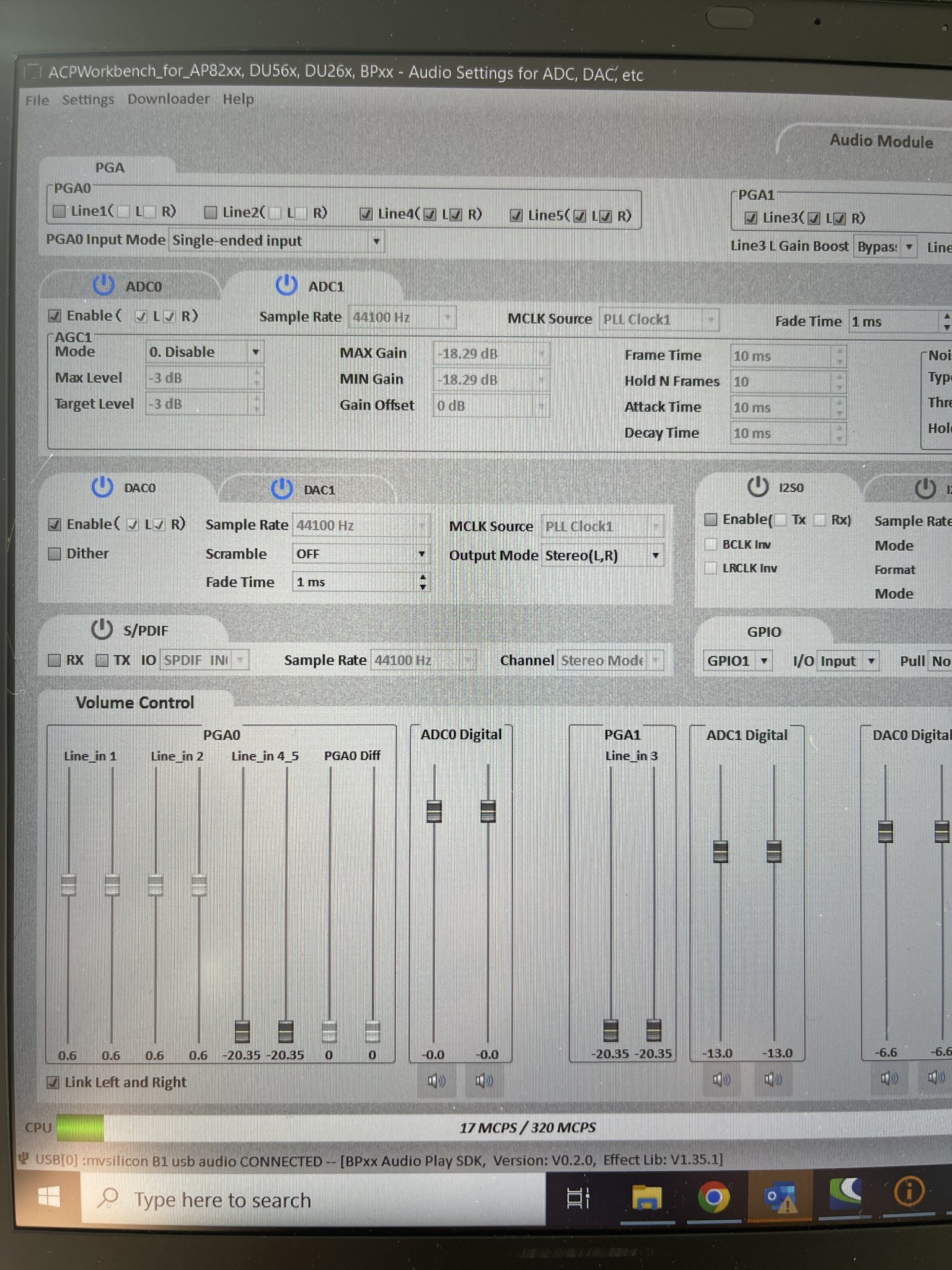

The program I got from the seller on AliExpress.
I even contacted more than one seller and got it sent to me from both. This was for the v1.
When I bought the 2.1 v I asked again and they said that they already sent the software before. And they were right, it detects the board and changed with options were available in the software.
I couldn’t edit my response.

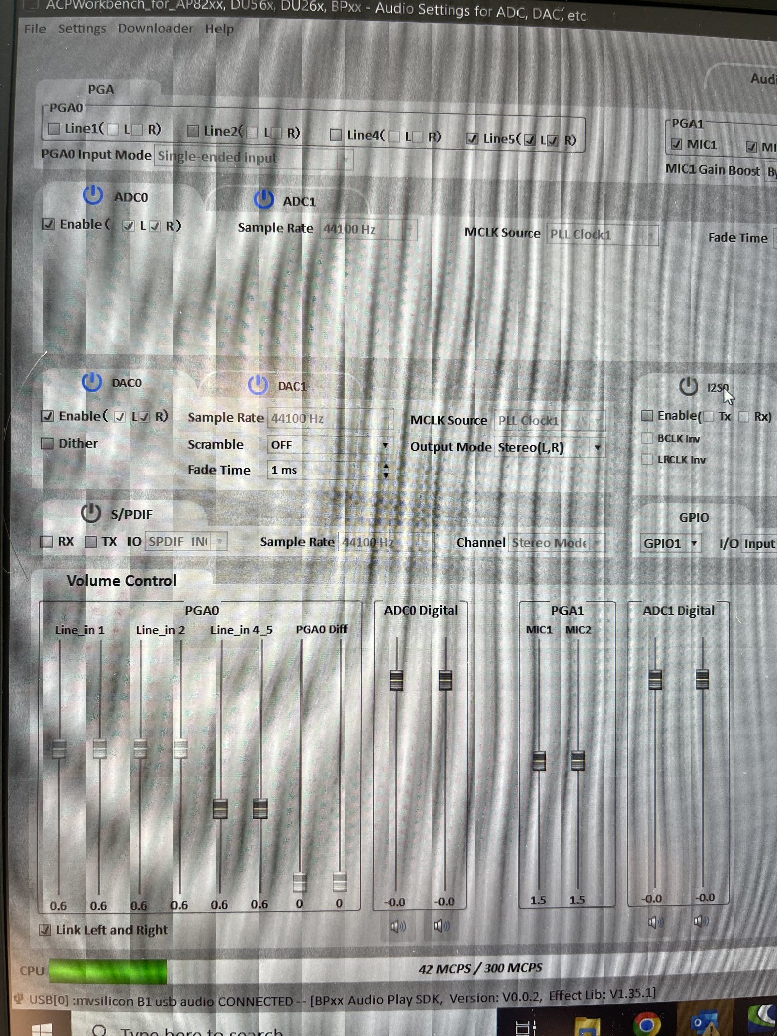

On your board you have the sdk version v0.0.2.
The stereo only have V0.2.0. Whatever this means..
As soon as the program detects the board the program tells you at the bottom what is connected. So before you connected the board you can’t fiddle with the program

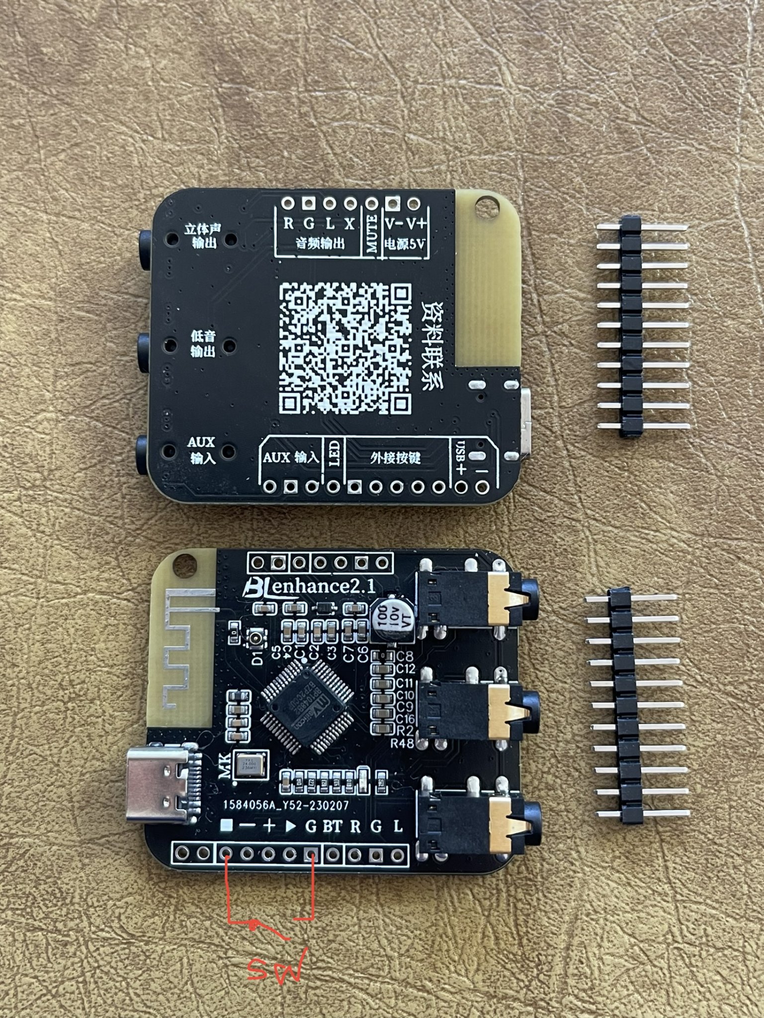

Can someone tell me what the Chinese markings on the two 3.5mm jacks is? The bottom says “Aux”. I assume that is the aux (non BT) input? The others are Ch 1 (left) and Ch 2 (right)? How does the sub .1 output work? Or is Aux same as sub output?

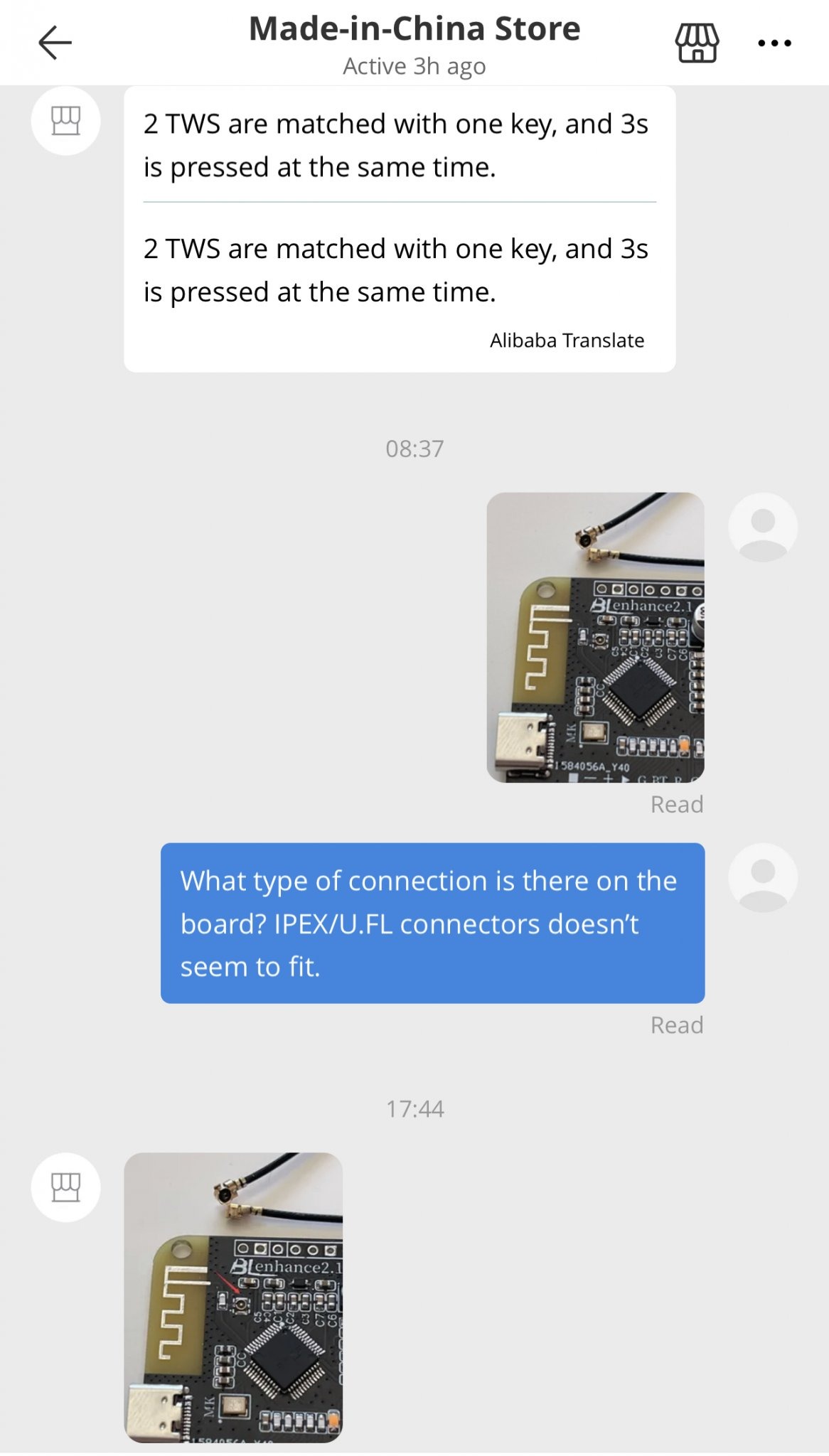

Could anybody take a guess on what type of connector this board have? I ordered two external antennas from Amazon “ipex/U.FL” naively thinking there is a standard. ...
Apparently I-PEX and Amphenol claim compatability between I-PEX MHF, Hirose U.FL, and Amphenol AMC Connectors. Then Hirose also has the smaller w.FL connectors, and I-PEX apparently has a whole line as well.
u.FL w.FL

... Can someone tell me what the Chinese markings on the two 3.5mm jacks is? ...
Didn't cross check with YANDEX or BING, but Google Lens says:
Left side:
top: 立体声 输出 stereo output
middle: 低音 输出 Bass output
Bottom: AUX 输入 AUX input
Top Holes:
Under "RGLX": 音频输出 Audio output
Under "V- V+": 电源5V Power supply 5V
Next to QR code: 资料联系 Information contact
Bottom holes:
Left: AUX 输入 AUX input
Middle Right: 外接按键 External key

Left side:
I`m sitting here with headphones in the output and fiddling.
The above is correct. The middle is a output with summed L+R and low passed at 300Hz.
But I have not been able to write to the permanent memory yet. Live changes to "Effect list 3 Rec pre eq" effects this mono output.
The stop sign is a multi key, when connected to ground with a simple wire will change the input mode, unclear yet on how.
Double clicking, Tripple clicking and long press all have different effects.

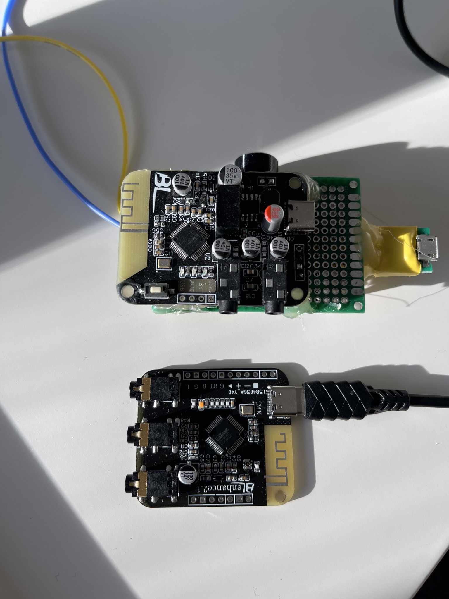

3s hold on two boards that is not connected to any Bluetooth device will make them enter TWS mode.
Yes by pulling these different outputs to ground (momentary and hold) you can change volume, stop, play on the connected bluetooth device. And the stop buttom is for changing input type from USB to bluetooth, entering TWS (three second hold on both boards at the same time).
I haven`t damaged the board by using a single wire (no resistor) yet.
Does it save the DSP settings onto board non volatile memory so the DSP can operate without being connected to PC and USB connector after programming?
This quote is from a review of the Nvarcher TPA3118 board I previously linked to...
"I initially used ACPWorkbench from Arylic which worked but has has issue to save data. Later seller point out to another one. For whom it concerns save command is A5 5A FD 00 16".
They don't mention what the other program is though.
