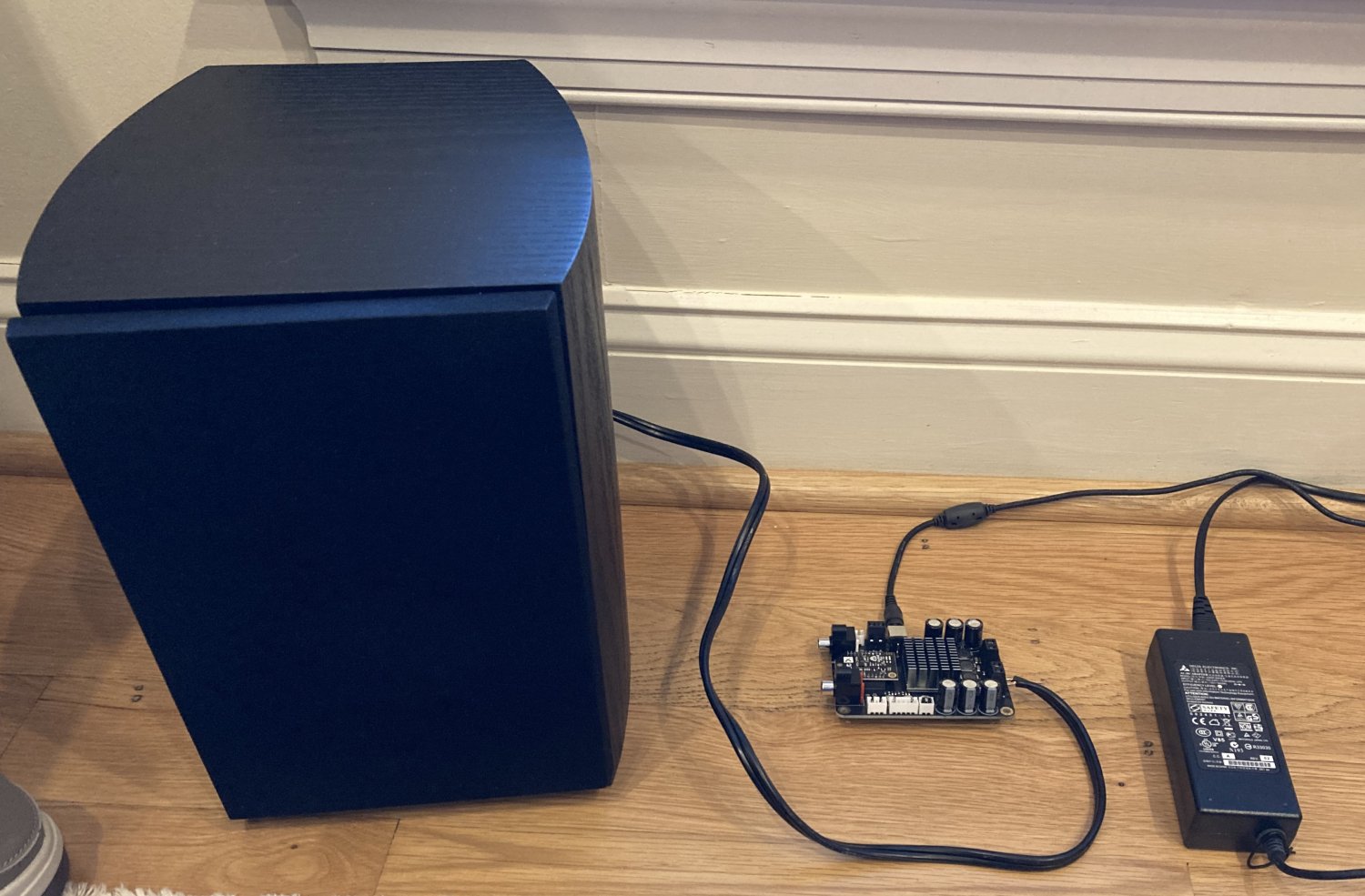

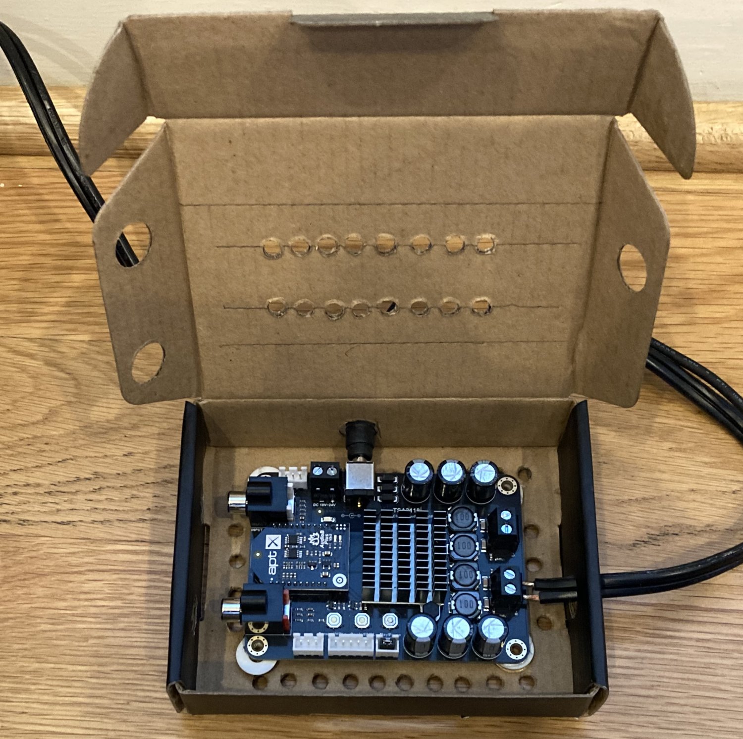

I also have been amazed that there do not seem to be any good TWS bluetooth speakers available. I finally found this forum and purchased a pair of Fluance reference bookshelf speakers and a pair of tinysine TSA3118B boards. Tinysine support told me I do not need a dummy load on the channel not in use. I am trying to use the boards with Windows 10. My computer is not new, so I had to upgrade the M.2 wireless card (now using one with Intel AX210 chip). Everything functions and I FINALLY got Aptx working. I had to disable two way communication to the boards - didn't want it anyway. There are still two issues.
1. The sound has to play for a second before I hear anything from the speakers (minor issue).
2. I have latency problems (maybe half a second). This is an annoyance when watching movies.
I may try one of the USB bluetooth devices, knowing that it might not help.
I am really enjoying hearing music in stereo again. The speakers are nearly 20 ft. apart. I don't mind the power supply wire at each speaker, the goal was to eliminate the need for the long wires feeding the audio source. The Fluance speakers seem to be a good quality product at a reasonable price. I will put the tinysine boards in some sort of enclosure.

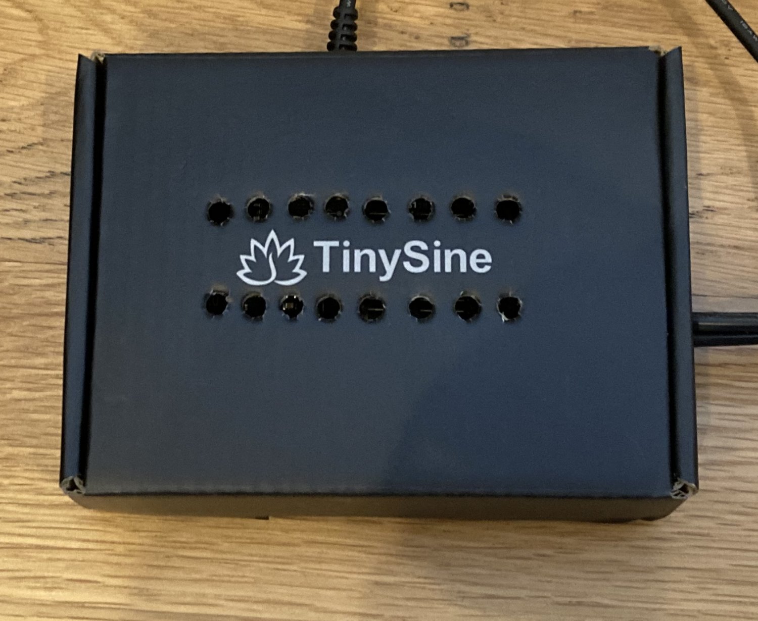

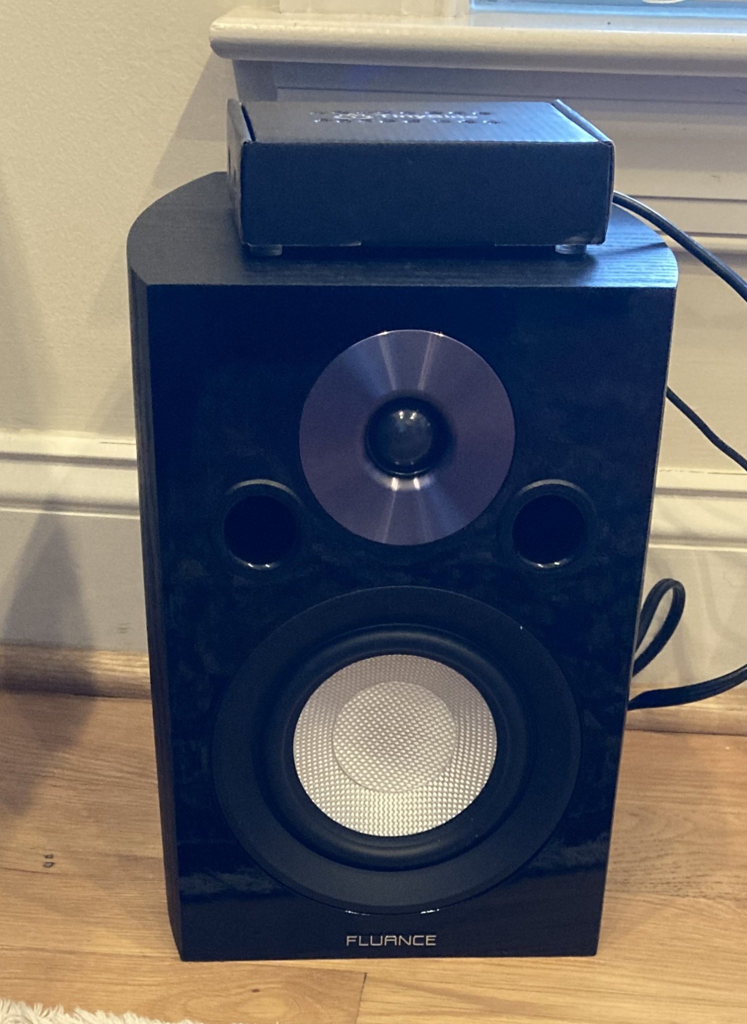

I thought of putting the Tinysine in the cabinet, but there isn't a good way to open it. I could have built my own speakers, but my wife said don't bother, she would get me the Fluance speakers for Christmas! The link between the boards doesn't work well if they are too close to the floor, so depending on placement, a separate box works better.

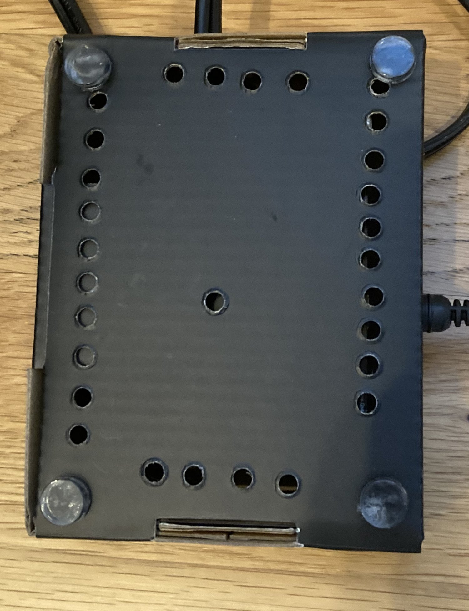

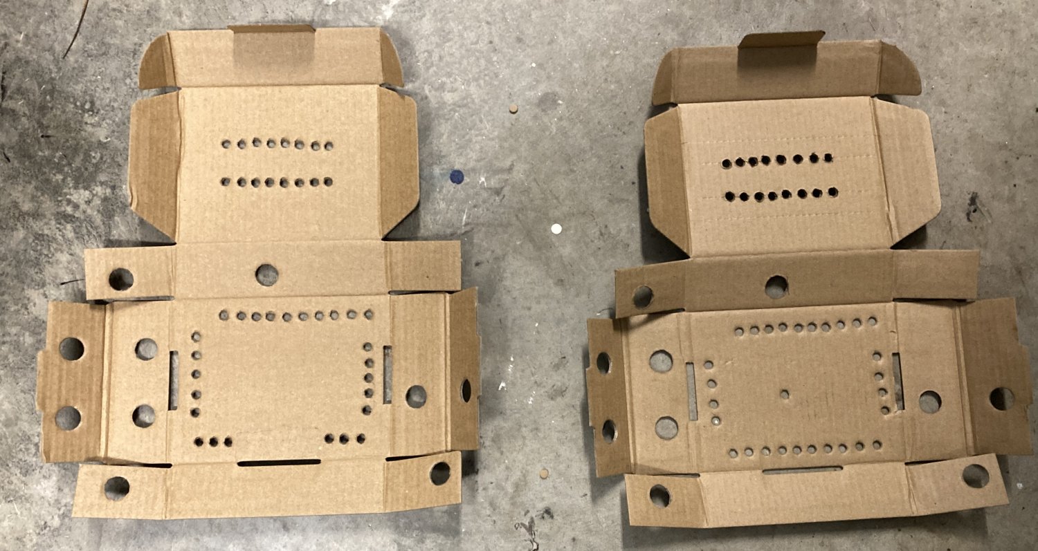

I decided to use a sophisticated, Tinysine branded, climate friendly, upcycling approach for the board enclosures which are in themselves recyclable.
Translation: "Dad Gum, I can use them cardboard boxes they came in!! And they're FREE!"
My computer audio tone controls do not work with bluetooth devices, so I installed Equalizer APO. It works quite well and I get surprising amounts of bass from the Fluance speakers. I only adjusted the bass so far. Does anyone have experience with good ways to reduce the latency?

I believe the latency issue is due to Windows 10. As far as I can tell, Win10 does not natively support APTX low latency. If I can find a driver (Intel ax210 wireless) that includes APTX LL, then it might solve my latency problem. I don't think the normal Intel provided drivers include it, but it is possible that some PCs are sold with drivers supporting APTX LL. I have not found one yet. I spend a LOT of time fixing Windows bugs. Some people have had good results with USB bluetooth transmitters, others still have problems.
This and many other issues are pushing me towards Linux. I plan to gradually transition to Linux before MS stops providing security updates for Win10 (Oct 2025). Overall, my setup is working very well for music.

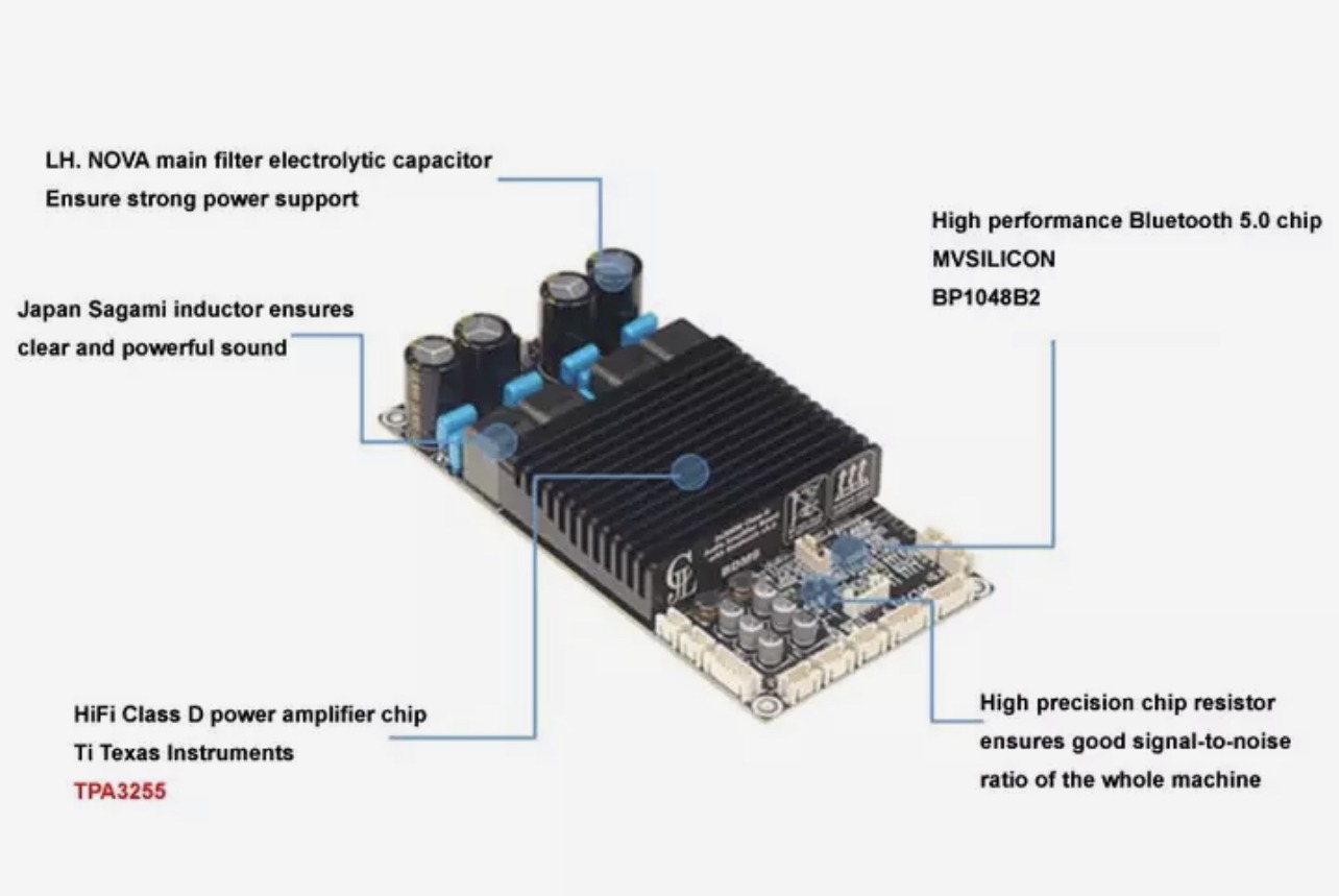

In case you aren't aware, that board uses an MVsilicon (Shanghai Mountain View Silicon) BP1048B2. Programming is done with ACPWorkbench.
I can't find a download for the datasheet, but this Ali link for the bare IC has all the pages of the datasheet posted as images...
https://www.aliexpress.com/i/3256804589587740.html?
There's also a TPA3118 board available that uses the same chip for only a few dollars more than just the DSP board...
https://www.aliexpress.us/item/3256803992176562.html?
