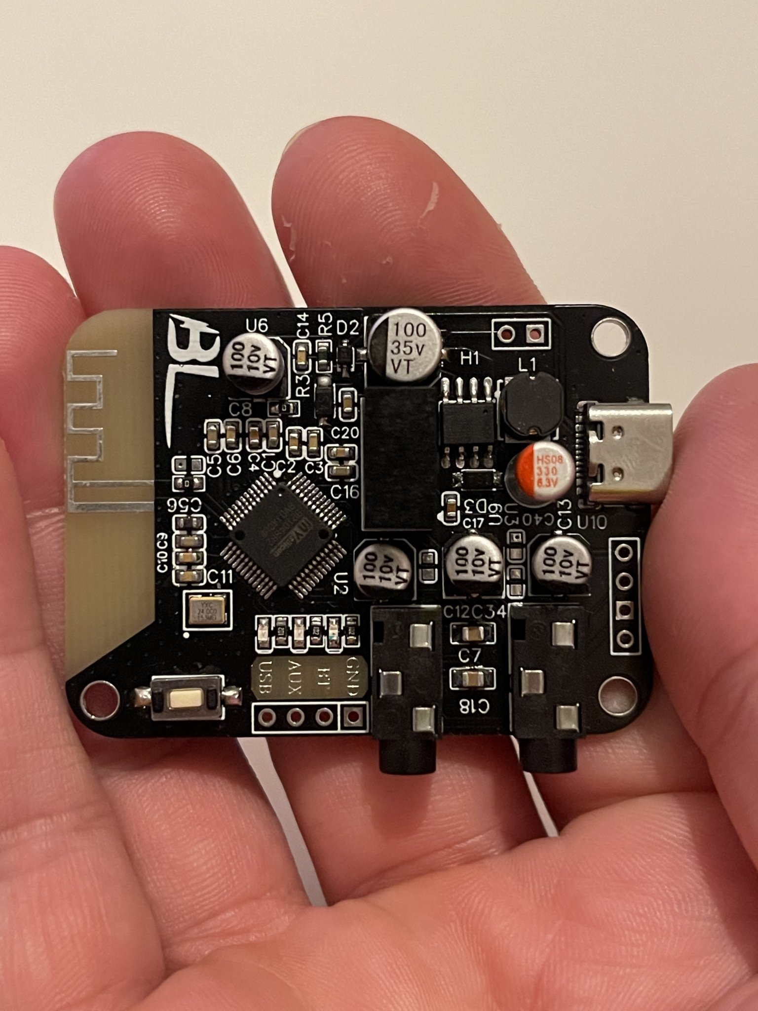

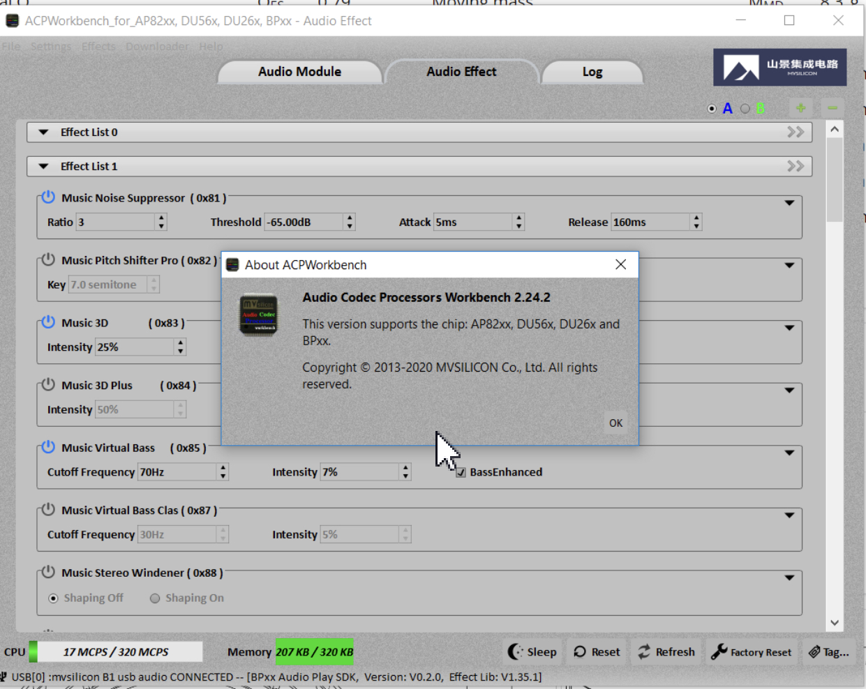

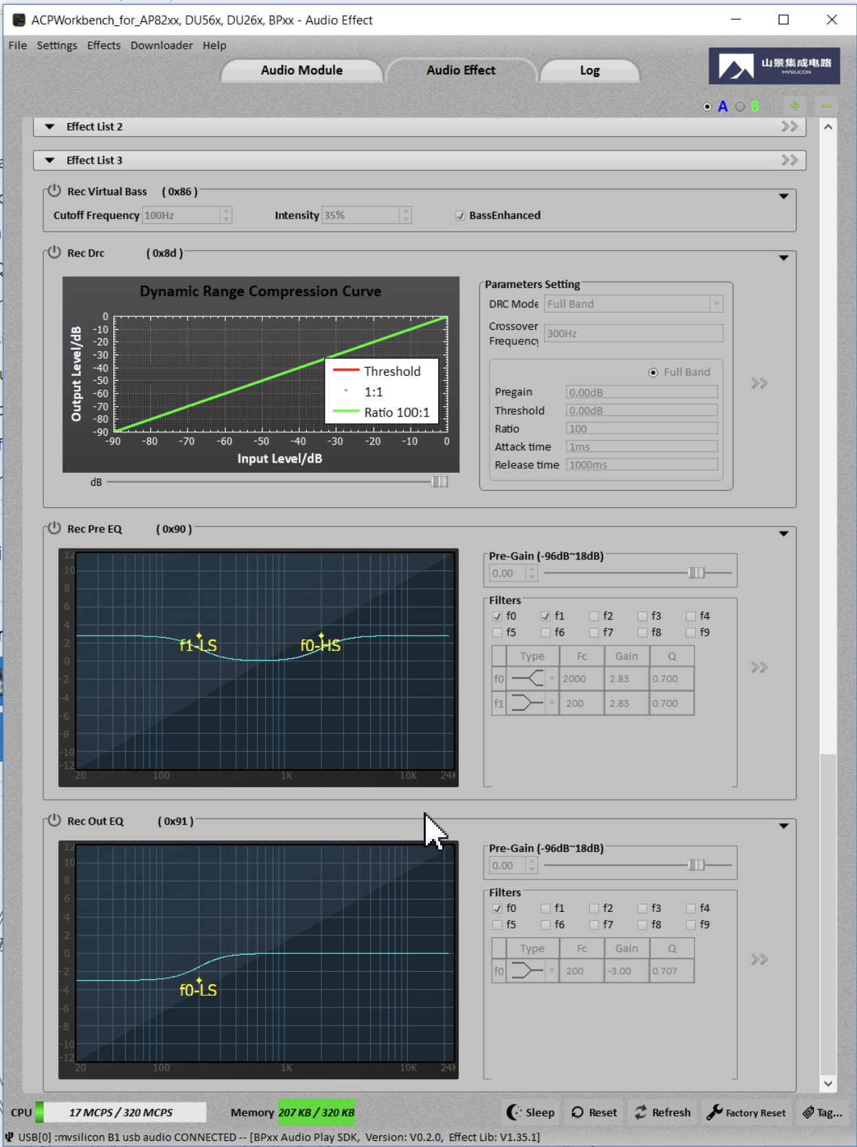

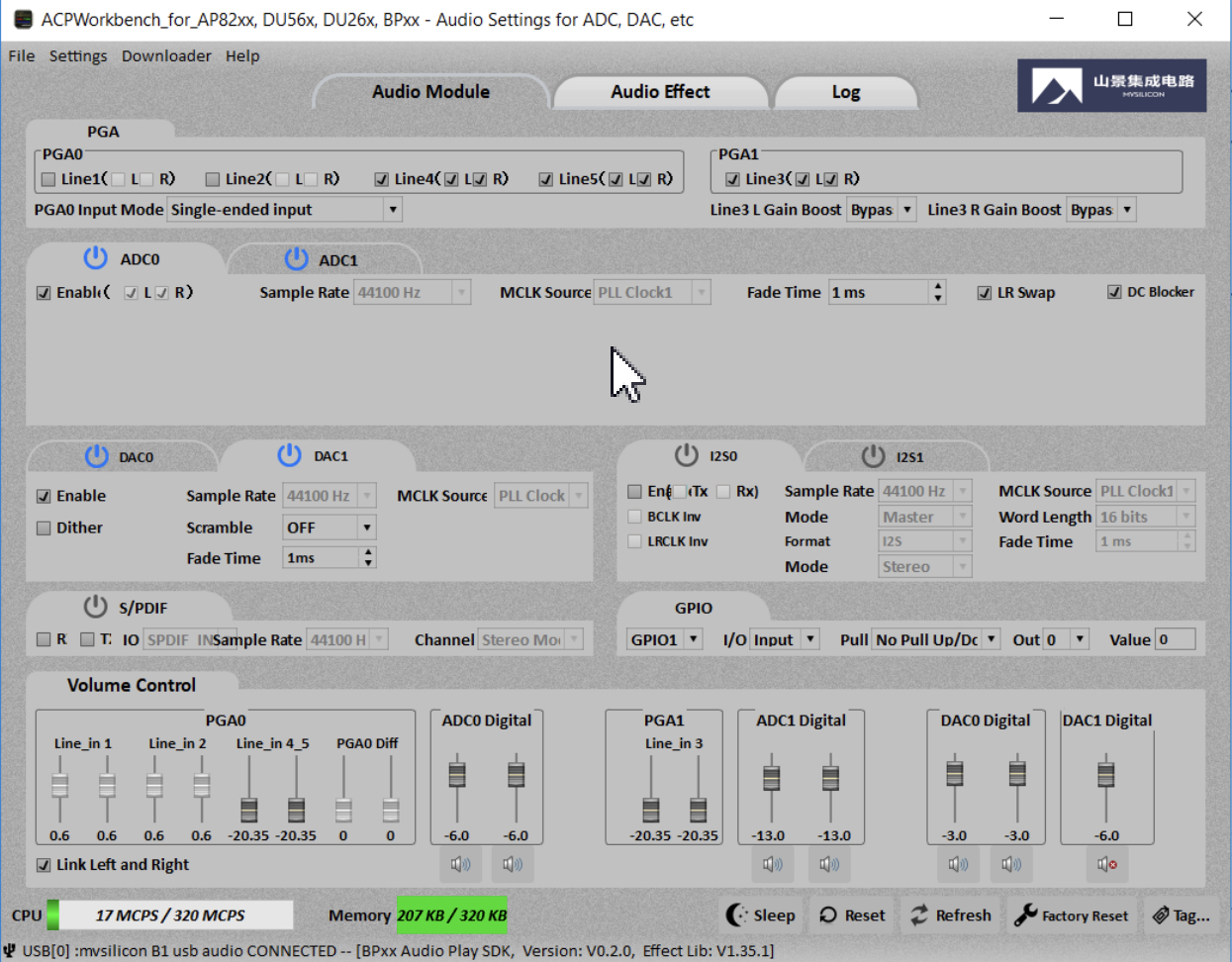

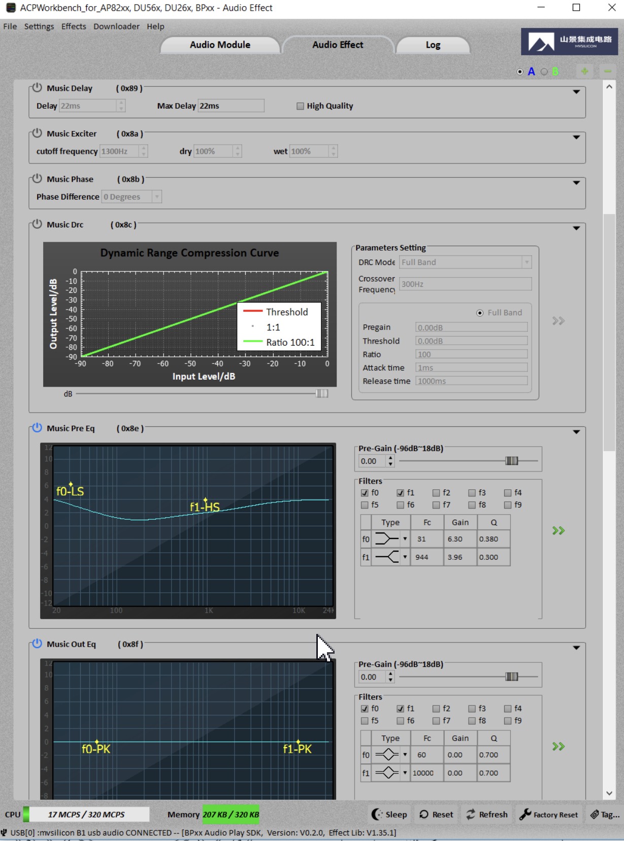

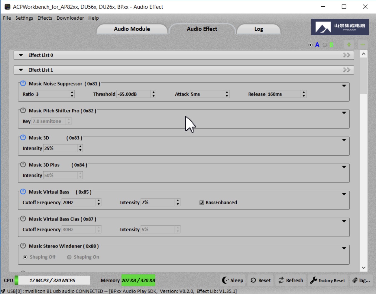

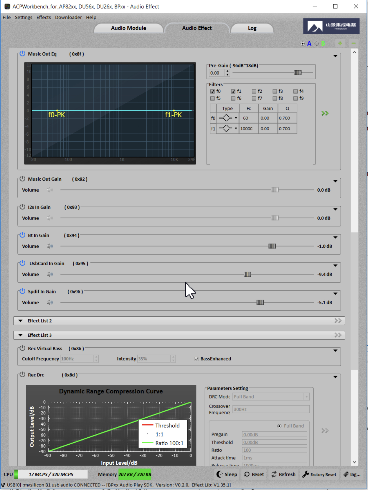

I have received the boards, and it has some cool features. I chatted with the seller and got their version of ACP-workbench sent to my mail. Same software as Acrylic? As soon as you plug the board in the computer it switch to usb sound card mode. The software is responsive and I had no problem to make a correction eq for a pair of headphones I made.I have my eyes on a board on Aliexpress that looks interesting. Search for Nvarcher Bluetooth 5.0 DSP Audio Amplifier Tuning.
Have anybody tried it?

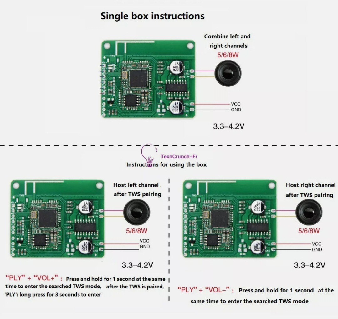

One button to switch between Bluetooth, line in, usb sound. And for a few seconds ago the seller finally told me how to put it in TWS.
Turn of Bluetooth on the iPhone in my case and press the button on the board three seconds on both board at the same time. Then the boards will present themselves as right and left channel.
The fun can begin!
Many questions to be answered, how the eq on one board will affect the other, can it be used to make a two way per board?

So far only played audio thru headphones, noticeable hiss when the source is changed to line in without anything connected on the input but other than that I have nothing negative to report so far.How is the noise ratio ?
I have now confirmed that each board have a mono output of left/right on each respective board with a classic, Money from the dark side of the moon. The pan from left to right makes it obvious.I have received the boards, and it has some cool features. I chatted with the seller and got their version of ACP-workbench sent to my mail. Same software as Acrylic? As soon as you plug the board in the computer it switch to usb sound card mode. The software is responsive and I had no problem to make a correction eq for a pair of headphones I made.
The fun can begin!
Because playing a system tuning track that literally say righ channel left channel is no sport..
If the dsp only would support processing of the individual outputs/ left/ right then these could have been used as a active crossover for a two way.

The issue I see with the TWS/Apt-X plus amp boards is that you still seem to end up with a single amplified channel even though there are two amp channels available on the board. So if you want a two-(or more)-way speaker you are stymied. Or have I read that wrong?
It does seem that the TinySine TSA6014-bluetooth-audio-receiver-tws-aptx would be a building block to get around this with a passive line-level crossover on its output driving separate amplifiers for multi-way.

The single audio channel can be routed via crossovers to all the amp channels. I'm currently using TinySine TS7800B (Apt-X) boards (2 X 50W plus 1 X 100W) in 3-way speakers. Each board has the same crossover network which divides the single audio channel into woofer, mid and tweeter outputs.The issue I see with the TWS/Apt-X plus amp boards is that you still seem to end up with a single amplified channel even though there are two amp channels available on the board. So if you want a two-(or more)-way speaker you are stymied. Or have I read that wrong?
