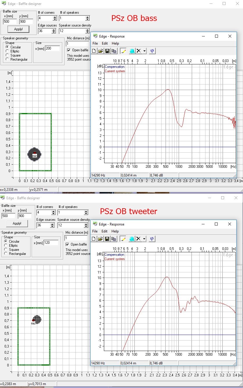

An open baffle radiator gives dipole radiation pattern only up to certain frequency. The constructions in this thread are mostly based on a quite large and flat baffle that give dipole pattern up to some 500Hz when hanging in free-air. Placed on the floor even that is disturbed.
Look at Edge simulation of PSz's OB. Some challenges for lower bass and 600-2000Hz range...

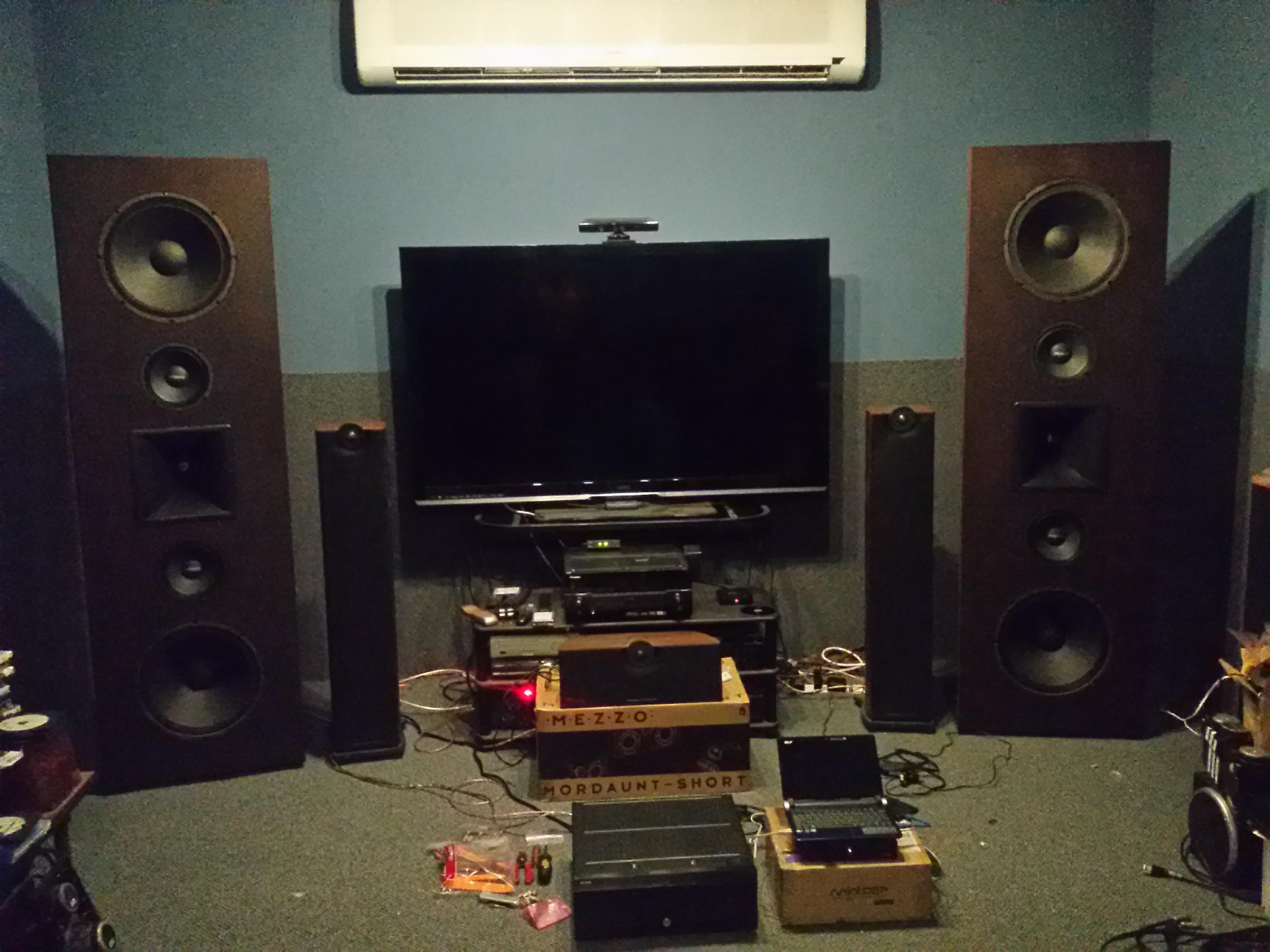

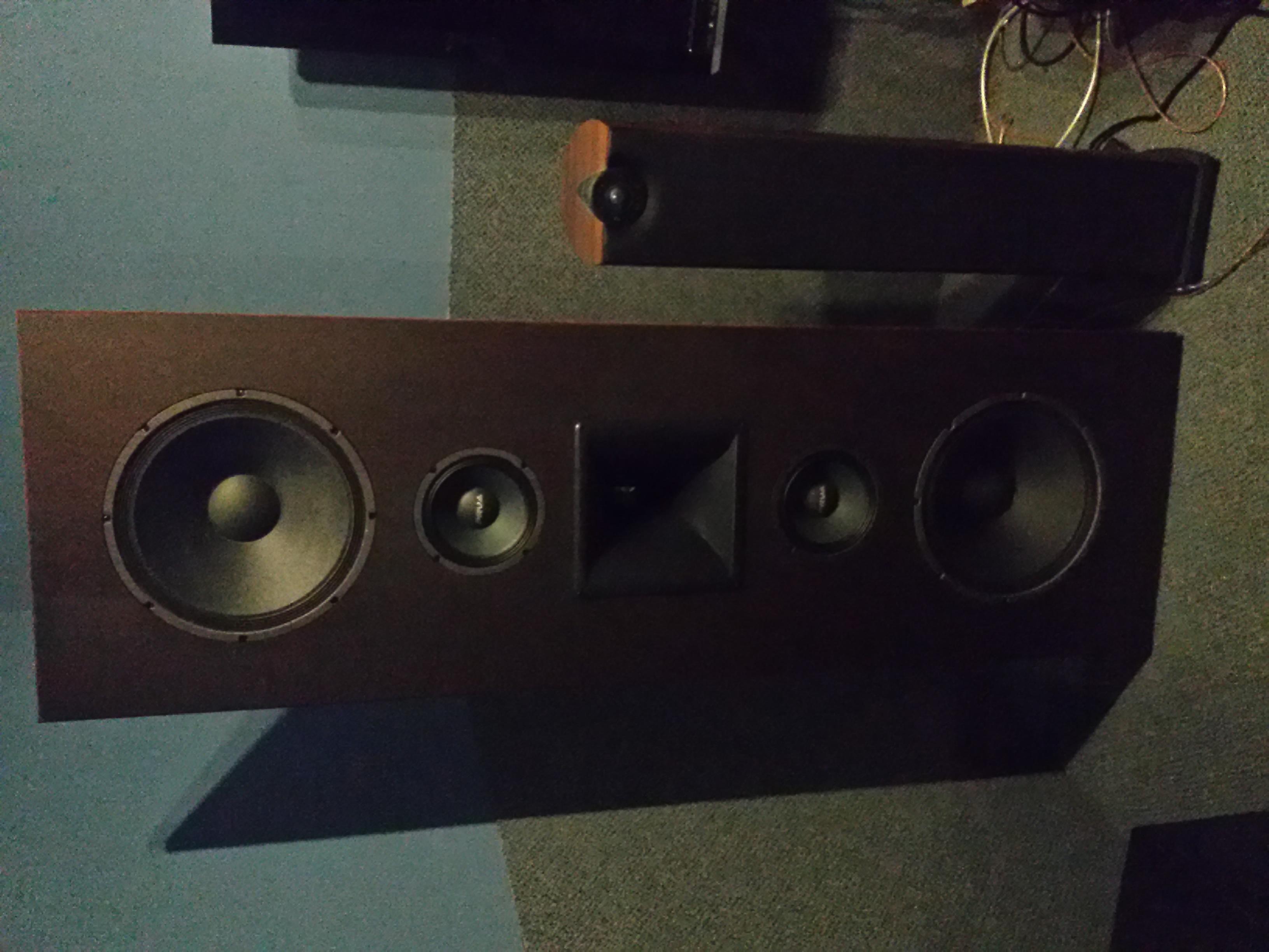

Spatial Audio X1
Not bad looking. Around $10k domestic and $12k outside of the US.
I wonder how waveguided compression driver which has open back will work in the room.
The appealing part is: "The entire spectrum above 300Hz is reproduced by a low distortion compression driver/waveguide assembly of the highest quality available.|

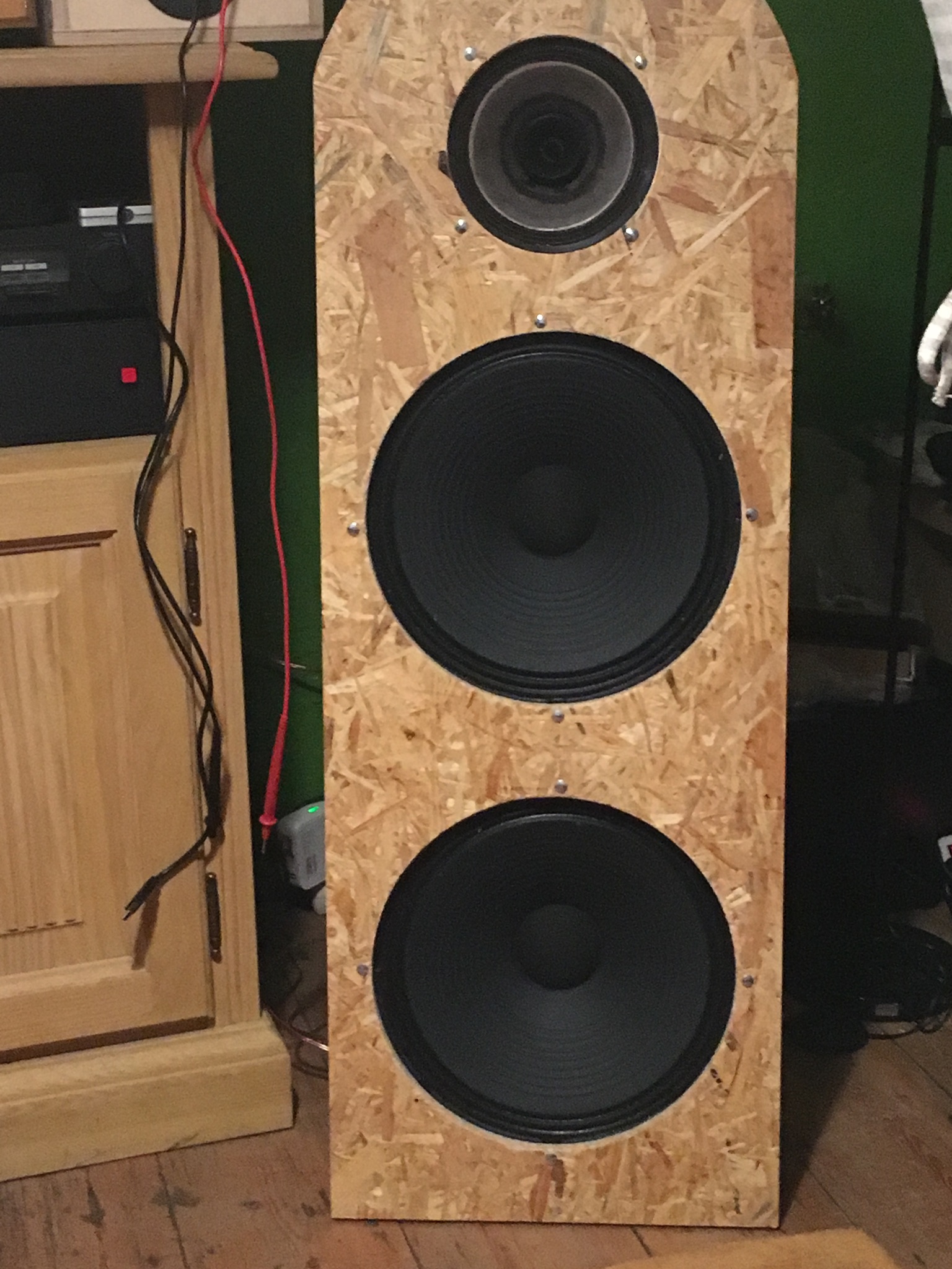

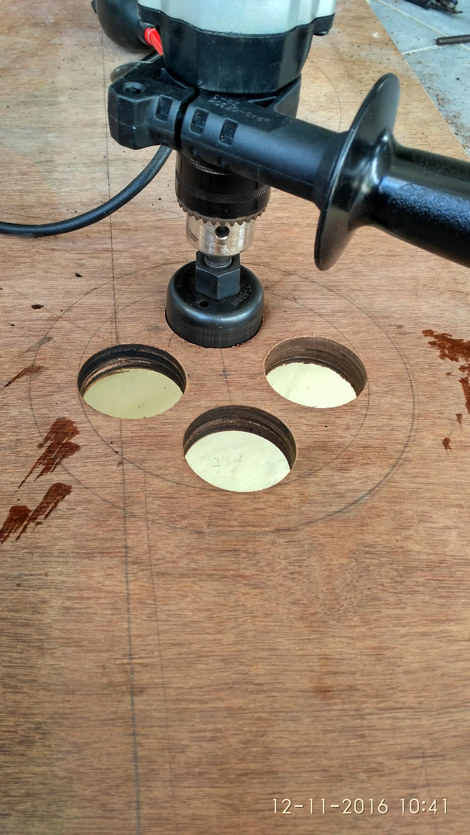

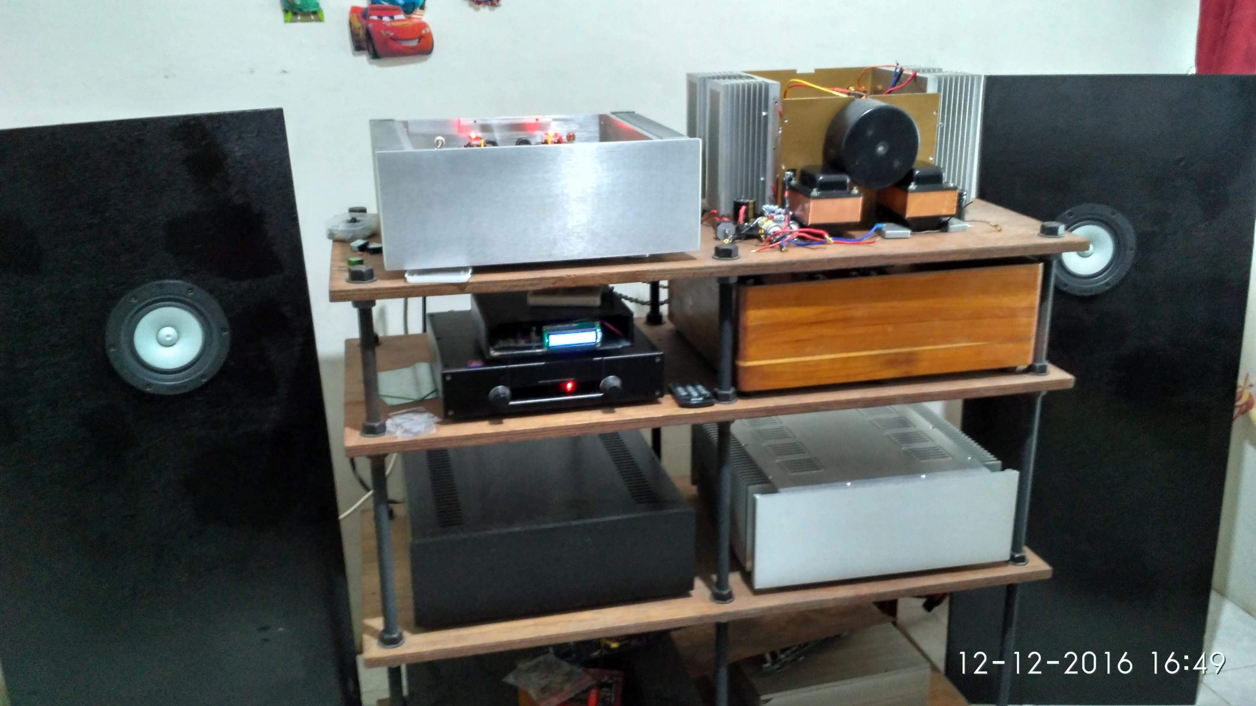

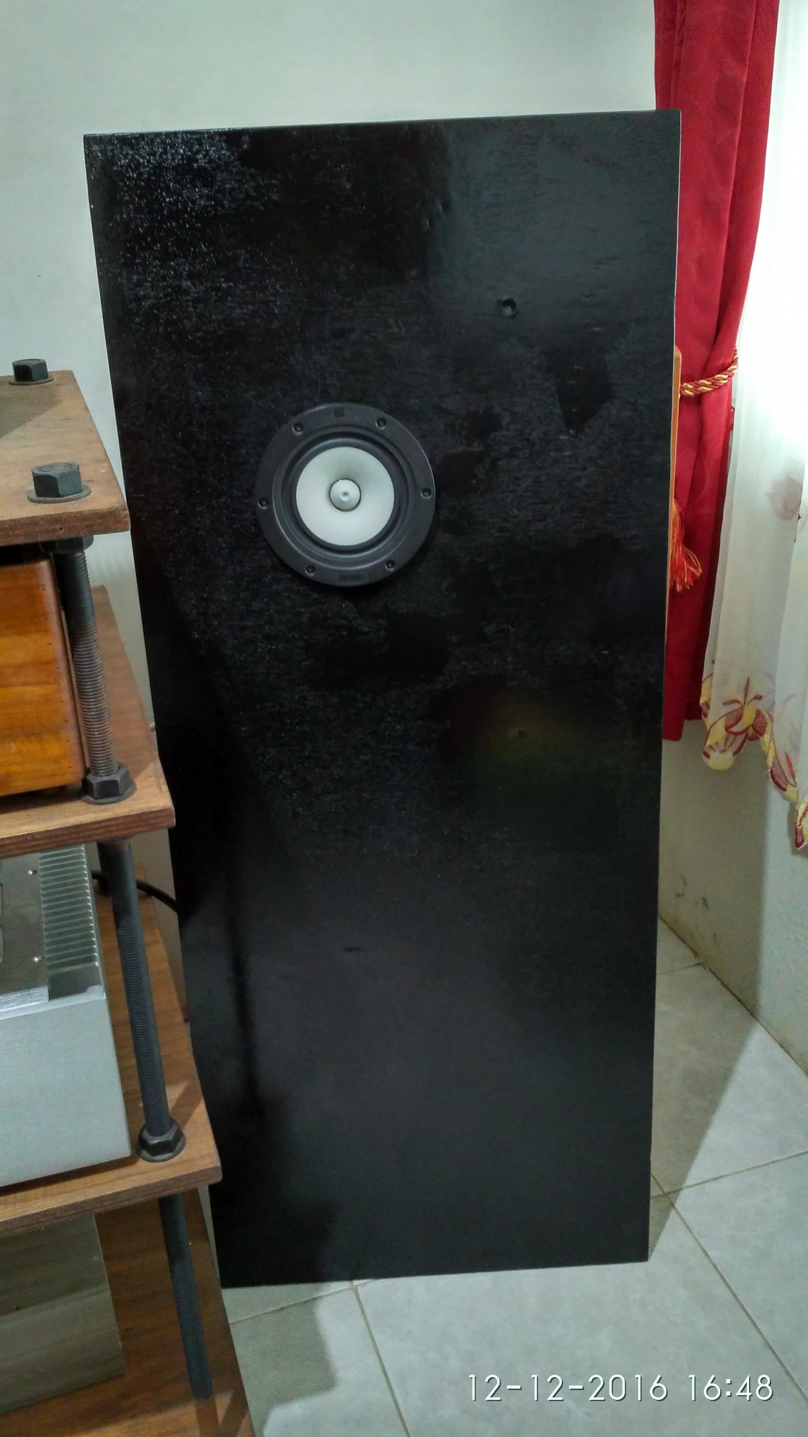

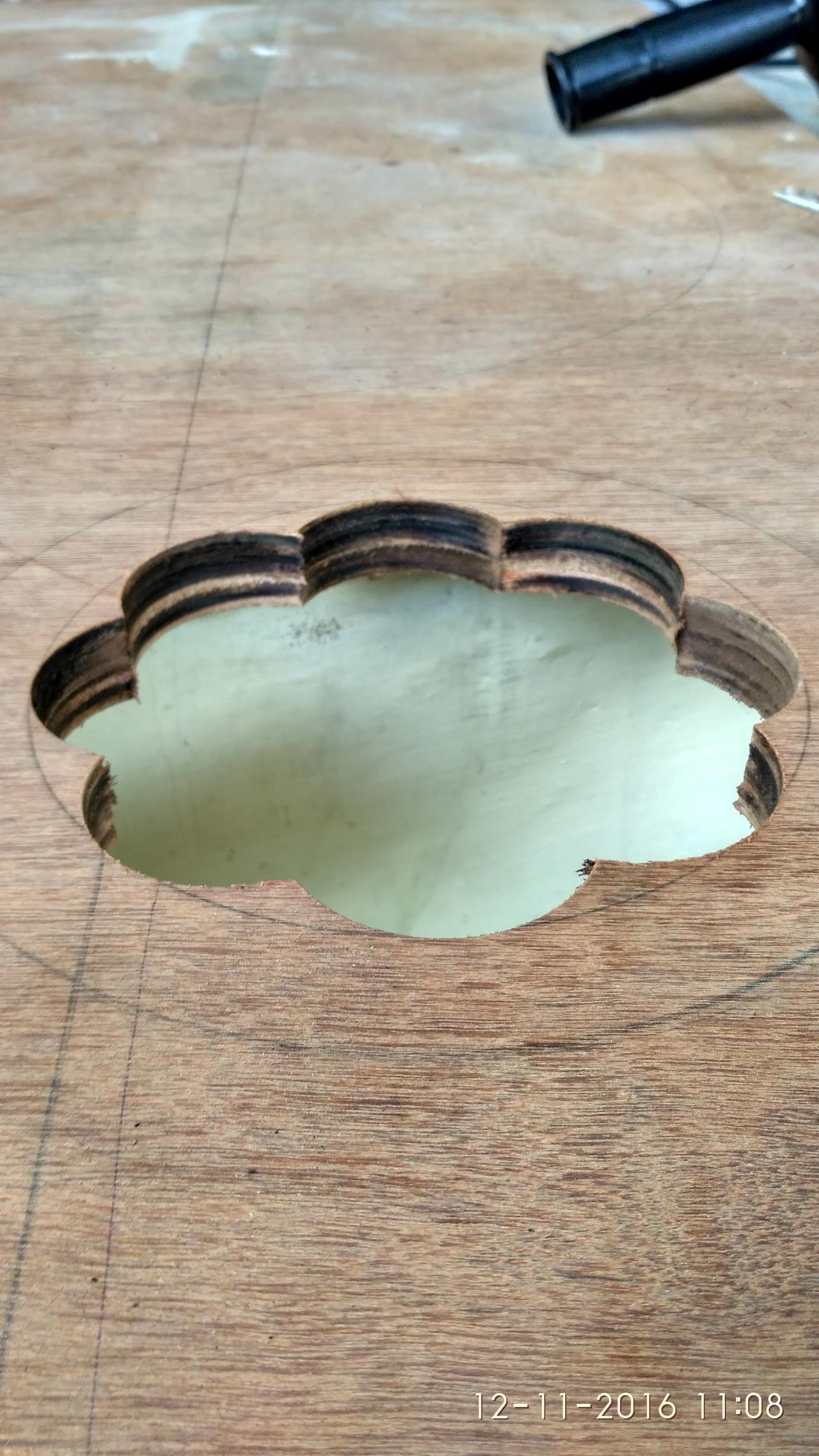

lack of proper tools, I only have hand saw and hand drill but doing this slowly still i completed this 18mm plywood.
Alpair 10p on Open Baffle 50cm x 120cm, my plan is to put a pair of Eminence Beta 15" at the bottom.
Good plan!

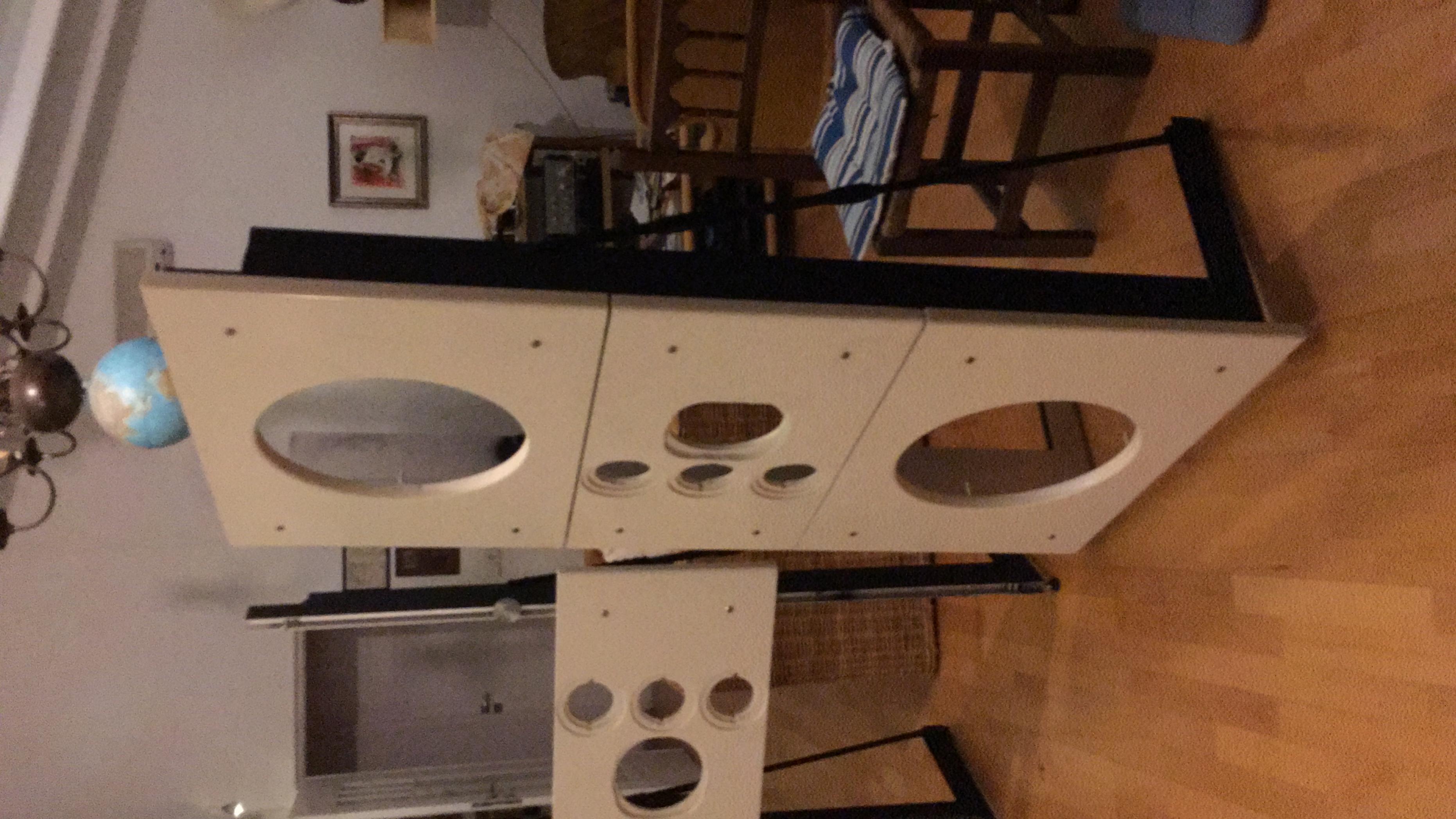

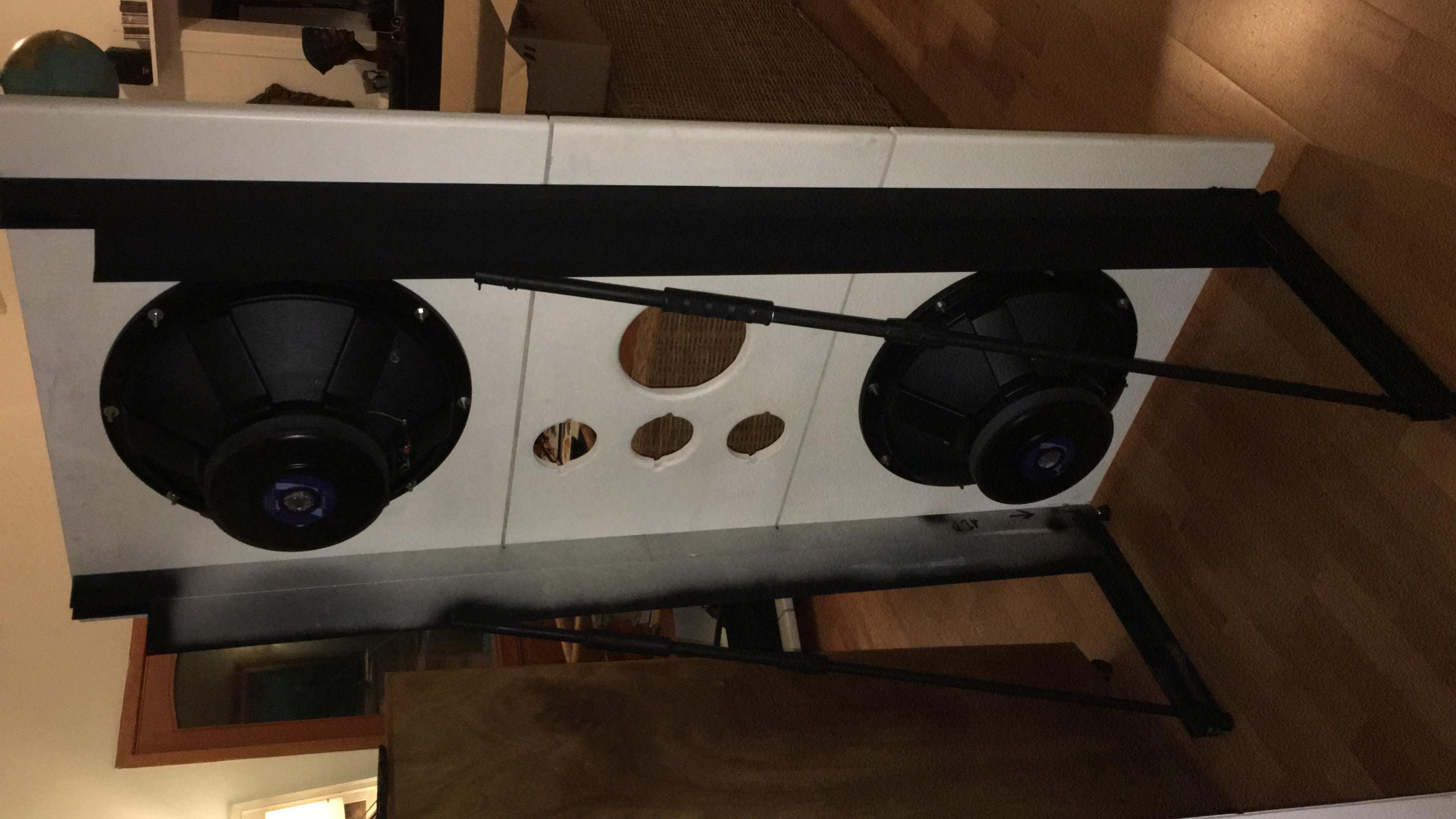

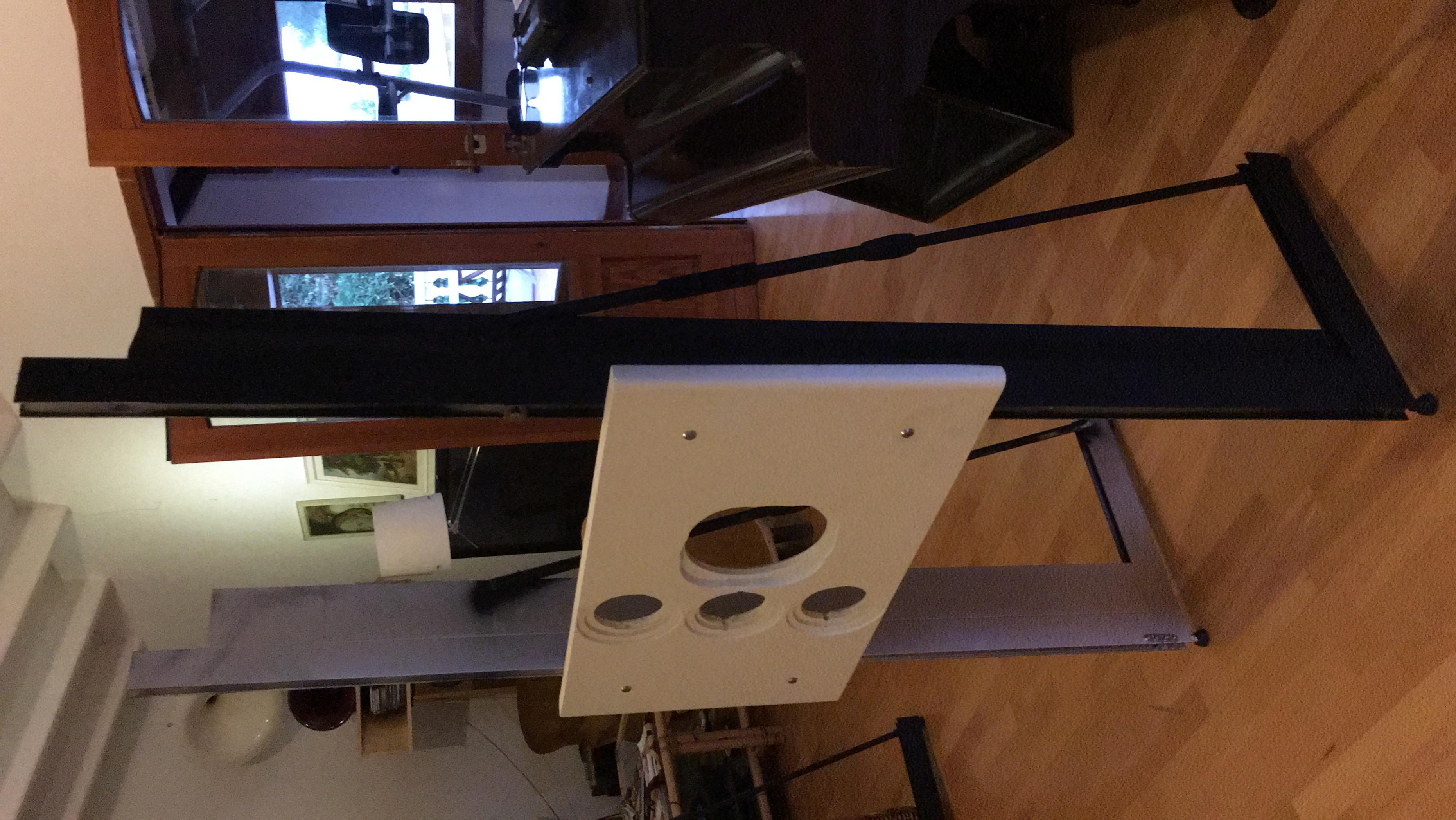

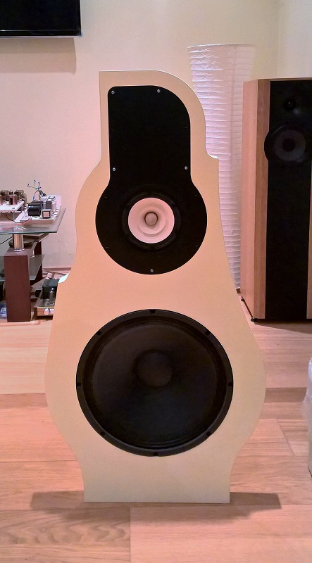

I did mine using double 21 mm plywood glued together. The size of the baffle is 48cm x 117cm and there's two Eminence Beta 15"s on the bottom and a visaton B200 for the band from 300 Hz upwards.

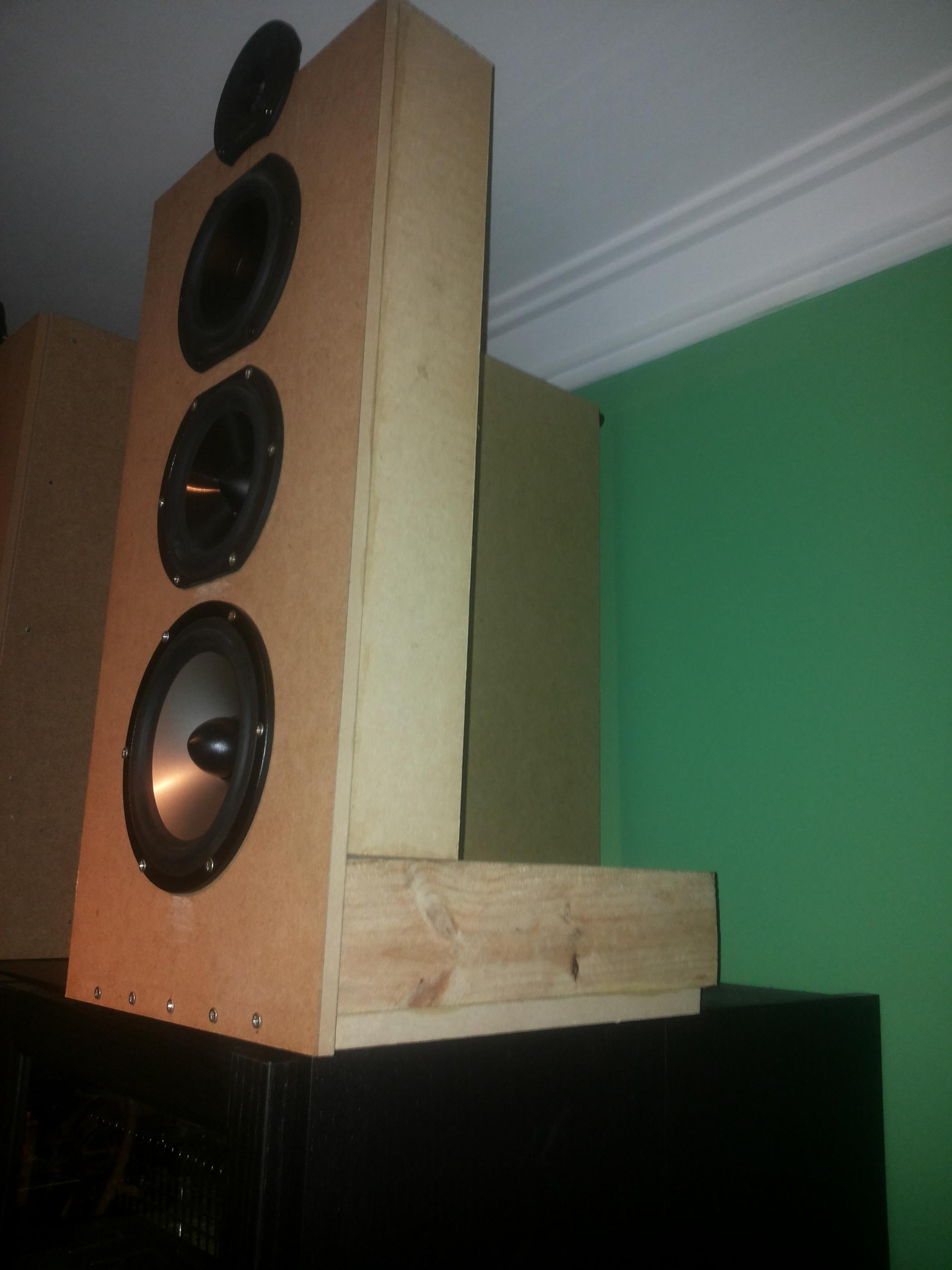

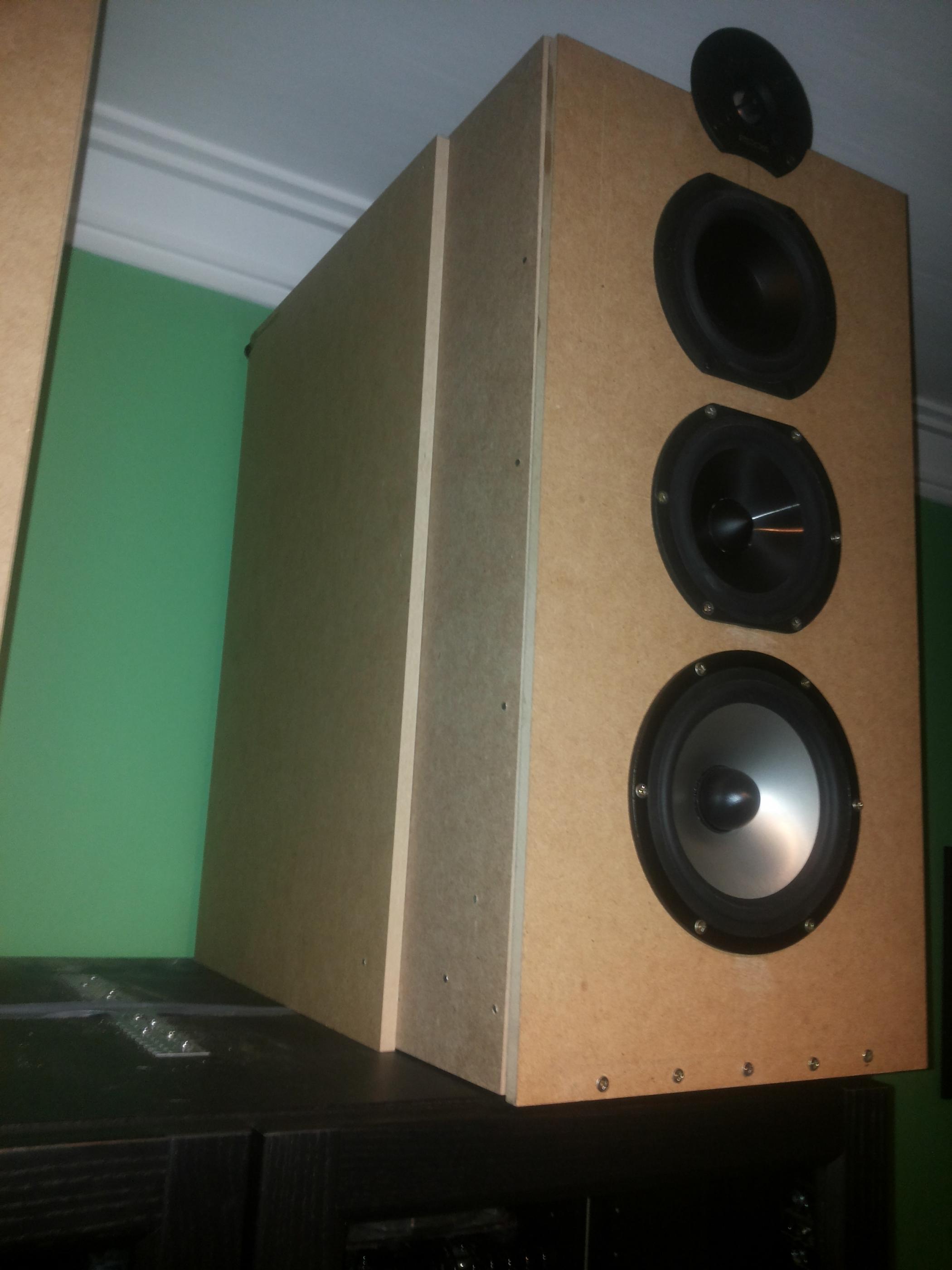

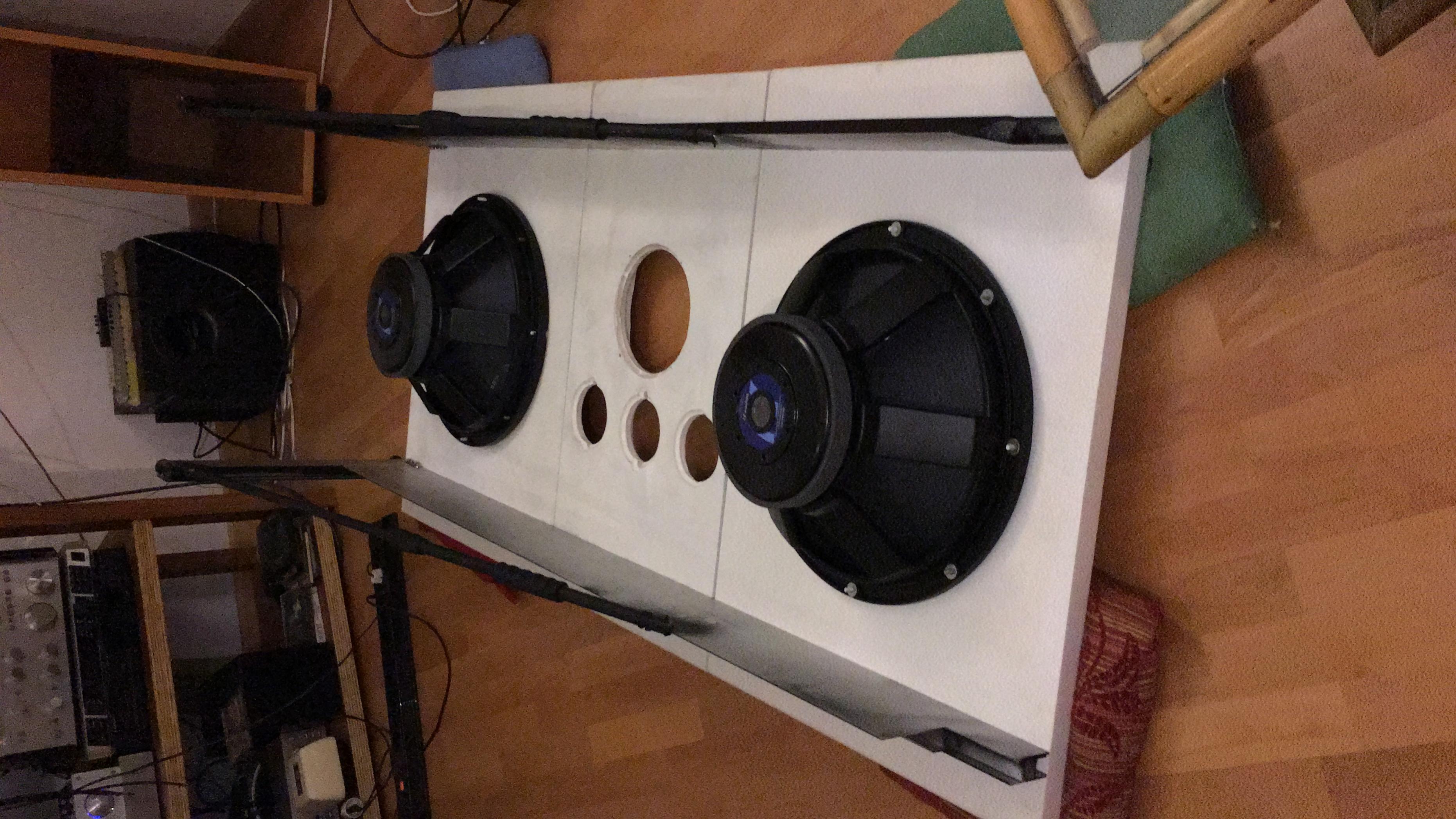

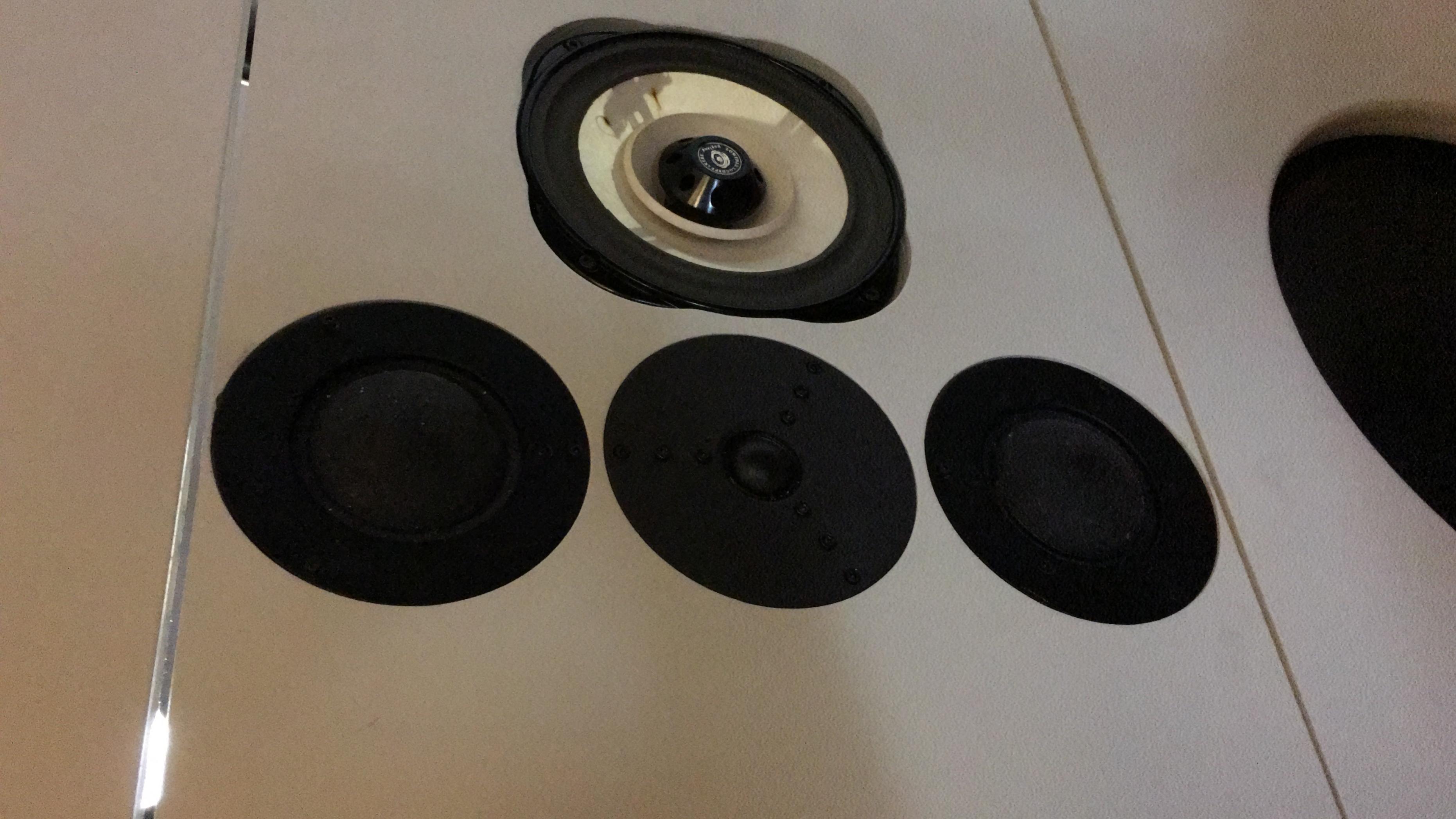

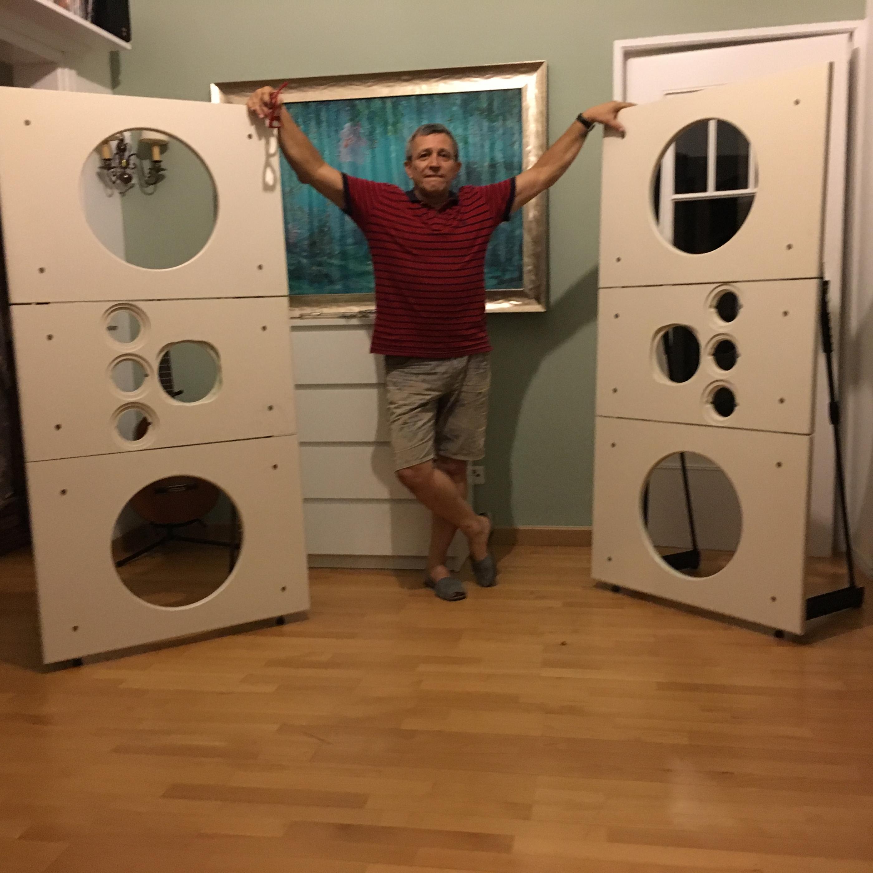

OB in construccion
IMG_4207.jpg This is a part of the construction of a OB.
The panels are removable and in the middle is possible to chose between the MTM with Dynaudio D76/Esotar/D76 with the Lowther DX3. Or replace for a horn system with TAD. The crossovering is with nanoDigi.
