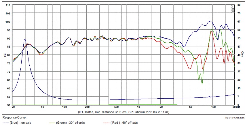

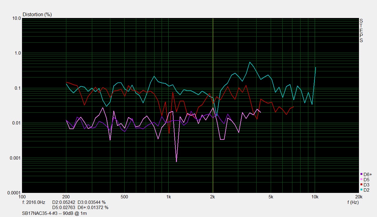

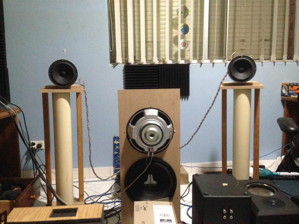

These are my early stages of messing around with dipoles...
These don't make sense and break the rules on paper.. full range 6 inch hard al cone driver, baffleless, I would imagine a very messy CSD plot...
however, because DSP is amazing I can get this speaker +-3db on axis from its xover point to 16khz. (not that this fixes resonance issues or anything..)
HOWEVER,
listening tests - my golly gosh! the most extraordinary, stunning clarity I have heard from anything -period. Not a trace of a muddy sound, sharp stereo imaging, very dynamic, super musical and a sound stage you get awed by when putting on a good recording. Very nonfatiguing - and I can see these rigid cones really pick up a lot of microdetails. I can hear some resonance issues in the mid-high treble range which would also show itself on a CSD plot.
For now just very temperamental - a very happy man with some cool stuff planned. 😎
Attached - my little system, distortion graph of this amazing drivers and the original , unequalised response.

I can't see any tweeter from this setup?

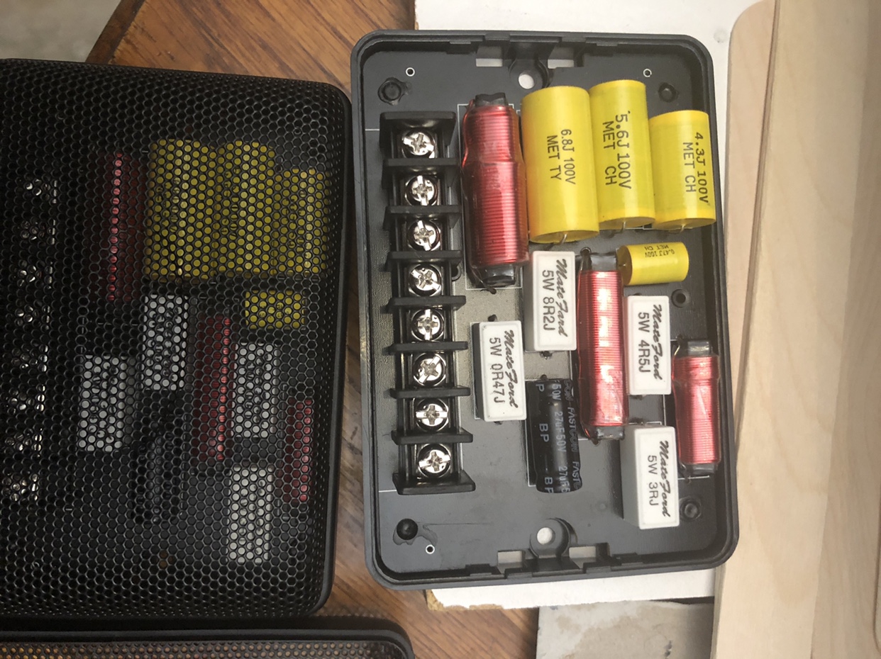

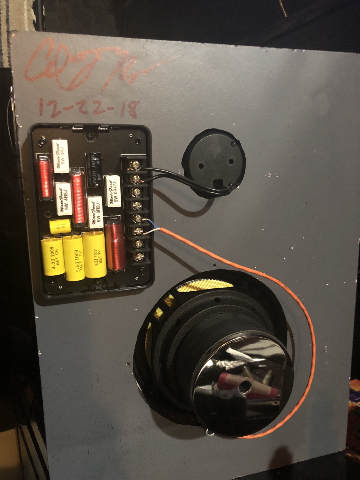

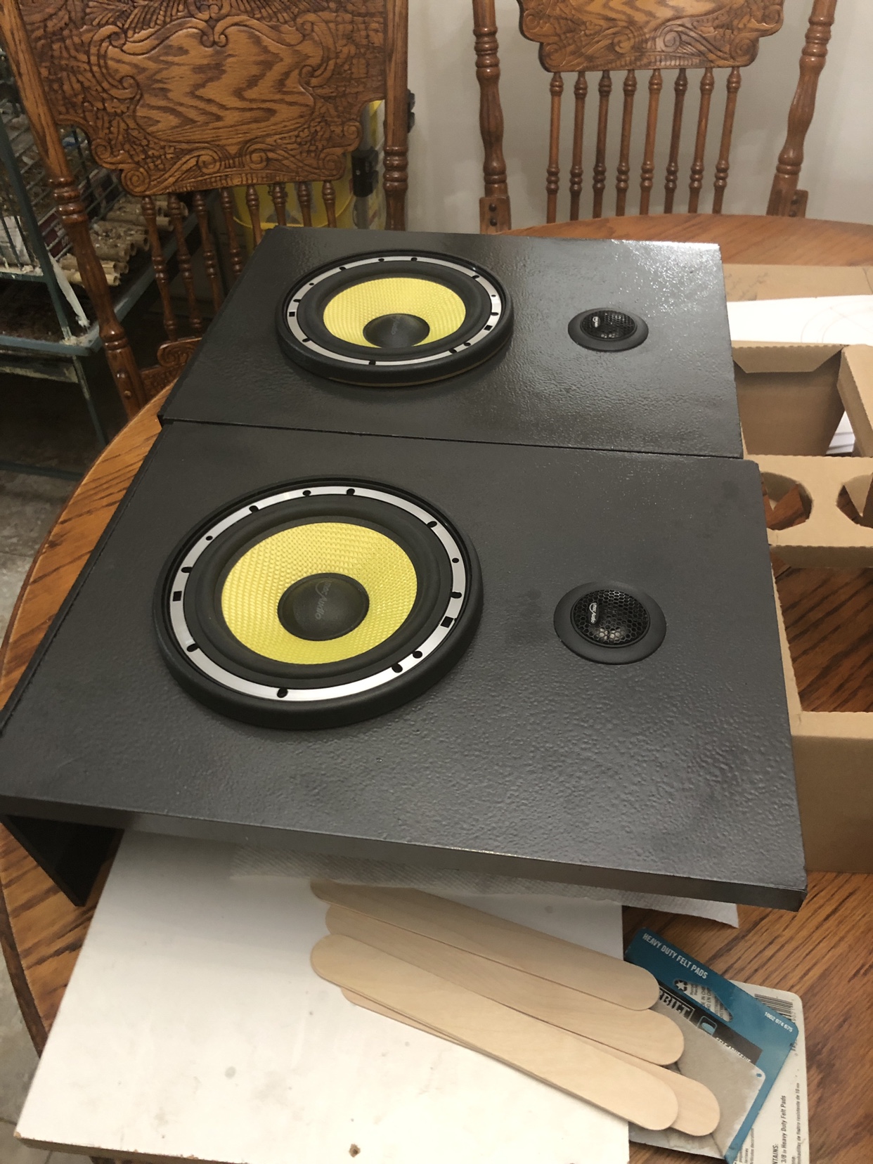

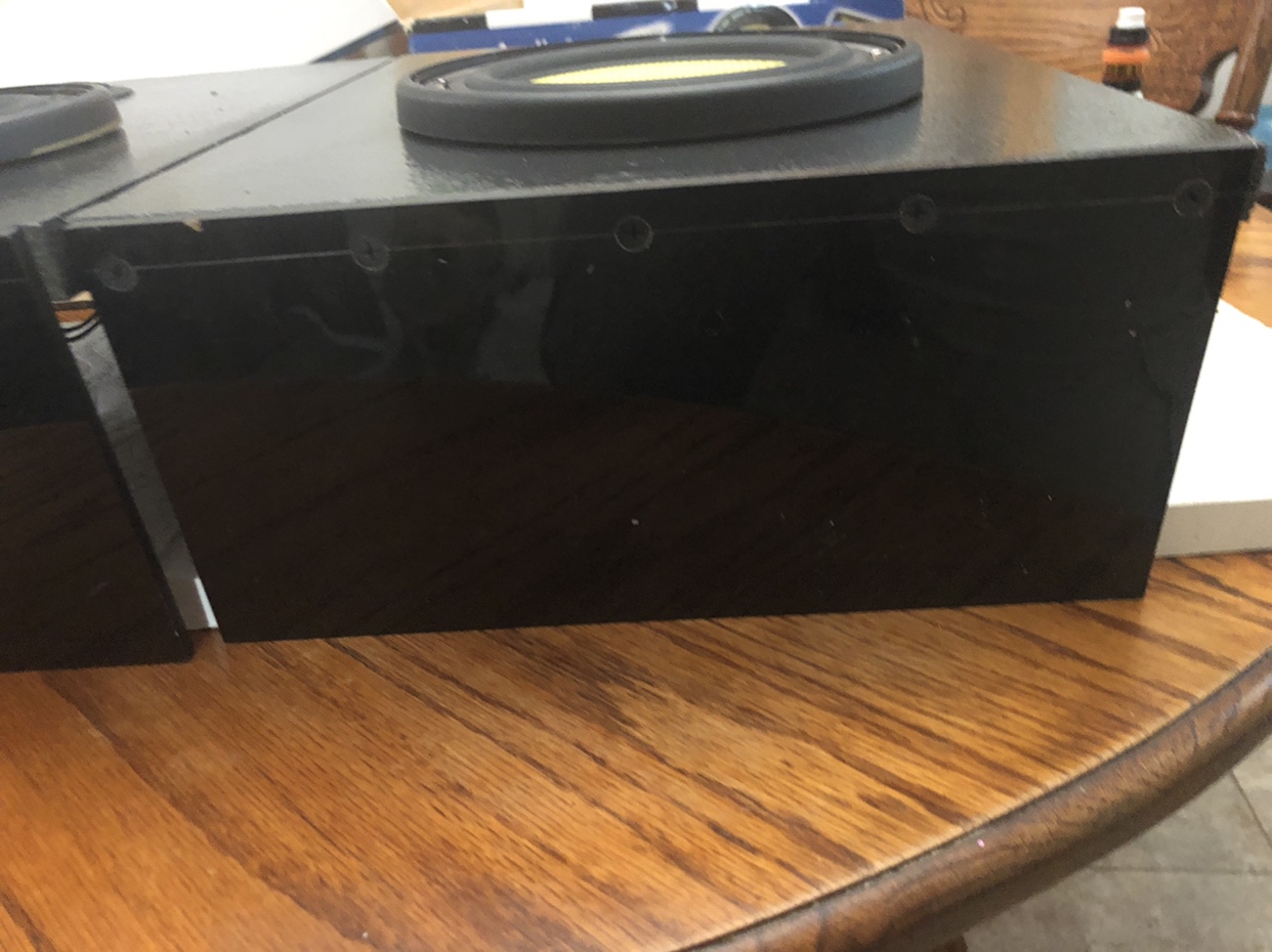

I e started this build from a set of 2way German made car speakers. Specs are 30hz to 20,000. I just made the stands to burn them in and see how they sound. Any ideas on what I can do to make them get the best sound out of them? I have not hooked them up yet and I do have a dsp unit I can hook up to them to mess with the response of them
Any way. Here’s some pics. Just be easy on my. First try at OB speakers and just wanted to use what I have laying around
They are on a stand that has them leaning back just a very small amount. Just enough to keep them standing up and not falling over. And I just used what ever wood I had laying around
What specs do I look for on mids and woofers for OB setup?
:soapbox: *IMO* The best approach is this:
Start with a full-range you love and could almost live with all by itself...
(don't "cheap-out" here)
Then, add woofer and tweeter.
Probably, you'll soon want more bottom end and top end.
The "full range" will really be a "wide-range", and used essentially as a mid.
Next, find a woofer and tweeter of similar sensitivity... (the closer the better!)
With this approach, you wind up with a "full/wide/mid" that yields most of the music...
Just adding augmentation at top and bottom...
Keeps crossovers/filters out of the "vocal range"... the range where most of the music is.
The woofer specs are:
BIG!
High(ish) Q
High sensivity is "helpful to the cause"..
No box to yeild deep base... that's what the big and high-q are for...
Sensitive because an "insensitive" woofer will struggle to produce the large excursion needed with no box, and which is inevitable with no box to offer resistance.
Think "lots o' watts"..
Hard to find hi-q woofers that are inefficient anyway.
Low FS is always nice.... :sly:
Tweeter will likely need some sort of lens or wave guide...
(unless it's "built-in"... or on)..
I happen to prefer ribbons....
But others prefer other things..
The crossover will be the fun part.... :yikes: :scratch: :xfingers: :headbash: :yell: 😎
