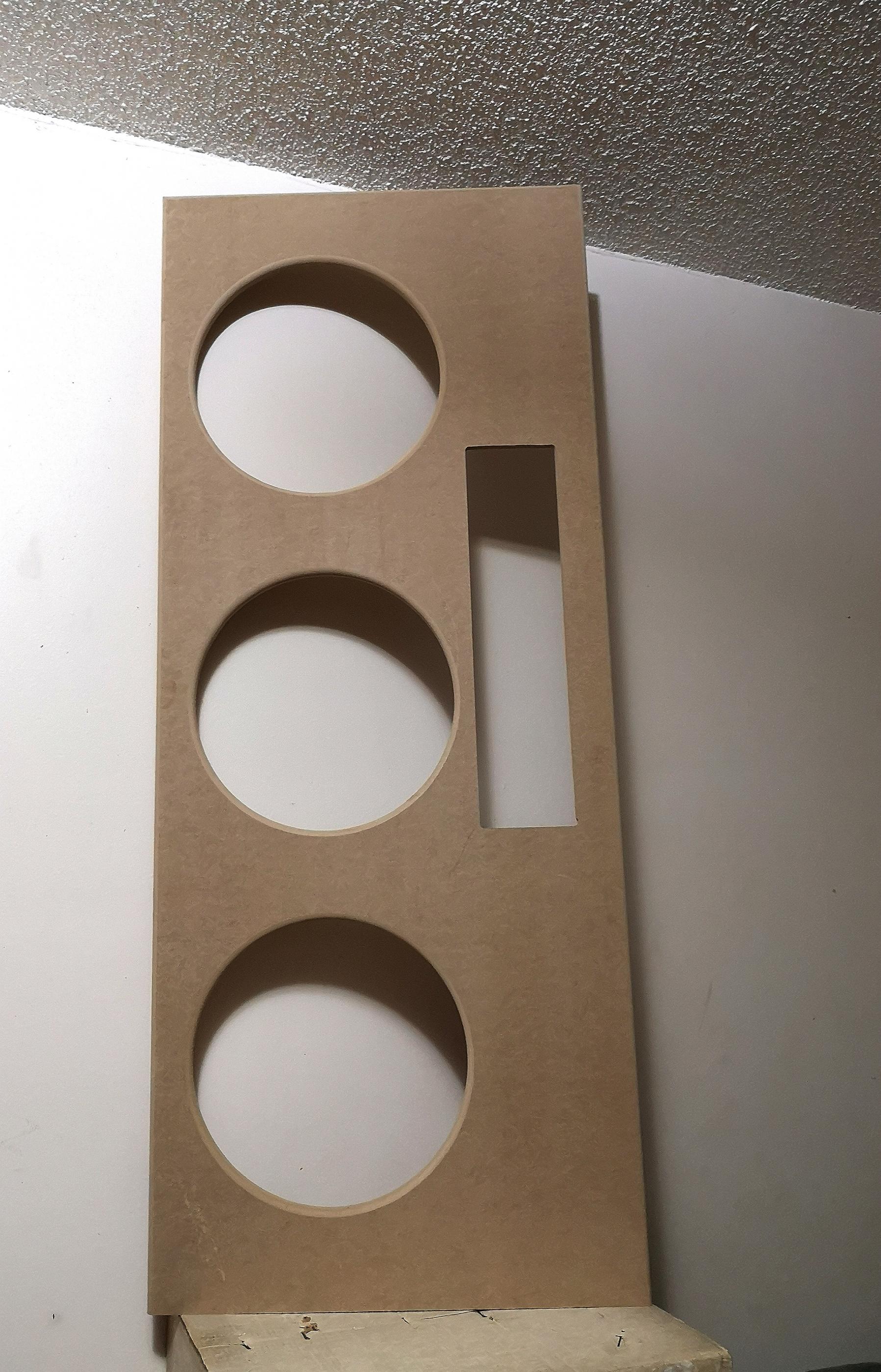

Sort of winging the baffle size for this.
Tested the concept with a 16x48" baffle, with the midranges and tweeters just screwed to the side of the try baffle.
Still awaiting delivery on a second pair of Neo 10 Bohlender Graebeners.
Still awaiting delivery of 4 Celestions 1525e-4, 15 " woofers.
Made two of these tonight, but I'm too lazy to cut out the tweeter holes.
The plan is, a Neo 8 ( I think mine are PDRs) splitting treble with a Neo 3PDR, 1 slope passive at 6000 Hz, actively crossed 4 slope to two BG Neo 10s, at 2500hz, actively crossed to the woofers, also 4 slope, at 175hz.
The two tweeters will share an amp channel, as will the two midranges, and will be vertically biamped with some nice little class a amps, 15 watts into 4 ohm loads.
The mixing of a total of two 4 ohm bass drivers, and one 8 ohm bass driver per channel allow for a few wiring and amping options, but I will start with them as a 4 ohm load, and a stereo Behringer A500 I've had around for a while.
This started out as a smaller alternative to my home made Onkens, with 511B and B+C horns.
Now they'll be a couple inches wider, and taller, at 24.5" wide, and 60" tall.
I'm hoping these will match the Onkens for dynamics, be a little smoother, and have better bass, that's less intrusive on my apartment neighbours.

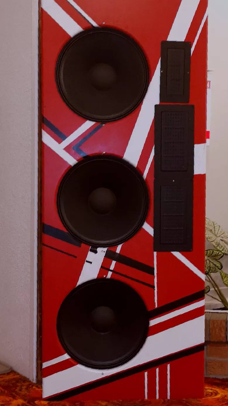

Has anyone tried a satin or semigloss latex paint on their projects?
I plan to paint my baffles à la Eddie Van Halen's guitar scheme, red field, black and white stripes.
I ask, because I'm hoping some car wax and a buffing pad will shine things up, without me needing to outsource the painting to a shop.
I dunno about car wax and buffing pad on latex paint????
Did a test, and it works fine. Not able to set up a spray booth in my apartment, and every polyurethane finish winds up with dust particles in it. This way, an inexpensive cut polish leaves a very good surface.

Van Halen fan?
Absolutely.
Plus, I didn't want another veneer struggle.
I can change this out, easily.
Sweet!
Dual 15 subs and 15 mid... must have some impact.
Got a close up of the XO plate? Just for fun!
I also use my OBs for 2-channel music, and 5.1 movies. Love the sound.
