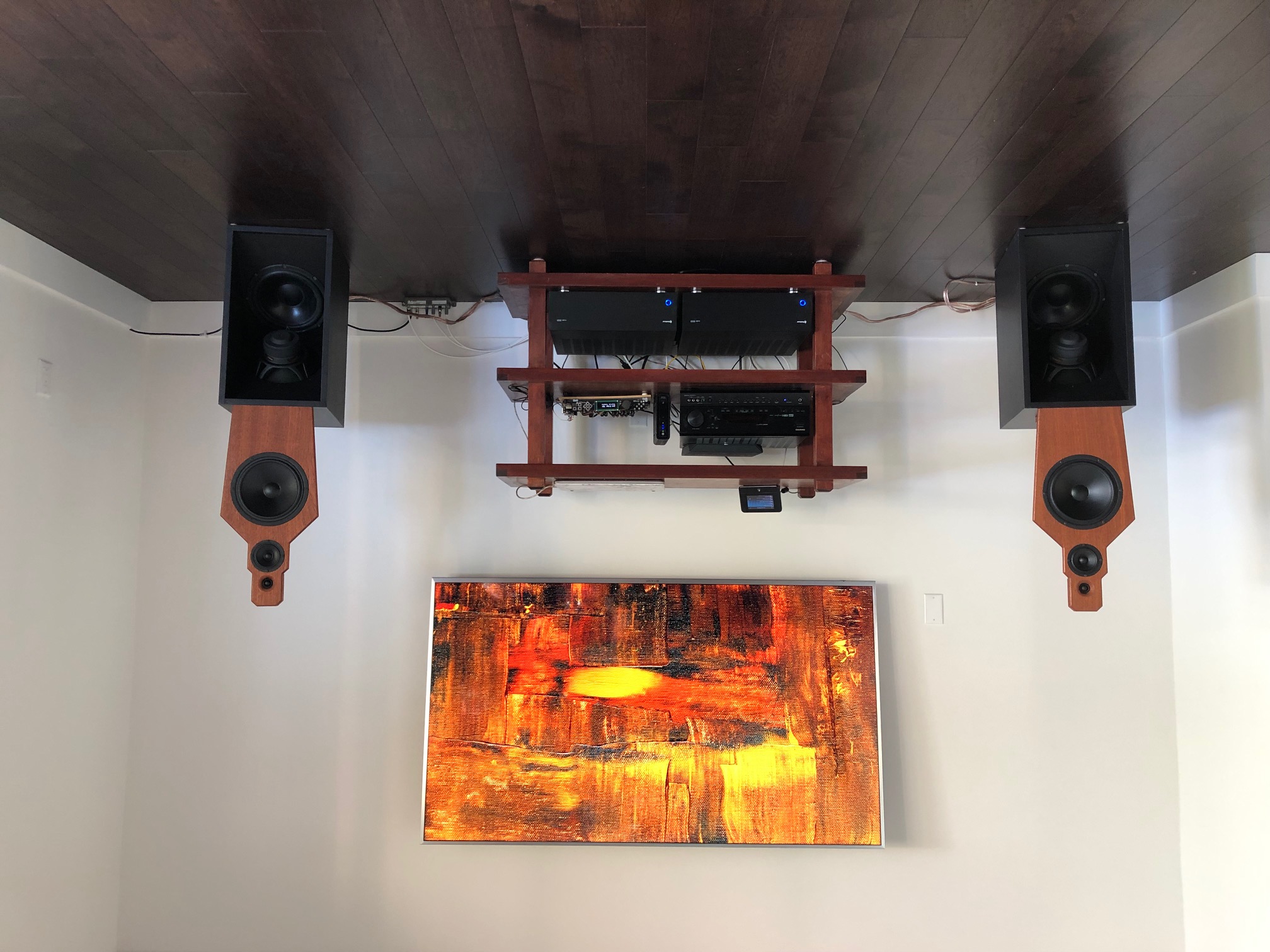

My Nao Note II RS
Built these last year and they sound great.
This is a "fastrack" setup in new house, need new furniture to include turntable and hide wires.
Najda DSP
Outlaw 5000 x 2
Squeezebox touch coax, Chromecast Audio SPDIF, receiver analog (video sources)

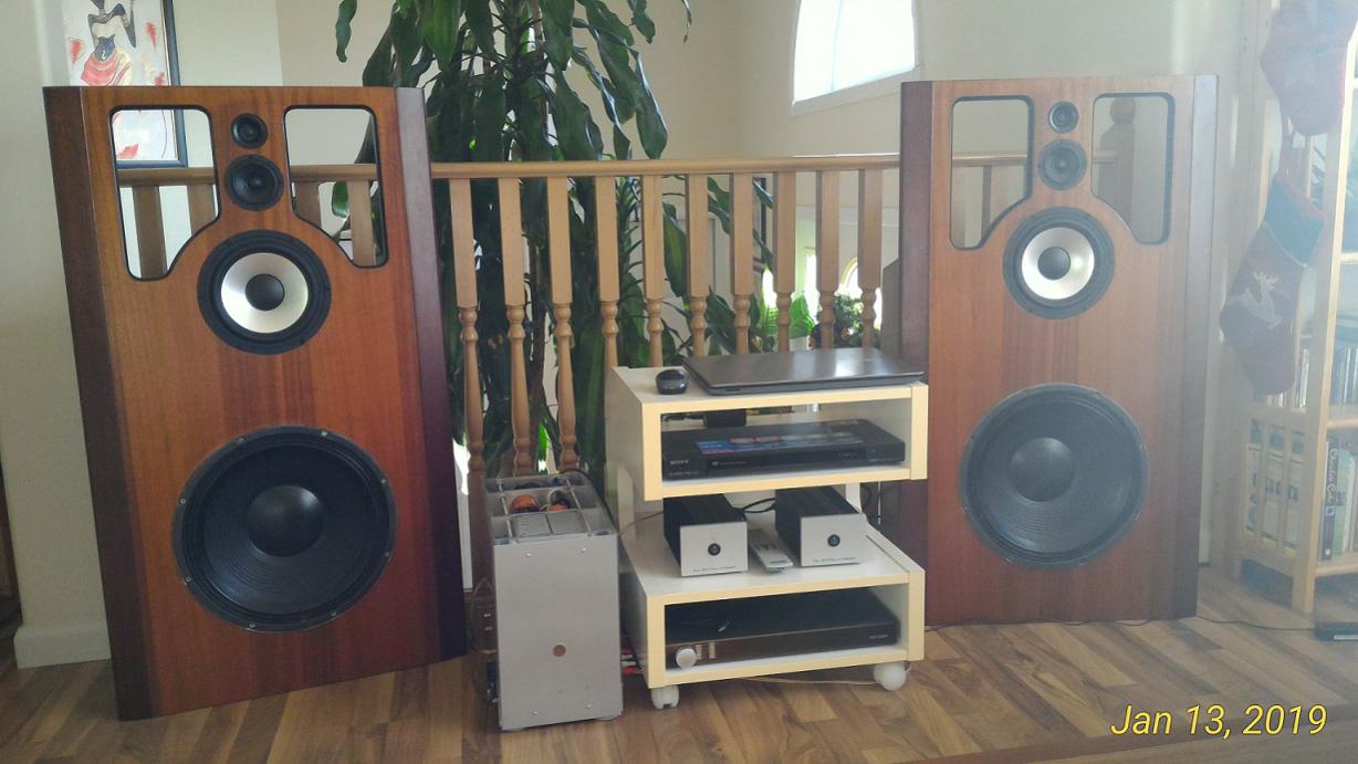

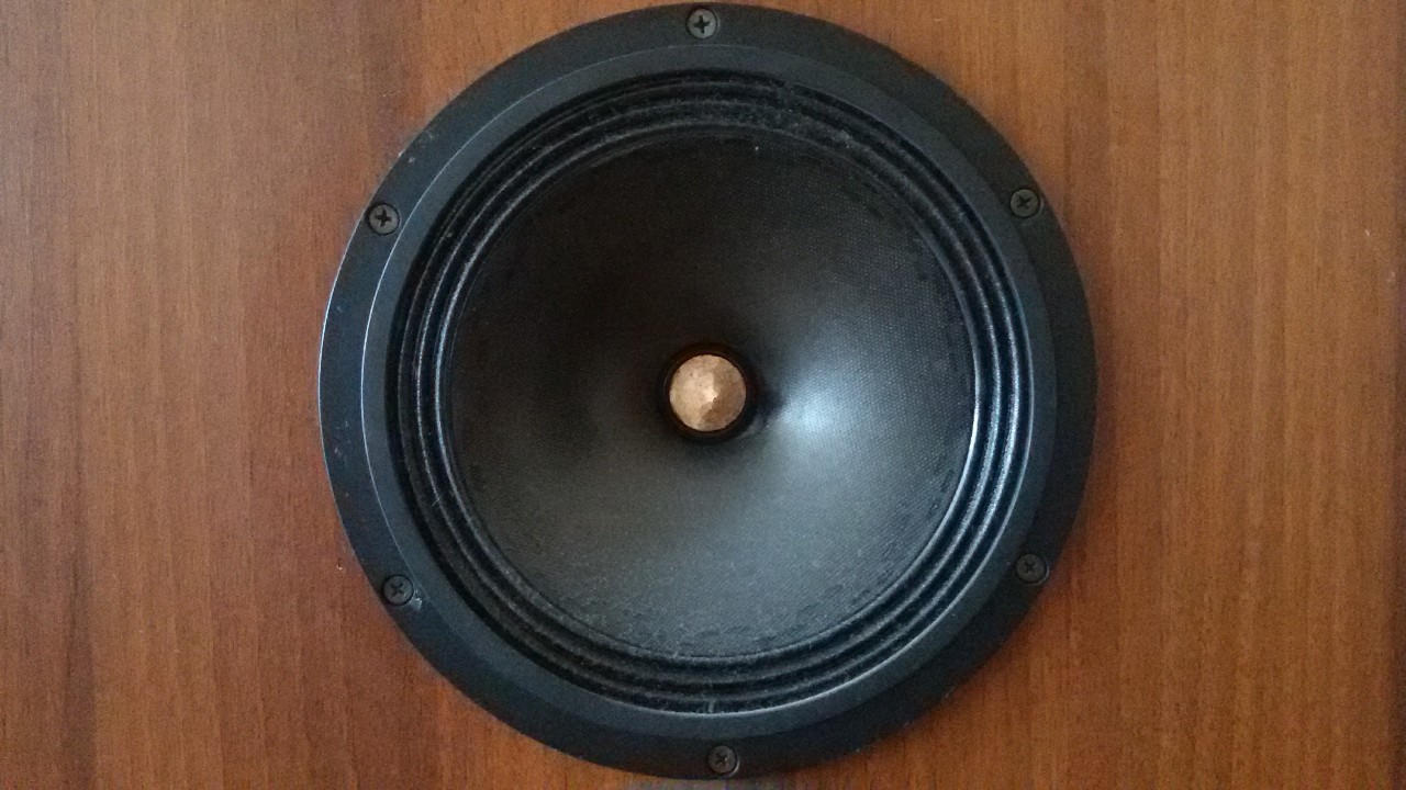

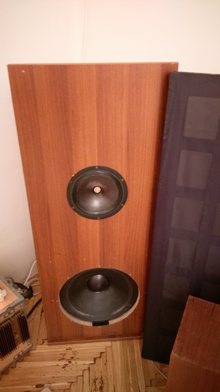

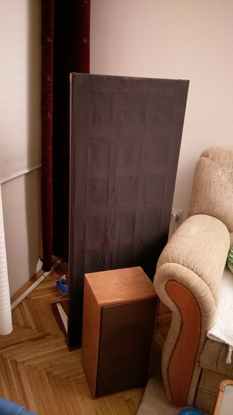

last Fall my home brewed OB got a face lift and an update: the lower mid driver changed from Visaton B200 to AL200. Wider dispersion now. SQwise: as much as B200 could sound good, with this setup one realizes that it was still a distortion that sounded good. Now it sounds both more accurate and still good (better); with good recordings of course (disclaimer).
The active Xover had to change quite a bit. They are still operated as a 3-way. I may still implement the tweeter passively, though I cannot hear up there but maybe for the kids and the neighbour's dog
. The star of this setup is the 4" Scanspeak which is such a fantastic driver. With AL200 under, the small SS got an even bigger role to play and still does the job with no signs of strain.
btw drivers are listed in my previous posts:
https://www.diyaudio.com/forums/multi-way/123512-ultimate-baffle-gallery-225.html#post4970383

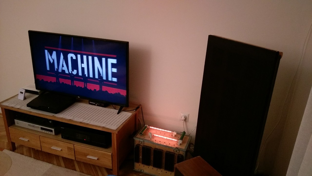

p.s. in the picture my DIY F5+ACA amp is missing top cover since the grill is being changed (the amp was overheating in Summer).

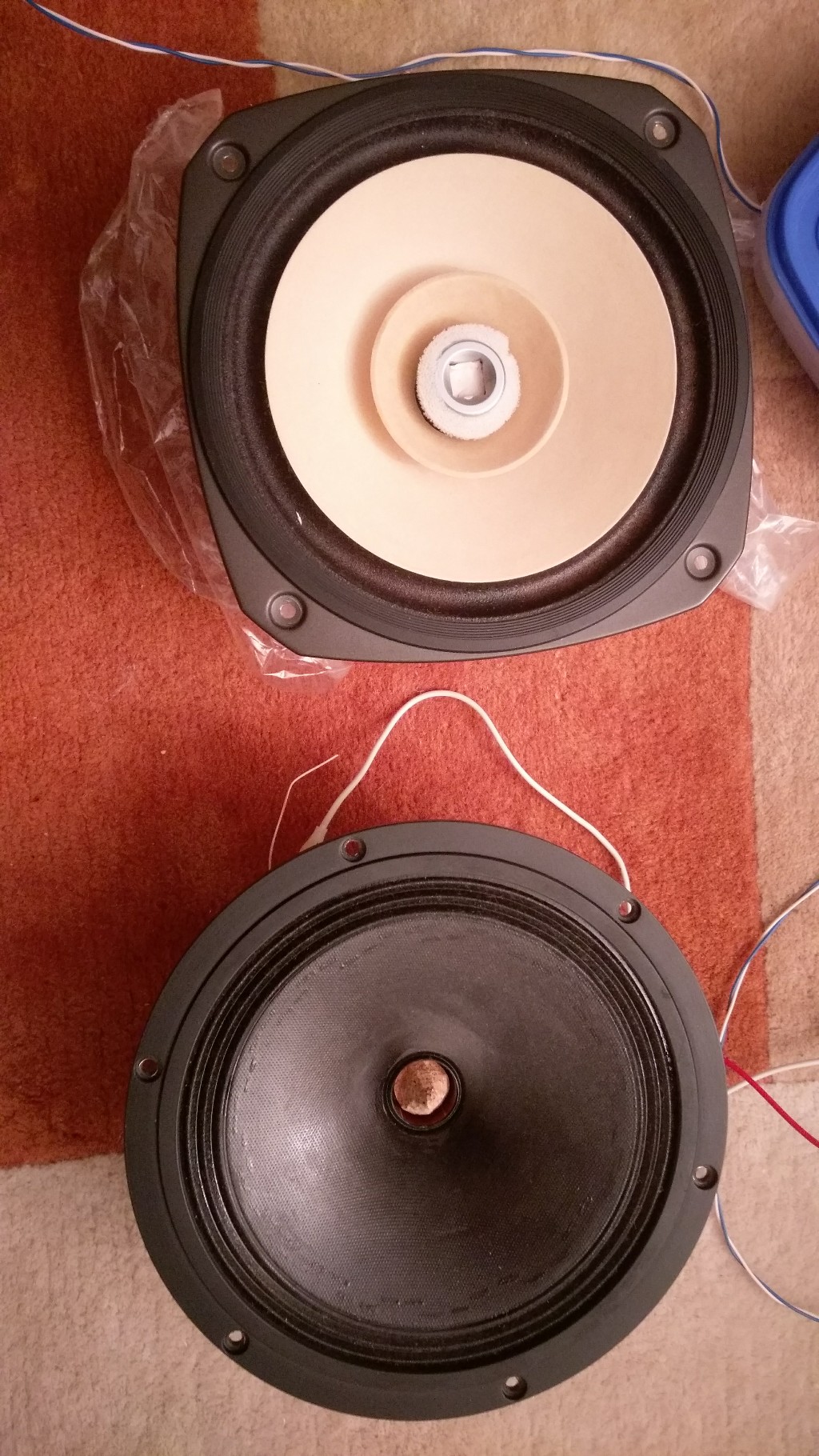

...the lower mid driver changed from Visaton B200 to AL200. Wider dispersion now. SQwise: as much as B200 could sound good, with this setup one realizes that it was still a distortion that sounded good....
Koja, nice implementation of an OB, a lot of space behind the drivers
I had also tried Fostex FE206e, but was not happy with it, Visaton sounds better in an OB...

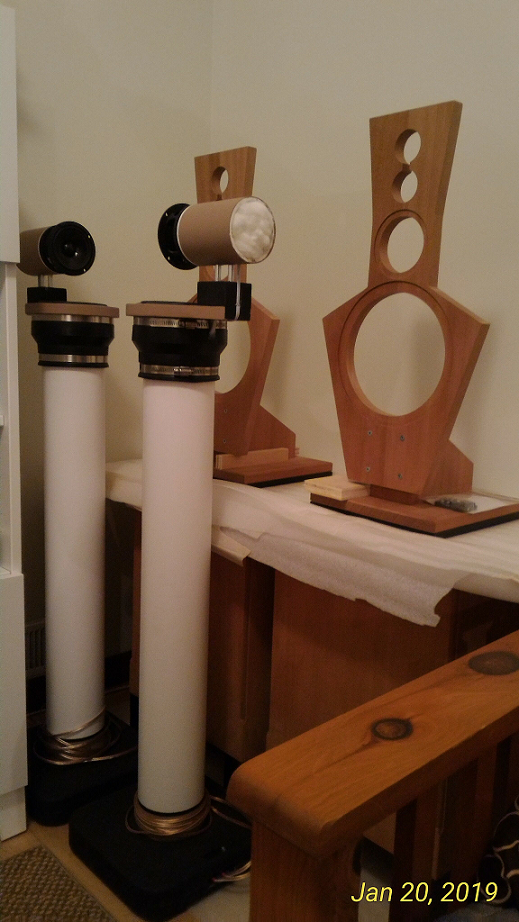

^ You are missing the reason for the baffle shape: LX521 Description
As for giving credit where credit's due: SL continues to live in my home
LXminis are currently off duty and LX521s are waiting for spring to be finished.

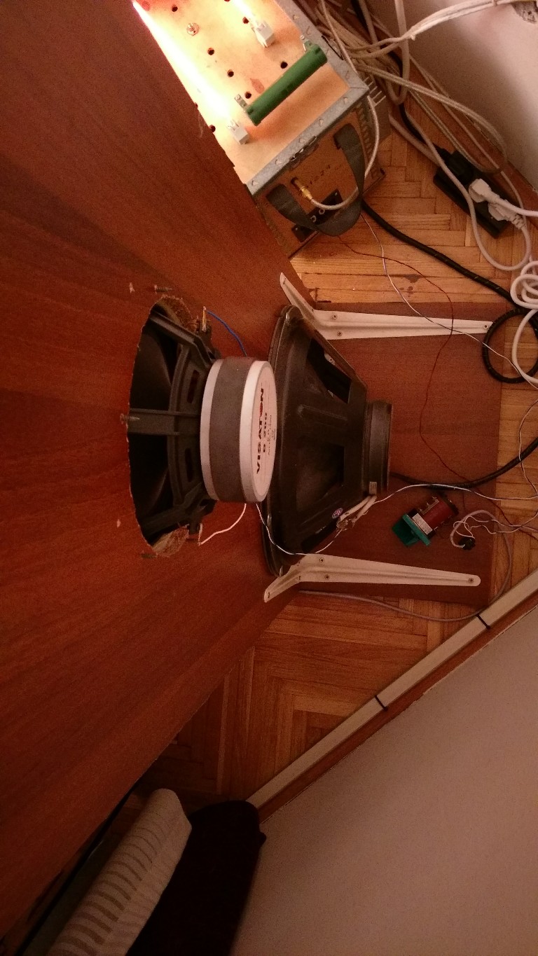

Why do you slot load the full range?
I wanted to ask the same question. I was expecting to see a slot loaded woofer, but this..I was baffled
Maybe it sounds better that way, reduces some peak or something. Easy to try (with or without slot)...
Hi.
slot loaded in in bass unit can lowered Fs and also Qts, I have a pair of OB speakers with slot loaded woofer.
Slot load a full range are totally different, as rules of thumb, the slot area should be 1/3 of Sd of your driver but I always fine tuned carefully using thick cardboard, and after finalised, I use ply wood instead.
Please read comment in youtube for further info + patent article # US2646851 (A) . Mr. Gilbert Briggs also mentioned in his article too ( Wharfedale SFB3 prototype ) . thank you.
