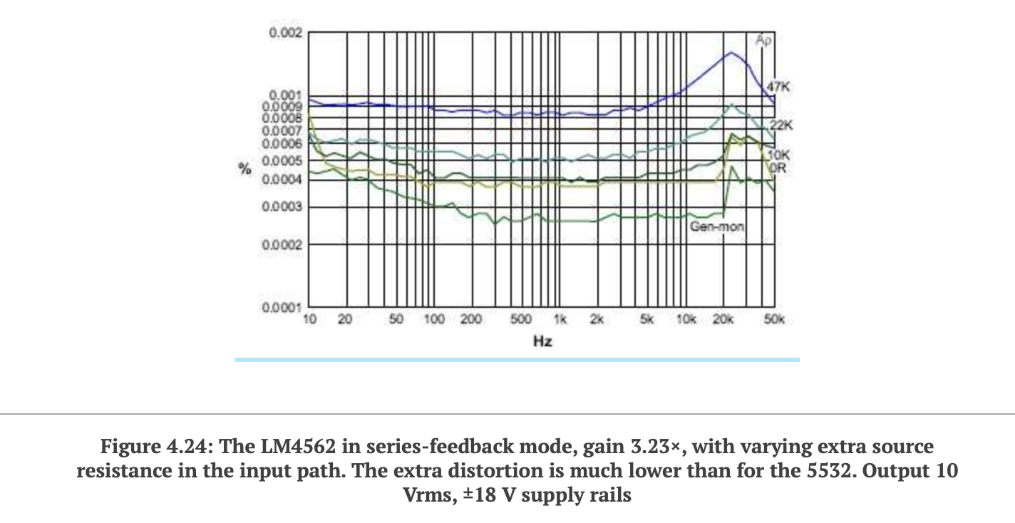

@craig: D. Self has done such measurements on the lm4562 which is used on that buffer, found here: https://www.eetimes.com/op-amps-in-small-signal-audio-design-part-3-selecting-the-right-op-amp/ , scroll down to fig. 4.24
Not unmeasurable but not very worrying under 10k
Yes - I'm very aware of Self's measurements. But common mode distortion has been known about for way longer than Self re-publicising it.
My point however is that preceding a voltage follower with a volume control pot in a buffer with exceptionally low distortion significantly compromises the distortion - and not just under 10kHz or 10k-ohms (not sure what your 10k refers to).
For an LM4562 at 10kHz, 10Vrms and 10k-ohms source resistance the distortion of an LM4562 follower is nearly 0.005%.
Basically this all kicks in seriously at around 4Vrms, although it is gaining ground at significantly lower levels. And it gets rapidly worse with increasing source resistance. So putting a pot on the input is perhaps not the best news for distortion.
But Tom is the ultimate arbiter on this - he knows his design better than your or my ideas.
Craig
Craig
True. It's also been around since before the LM4562/LME49720 was released. However, the discovery of common-mode distortion does not change the fact that the LM4562/LME49720 does not exhibit much common-mode distortion. You can see that from Fig. 4.24 in the EE Times article that 00940 linked to. I've attached the figure to save you the trouble of clicking the link and scrolling.
10 kΩ.
Douglas Self measured 0.0004% at 10 V RMS output with 10 kΩ in series with the non-inverting input. The THD+N trace for 10 kΩ is line-on-line with the trace for 0 Ω in his figure.

@Tom: the 0.005% quoted by Craig comes from further measurements by Self on the lm4562 in voltage follower mode. They can be found in his crossover book, some sections of which are free on google books: The Design of Active Crossovers - Douglas Self - Google Livres

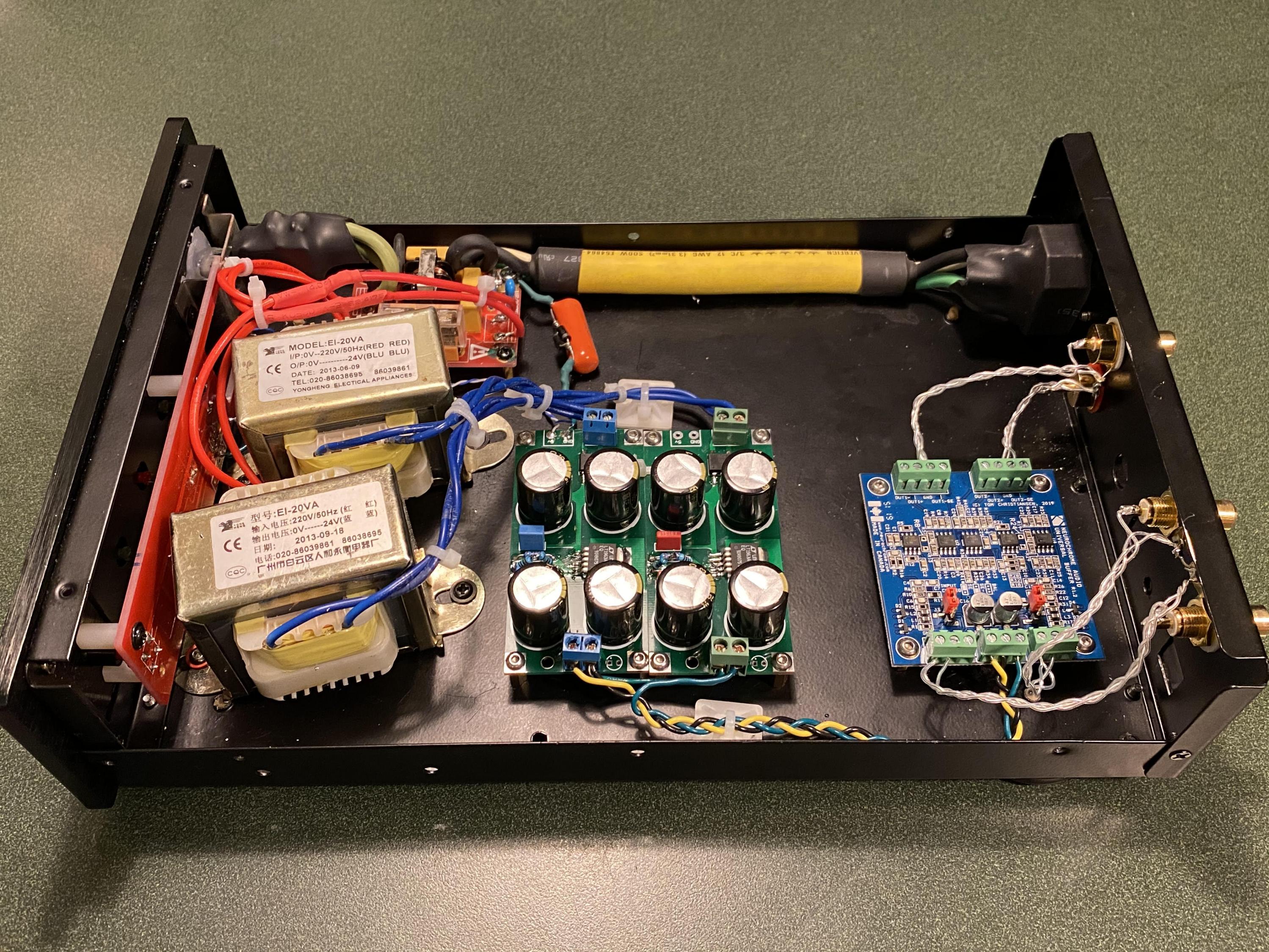

I put this buffer together with parts I recycled or had on hand. It's dead quiet and sounds nice. I'm using LT1963a regulators and a couple of single secondary transformers I picked up from a flea market in Guangzhou for a buck or two and I've been waiting for a chance to use them.
I will sit down later to compare it with my direct coupled B1, I don't expect to hear any differences but it's always fun to do.
I'm using Millet uniamp's and don't need any gain, I'm using a Topping D50s with 10 ohms output impedance and my amps have 47k input impedance. It does work fine directly from the DAC but I prefer using it with a buffer. I'm using the volume control of the DAC and it's set between -25 and -30 db for normal listening.
Anyway, thanks Tom
Anyway, thanks Tom
