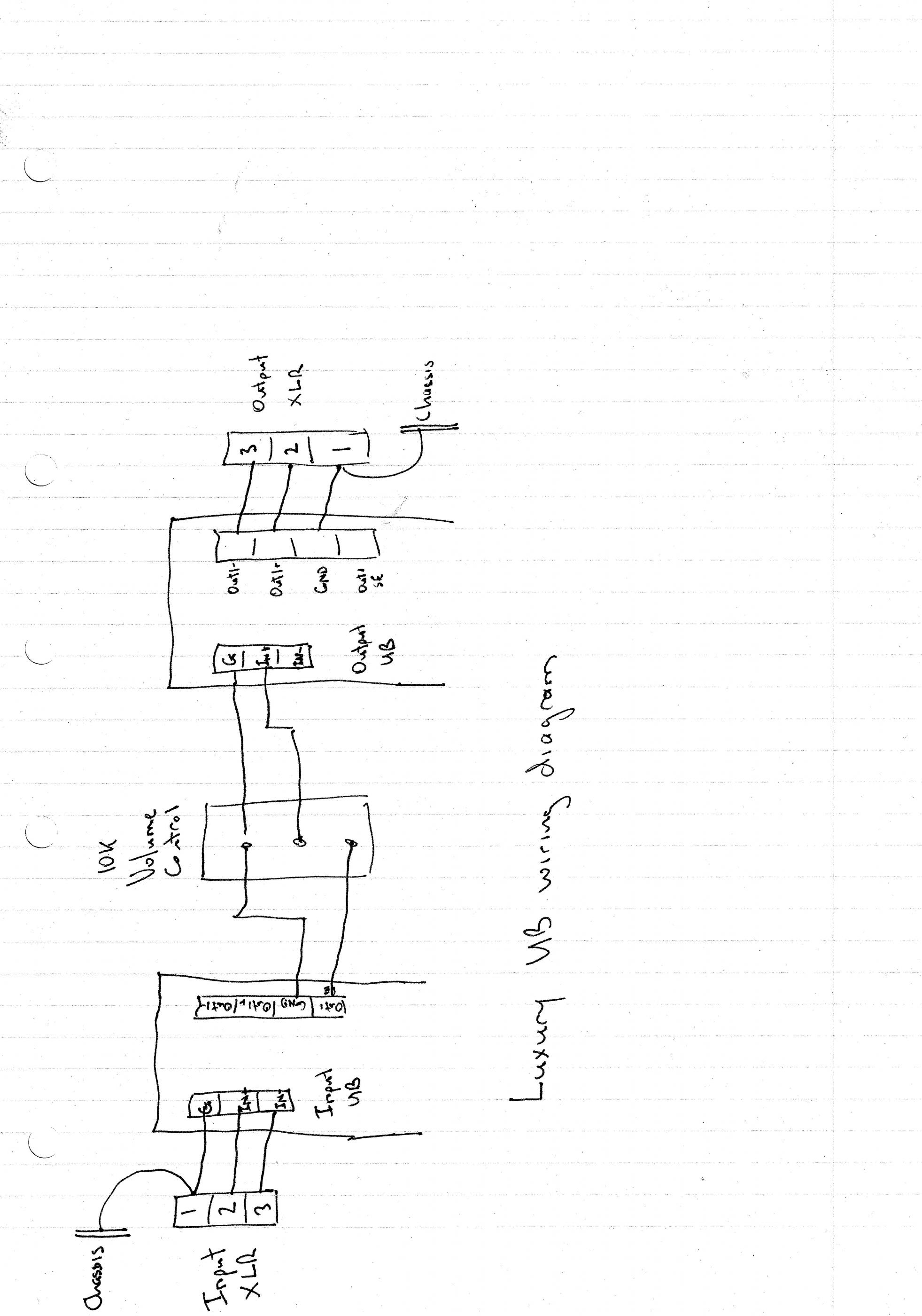

Would you check my "wiring" diagram for a luxury UB set up please---balanced in to SE volume control to 2 x balanced out UB?

The wiring is correct. Do note that you have the 4-pin outputs of the UBs flipped upside down, though. Pin 1 is to the left when you look into the connectors from the wire side.
Can the UB be powered up without line in/out connected? Only the +15v -15v and ground
Yep.
Ah......silly mistake I'm sorry Tom.
Not paying sufficient attention.

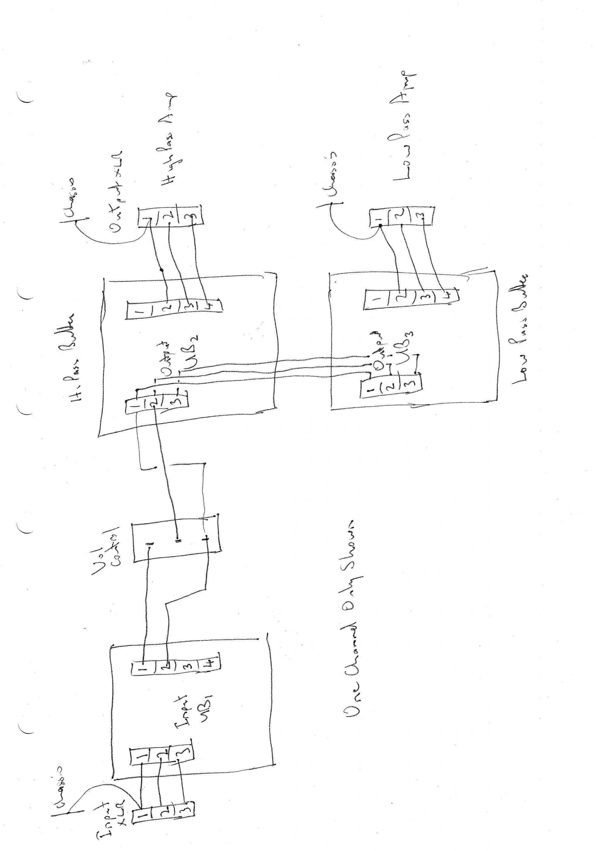

I've scribbled a version 2 diagram.
Am I right this time?
Many thanks
Yep.
Tom
