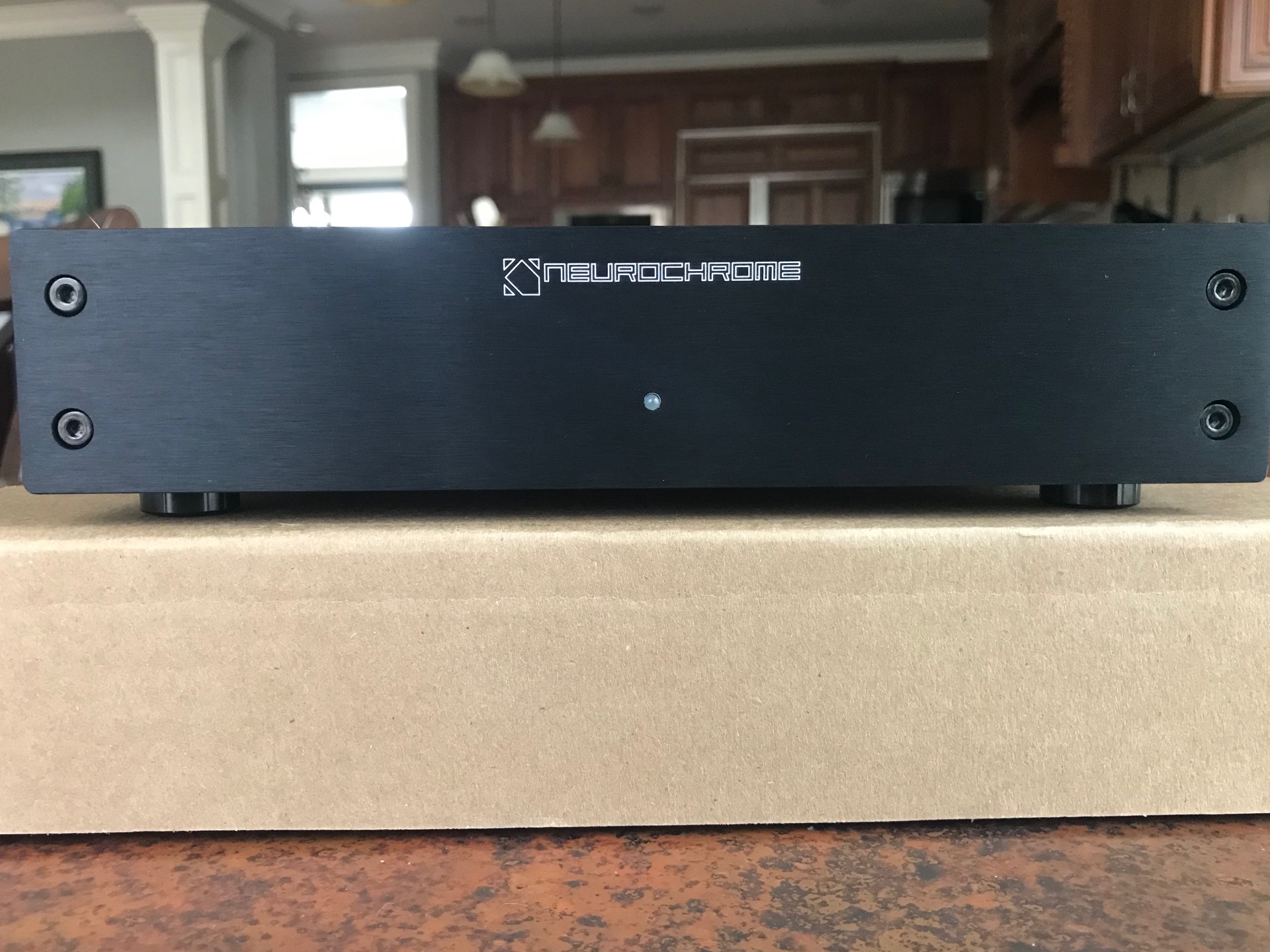

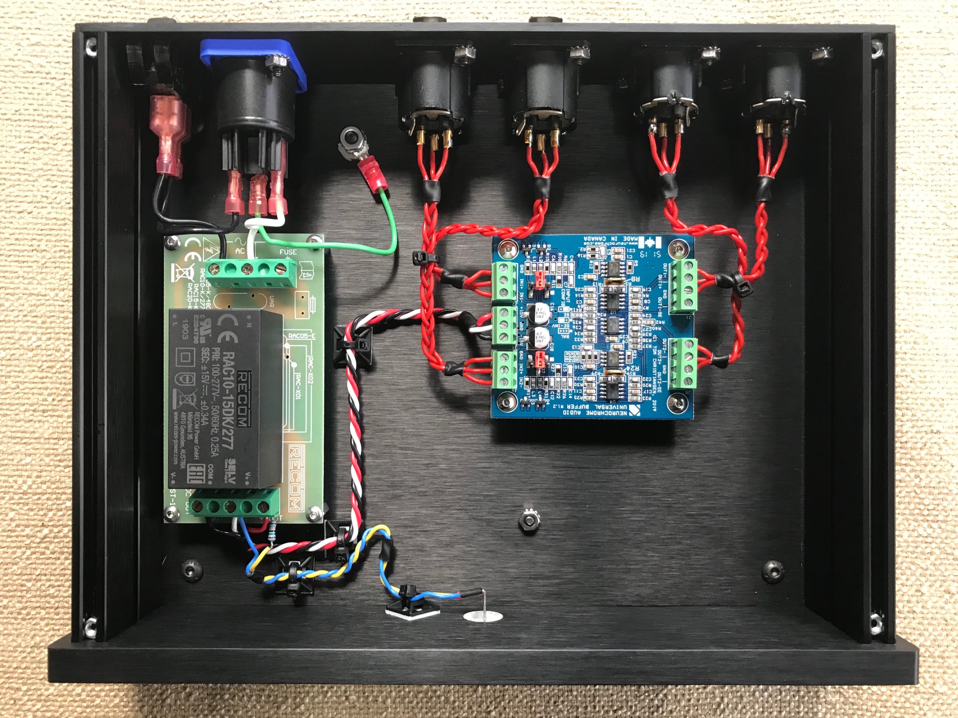

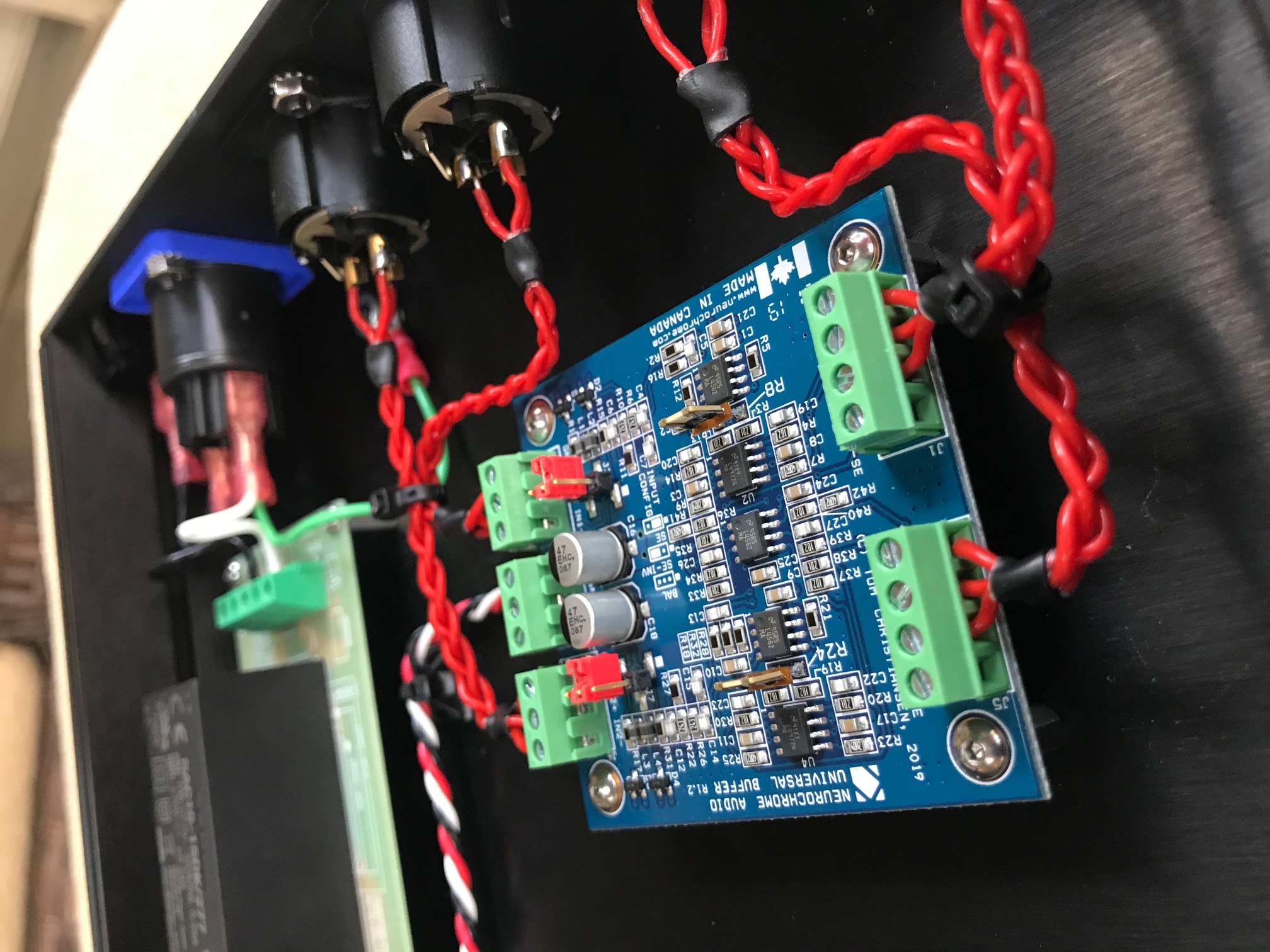

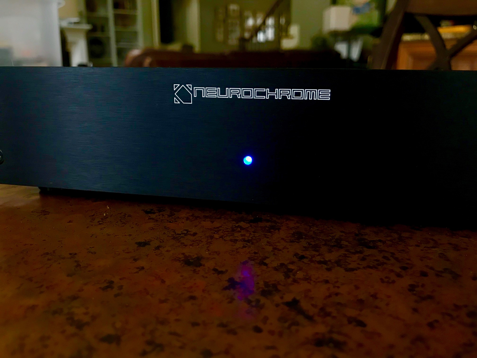

Just completed the build of my Universal Buffer. I built it with one goal in mind only, and that was to add 6 dB of gain between my Matrix Audio X-Sabre Pro DAC and Neurochrome Modulus-686 amplifier. The build substantiates Tom's claim; it IS sonically transparent...period. No need for audiophile superlatives.

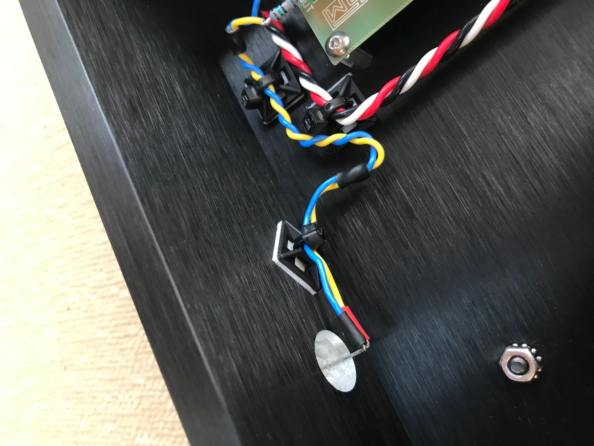

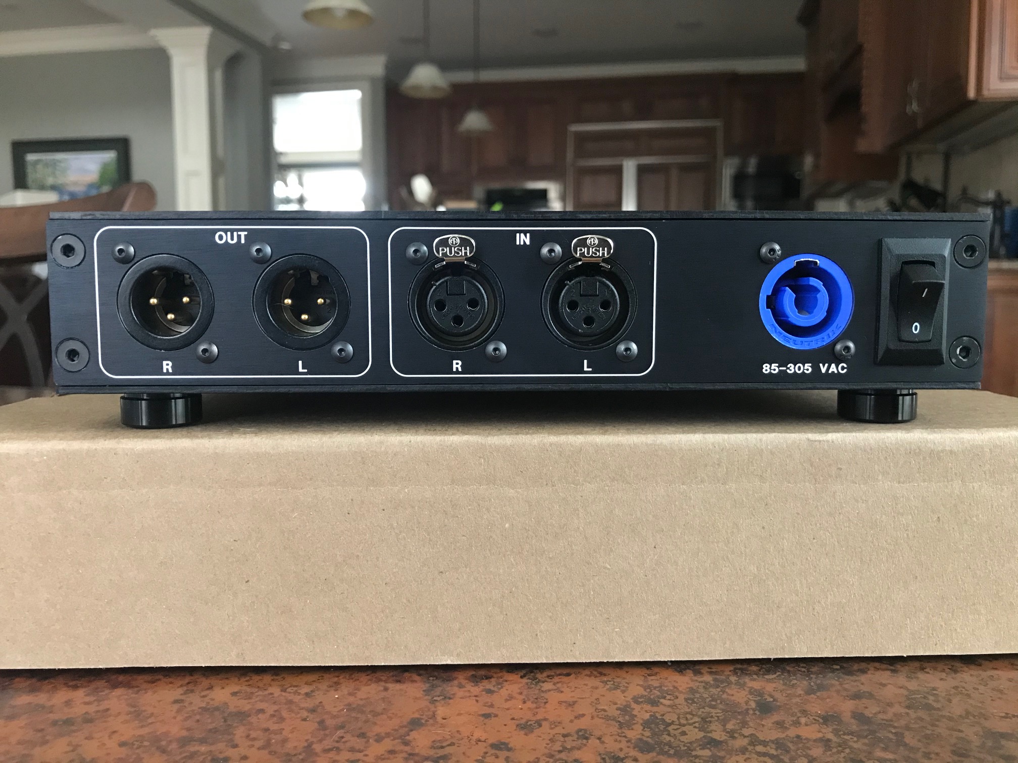

The chassis I selected was the diyAudio Store Galaxy 1U, 230mm x 170mm size. Plenty of room inside as it was the rear panel connectors that dictated the width. Front and rear panels were machined by Front Panel Express. The RECOM modular supply and companion mounting board worked very well together. A couple of "feel good, okay take my money" items were included in the build. I used Neotech UP-OCD 22 AWG stranded wire for the I/O hookups, and a pair of 1K, TX2575 Z-foil resistors from Texas Components to achieve 6 dB gain. The resistors fit the hole pattern on the board perfectly. The miniature LED on the front panel required a 150K ohm drop resistor on the +15V to adjust the brightness to something below eye piercing.
Tom, thank you for another no-hassle, does what the numbers say it's supposed to do product.

Very nice job!

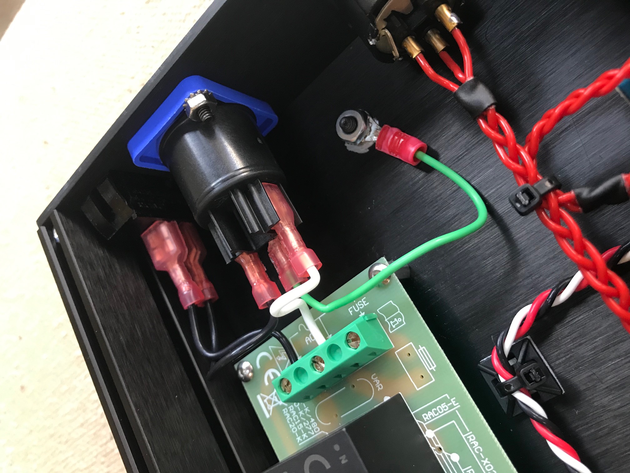

Just curious - how did you fuse this? I'm not familiar with the PS or the board but I didn't see anything where it says "fuse".
gabkw
gabkw:
There is an internal fuse on the power supply and there is also a place on the adapter board for a fuse. I decided to just use the internal fuse.

Very cool thank you Tom for creating this balanced buffer! I have a few questions. If you wanted to build three of these in one box would the power supply amp rage yeah thanks auto correct I know I have amp rage but I’m working on it... amperage required just triple and the voltage stays the same? 150 mA.. or should I get three units like the recom in the picture above? It would be for splitting an xlr out of Dac to 3 amps a hard wired balanced pad for each would be part of this with slightly different attenuation for each.
Awesome. Thank you for sharing. I'm glad you like the buffer. very nicely done with the chassis and build as well!
I would budget 100 mA per board to make sure you have enough current for the load current. So a ±15 V, ±300 mA supply would be my choice.

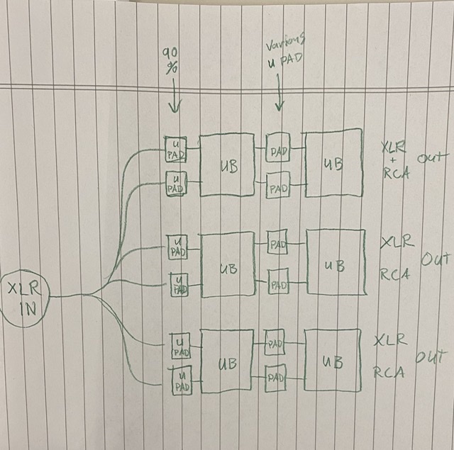

Here’s what I’m wanting to do to split 3 ways. Tell me what you think. The first pad would be a high z voltage divider to take 1 volt down to .93 or so so the input sees a high z across all 3. (Help needed here to figure what is the best) Then the middle pad does the main attenuation then out to 3 separate amps. Deluxe version.
That should work, though, I wonder if you can combine the two pads such that you get the required attenuation up front. That would save you three buffers.
I'm obviously quite happy to sell you six buffers instead of three, but ya know... I like to be honest and that.
Keep in mind that the input impedance of the UB is 48 kΩ, differential.
Tom
