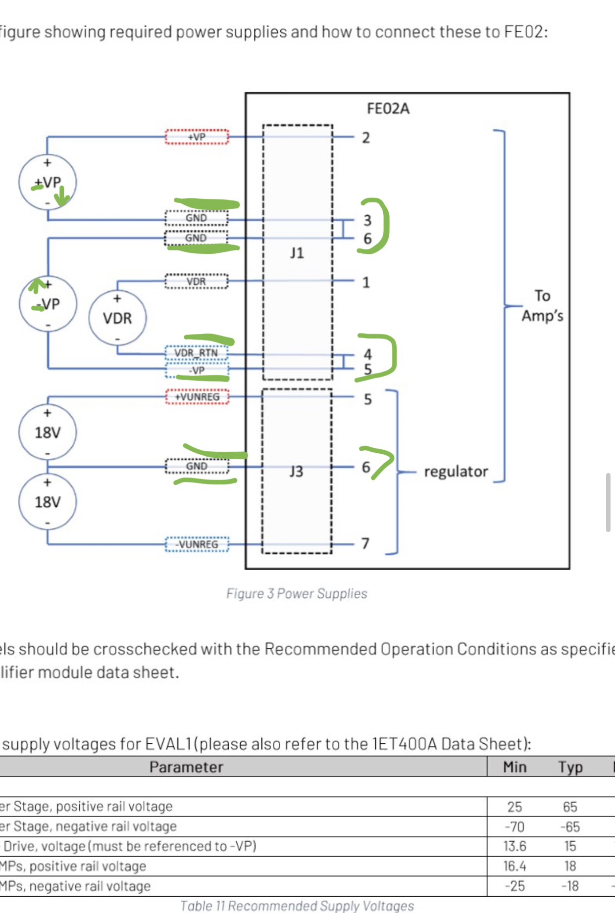

digging in the connection diagrams, it seems like there are two rails on Eval1
- main + and common ground - (25-70v)
- Vdr + and common ground - (13.6v to 16.5v)
- ground connected directly with - of main and - of Vdr (common ground)
So it seems like I will need to run Murata to main voltage and than run non isolated 15v dc-dc from murata output to the Eval1

Sorry to say yoodog, but you got that wrong on most points... . The 16amps is not there to save your life but to prevent setting your house on fire. Ground fault circuit breakers that are intended to protect your life will switch of the circuit at 30mA differential current or there around.

GND - all common it seem
This amplifier has common gnd with negative a coding to the diagrams. Feel free to show me why I’m wrong if so. See the diagram below
Here are the power inputs from the spec sheet
±25V to ±65V (VP)
15V (VDR)
±18V (VUNREG)
Power connection

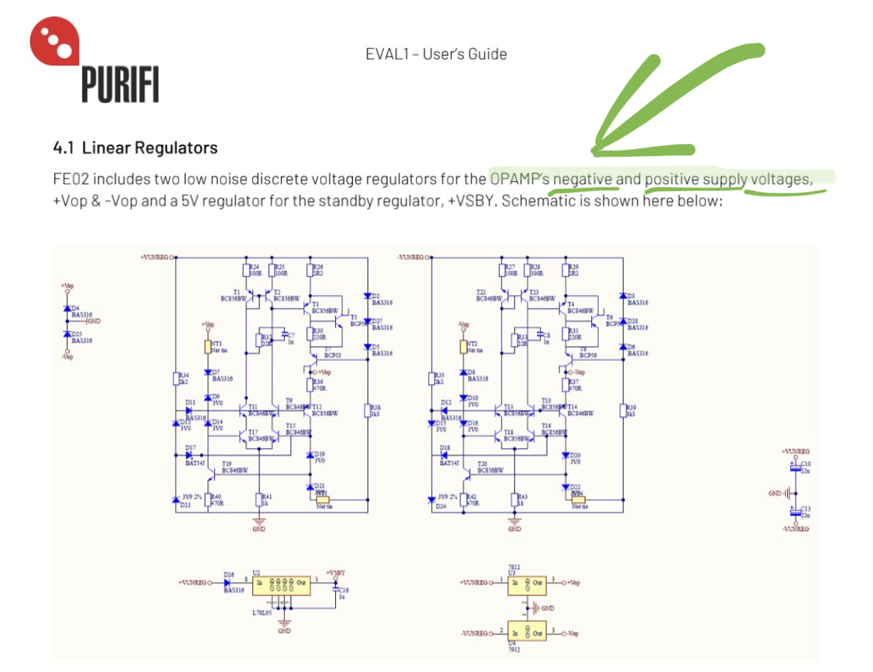

- It looks like power actually has positive and negative supply!? Never worked with DC pcb that would require positive and negative supply feeds
—— yes confirmed found that being mentioned in the manual🙈 thank you Tomchr for setting me on the right path. Will have to get 2 of those murata - btw they are insanely clean PSU! I have had one on the bench for about 3 month running different tests, and I can not imagine anything being AIO psu in that size with true 1050w and that clean 🤙

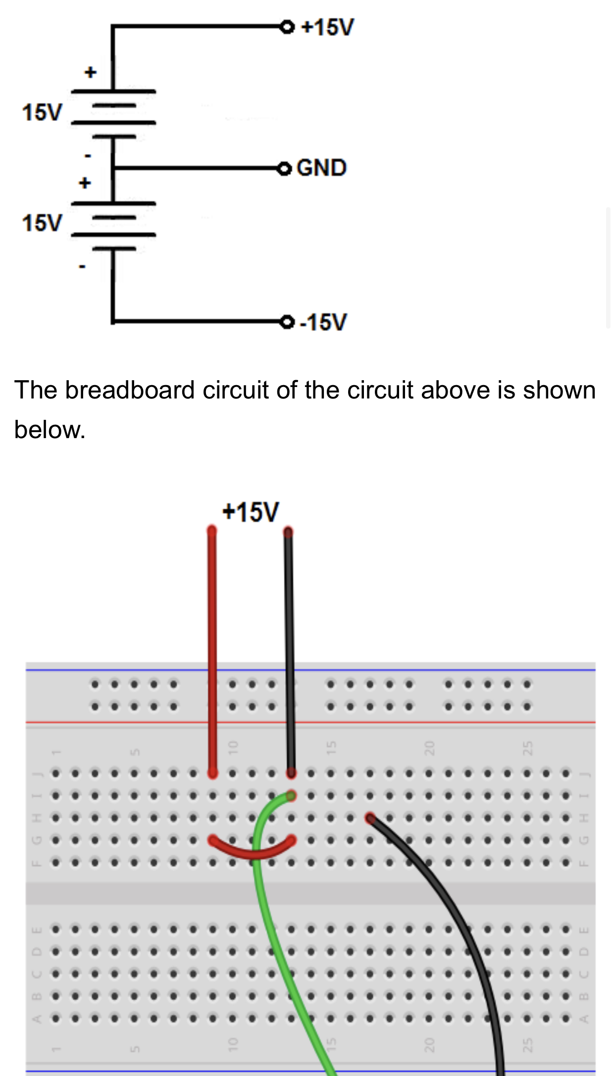

I see now what you Tomchr meant and what would be the product of two PSU in series.
PSU1 + to +VP, - to GND
PSU2 + to GND, - to -VP
That’s what is called dual polarity power supply. No the question for me is how to implement output filter on negative polarity filter. Seems like Polarized low esr capacitors will have +leg on PSU2 - to -VP line, and -leg on PSU + to GND trace.
That dual polarity supply is really trippy
I would appreciate if some one could confirm or correct me if I got it wrong (again sorry dual supply is new to me)
