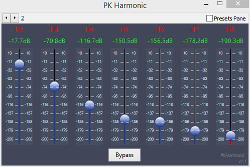

Yes, I think a single ended FET class A amplifier may give you the 2nd order harmonic distortion you are looking for. Nelson Pass mentions the pleasing musical sound of 1% second harmonic distortion.
You can do this with software: PKHarmonic VST Plugin - Audiophile Harmonics Generator | Distort documentation
It may also depend on the type of music you are listening to, since some types of music may sound better to Your ears with the second order harmonic distortion added.
https://www.firstwatt.com/pdf/art_h2.pdf
https://www.firstwatt.com/pdf/art_h2_v1.pdf

A low feedback class A amplifier with have more harmonic distortion. A single ended version will have more 2nd order distortion.
You might want to download the distortion software noted above and compare your impression with varied amounts of distortion.

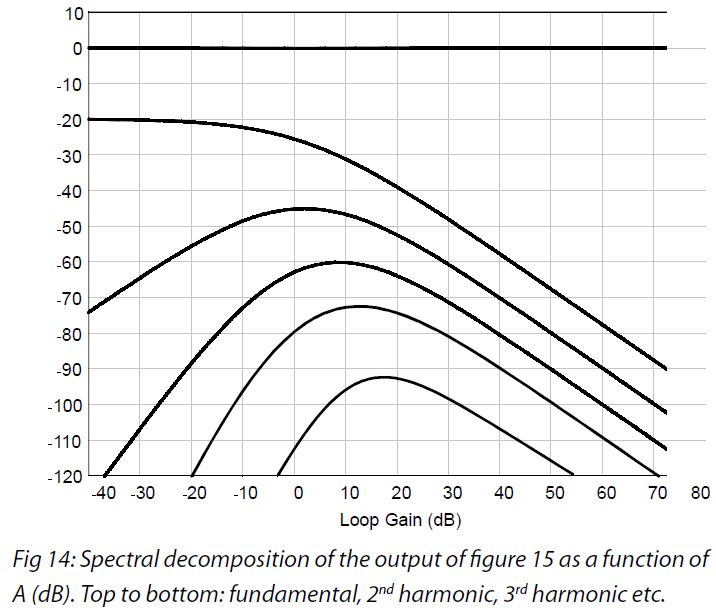

Many people that consider it is better to have no feedback, also believe in the theory that TIM (Transient Intermodulation Distortion) is caused by excess feedback. There is an opposing view that it is due to not enough feedback (loop gain is too low).
There is a paper on Feedback. On page 11 is a review of TIM: https://linearaudio.net/sites/linearaudio.net/files/volume1bp.pdf

TIM was somewhat of a red herring -- what was going on was real but mis-attributed. The proposed solutions were also a bit over-done as simpler 'cures' exist. Walt Jung showed that it was really slew limiting in the power amp, especially its input stage. Bob Cordell also wrote a couple illuminating articles, for the old Audio mag, I believe.
That is actually not possible. There is always at least local feedback through regeneration. So for example a differential pair has emitter resistors to control the gain through regeneration. An output stage of a power amp is usually an emitter follower, which has enough local feedback to give it a gain of 1 (or just slightly less)

So, feedback after using PKHarmonic VST Plugin with foobar.
Qutest direct to power amp. The sound is slightly flatter without the added harmonics (H2@-90dB, H3@-100dB and H4@-110dB), but it’s not a huge difference to my ears. There is greater clarity without harmonic distortion and less hash. This is my preference.
The added harmonics seem to change my perception of loudness more than anything else - when the additional harmonics are added the sound is slightly fuller. However, I think my perception would be that a slight increase in volume, or mild equalising, would have a similar effect.
Yes, even the low feedback believers often use resistor degeneration for bias stability & improved linearity.
