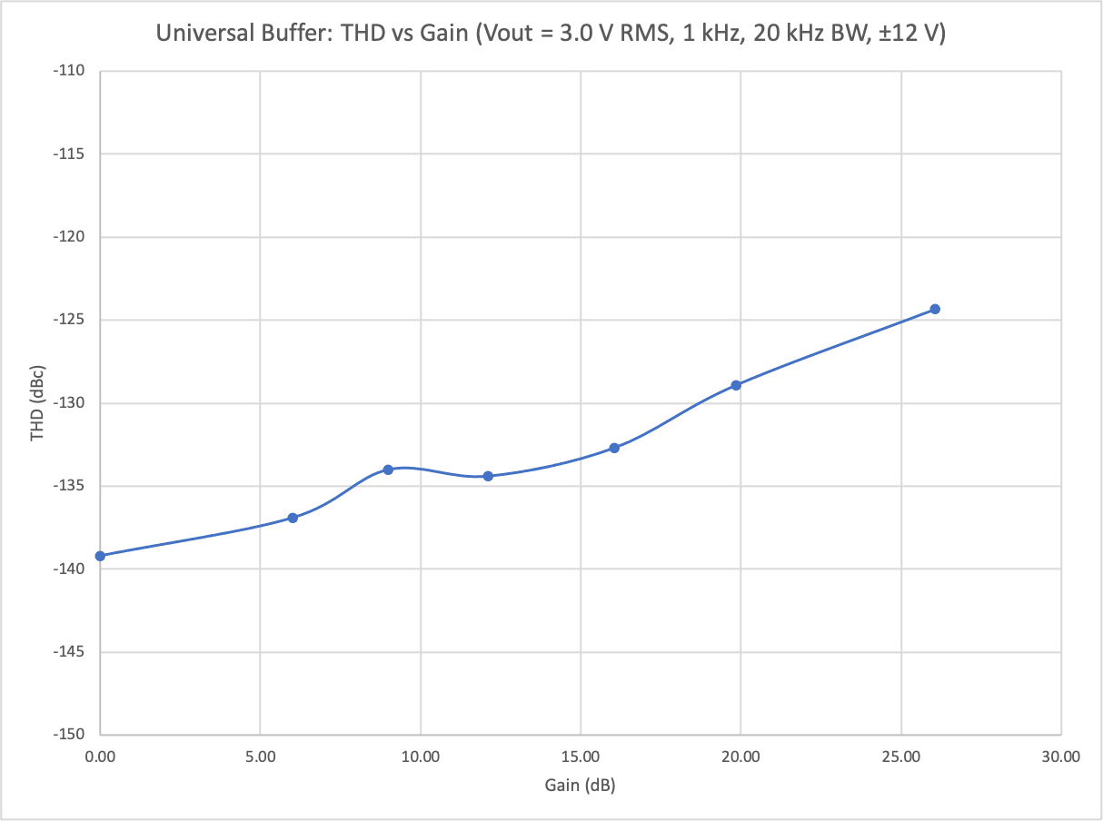

I finally found time (and developed the tools) to allow me to measure the THD vs gain. See attached.
The UB behaves about as I would have expected. Basically, as you increase the gain, you increase the THD as the increase in gain results in a reduction in loop gain. It's not quite a 1:1 relationship (it's actually a little better), but it's pretty close.
The blip at 9 dB gain is due to a range change on the APx525 source.
I used a 5th order elliptical filter to clean up the source. The filter notches out the 2nd and 3rd harmonic and attenuates everything from H4 and up by 50+ dB. The cleaned up source goes to the DUT.
The output of the DUT then goes through a balanced receiver and a notch filter, which allows me to extend the measurement capability of the APx525.
I measured at 3 V output voltage as that's the sweet spot on the AP for THD. Even with my fancy tricks, I'm still pushing the limits of the instrumentation.
The UB was powered by a Preamp Power Supply providing ±12 V.

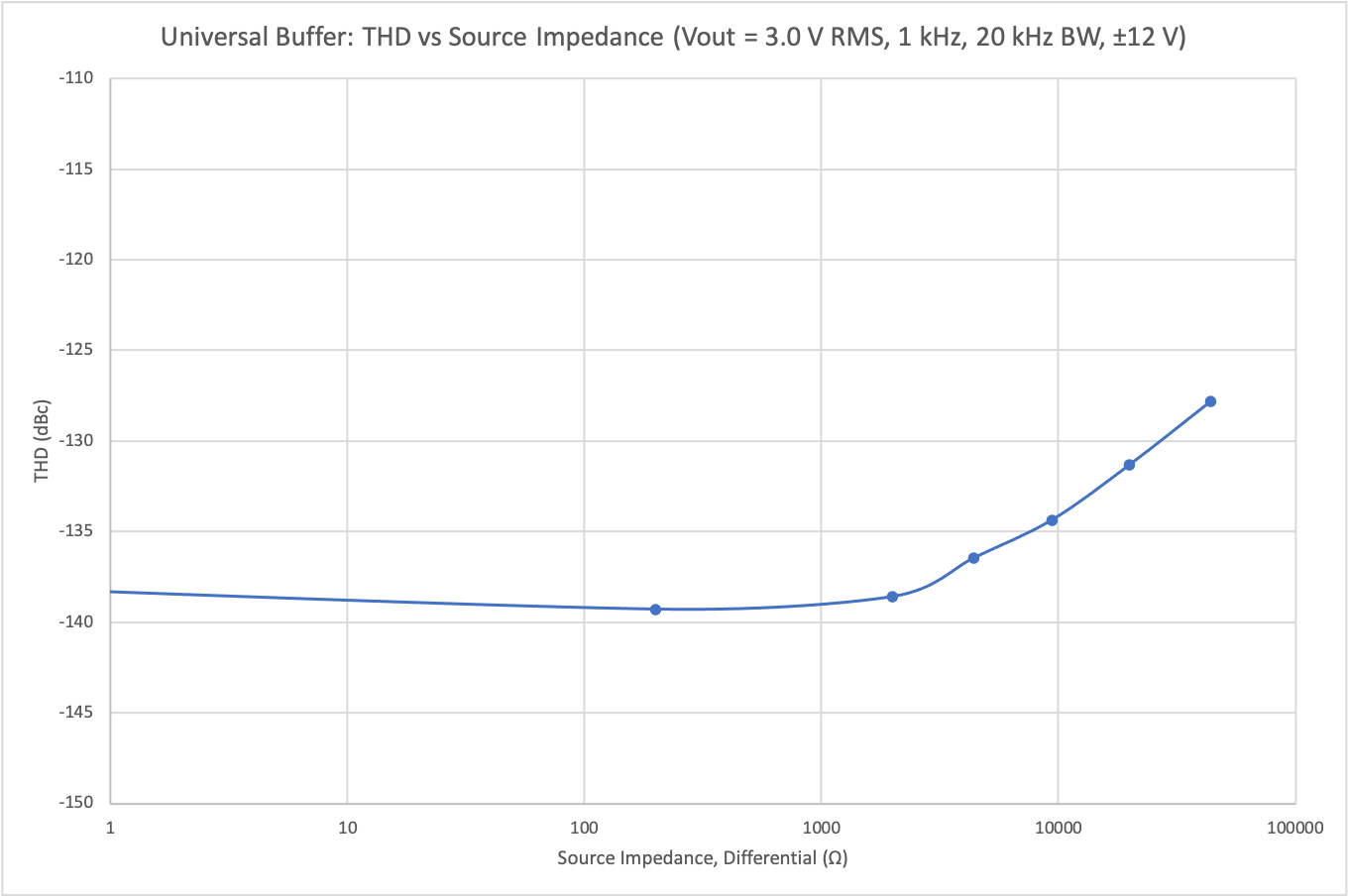

And now THD vs source impedance. This could be relevant if you plan to use the Universal Buffer as a preamp where it is preceded by a volume control.
This measurement shows that the THD of the Universal Buffer is not impacted by the volume pot as long as the resistance of the pot is 10 kΩ or below.
Recall that the worst case output impedance of a volume pot (or "passive preamp" if you prefer) is Rpot/4. So with a 10 kΩ pot you'd be sitting at the last data point just before the THD starts to rise.
It should be noted that the rise in THD could very well be due to the signal source. With the higher source impedances I had to crank the amplitude up quite a bit due to the voltage division between the source impedance and the 48 kΩ input impedance of the Universal Buffer.

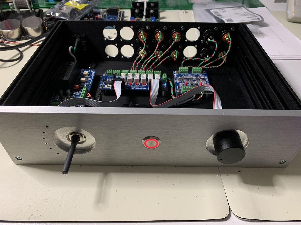

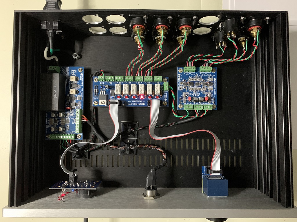

Here's my take on the Neurochrome preamplifier using the Universal Buffer, preamp PSU and source selector.
The project is work in progress and should be completed in the coming week or so. Currently awaiting two sets of RCA connectors and one set of XLR for the second Universal buffer that will be used to convert balanced to unbalanced.
Front panel was done by myself using a router. It not perfect but the buttons will fit nicely in the holes and hide the little defects on the source selector hole. Also made 6 tiny holes for displaying the source. Red LED are used for unbalanced and blue LED for balanced source. Power switch is Bulgin bi-color LED.

I used the router to first cut a hole of the proper size inside a piece of hardwood, then used this wooden guide on top of the faceplate (tightly fastened). Used a 1/2" diameter carbide bit (just use good quality router bit) with bearing to follow the wooden shape, 1-2mm depth at a time. I've used a router many times with aluminium and now I'm used to how it reacts, but at the beginning (several years ago), I almost lost fingers and not counting broken bits the flew dangerously fast... I don't recommend unexperienced people to do this, but I've learned to master the art of aluminium cutting with a wood router and now I can do it very safely.
I finished the filling the back panel with just the extra universal buffer as input still MIA.
