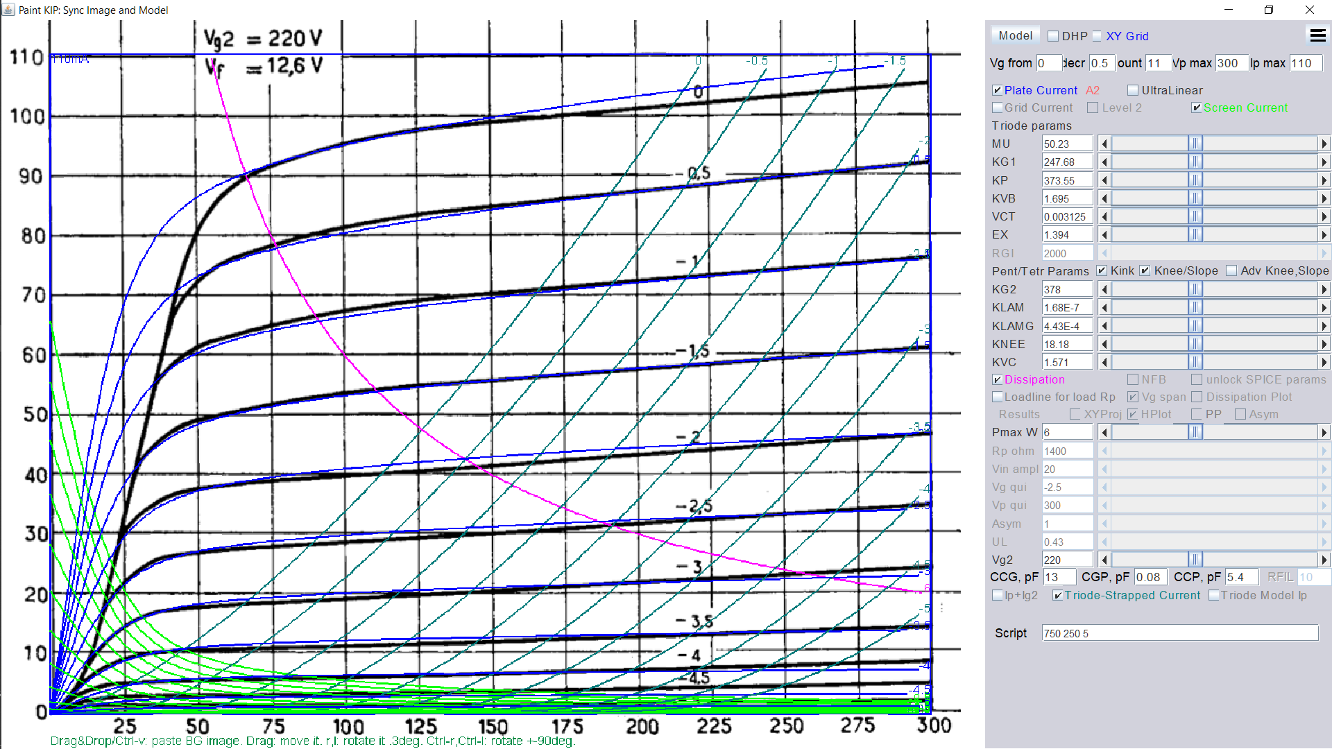

Hello,
I'm looking for a model for EL183 in triode?
Thx.
I have to estimate unknown G2 current, the unknown Mu is adjusted for best fit too. In your sim connect G2 to Anode for triode operation.
Code:
**** EL183_P ******************************************
* Created on 11/10/2018 00:58 using paint_kip.jar
* [url=http://www.dmitrynizh.com/tubeparams_image.htm]Model Paint Tools: Trace Tube Parameters over Plate Curves, Interactively[/url]
* Plate Curves image file: el183_p.png
* Data source link: <plate curves URL>
.SUBCKT EL183_P P G2 G K ; LTSpice tetrode.asy pinout
* .SUBCKT EL183_P P G K G2 ; Koren Pentode Pspice pinout
+ PARAMS: MU=50.23 KG1=247.68 KP=373.55 KVB=1.695 VCT=0.003125 EX=1.394 KG2=378 KNEE=18.18 KVC=1.571
+ KLAM=1.68E-7 KLAMG=4.43E-4 KNEE2=20 KNEX=30  KNK=-0.044 KNG=0.006 KNPL=50 KNSL=11 KNPR=120 KNSR=29
+ CCG=13P CGP=0.08P CCP=5.4P RGI=2000.0
* Vp_MAX=300 Ip_MAX=110 Vg_step=0.5 Vg_start=0 Vg_count=11
* X_MIN=58 Y_MIN=40 X_SIZE=1015 Y_SIZE=761 FSZ_X=1550 FSZ_Y=878 XYGrid=false

* The following triode model is derived from pentode model, see above.
* In the triode model, all spice parameters come directly from the pentode model, except for Kg1,
* which for triode-strapped pentodes is derived from pentode's Kg1, Kg2 and Kvc as
*    4Kg1Kg2 / ((2Kvc-Pi)(2Kg1+PiKg2))
* Created on 11/10/2018 00:58 using paint_kit.jar 4.7
.SUBCKT TRIODE_EL183_P 1 2 3 ; Plate Grid Cathode
+ PARAMS: CCG=13P  CGP=0.08P CCP=5.4P RGI=2000
+ MU=50.23 KG1=556324.71 KP=373.55 KVB=1.695 VCT=0.003125 EX=1.394
* Rp=1400 Vg_ac=20 P_max=6 Vg_qui=-2.5 Vp_qui=300
* showLoadLine=n showIp=y isDHT=n isPP=n isAsymPP=n showDissipLimit=y
* showIg1=n gridLevel2=n isInputSnapped=y
* XYProjections=n harmonicPlot=y dissipPlot=n
E1 7 0 VALUE={V(1,3)/KP*LOG(1+EXP(KP*(1/MU+(VCT+V(2,3))/SQRT(KVB+V(1,3)*V(1,3)))))}
RE1 7 0 1G  ; TO AVOID FLOATING NODES
G1 1 3 VALUE={(PWR(V(7),EX)+PWRS(V(7),EX))/KG1}
RCP 1 3 1G   ; TO AVOID FLOATING NODES
C1 2 3 {CCG} ; CATHODE-GRID
C2 2 1 {CGP} ; GRID=PLATE
C3 1 3 {CCP} ; CATHODE-PLATE
D3 5 3 DX ; POSITIVE GRID CURRENT
R1 2 5 {RGI} ; POSITIVE GRID CURRENT
.MODEL DX D(IS=1N RS=1 CJO=10PF TT=1N)
.ENDS
