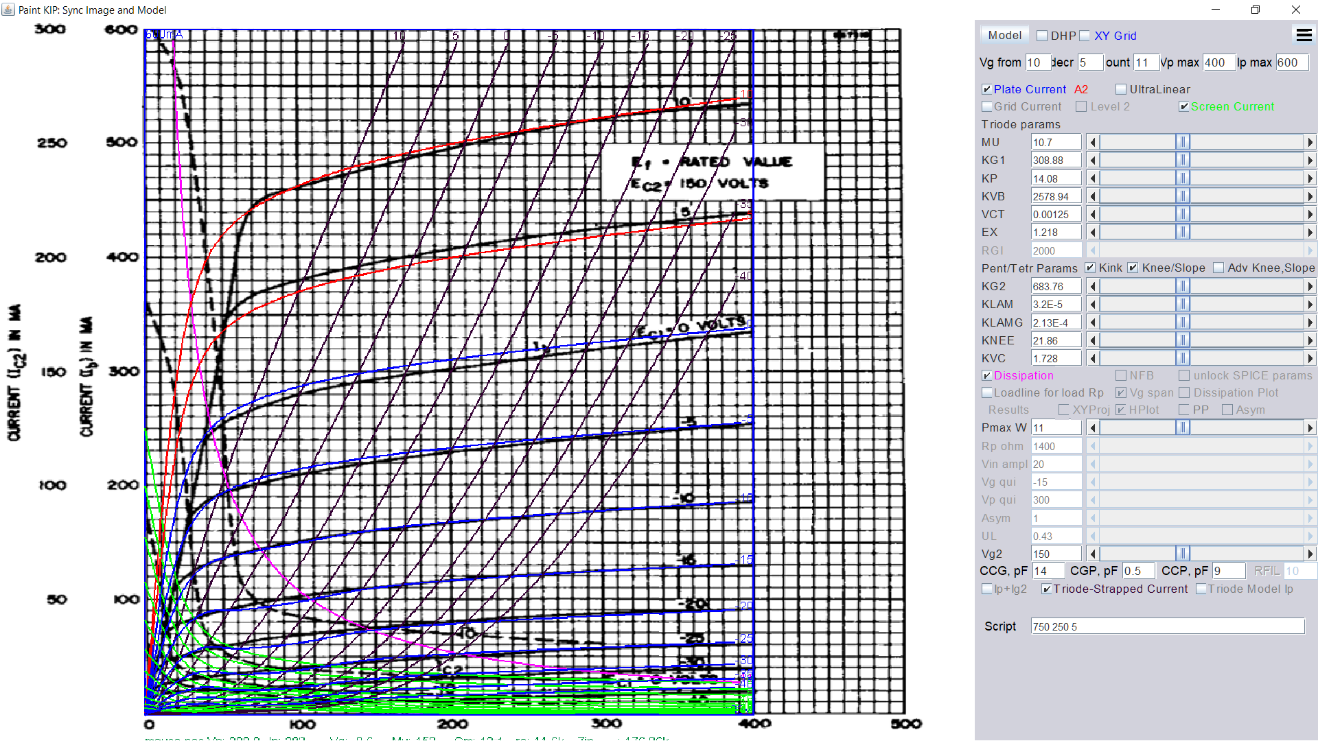

I hate to ask, because I've already asked for the 6AR6 models, but does anyone happen to have models of the 6DW5? It's a 9-pin mini from Sylvania, somewhat similar to a beefed up 6W6GT, but with higher zero-bias plate current, intended for use with the then-new (circa 1957) 110 degree deflection monochrome CRTs as a vertical deflection amp.
My main hobby is the restoration of vintage television sets, particularly color roundies from 1954 to 1959, and I have enough 6DW5s around to last me multiple lifetimes, yet nothing that uses them at the moment.
Links to the datasheets:

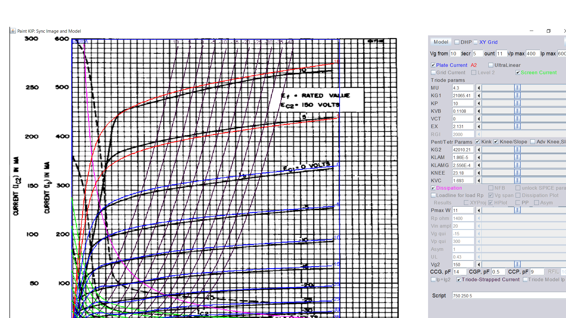

I found the pentode strapped triode Mu of 4.3 in datasheet, so here is the remodel of 6dw5:

**** 6DW5 ******************************************
* Created on 12/04/2018 16:58 using paint_kip.jar
* [url=http://www.dmitrynizh.com/tubeparams_image.htm]Model Paint Tools: Trace Tube Parameters over Plate Curves, Interactively[/url]
* Plate Curves image file: 6dw5.png
* Data source link: <plate curves URL>
.SUBCKT 6DW5 P G2 G K ; LTSpice tetrode.asy pinout
* .SUBCKT 6DW5 P G K G2 ; Koren Pentode Pspice pinout
+ PARAMS: MU=4.3 KG1=21065.41 KP=10 KVB=0.1108 VCT=0 EX=2.131 KG2=42010.21 KNEE=23.18 KVC=1.693
+ KLAM=1.86E-5 KLAMG=2.556E-4 KNEE2=20 KNEX=30  KNK=-0.044 KNG=0.006 KNPL=50 KNSL=11 KNPR=120 KNSR=29
+ CCG=14P CGP=0.5P CCP=9P RGI=2000.0
* Vp_MAX=400 Ip_MAX=600 Vg_step=5 Vg_start=10 Vg_count=11
* X_MIN=169 Y_MIN=12 X_SIZE=727 Y_SIZE=799 FSZ_X=1550 FSZ_Y=878 XYGrid=false
* Rp=1400 Vg_ac=20 P_max=11 Vg_qui=-15 Vp_qui=300
* showLoadLine=n showIp=y isDHP=n isPP=n isAsymPP=n isUL=n showDissipLimit=y
* showIg1=n isInputSnapped=y addLocalNFB=n
* XYProjections=n harmonicPlot=y dissipPlot=n
* UL=0.43 EG2=150 gridLevel2=n addKink=y isTanhKnee=y advSigmoid=n

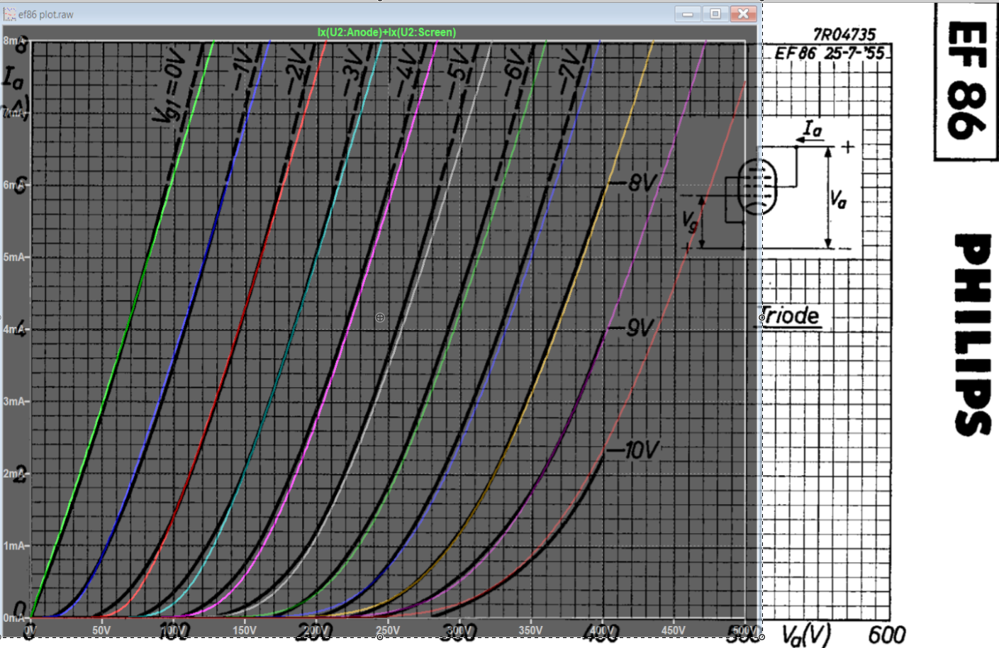

Hi, do you have any model for the EF86 as I found only equivalents but I dont trust the figures are exactly the same.
Regards, Victor
I used this model 2 years back on Tim Mellow OTL simulation posted numerous sim since, not sure if derived from original datasheet, so check it out.

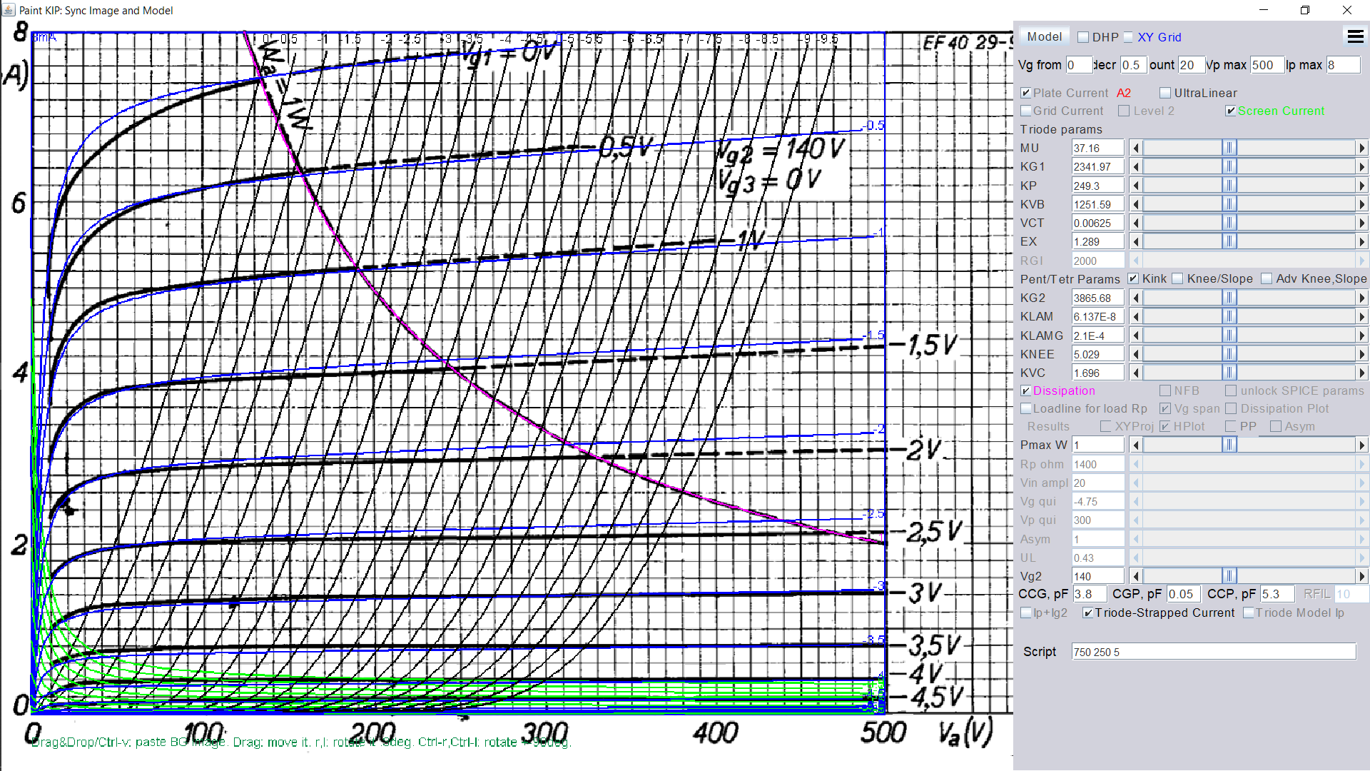

Here is another one based on Svetlana datasheet, please do comparison before use.

** EF86  as TRIODE ******************************************************
 * Created on Mon Aug 02 13:20:50 PDT 2004 using tube.model.finder.PaintKIT
 * data URL: [url=http://www.svetlana.com/graphics/products/pdf/EF86.pdf]404 - File or directory not found.[/url]
 .SUBCKT TRIODE_EF86 1 2 3 ; P G K ;
 + PARAMS: CCG=3P  CGP=4.4P CCP=4.9P RGI=2000
 + MU=37.2960 EX=1.3929 KG1=2010.0 KP=318.0 KVB=15.0 VCT=1.104

There appears to be a scaling issue with the models vs. the datasheet, the quick fix is to lower the screen grid voltage, e.g., 130V instead of 140V, bring the curves quite close to the datasheet. But in the actual circuit, you may need to make further adjustment. In any case, there are large variations in the tube parameters due to the tolerance of the manufacturing process, so the tubes that you have may not be that close to the datasheet.

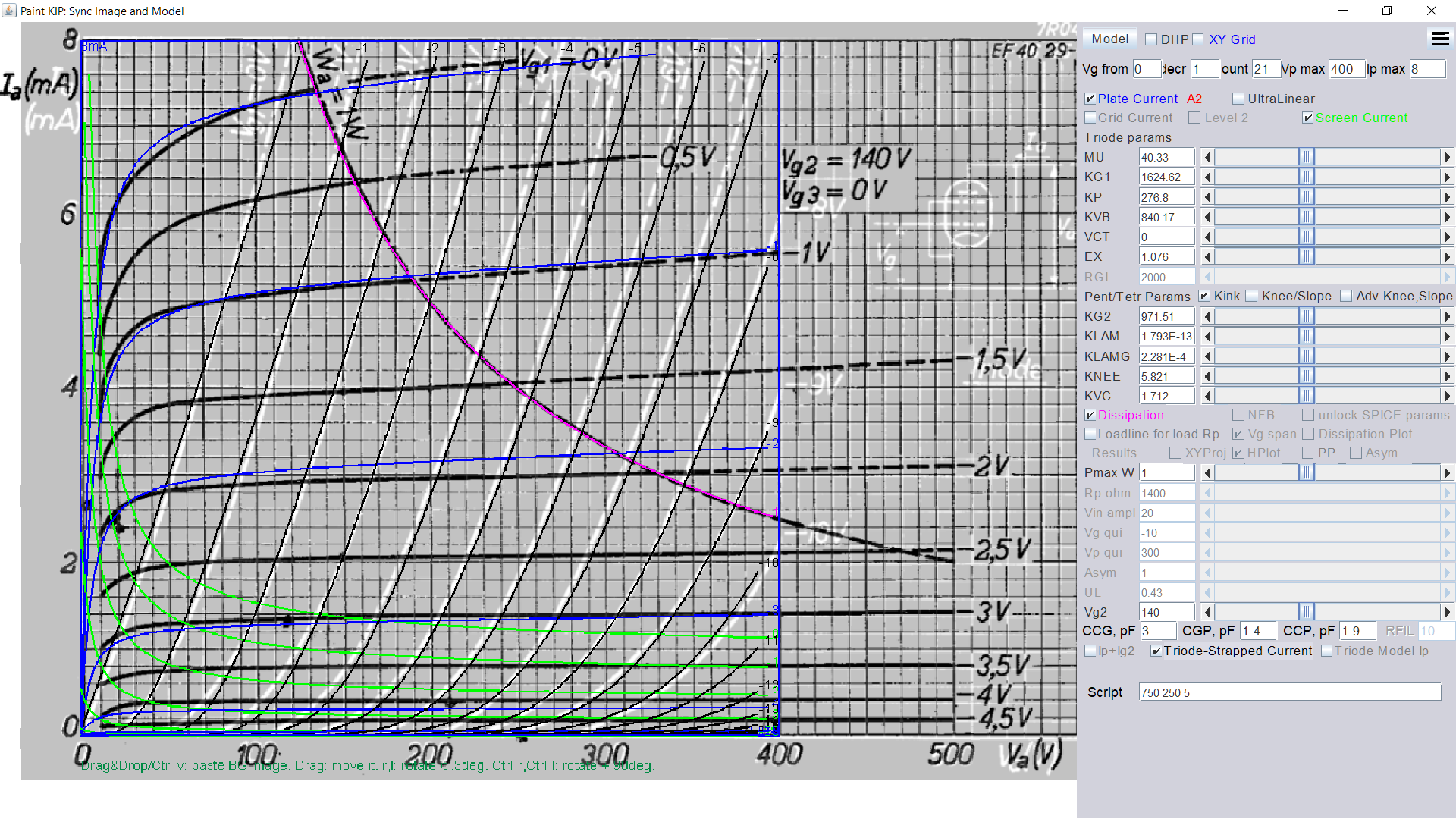

The tube current of previous ef86 was out a bit. Now I remodel using triode curve in original datasheet, it's fine.

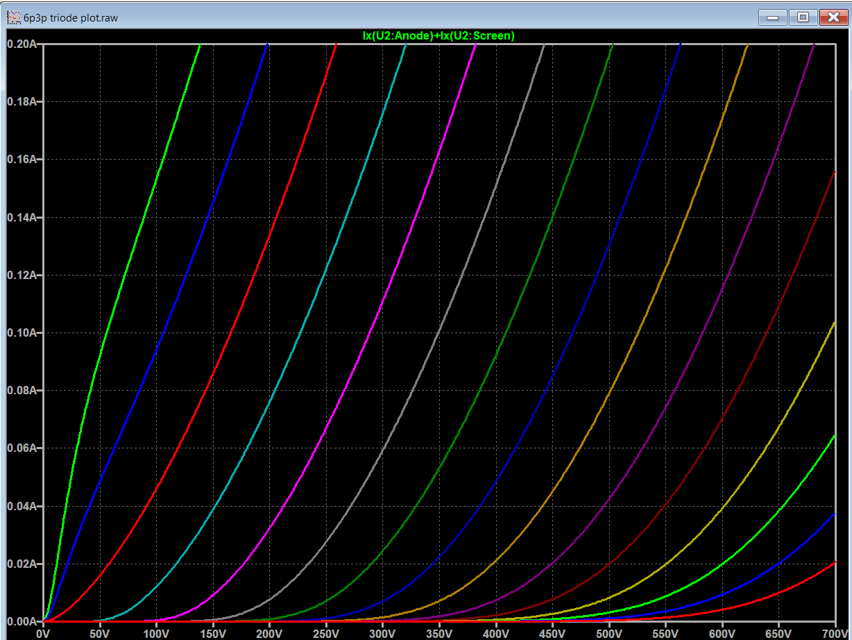

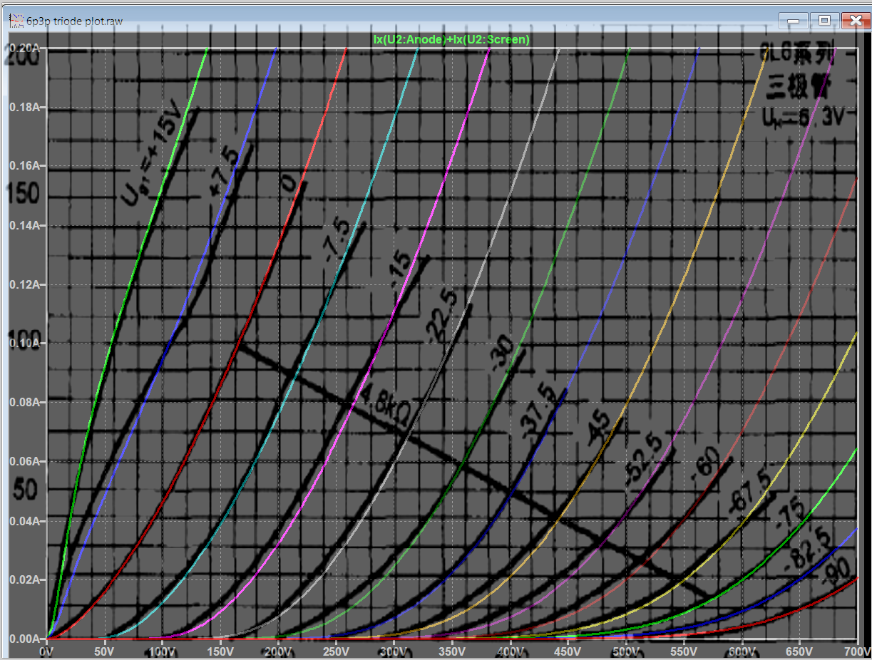

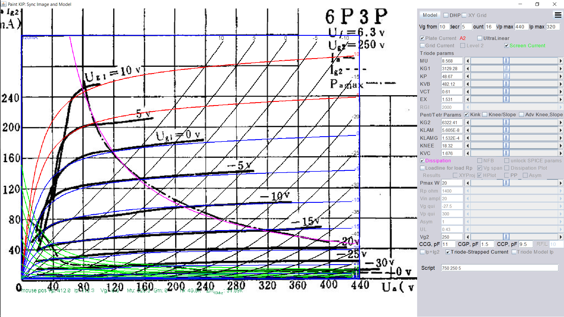

Found triode mode of 6L6 surprisingly closed to 6p3p, hence here is the remodel:
