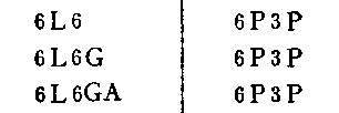

Found triode mode of 6L6 surprisingly closed to 6p3p
That's to be expected - it's just a substitute for the 6L6,

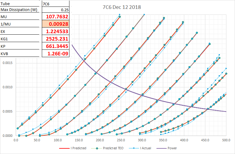

Thanks for your feedback. I develop my models manually, that means plotting the curves with LTspice while overlaying a semitransparent diagram, from measured data or data sheet curves. I also have a excel sheet and the solver add-on for least mean square fit of the params, but it is not stable (why ever).
Adrian:
With "Solver" try using "log squashed error" -- a trick I got from Nutonian:
=LN(1+ABS(Actual_current - Predicted_Current))
for instance Log squashed error =LN(1+ABS(V16-T16))
It's also important to paramaterize the params to reasonable values.

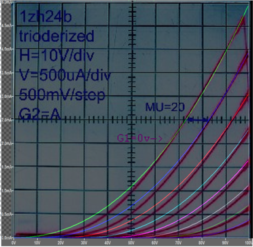

Here is both pentode and triode curve measurement for spice model.
Thank you in advance ...

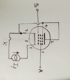

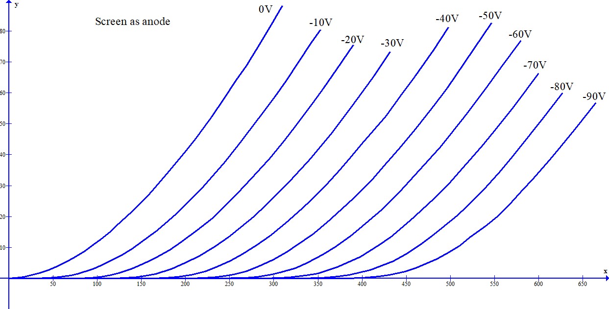

On the characteristics of tube 813 screen as anode axis X-Volt, Y-mA anode
Do you mean triode-connected? i.e., the screen is connected to the anode?

Unfortunately, the model created by the Ayumi method using the traced triode curves does not match up to either to the traced pentode curves or to the datasheet. Perhaps you can trace it again but with higher voltage like those shown in the datasheets?

Hi, I want to model but I ran into difficulty: the tube is cut off about 5V, and about 10V for triode. In other word the curve origin is quite a distance from 0, 0 as compared with other sharp cut off tube. I wonder whether it is due to tracer or actually is like that?

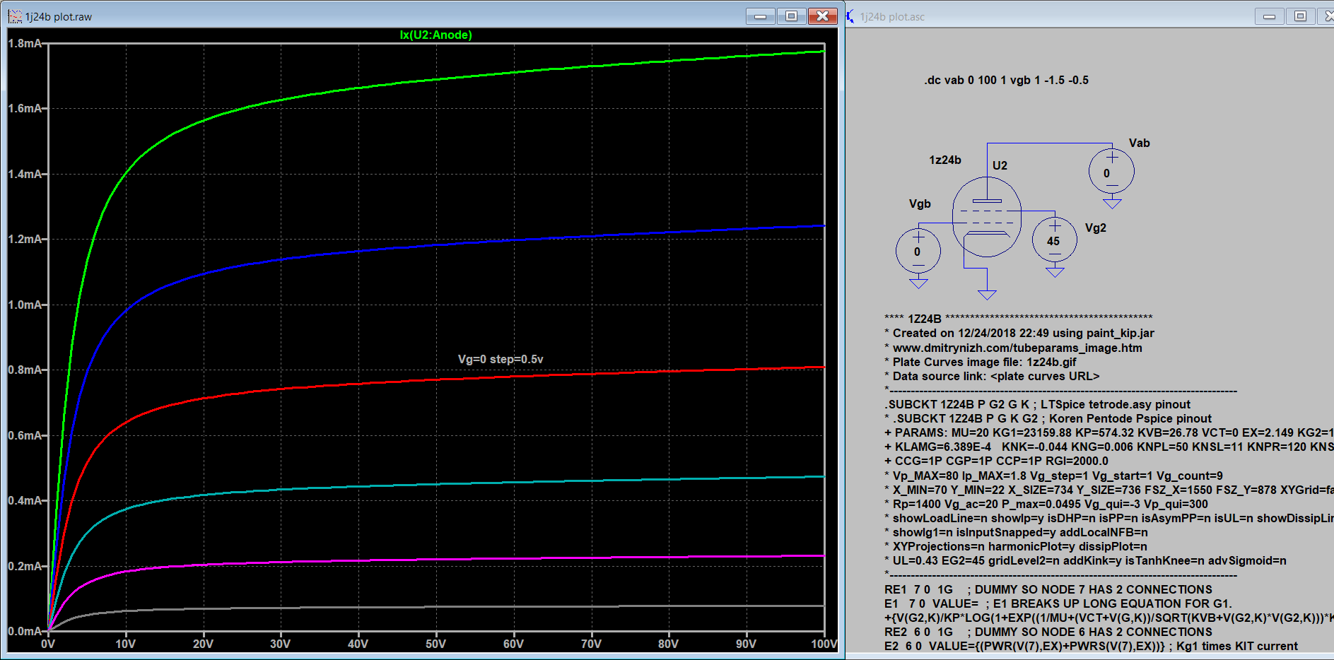

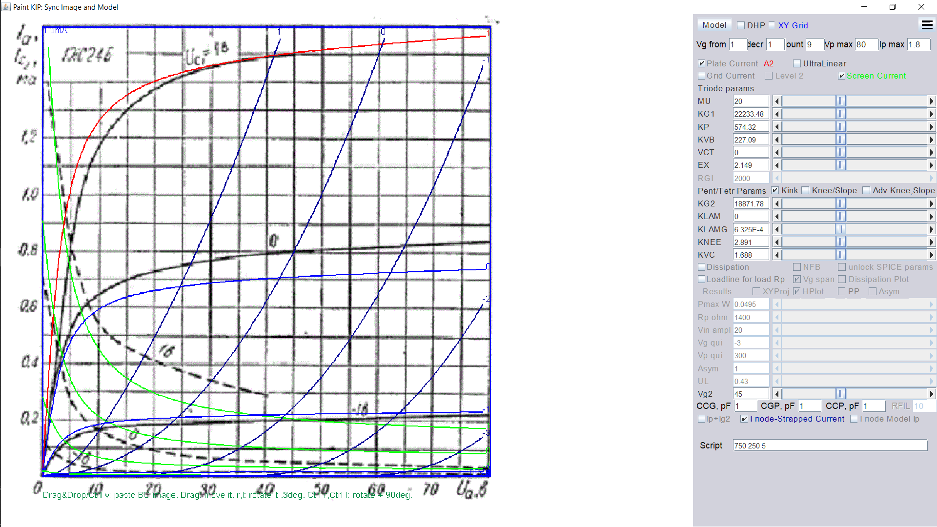

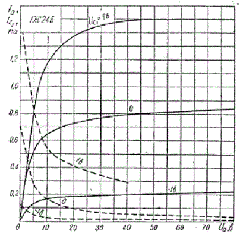

Ok, found original Pentode curve: ''GSTube.com''. Tubes, sockets etc. Parameters and characteristics 1Zh24b
Here is the model, fill in the capacitances:
Code:
* [URL="http://www.dmitrynizh.com/tubeparams_image.htm"]Model Paint Tools: Trace Tube Parameters over Plate Curves, Interactively[/URL]
* Plate Curves image file: 1z24b.gif
* Data source link: <plate curves URL>
.SUBCKT 1Z24B P G2 G K ; LTSpice tetrode.asy pinout
* .SUBCKT 1Z24B P G K G2 ; Koren Pentode Pspice pinout
+ PARAMS: MU=20 KG1=23159.88 KP=574.32 KVB=26.78 VCT=0 EX=2.149 KG2=18871.78 KNEE=2.891 KVC=1.688
+ KLAMG=6.389E-4   KNK=-0.044 KNG=0.006 KNPL=50 KNSL=11 KNPR=120 KNSR=29
+ CCG=1P CGP=1P CCP=1P RGI=2000.0
