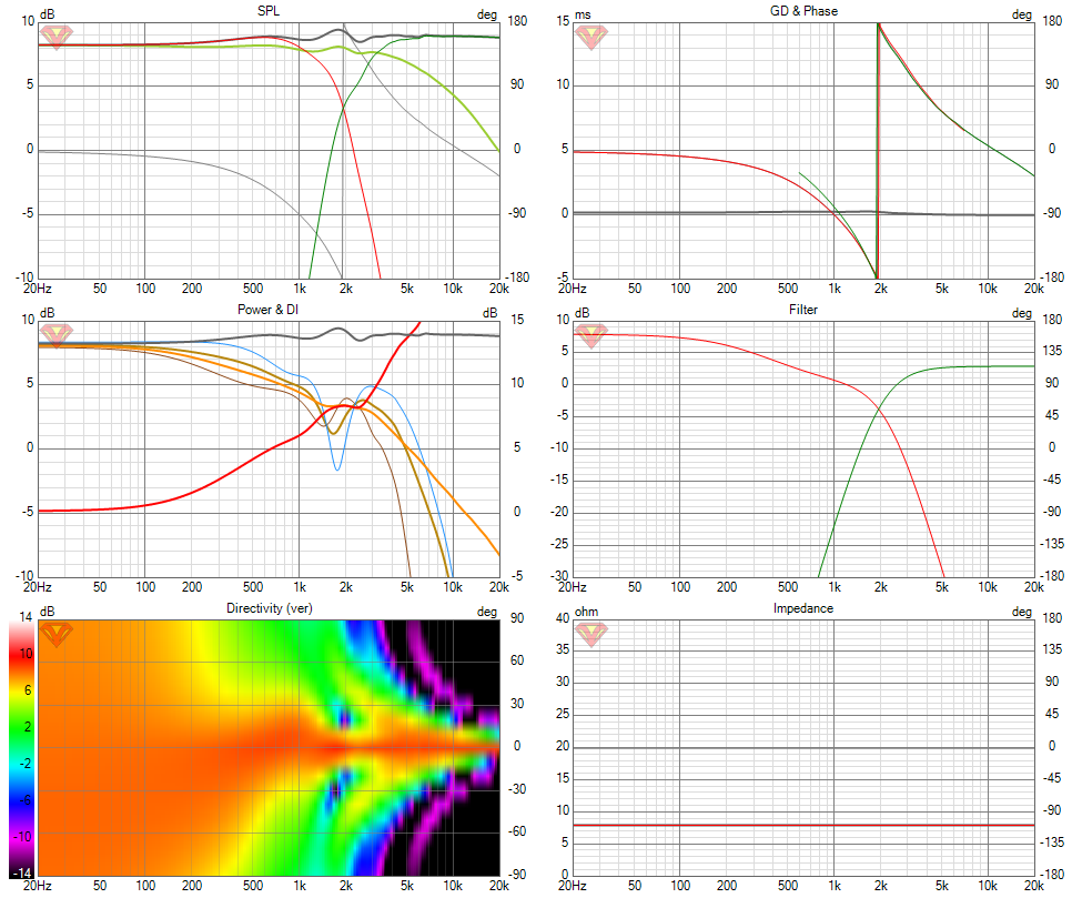

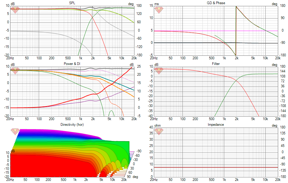

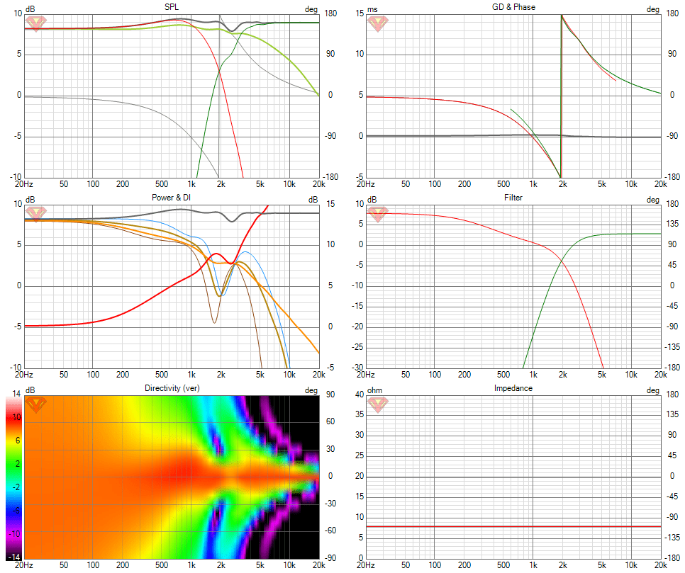

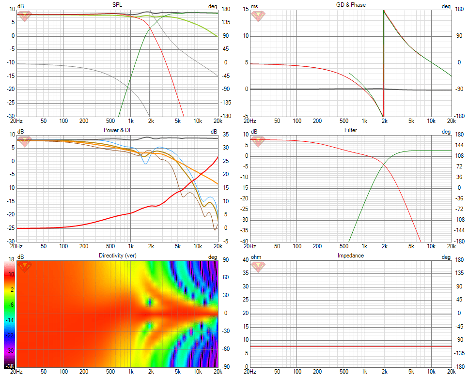

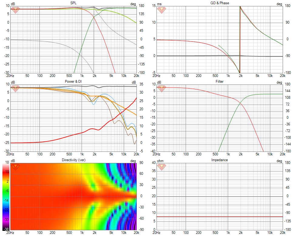

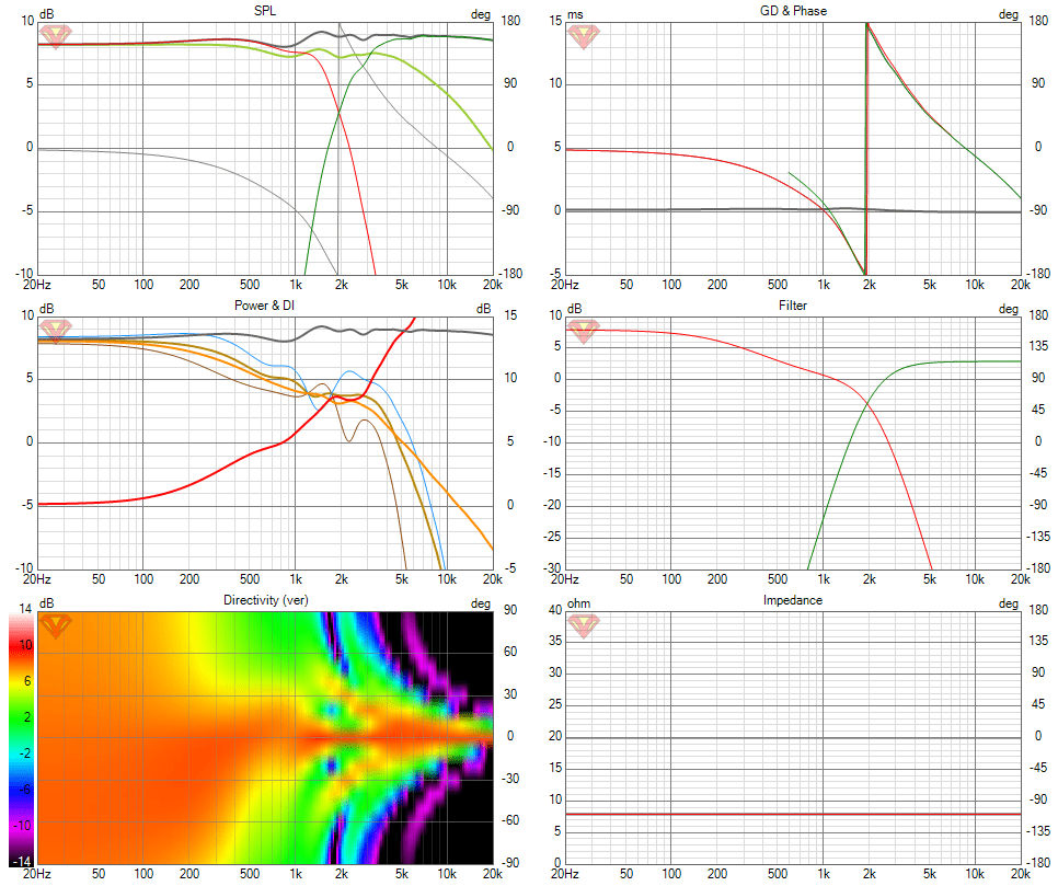

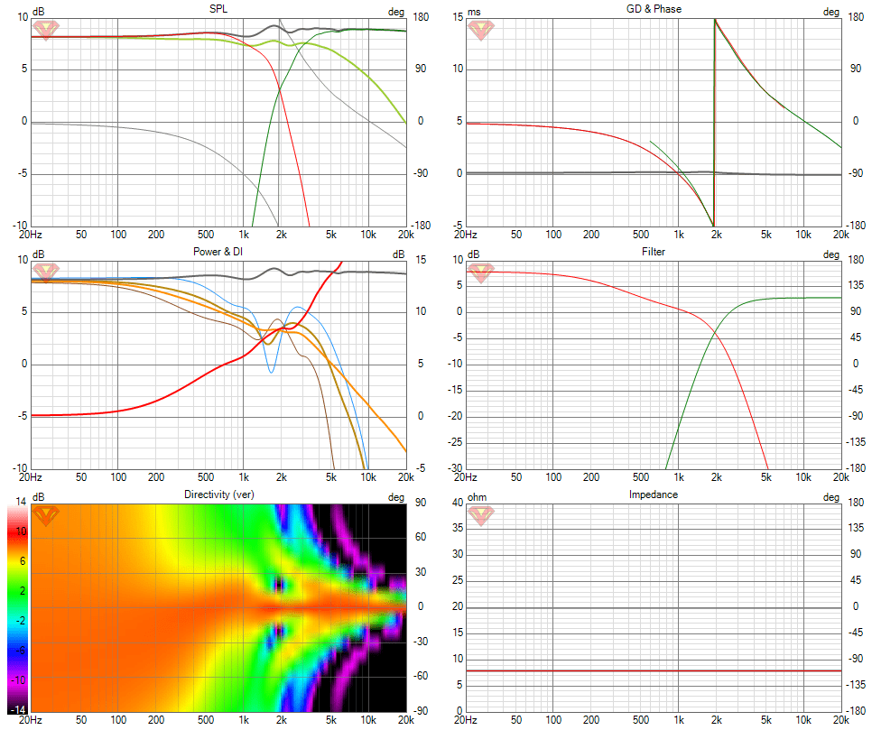

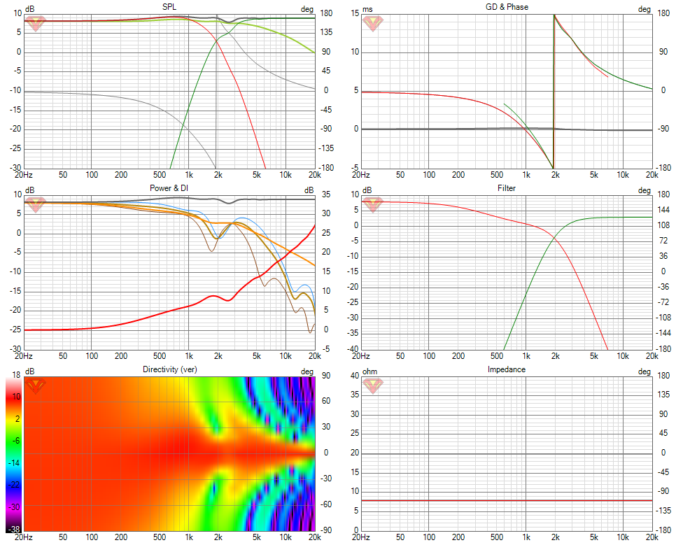

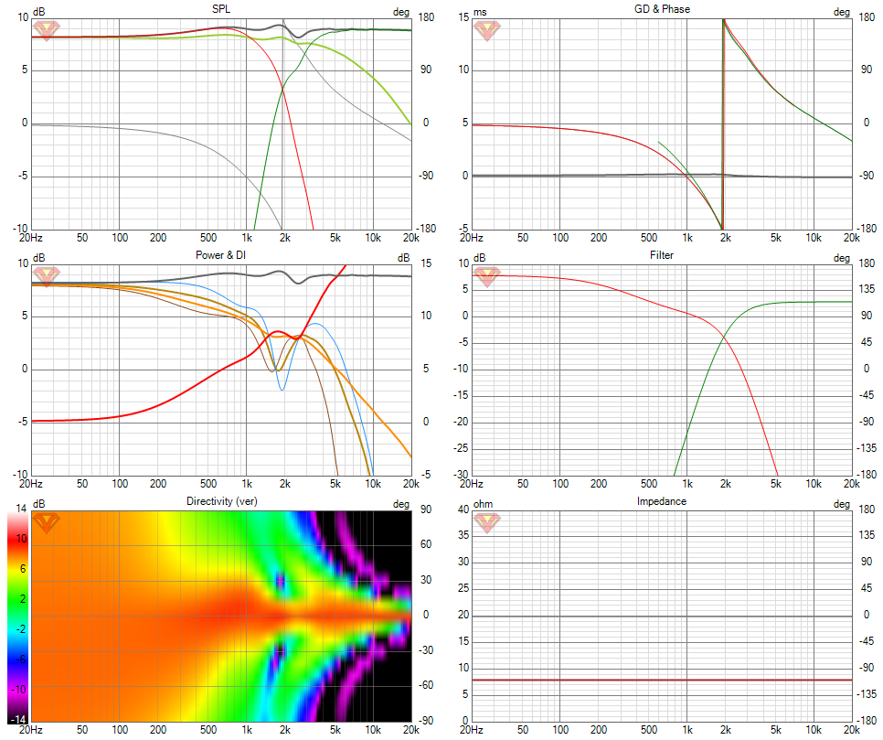

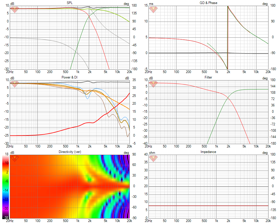

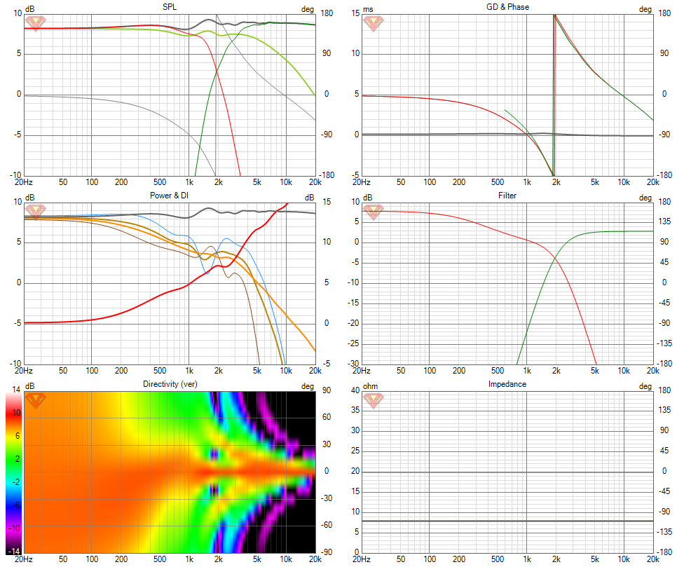

Looking for everyone's vote on which plot they prefer below. I'm specifically investigating floor and ceiling bounce, and their impact on in-room response, and DI. The models use a 6" woofer, crossed to a 4.5" midrange at 2khz. The reason for the 4.5" is that I needed something to mimic my waveguide at the crossover frequency. It rolls off fast >4khz, so just ignore that, it's not relevant to what I'm looking at anyway.
On-axis
In-room
ER Floor
ER Vertical (thick line)
ER Ceiling (thin line)
DI
On-axis
In-room
ER Floor
DI
CLooking for everyone's vote on which plot they prefer below.
Brandon,
Yes VituixCAD's default is for the CTA2034A, which I feel is too generous for crossover design.
Can you make your Y axis 10dB range? If that looks too rough and ugly, 20dB?
Not 50dB, which is akin to the difference between 0.001W and 100W ie. mute to full blast. Like really?
I only care about by F3, F6, may -10dB point, not -40. And if my speaker has a 10dB peak somewhere between 20Hz to 20KHz, isn't that already bad enough? Do I really need to see more?
Brandon,
Why C and D?With no other information, I would go for C or D.
I would not go for A and B because of the mismatch in the DI. But E seems to have the smoothest in room response
