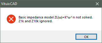

^Multiple problems in basic impedance model solver fixed/improved to rev 2.0.58.1 (2020-11-29)
Enclosure
* Initial values, constraints and parameters of basic impedance model solver improved to support all driver models, quantities and connections. May still fail with tweeters and illegal combinations of Z1k and Z10k.
Error message if basic model fails:
Enclosure

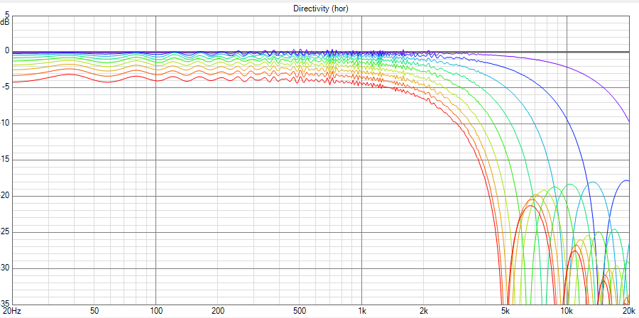

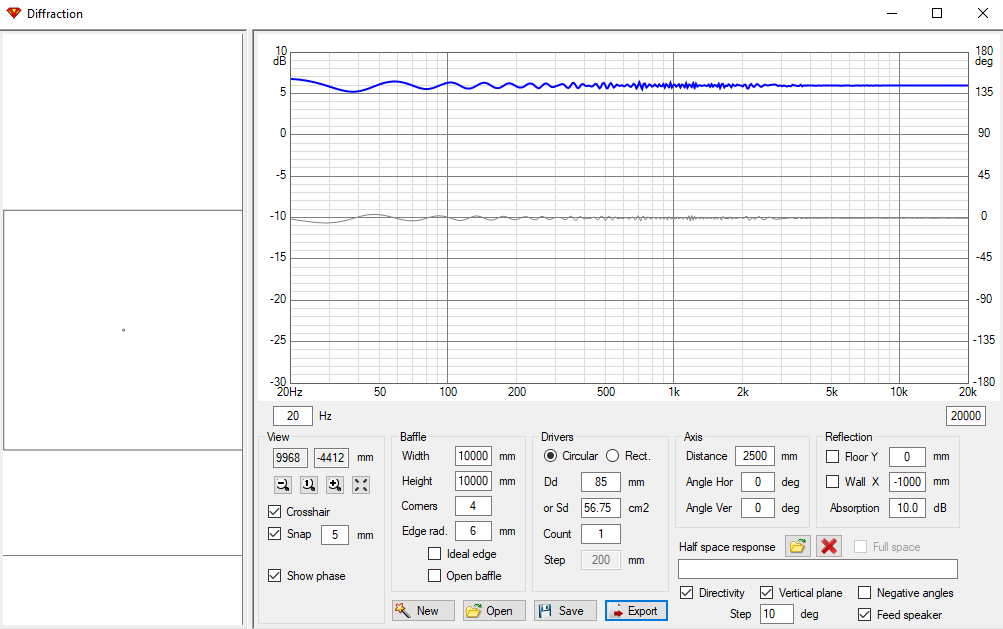

I am wondering if this is a bug. I exported a flat FR (no half-space response loaded) from a pseudo-infinite baffle diffraction sim (10000mmx10000mm). Shouldn't all of the off-axis angles be at the same level before beaming sets in? I don't have 'open baffle' checked, so I don't think there should be any cancellation from the back-wave.
Thanks!
--Myles

^Diffraction tool is not designed for any kind of infinite baffle simulation. That wouldn't make much sense if we're talking about box/baffle diffraction to far field = intended purpose of the tool. In addition, DED model used in the simulation doesn't have exceptions for near field simulation within the edges.
So at the moment without adaptive constraints in dimension parameters user should take care that edge cannot rotate to the "back side" of virtual microphone with any horizontal or vertical off-axis angle. I can add adaptive constraints if that helps to avoid mistakes.
Flat rigid piston directivity simulation in Calculator tool is more suitable for simulation to half space only, though actual radiators are not flat rigid pistons i.e. result is not very valuable in practice.
