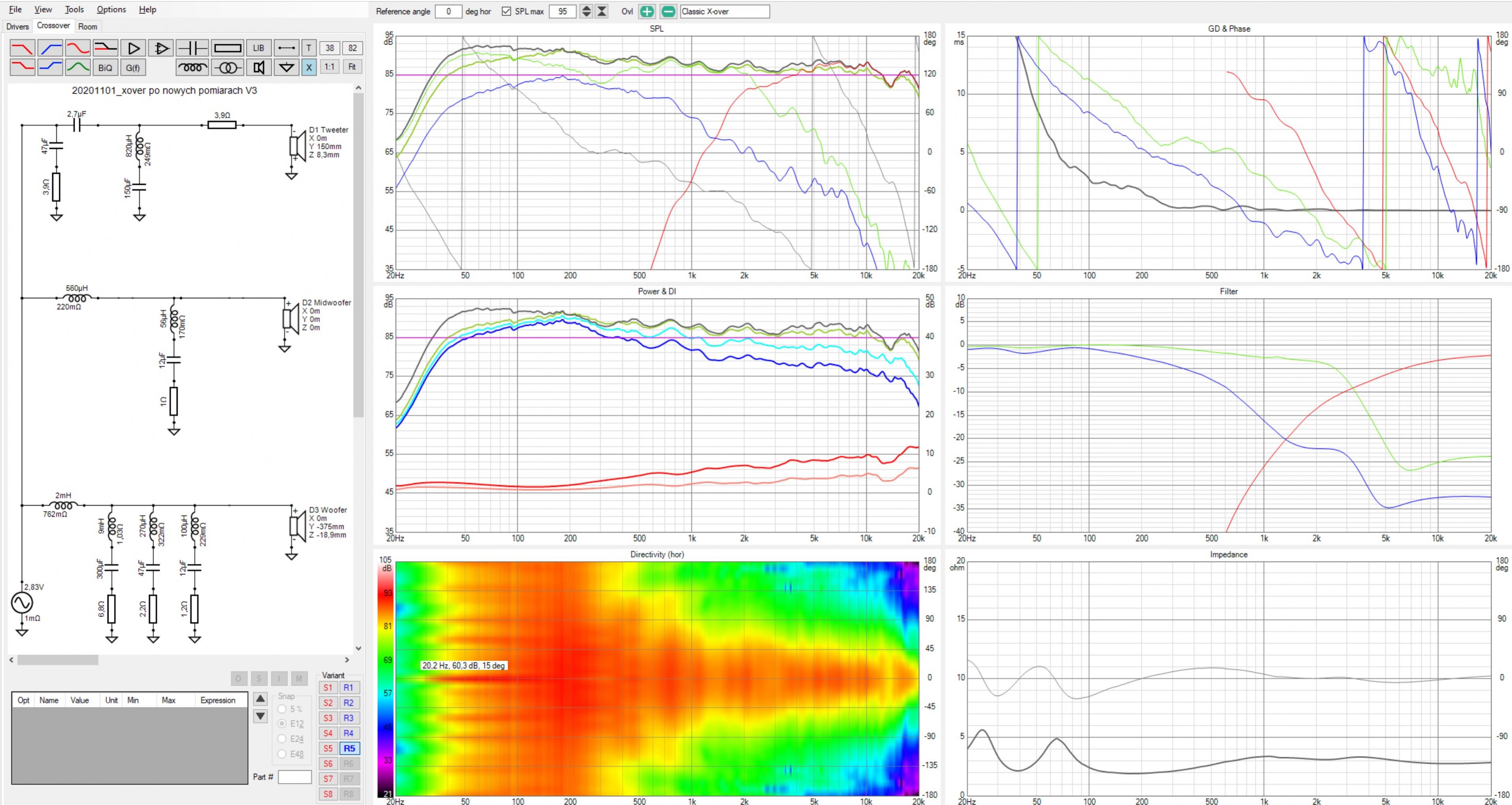

Hi Guys,
I have a question regarding GD & Phase Graph. When I tune some of the components in the crossover network I check how the GD & Phase Graph look like and sometimes I get the curve in the attached screen shot. How do you interpret this?
The vertical lines - It is on the graph. But in reality, the polarity is changed on reversed. The fact that two speakers work in phase is good, there is sound. In antiphase - no sound. In the above graph, this concerns a small section at -20 dB from the main graph. 2-3 kHz. But it can cause a lisp in the sound.
Better when it's not. But, most often it is. You can get rid of this by changing the volume of the speaker box, changing the speaker parameters (if you know how), and also changing the measurement conditions.
I was just curious why this occurs. I can handle it by changing values of some of the components in the x-over so that I get result without it and still maintain good frequency response. This isn't an issue I cannot solve in xover design. I just didn't know whether this will be audible. Anyways I wouldn't leave it that way.

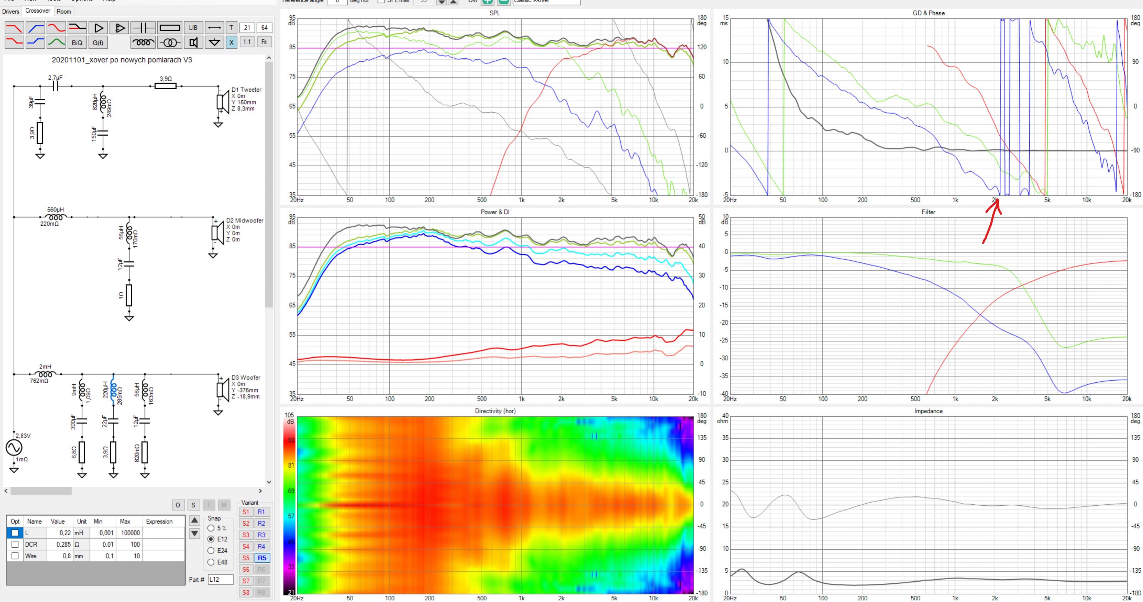

As tmuikku said, it's just visual feature to wrap phase value within 360 degrees in the graph. Vertical jumps are not faults i.e. nothing should be done to XO design assuming that design is okay otherwise. I really don't want to split phase response curve to multiple curves to avoid graphical jump from -180 to +180 deg. Just forget if you don't understand it.
If I may:
I think the question was as to the somewhat "grassy" phase rotation presentation at about 3-4 K in post 2509 (resulting from the bass driver's resonance).
As opposed to a clean single vertical line of rotation as shown in post 2515, where the resonance was tamed down in the x/o, and so was the phase...
Nothing to worry about.
