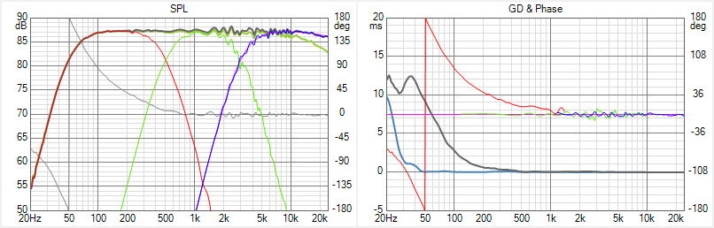

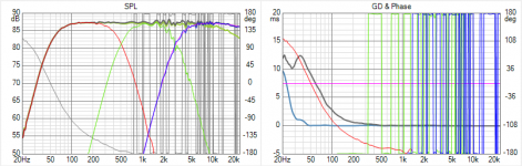

I think the question was as to the somewhat "grassy" phase rotation presentation at about 3-4 K in post 2509 (resulting from the bass driver's resonance).
As opposed to a clean single vertical line of rotation as shown in post 2515, where the resonance was tamed down in the x/o, and so was the phase...
Nothing to worry about.
Yes exactly. I just changed some values of RLC circuit in the bass driver around it's resonant frequency.
Here is good example about tiny variation in phase response causing dramatic phase wrapping. It's Epe-3W demo with minimum phase FIR crossover calculated with 1/3 oct. smoothing and plotted without smoothing, all drivers inverted and not inverted. Nothing really wrong so it's just visual harm due to continuous phase response trace wrapped within 360 deg.

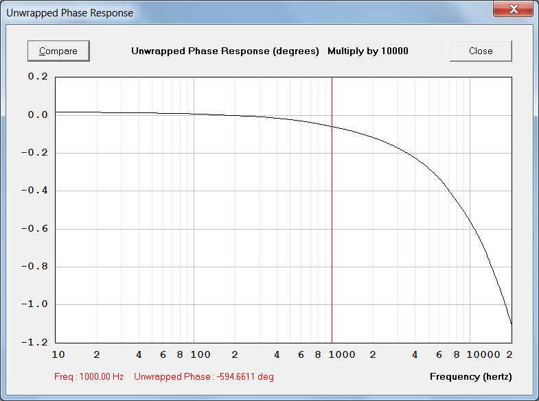

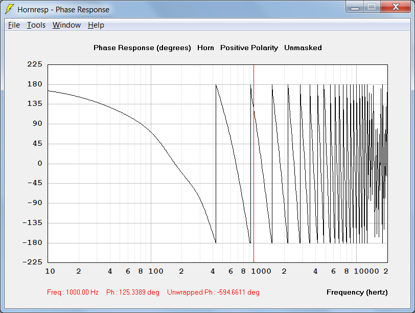

if the phase was in different scale, say -1800 to 1800 degrees you wouldn't see the line wrapping to the other side of the graph.
Just to clarify, there is no real need to extend the scale range up to positive 1800 degrees.
To illustrate, the first attachment shows a standard wrapped phase response. The second attachment shows the same response with the phase unwrapped.
