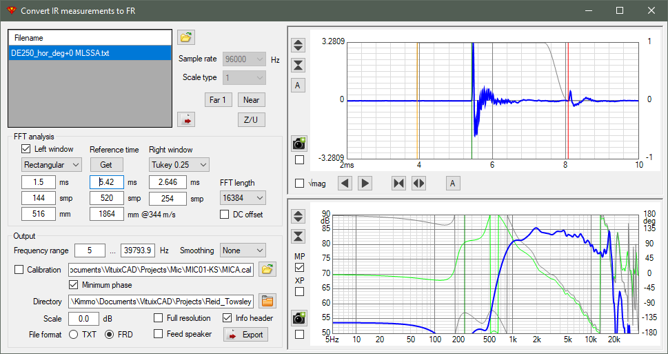

^Received, thanks. RES file looks hopeless because it's binary. Exported txt file has just time series without information about sample rate or interval. Number of samples equals to number of rows.
At the moment exported txt file is readable as MLSSA txt after the following three lines are added to the beginning with some text editor:
0
0.010416666666666667
262143
2nd line is sampling interval in milliseconds. So the easiest mod to the program would be asking sample rate and counting rows if the first line is not " 0".
0
262143

Thanks so much for having a look, and the addition sounds good to me. My only other suggestion may be a prompt for "multiplication factor" on import to account for any IR files that may have been exported without using a normalization coefficient of 1.0.
The key factor with SoundEasy is to keep track of recorded sampling rate and and to make sure you always set the export normalization coefficient to 1.0. By default SE will automatically set the coefficient to the value at the peak of the impulse, so the maximum value of the exported data is 1.0. I'm at a loss to determine any benefit that this coefficient provides.
^Small improvement done.
2.0.58.2 (2020-12-07)
Convert IR to FR
* Program asks sample rate and counts data rows if loaded text file does not contain header rows of MLSSA txt format.
Convert IR to FR
