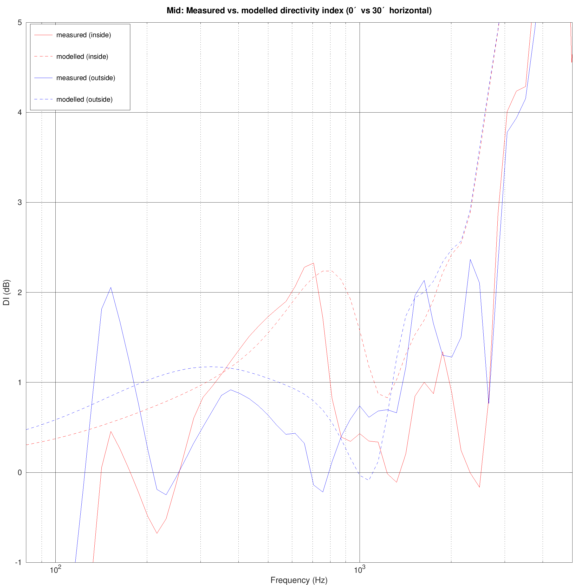

I used the Vituix diffraction calculator to determine the directivity index (DI) from the difference between on-axis and off-axis diffraction curves. My measurements show better consistency with the modelled curves if I invert the direction of the horizontal off-axis angles used with the diffraction calculator. This is how I did the attached figure.
Could this be a bug in Vituix? Is there a simple way to test?

Logic is the same with Diffraction. Reason is that you could merge diffraction simulation to measured responses or use measured data for mid while simulated data for woofer.
So this answer was B.S. Angles in measurement data are mirrored compared to responses exported with Diffraction tool. Rotation angles in horizontal plane are specified generally: "positive to counter-clockwise from top view" for baffle rotation in Diffraction tool, driver rotation in main program and mic rotation in measurement data.
At the moment diffraction simulation can be merged with measurements as far field responses if baffle is symmetrical (enough). That is typical situation with woofers in horizontal plane, but in other cases not so much.
Easier cheap trick would be changing of angle sign in Diffraction tool, just exports or whole tool. That is probably what I will do because angle values are located in "Axis" group which hints that mic/ear rotates. Not the baffle, how it is now and documented also in user manual.

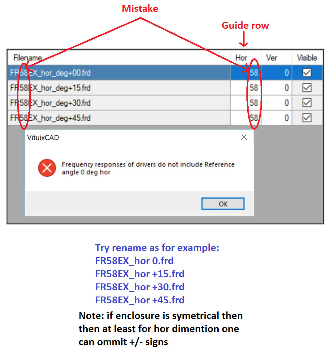

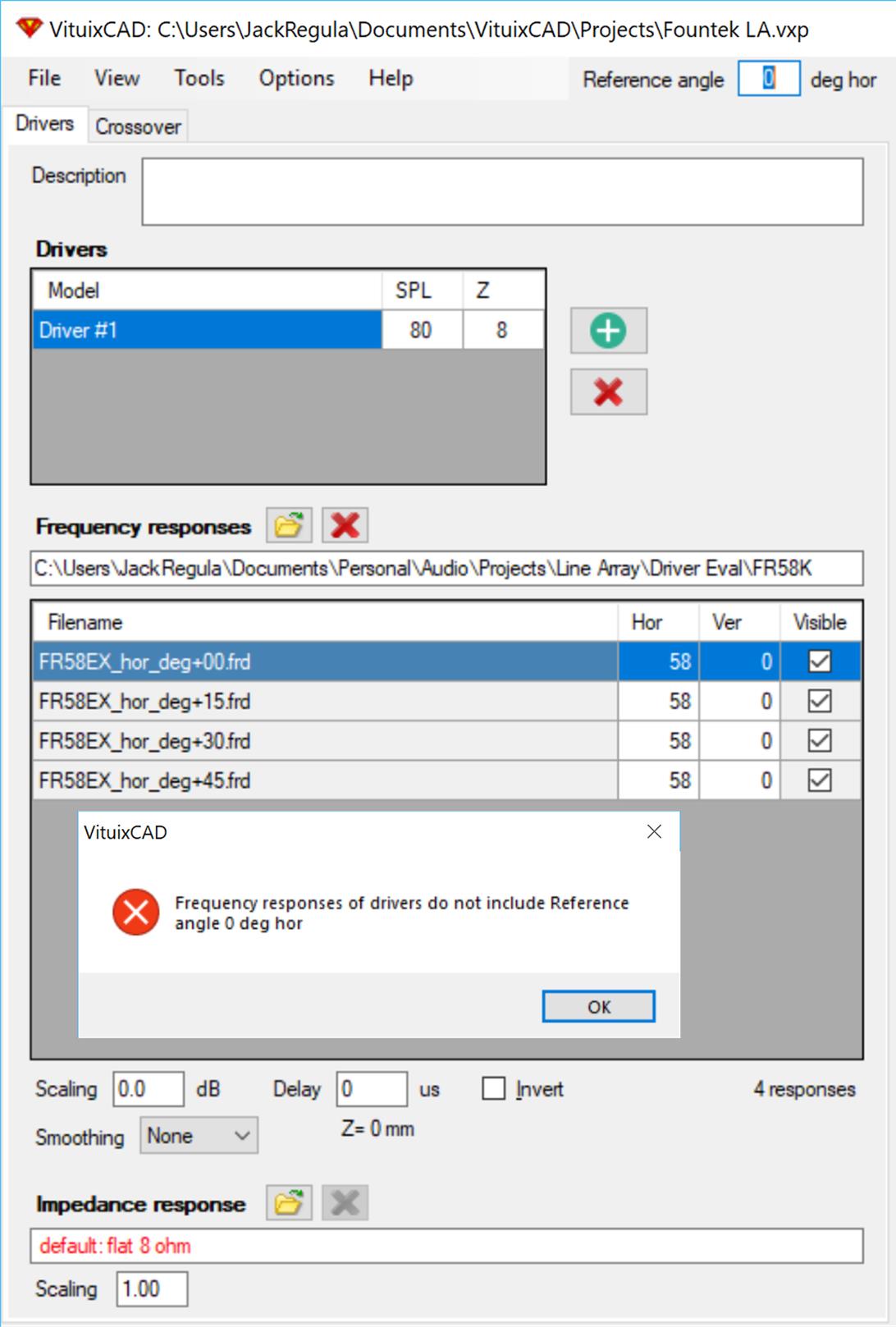

Still learning your great tool. My REW measurement export FRDs aren't being accepted. Any hints as to what to look for? I believe I have the file name angle encoding right. Do I need something inside the files?
attachment.php
Thanks,

Thanks.
renamed as suggested and it works. had to take the "58" out of the name also
Renaming was not needed. Original ARTA style filenames with "hor" or "ver" keyword before angle value were perfectly legal. Just change Search direction to From end in Angle parsing from filename group in Options window. That is default/initial value which works with both ARTA and CLIO.

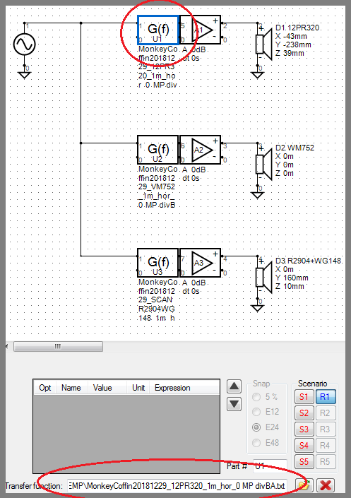

Over think the latest 4-6 software versions learned about and begun use practical "Transfer funchtion file" block to research and simulate stuff and ideas, thanks for that feature of possibilityes. Always had one minor bug with that feature and manual doesn't hint i'm doing something wrong about file and format, culprit is even session is 100% sure saved and path for transfer file is looking right at lower left corner then after a new re open of session then various plots doesn't reflect correction from transfer file, path at lower left corner is looking right and i have to reguide it down there vis explore dialogs to same file as path told for each of used Transfer funchtion file blocks to get various plots update to intended situation, visual example is below.
