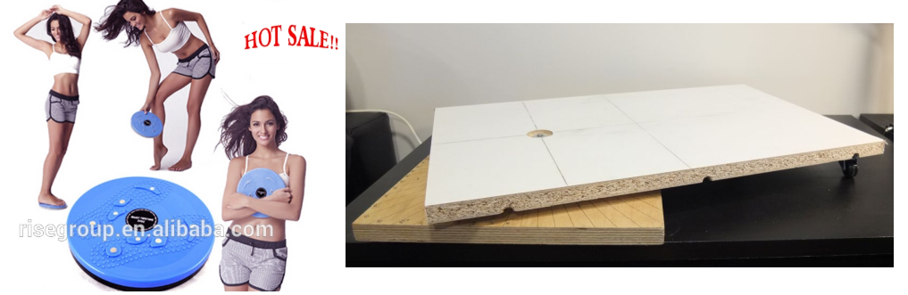

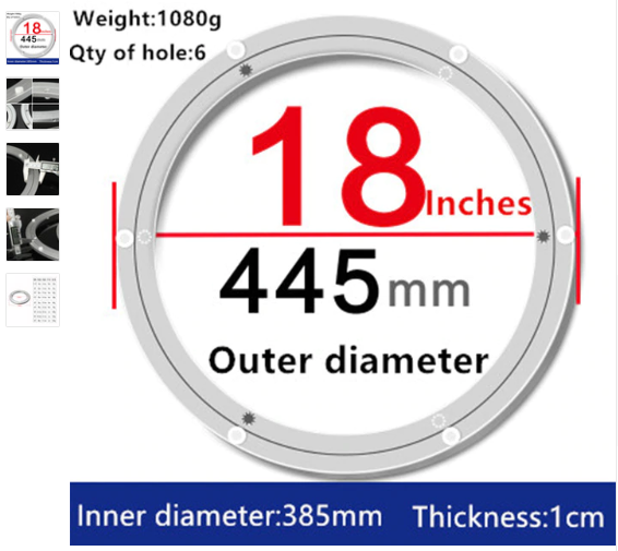

Making a low cost manual rotating table is not expensive nor hard to anyone capable of doing a basic speaker box.
My current one uses one of these waistline training disks as a Lazy Susan bearing between to plates. But I've just ordered this proper Lazy Susan bearing from AliExpress for about 45EUR with shipping. That'll create a new version with overall thinner dimension.
I skipped that bearing system and invested on a pack of felt pads as sliders. A coated board is very slippery!
