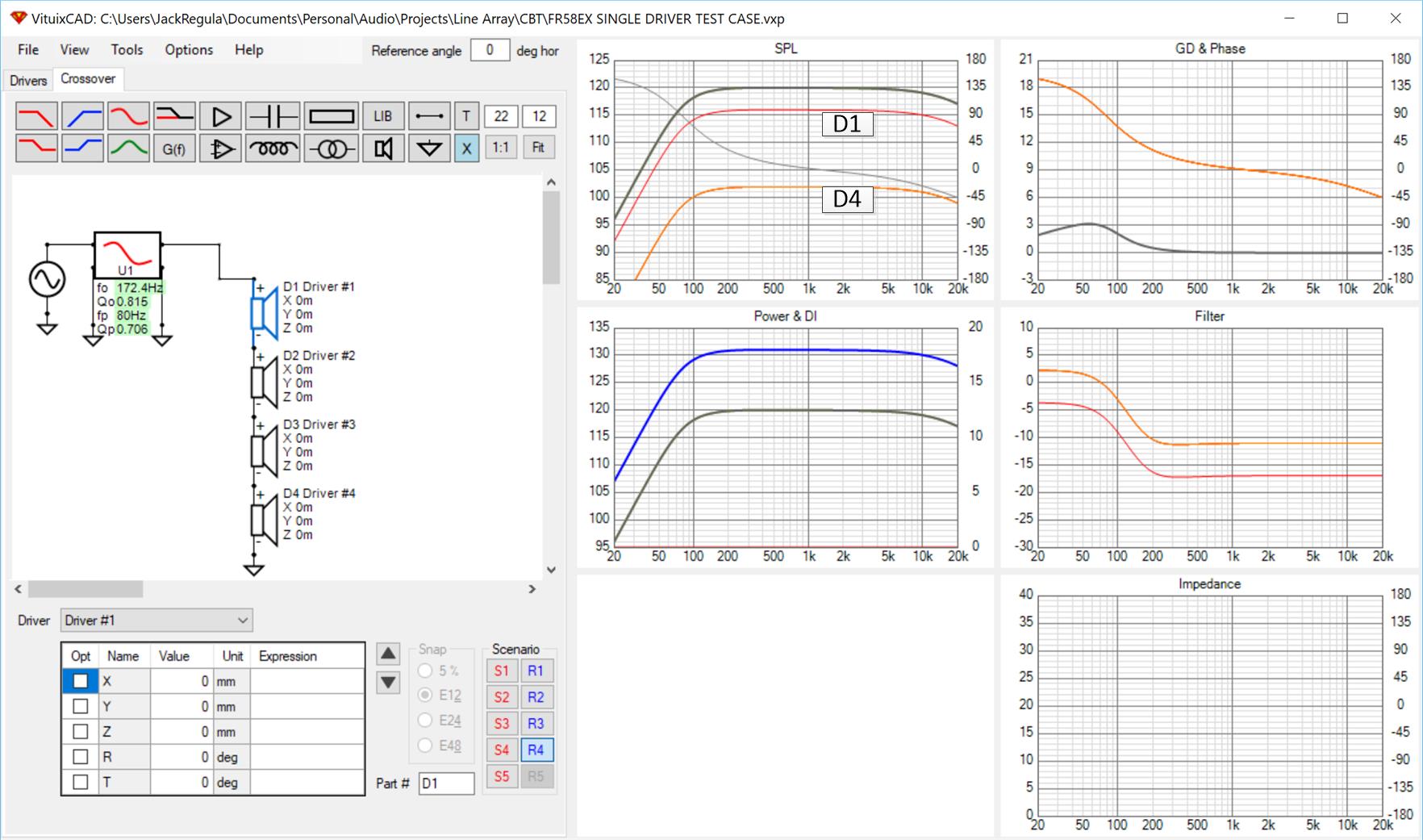

My end goal is to use Vituix to develop a passive weighting network for a line array. I have some questions from that effort so I've put together a simple test case to illustrate them.
As you can see below it has 4 drivers in series, all Fountek FR58EX full range drivers. I've loaded identical measurement (SPL & Z) files for each of them so I expect the SPL contribution of each driver to be identical. To test this I mute all drivers and then unmute one at a time. The top driver, D1, produces an output 12 db greater than any of the other 3. Your SPL plot shows this in the red D1 and D4 traces below the total SPL trace that I've annotated. Can you explain this? It doesn't make sense to me.
Regarding unmuting one driver at a time to see an individual driver's SPL: is there an easier way to do this?
Is there any way for the user to control which individual driver responses show up in the SPL graph?

You can see I've got a Linkwitz Transform configured in the circuit. I expected to have the flattest response with Q0 set to .707, which the box is auto aligned to. However, I saw a db or two of peaking at the box resonant peak which flattened out when I raised Q0 to .815. This seems to be an impedance effect. Are you modelling a non-zero source impedance? (Include Qb and Rs in the enclosure tool are unchecked.)
It would be nice if the enclosure tool allowed me to specify 24 drivers but its easy to scale the sealed box size to 2x the number of drivers. Were I planning a bass reflex box it would be more of an issue.

Should not add measurement data for every individual driver in line array. Only one driver data is needed and that data is used for all driver instances in crossover. Decades easier to handle project and avoid mistakes with frequency and impedance responses.
Active Buffer is able to measure and show load impedance of it's output in active and semi-active projects. Or if user wants to see load impedance of driver groups (usually called as "ways") in passive projects. This is shortly explained in user manual, in the middle of page 18.
Sensitivity issue is probably due to wrong impedance data. Simplify that to avoid mistakes.
Drivers can be selected with window or multi-select with Shift or Ctrl key pressed to make muting easier.
You should also simulate only one driver with Enclosure tool. Same story with Diffraction. Data for single driver makes everything much easier because you can freely clone that data in crossover.
Here is proper implementation of short line. Note that correct Y mm coordinates help identification due to small delay/phase differences at virtual listening spot.
Thanks for that. I didn't get a notification email or I would have seen it hours ago.
Yes, it would be so much easier to enter data for just one driver - I was wondering how to do that but now I see just place multiple instances of Driver #1 on the schematic.
I had already assigned Y values to drivers and as I did I saw the FR take on the expected -3db per octave response slope. But the array is a CBT so I have to do some trig to get the correct Y and Z values and inclination angles. That part was very encouraging.
