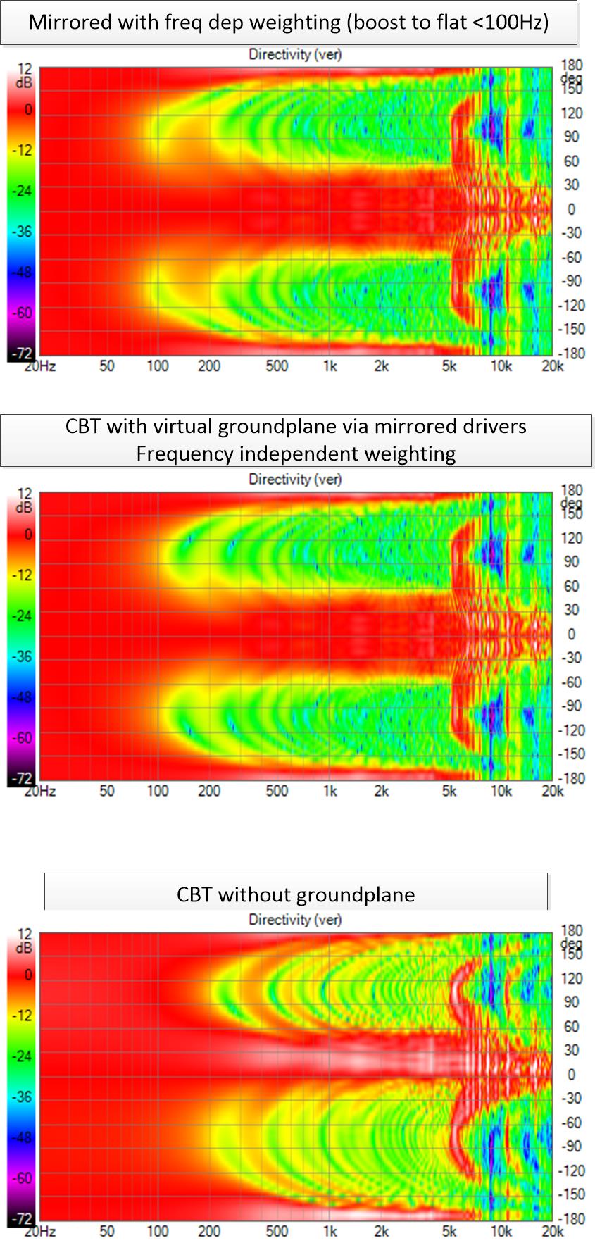

I suppose its also OT (apologies) but I'd like to show the attached on groundplane CBT directivity if for no other reason than to show off the power of Vituix.
These curves are from a 24 driver (2" piston), 36 degree CBT. Mirroring the drivers to approximate the ground plane response made a huge difference and directivity holds just about down to 100 Hz. The weighting/shading costs 3 db in SPL in excursion limited region and the 2" drivers are already a little bass shy. Trying to get this 3db back by essentially unshading below 100 Hz with first order PEQ causes vertical lobe to appear between 100 and 200 Hz. Perhaps this can be fixed with sharper roll off on the LF boost. Its awesome to be able to explore and optimize this before making any sawdust.

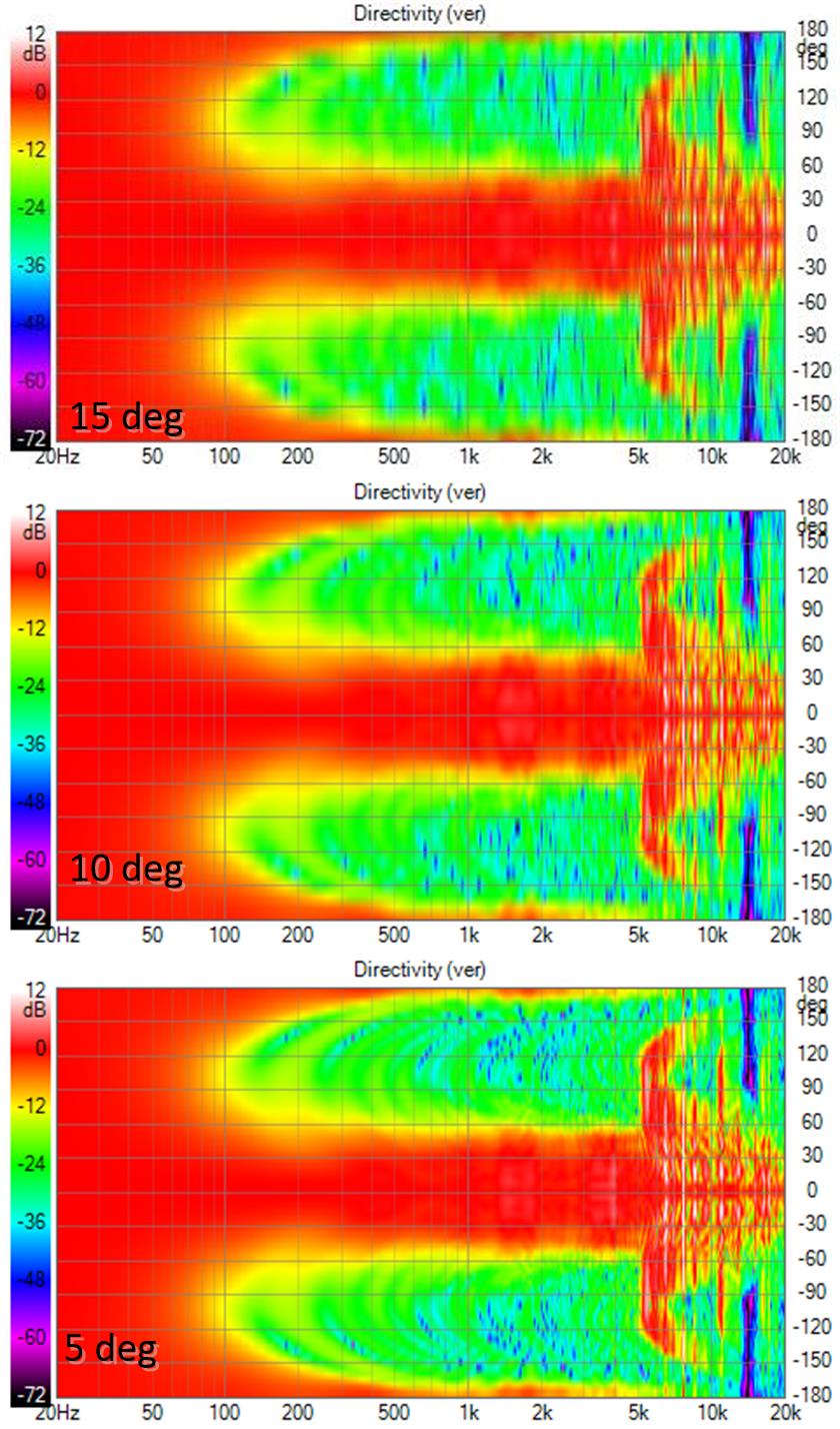

Maybe you are already aware that response data with 5 deg steps does not give very accurate vertical off-axis simulation with line arrays because frequency responses are not interpolated between measured/simulated angles. Delay/phase information is calculated by distance differences so that part in simulation is accurate, but program selects off-axis response from Drivers tab which is closest to angle between driver's axis and 3D line from center point of driver to mic/listening point.
We would need off-axis responses with 1 deg angle step to get the most accurate simulation VituixCAD could offer, but 360 off-axis responses (per plane) keeps program so busy that using becomes too inconvenient (though simulation result looks very nice). Minimum step in Diffraction tool is kept as 5 deg because simulated off-axis will not be accurate anyway.
I wasn't aware of that. But how accurate is "not very"?
And how accurate does it need to be at this stage where I have already decided on a CBT and I have to make choices about height of the array, number and kind of drivers. Even not very accurate might be good enough and would be better than nothing provided its not misleading.
I think I will compare sim results for 15, 10, 5 degree steps and see if there is a trend

Here are plots with 5,10, 15 degree steps set in diffraction tool. They are all qualitatively the same. If I look closely. I can see differences in the yellow green transition regions. I imagine with 1 degree steps, we could see fine detail in these regions. I wouldn't mind waiting a few minutes for Vituix to crank out that level of detail when I felt I needed it. But I'd probably also want a cancel button for when I forgot to see the step size back to a normal 5 degrees
Angle resolution of off-axis data and directivity difference between actual driver and ideal piston are the most obvious errors with simulated data. I could easily reduce minimum angle step of diffraction simulation down to 1 deg, but that would not reduce the other error a bit. This kind of simple simulation is inaccurate anyway, but hopefully gives some information about whole project before making any prototype for measurements.
With measured data we are able to reduce both errors (in addition to error in baffle diffraction simulation). Angle resolution could be 1 deg and off-axis data with actual driver - not just simple simulation with Bessel J1 function. No need to built whole array.

I would measure with 5 deg step despite of some inaccuracy. 5 deg step allows merging of simulated LF directivity and measured HF directivity. That could be useful if directivity information of far field measurements is not logical and reliable enough at LF.
Motorized turntable would be helpful with 1 deg step
