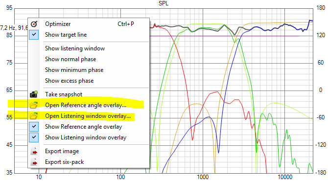

It would be great if it were possible to load some "target curves" from external files (FRD format or similar). These curves would then be displayed in the background of the SPL chart (as thin light grey lines?) in order to serve as targets when designing the x-over. This would be very useful to understand how close a given filter design gets to a predefined target, which is very difficult at the moment.
^You can load two files as overlays to SPL chart via context menu, but they cannot be used as acoustical target for Optimizer.
Loaded overlay of Filter chart can be user as a target for Optimizer while iterating filter's transfer function. This feature is designed for filter cloning from speaker with unknown component values.
Each driver can have individual textbook target curve for acoustical response to reference angle visible in SPL chart. This could mean e.g. 20 individual target curves in practice.
Total SPL (to ref angle) and power response have straight target lines in SPL and Power & DI charts. Both charts have two overlays (with left Y scale) which can be loaded from file. Reload is needed with multi-driver application if response files are used as manual targets for individual drivers. Optimizer is not available for this.
Filter transfer function has single/common target curve which can be loaded to Filter chart. Reload is needed when moving to next driver.
That's it. Unlimited possibilities are available, but some design methods take more time. I'm not willing to add support for design methods which are not effective and rational imo.
Aha!? How do I do that? The only way to load a target curve I have found is to right click on the SPL chart and load a target curve for either the "reference angle overlay" or the "listening window overlay". I can get two target curves like this, but not more.
^First I have to underline that driver target curves are not loadable from response files. They are ideal text book curves you specify in Optimizer window with seven parameters; for high pass, low pass and SPL.
If this was not terrible disappointment, continue to user manual page 18 section "SPL Target curve of Driver". Refresh pdf that you have the latest version for 2.0.10.4 (2019-01-16).

Could be wrong here you need help so ignore if you already got it so far : ) Feature is not called or named as target curve but a rightclick with mouse in SPL plot brings two options for loading overlays as seen below for your tweeter and mid and when done shift tweeters overlay with woofers target curve:
attachment.php

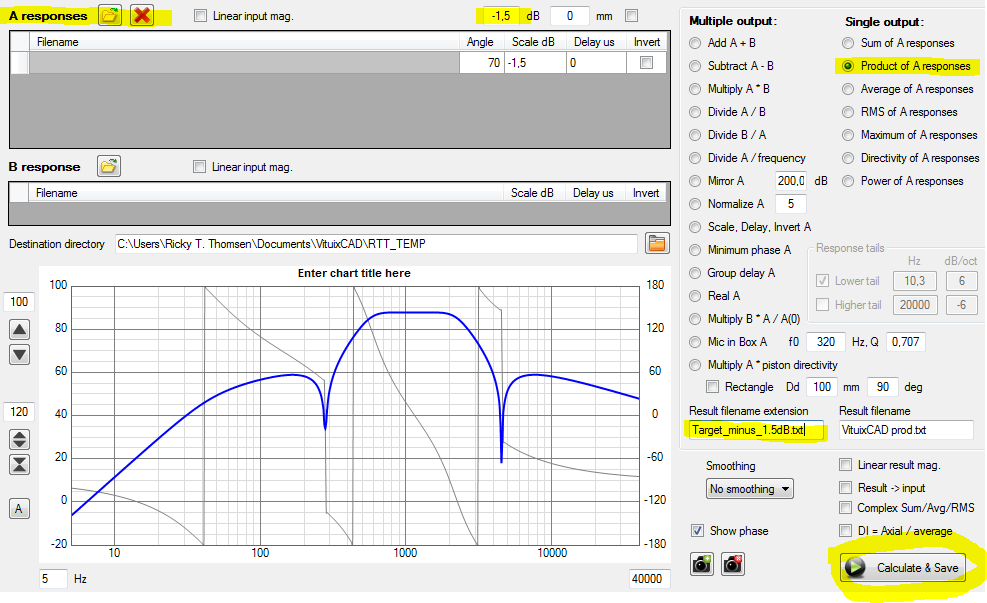

Should those target curves need some SPL offset to fit the puzzle use Calculator tool as in example where mid is lowered minus 1,5dB:
attachment.php

Level of visible overlay(s) can be adjusted simply with mouse wheel above the chart. First hide overlays you don't want to adjust by unchecking Show ... overlay and then wheel up/down on SPL chart.
PS. Scale, Delay, Invert A function is designed for scaling in Calculator, though Sum, Product, Average etc work too if only one response is loaded into file list A.
