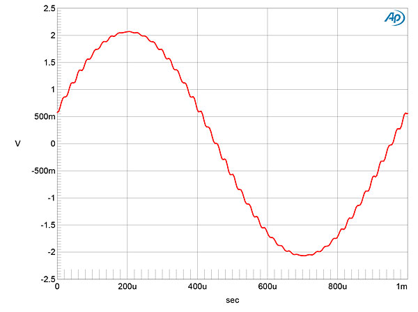

I looked at the Holo May NOS/OS Dac that was mentioned a few postings back, and a read a Stereophile review.
Although results are very impressive, I have a few things that I don't get.
1) A NOS Dac is supposed to produce a perfect impulse response, but the Holo May does not, see image 1
2) The reproduction of a 1Khz sinewave in NOS should show a perfect staircase, but the vertical lines are skewed, see fig 2
3) The Holo May stops reproducing in NOS at 20Khz, no matter whether the input is 44.4, 96 or 192Khz.
With these 3 points, I can only assume that some digital filtering is taking place, since the noise spectrum in NOS mode shows a perfect Sinc, indicating no analogue filtering ?

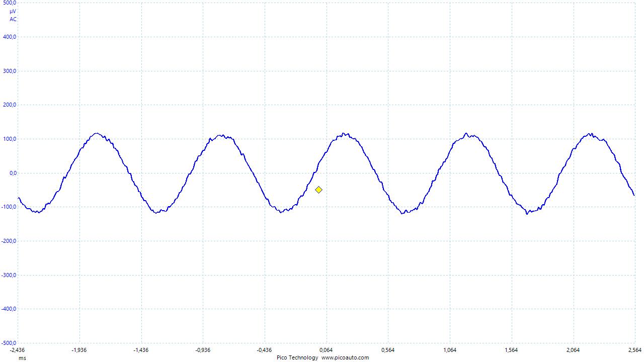

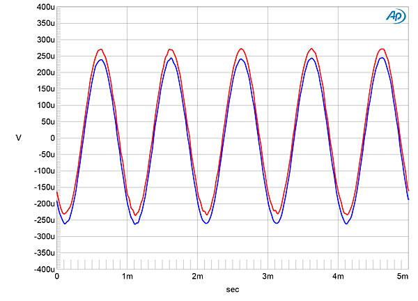

Last but not least the 24bit bit reproduction of an undithered -90.31dBfs input signal.
This is the best I have ever seen. Compare it to same signal processed in my heavily modified DAC with battery supply, resp. fig 3 and fig 4.
Hans

What's the bandwidth of the AP and what kind of anti-aliasing filtering does it use?
Fig.1 shows the May's impulse response with 44.1kHz data in NOS mode. Ignore the very small amount of symmetrical ringing before and after the single full-scale sample, which is due to the antialiasing filter of Audio Precision's A/D converter operating at a sample rate of 200kHz. This graph indicates perfect time-domain behavior due to the absence of a low-pass reconstruction filter.
Interesting, how their anti-alias filter does not appear to be linear phase. Looks like a hybrid of linear and minimum phase reposnes, possibly. I've seen at least one DAC designer advocate such an reconstruction filter hybrid impulse-response.
Or, maybe, it's something else entirely. 😀
