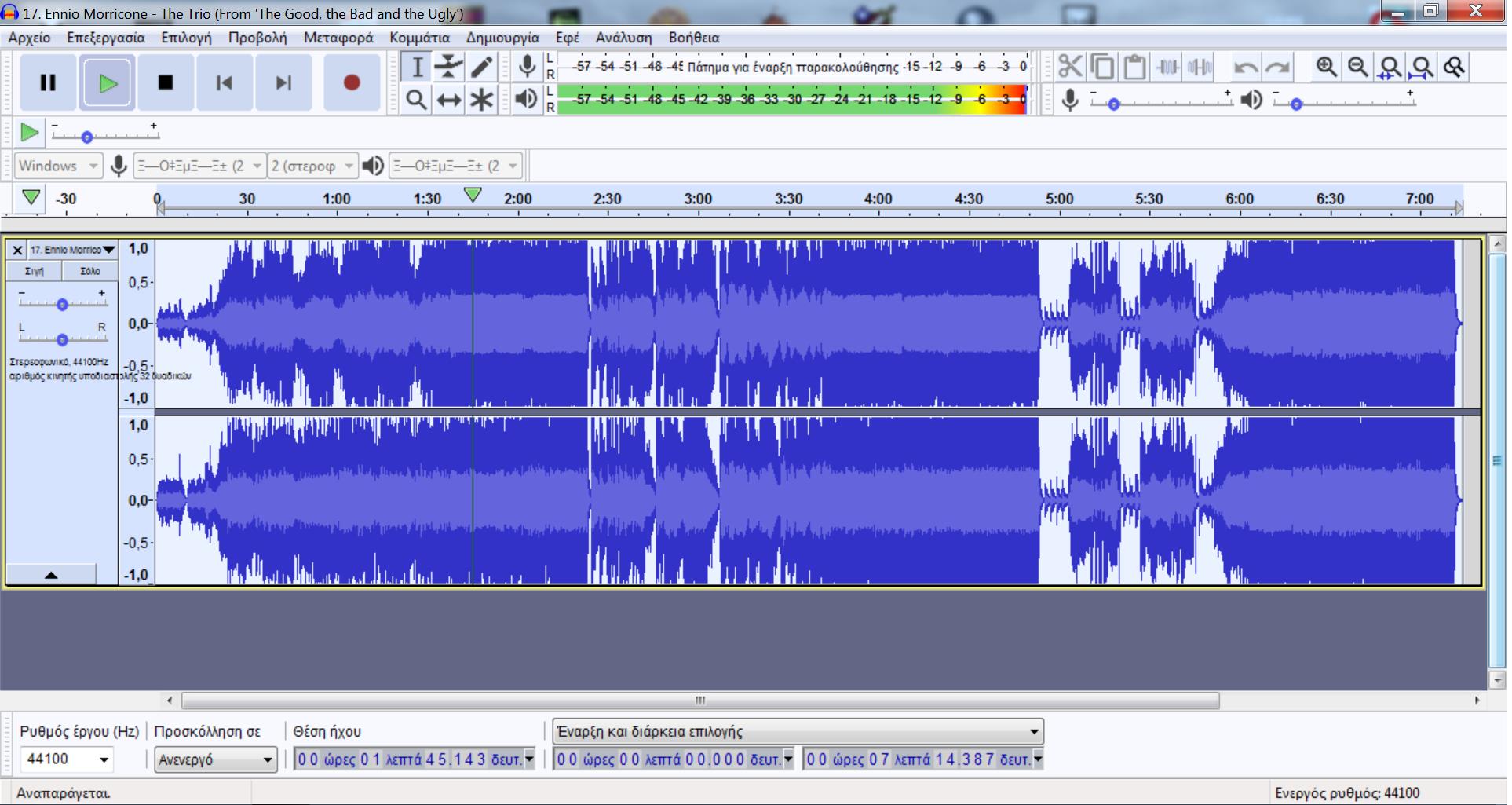

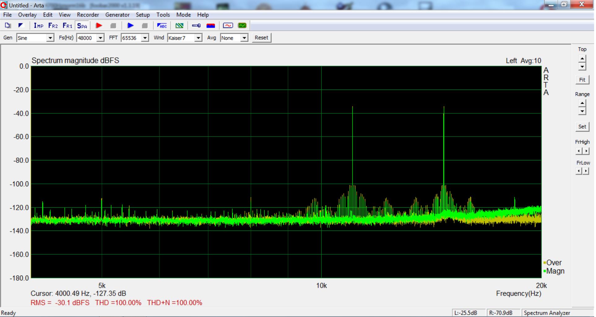

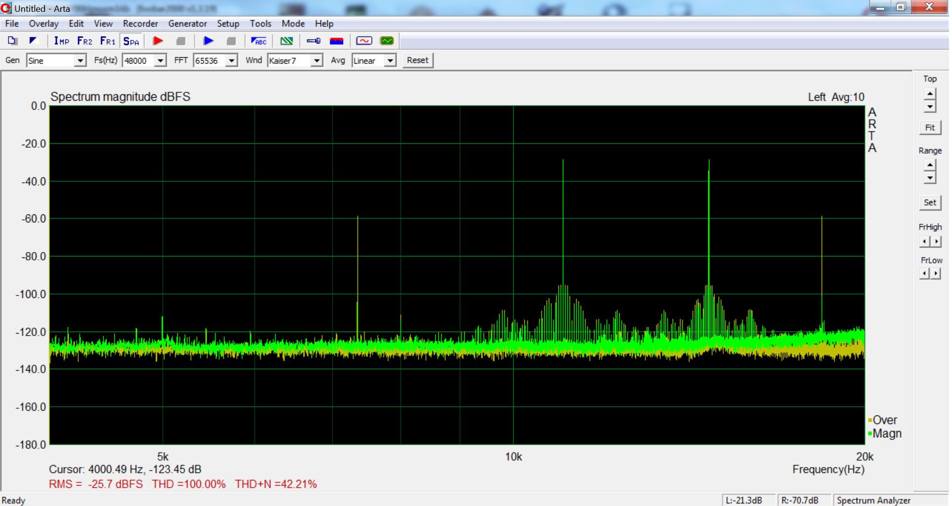

Intersample overshoots
First with original test signals. The first signal measures the same in both OS and NOS and sounds just a bit louder in OS. The second signal -first pic- measures and sounds different. OS is yellow, NOS is green. Distortion can be easily heard.
Then with levels halved. No measurable difference - second pic. Both signals sound a bit louder in OS. All in all, as expected.
Finally the next logical step. I processed the aforementioned track with the trumpet with audacity to reduce level by 6dB. Vibrato was just a bit more dynamic in OS than before but in NOS got worse. Both modes now come closer but in the wrong way, so I don't feel this is the way to go. I attach screenshots of the file before and after processing. The original seems like compressed but it doesn't sound so. I think it hits zero without clipping. The processed file sounds compressed if this makes sense to you...

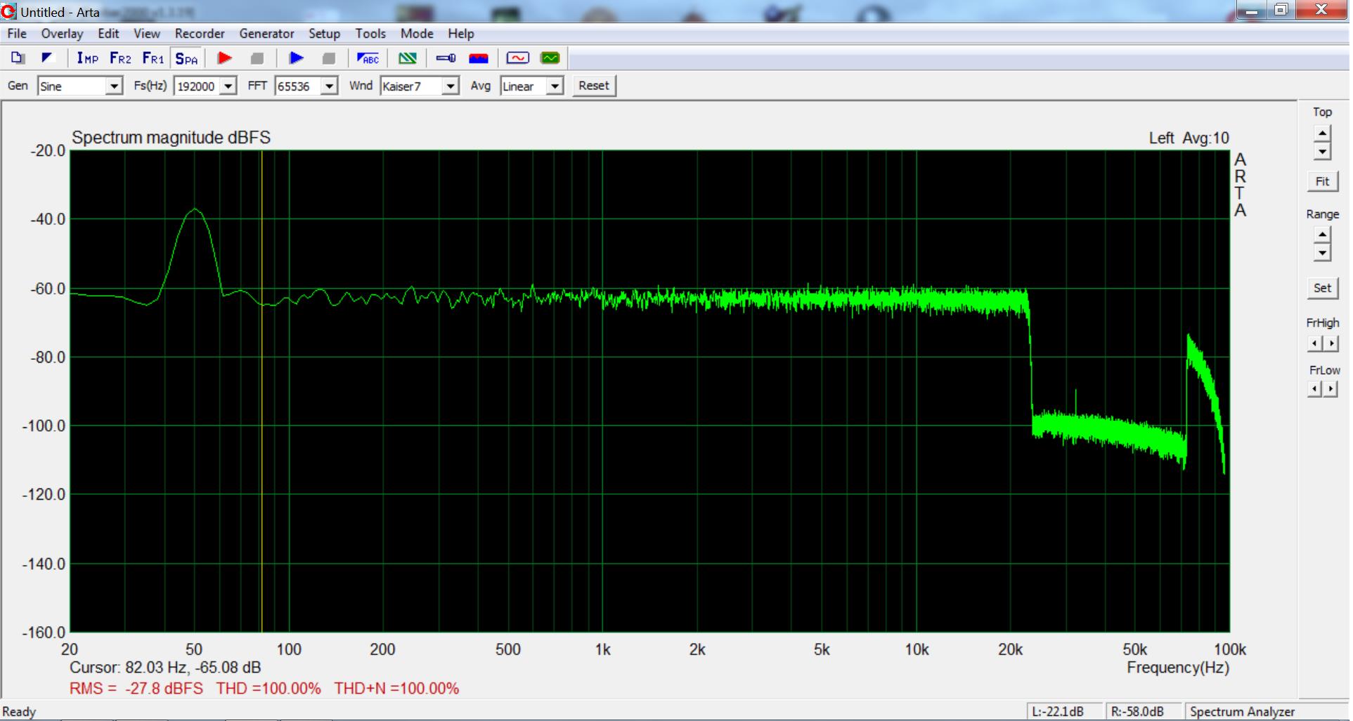

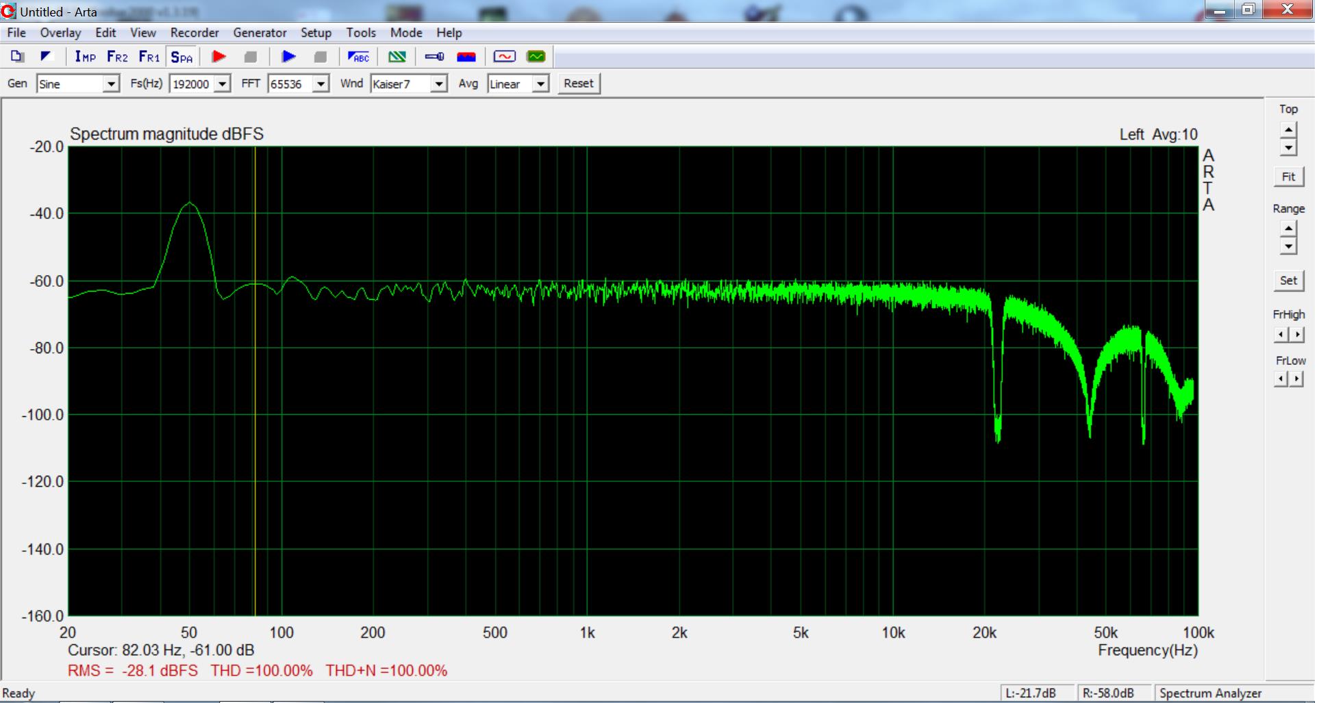

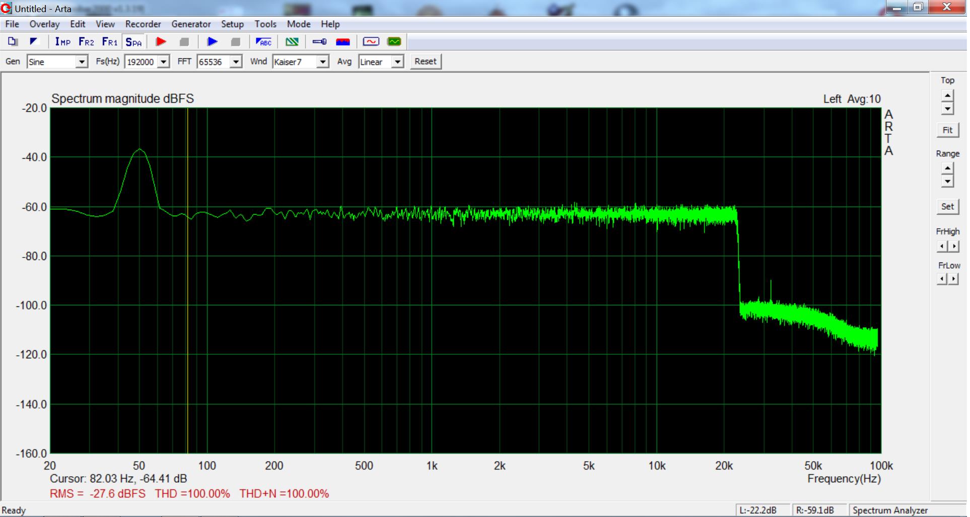

Perhaps I don't understand your query but anyway, here is what I capture from my NOS DAC with white noise created with audacity and then extracted as flac at 44,1 96 and 192kHz.
Using noise is a perfect way to get the Frequence Response.
But the noise you produced was bandlimited to 20Khz for all three cases.
The first picture shows a FR to 20Khz, the rest of the 44.1 spectrum are images exactly as expected, so far so good.
Now try to produce noise limited at resp ca 40Khz and 80Khz for the two higher sampling rates.
You will then see the spectrum of the reproduced 96Khz file going to 40Khz and starting again as mirror as from 56Khz and for 192Khz going to 80Khz and starting again as from 112Khz as mirror.
However the Holo May stops in all cases reproducing at 20Khz which seems in this very case to be caused by digital filtering.
Hans
Could you send (part of) your track as a .Wav file ?I processed the aforementioned track with the trumpet with audacity to reduce level by 6dB. Vibrato was just a bit more dynamic in OS than before but in NOS got worse. Both modes now come closer but in the wrong way, so I don't feel this is the way to go. I attach screenshots of the file before and after processing. The original seems like compressed but it doesn't sound so. I think it hits zero without clipping. The processed file sounds compressed if this makes sense to you...
That the NOS sound gets compressed after attenuation seems to make no sense.
Only the S/N is supposed to worsen by 6dB, but I can imagine that your OS process gets overloaded.
Hans
