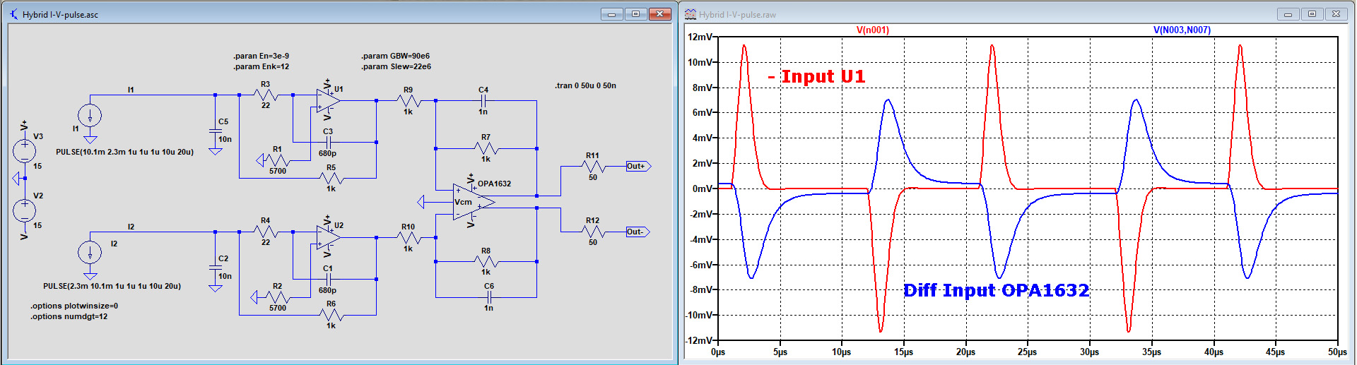

I thought it would be a good idea to further examine the Hybrid I/V converter that recently popped up as an alternative.
Big advantage is that it acts like a passive I/V without the potential input oversteering of an active converter, but with almost the same extremely low noise of an active converter.
That’s why I tried to simulate a complete circuit, in this case projected on the popular PCM1792/1794, to get a better feeling for certain sensitivities.
The circuit in the first image shows a 5700R resistor, connected to the (+) input of U1/U2.
This resistor is used to the simulate the PCM1792/1794’s noise, but this input should be directly tied to gnd in a working solution.
In the plot connected to the circuit diagram, input voltages are shown as calculated in the Sim at U1/U2 and at the second stage, here an OPA1632, when offering a steep square wave current step from 2.3mA to 10.1mA, the maximum step size for this PCM1792/1794, a Dac that is supplying 6.2mA at rest.
Nothing dramatic happens and the amp behind the 10nF caps can handle this step without drama resulting in a smoothly dampened response with the chosen values for the caps.
Nevertheless, still a fast op-amp should be used for U1/U2, slew rate minimal 20V/usec and a GBW of around 100Mhz.
Because of the noise produced by the Dac, represented here by means of the 5700R resistor being almost 10nV/rtHz, it’s obvious that the noise requirement for U1/U2 is quite relaxed.
Up to 5nV/rtHz is no problem at all. So, a LT1468 is one of the many possibilities to be used here.

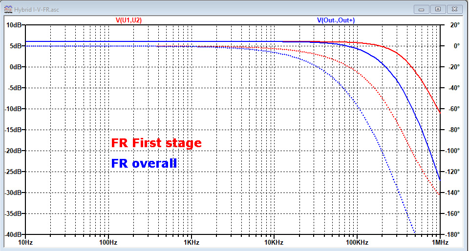

The second Image shows the Frequency Response, in red the output from U1+U2 and in blue the overall output from the OPA1632.
Output level in SE is 2.7 Vrms and in Diff twice as much with 5.4 Vrms.
Given the FR, it’s obvious that this I/V converter can be used both for OS and for NOS for all possible variations of Fs.

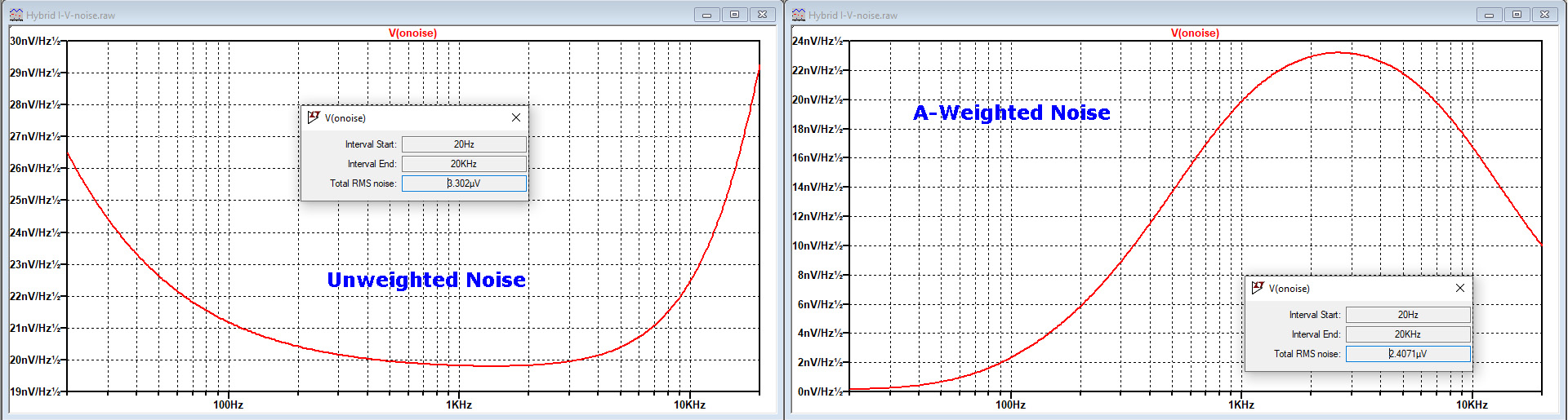

Third image shows the noise spectrum.
Noise ramps up at HF, still well under control higher in frequency, and results in ca 3.3uV from 20Hz to 20Khz as against a measured 2.7uV for a conventional active I/V converter using the same op-amps and gain.
All noise figures were taken from the diff output.
When A-weighting this noise, it reduces from 3.3uV to 2.4uV,.
So S/N calculates to 20*log(5.4V/3.3uV) = 124.2 dB or to 127.0 dB(A).

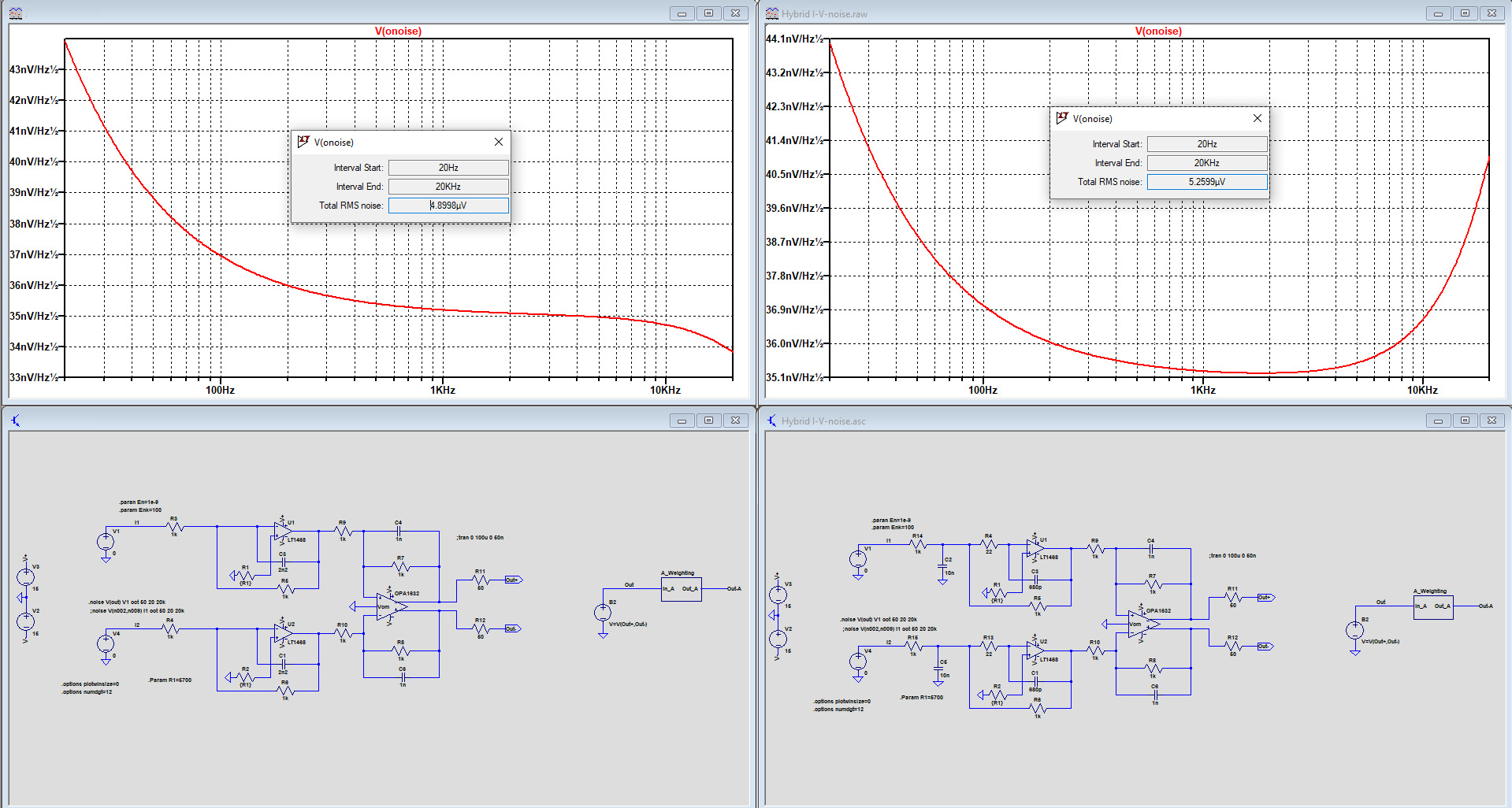

You treat the DAC as an ideal current source. Is its output impedance high enough to make that approach valid?
The obvious way to represent the DAC's noise is by a current source in parallel with the DAC output. One way to model that in SPICE, is to put a noisy resistor across the input of a current-controlled current source (preferably with one side grounded to prevent a floating cluster) and connect the controlled source's output across the DAC output. Why do you prefer a resistor in series with the op-amp's input?
The resistor was just one way to add a noise source, free from interrupting the current and voltage from the Dac.
My first attempts where in the direction you suggested, but this final solution worked the most stable while varying other parameters.
The 5700R was determined by taking my existing Dac with a measured 2.7uV noise that's using these op-amps with exactly the same gain.
So, empirically I got this 5700R as the value to use to get exactly this 2.7uV.
I don't get your other question about the Dac's output impedance.
When it's able to drive a virtual input, it should even be more able to drive a 10nF cap IMO.
Maybe you can go in more detail to eventually add this to the Sim.
