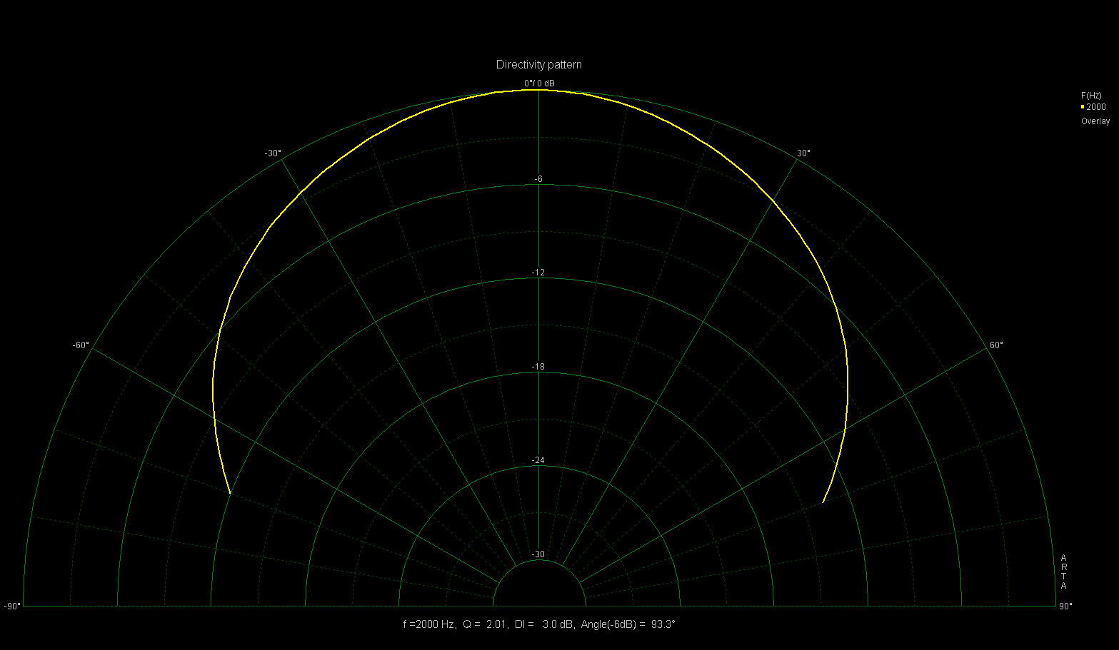

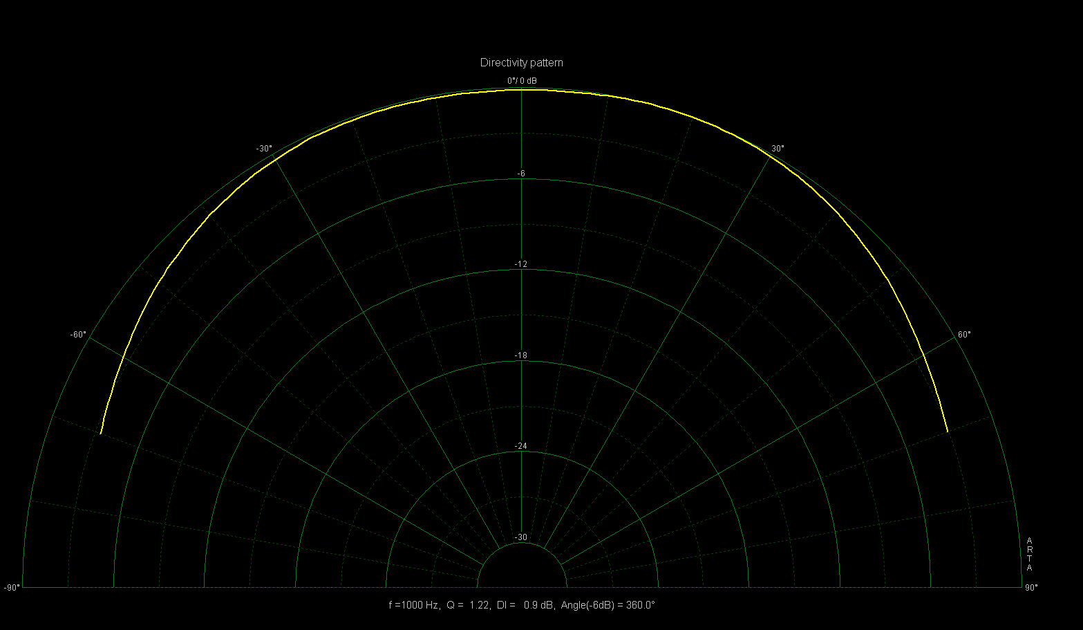

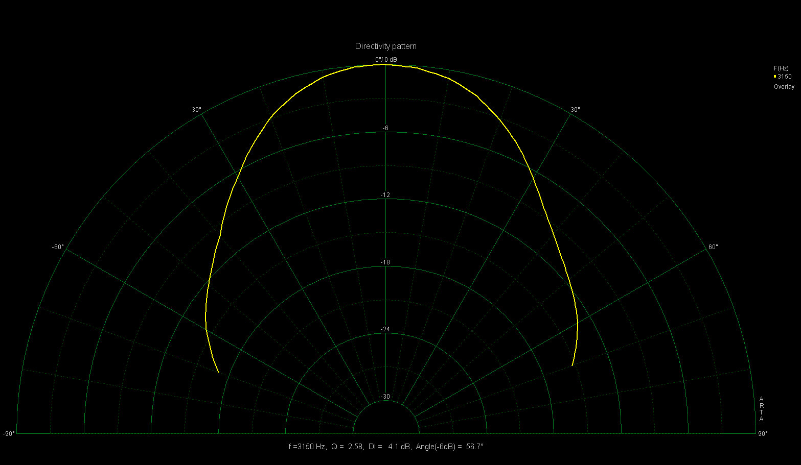

Really ? So the measured polar response of an 8" driver at 1Khz in the first image below is "beaming" ? 3dB down at +/- 65 degrees ? That's not my definition of beaming, by a long stretch. That was taken on a largish baffle too - 63cm x 39cm.Sure it is! Give it some baffle, and it will be even more pronounced.
People seem to greatly over estimate the directivity of large drivers.

A real driver is (a) not a flat piston but a cone, (a conical radiator has increased dispersion over a flat piston, yet the formulas for a flat idealised piston are still often used) and (b) a real cone in a wide band driver is not a rigid piston at higher frequencies - cone breakup and shrinking radiation area helps to further improve dispersion over a rigid cones theoretical response.
Compare your calculated directivity indexes and expectations to the measurements below and you'll see they don't line up. To be fair I'm cheating a bit, because its a dual cone driver, but this only starts to improve directivity over a single cone at about 2Khz and above, and isn't relevant to 1Khz.
Is it beaming at 1Khz ? Not in the slightest. At 2Khz ? I would call that directional, but not beaming as its still about 90 degrees. At 3.1Khz ? Yes, starting to beam now for sure.
No. It's impossible to measure a full range driver of that size in the near-field at high frequencies and get any meaningful results. I don't remember for sure if I used half a metre or 1 metre, but looking at the relatively short reflection free time in the impulses it was probably 1 metre.DBMandrake, did you measure in the near-field?
Well, you need to place a figure on what beaming is - directivity is usually measured to -6dB, and at 1Khz it doesn't actually go as low as -6dB, even at +/- 90 degrees (not shown in the measurements) so its the baffle that's controlling the directivity at that frequency.Call it directional, call it beaming - for me that's just semantics.
If I had to put a number on it I'd say directivity of 60 degrees or less is beaming. Where you draw the dividing line is up for debate though I guess, I haven't seen a formal definition of beaming, and the shape of the lobe is probably just as important as the exact -6dB width.

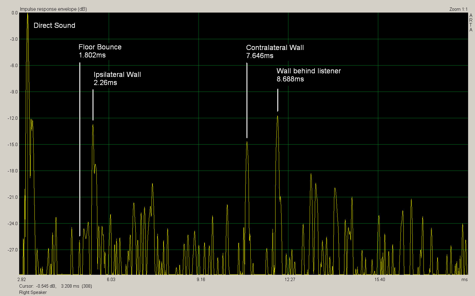

Here you go. Floor plan:
Nathan, right:
By the way, we don't see any front wall reflections because the whole wall is absorptive. There's also a thick rug on the floor.
I've just measured ETC curves of my speakers and room for a comparison. Quite an interesting exercise.
A couple of caveats -
(1) my room is rather small and my normal listening position is quite close to the rear wall. This adds a lot of extra strong reflections in the same time range as those we're interested in, like floor, side walls etc, confusing the issue, so for the purpose of this test I've brought the measurement position about half a meter further forward to delay that rear wall reflection enough to get it out of the way.
(2) To identify each reflection source I measured with and without an absorbing blocking object (me!) in the path of the reflection, as such I wasn't able to identify the ceiling reflection due to being unable to lie on the ceiling
The room layout is significantly asymmetric, both speaker to side-wall distance, as well as room objects and damping so the differences between left and right are interesting.
The first 1.5ms looks much the same for both channels.
The floor bounce reflection comes first at around 1.8ms, and on the right speaker there is a thick rug in front of it, putting the reflection well down into the noise. I was only able to identify it by further reducing it with more adsorption/diffusion on the floor. (me again...) The left speakers floor bounce area is only partially covered by a rug and from that we see the floor bounce is about 4dB greater in level.
Next comes the ipsilateral reflection at 2.26ms on the Right and 2.6ms on the left. This is the major difference between the left and right side of the room, and amounts to a 10dB greater reflection on the right side, which is largely bare wall with a small fake fireplace a bit further along and protruding about a foot.
On the left, the speaker is a bit further from the wall, but there is also a sofa and a small computer desk along the left wall only a metre or so from the speaker, together which would add significant diffusion and absorption, with the difference being really obvious in these plots.
When I've tried to optimize the imaging in this room with toe in etc, its always the right side that has been the problematic one, and even with this amount of toe in there is still a strong reflection that could really do with diffusion.
Contralateral reflections come next, at 7.646ms for the right speaker (off the left wall) and two discrete reflections at 6.021ms and 6.635ms for the left speaker coming off the right wall. Both the latter reflections disappeared together blocking the path to that wall, so I can only assume that the wall and the protruding but flat and smooth surfaced electric fire place provide two different path lengths.
Finally at 8.68ms comes a large reflection from the wall behind the listener - which would normally come at around 4ms at the normal listening position.
