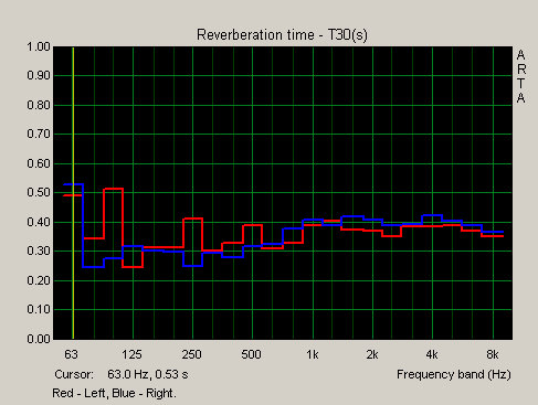

Replying to myself...I decided to check the RT60 from the same impulse measurements I derived the ETC curves from, and the result is below. It's not surprising the room sounds a little bit bright and live when the RT60 climbs quite a bit above 1Khz to just over 0.4s.
So despite mostly well controlled early reflections (apart from the right side-wall) the overall reverberation time is still quite high at high frequencies for such a small room. Could use a bit more absorption in the room to get it down to 0.3s I think... 🙂

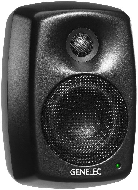

I always think the Genelec stuff looks like it should work well. Smooth waveguides over direct radiators. Looks about 120 degrees wide. Should hide the cabinet edges, as Simon suggests.
I've done a lot of treble waveguides like this (see my avatar, XA Reference Snell).
David S.
