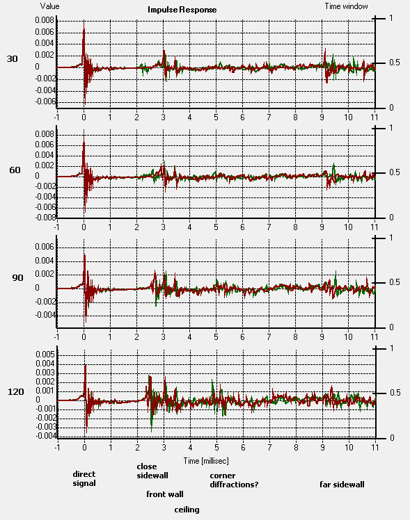

I ran some tests last night to evaluate different degrees of toe in. The speakers are described in this link - very wide dispersion, flat directivity, -3dB@60deg, -9dB@90deg from 500Hz-8kHz. I setup my speakers for similar early reflections even if that results in slight asymmetry in the physical setup. I find that to be very beneficial to imaging.
On the graphs red = left and green = right. I'm not sure what is the official way to describe toe-in/out so I made up my own. I assume 0 degrees is when the speakers are facing one another. At 90 degrees they will be facing perpendicular to the side walls and at 180 they will be facing the close side wall. I am not entirely sure which peak on the graphs corresponds to what reflection but I've indicated my best guesses based on distances in my room. The speakers are setup close to the narrow walls of the room and there is a wall behind them.
At 30 degrees, the extreme toe in, there were a lot of mirror images, it was hard to pinpoint the location of instruments. The center image was well pronounced and the overall clarity of the sound was OK. The overall sound detail was good and clear but the image had collapsed except for the center.
At 60 degrees things were better and this is my usual listening setup. The side image opened up and the clarity was good. The only thing that I didn't like was that a stereo recording of a piano failed to properly place the low notes on the left and high on the right.
At 90 degrees the image widened and the piano keys were correctly laid out from left to right. Clarity however was not as good as with 60 degrees. I did not like the overall sound quality but I can't quite describe what was wrong.
At 120 degrees the extreme toe out, the image was enormous. It grew the size of the room. It was more defined at the edges and somewhat blurry in the center. Sound clarity was OK but not optimal. Instrument separation was the best in this configuration. It is enjoyable for the short term but I probably won't keep it permanently.
When it comes to personal preference I like 60 and 120 the best but they are different. 30 is bad and 90 is OK but I don't like it.
![toe.PNG toe.PNG](https://www.diyaudio.com/community/data/attachments/224/224750-df6092c072dcafda605f15cea3cd2723.jpg)
The image widens when the speakers are toed out towards the close wall and it narrows when they are toed in towards the far wall. Widening and narrowing might not be a correct description because the effect is different than the one when the listener moves closer or further to the speakers. When toeing out speakers the sides of the image become more clear while the center blurs and when toeing in the center improves but the side image deteriorates.
Exactly my experience as well.

I agree, if diffraction was the only concern and you purposely wanted very wide dispersion you could use a 180 degree horn / wave-guide which terminates smoothly at the cabinet edge as you describe, however I think there are benefits to be had in deliberately restricting the directivity to much less than 180 degrees in the vertical plane, if nothing else. (Nobody has yet to show anything good about floor and ceiling reflections)
I'd like to have 100-110° CD (haven't made my mind up on vertical coverage yet). Is there anything DIY that would fit?
- What is the ideal directivity pattern for stereo speakers?
