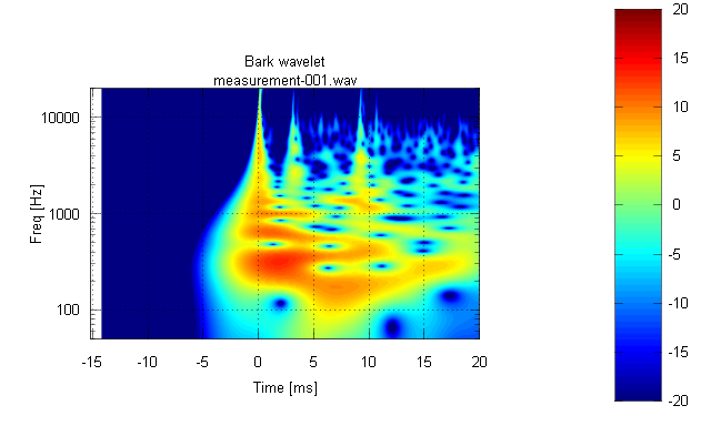

Hello,
Here first WAV file with Bark wavelet:
Click my signature to download the free software to do these plots !
![239231d1315564186-what-ideal-directivity-pattern-stereo-speakers-meas_001.png](https://www.diyaudio.com/forums/attachments/multi-way/239231d1315564186-what-ideal-directivity-pattern-stereo-speakers-meas_001.png)

I don't know how to generate an ETC curve. I tried the free ARTA without success. I was simply using HOLMImpulse to measure the Impulse Response at the sweet spot. I'm uploading the .WAV files if someone wants to process them.

(REW has a very good interface for comparing several measures, because it keeps everything instantly available. But there is no CSD plot. Arta has not this problem, but the only way of keeping a measure is to make a Pir, that's fastidious. Arta is also more intuitive for gated measurements.
A convenient solution is to save the WAV file with REW, then analyzing it with the wavelets that are a "no pity" test. It's DOS-like interface is very fast. It's also useful to run Arta and REW together)
