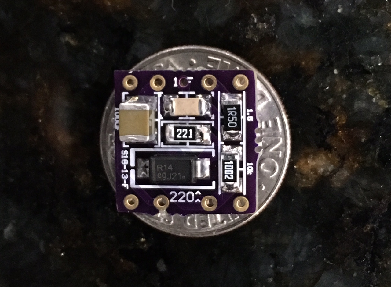

I don't think it is different - just use the critical part of the cap mx: the 220uF cap, 10k resistor, 1n400x diode, 220R gate stopper, 1uF and 1R5 snubber. The 4700uF output cap is optional - use whatever you have or the rail cap on the actual amp. Also, any N-channel enhancement mode MOSFET will work (IRFP240, IRF610, IRF510, etc). Even a little ZVN4306GTA and all SMT components can be used to make one that fits on a dime:
This one is courtesy of RaptoLightning who provides Gerbers for ordering your own - these are cap mx for my little pocket class A amp.
that's right. I followed xrk971's instructions as best I could. Just seven parts altogether. It would be the top right quadrant of the original schematic, minus the 4700uF cap. I used an IRF610 and a 1N4007. Put in my order for a bag of 50 1000uF caps and when that gets here I can build the cap array to complete the trifecta.

I think I can recommend to you guys to build this capacitance multiplier.
Juma's Easy-Peasy Capacitance Multiplier
Nice job Jonathan. Where else can you get -45dB ripple attenuation for 7 components and all under $1.50? Btw, 1/4w resistors are fine there - no need for 1w or 2w deals.

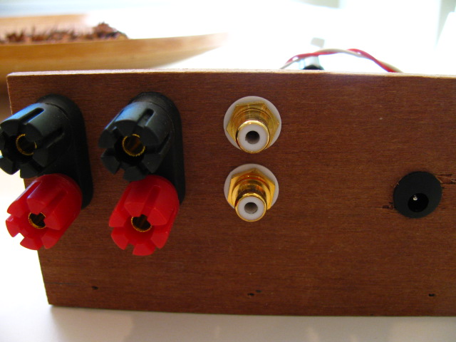

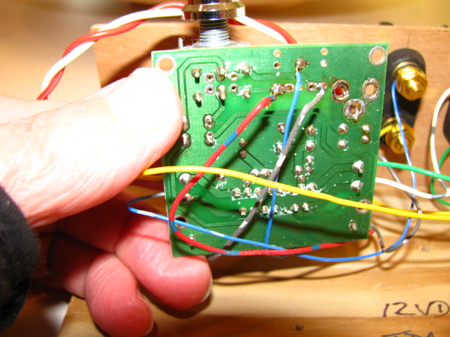

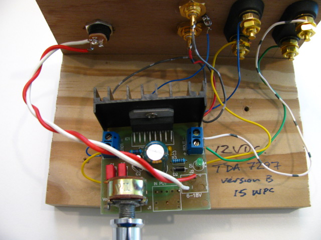

Help please. tda 7297 with no sound
I am getting no sound, and the LED is not lighting on the amp below.
I carefully and slowly removed the stock power input jack. (Yes, the amp was working before.) I have continuity on both the negative and positive wires from my new jack all the way to the board. And I get a voltage reading when I plug in my known good 12VDC supply.
I tested the LED with my meter and it lights up. I tested D2 and I see a reading there also.
As you can see, I also removed the stock input jack. I have continuity to all leads there: R input, L input, and the ground.
Any idea what I have done wrong?

Wow, the OP has such no-sound problem?
These amps are so simple that it comes down to power connection or the amp chip is dead.
Your 5.5mm barrel jack is strange looking. Are you sure you have positive polarity to the + wire to the board? It almost looks like that is the GND pin on the little jack PCB.
Have you verified +ve voltage all the way to the pin at the IC?
Yes, I am getting a positive voltage reading on the part of the board where I soldered those red and white wires. To the board, not just to the wires themselves.
If I am measuring the LED correctly, I think I got something like 3.2mV.
X, I am not certain what you mean about the GND pin on the power jack of the board. Are you wondering if the original jack of the board was set up to have the center pin as the negative, rather than the positive? I don't think that is the case, but I wouldn't know really.
I'm not sure how to measure any voltages beyond what I already have. Like to the pin of the chip.
This worked before I pulled the jack off. And I desoldered it very gently - did not force anything or ruin the board traces.
I'm puzzled. I've done stuff like this before successfully.
