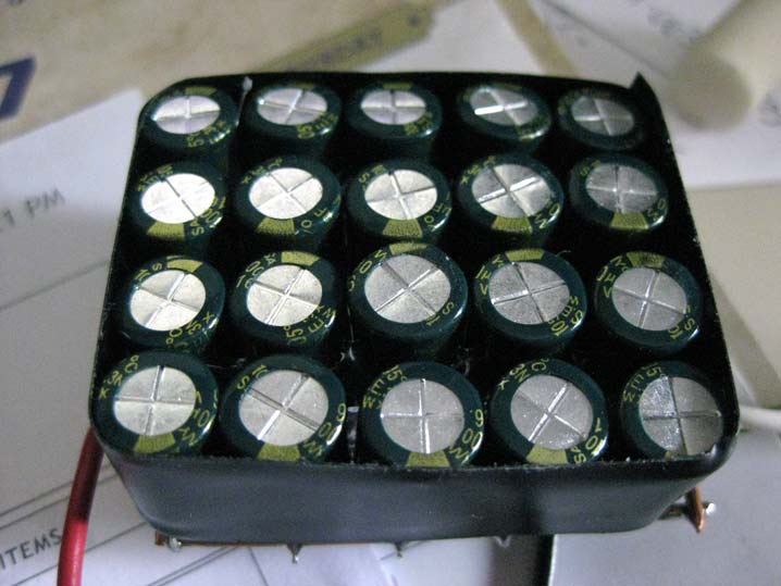

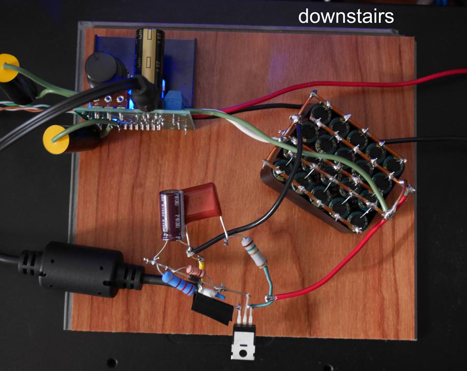

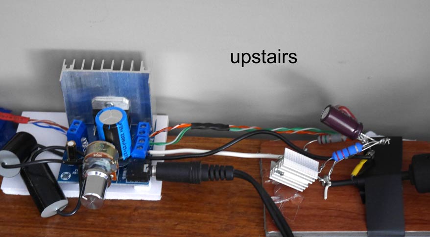

cap array question
question for xrk971:
as you know I just built a pair of XKiclops speakers using an old vifa 5" woofer, new PE tweeter and a box design you suggested. I had been auditioning it at my workstation driven by the cheapest TDA7297 I could find on ebay (caps replaced), an HP 19V adapter and Juma's Cap multiplier. The sound from that combo is KILLER. I procured a bag of 1000uF electrolytics to add a cap array in between the capMX and the amp, ostensibly to add bass impact, tho it already had everything I wanted. But the idea was to move these speakers downstairs to a medium sized room and get them off my desk. I picked up a Drok TDA7297 from amazon that was a bit pricier than the ebay ones I've gotten before. It's very similar except the input jack faces forward next to the volume control. I modded it w/ the same parts as b4, polypro input caps, shunt cap, and power cap. Built another Cap MX, and put together a cap array with 20 electrolytics wired in parallel. Hooked it all up with another HP 19V brick. When I started listening to the result it was kind of flat compared to what I was experiencing upstairs with a nearfield listening position. Downstairs I have the speakers on the floor to try and get best bass. It's OK but there's no real impact, and there is certainly not alot of bass. To see if it was the amp or something else, I brought the parts upstairs to see if the the cap array had a noticeable effect where I'm used to hearing the system. After hooking it all up and turning on, there was a terrible HUM and now the music signal was kind of weak. Odd that. Brought it downstairs and it worked fine again, tho not legendary. The upstairs interface to the input is a USB recording unit made by Roland, that connects to the amp and the computer. Downstairs there is a usb DAC interfacing with the computer then going thru an acurus preamp which is plugged into the TDA7297. I also brought the upstairs amp, cap mx and ps downstairs to try and it sounded similar to the other system w/ cap array. Any idea what's happening?
Try Drok amp upstairs without cap arrray. Check to make sure your cap array polarity is correct. How long does it take to charge up to steady state? What is the steady state voltage of cap array?
Then put cap array in upstairs but with old amp. Just try to eliminate as many potential problems as possible.
If one of your caps in the cap Mx is bad, it may present a short. In which case it will get hot and blow up. But when it is shorted - all power from PSU gets sucked low. Voltage will be low and it will sound weak and hum because cap multiplier is running fully open to keep up with current demand.
Look for a warm/hot cap with a bulging can lid. That's the bad one.
But these amps are so simple that when they don't work or don't sound good. It's the power supply. Is the wiring from cap array to amp correct polarity?

Thanks for the reply X. I already tried the cap array and new MX with the old amp upstairs. Drok too. That's what is mostly hum. All the polarity is correct. The polarities for V+ and speakers are switched on the two amps. But I hook them up carefully. The new MX and array work fine on the new speakers downstairs with Drok(played this combo for hours this morning) or old amp, just doesn't have a very noticeable difference than w/o cap array. Voltage after cap array is just over 16V. When switched on it takes 1-2 seconds for LED to light on amp, seems to ramp up nicely. When switched off, it takes a few seconds for the LED to fade and then there's a noticeable scratchy noise, not really a pop. The caps all look OK. Also everything is cool to the touch. I'm thinking something to do w/ ground and the upstairs usb interface? pic of caps and recording of hum (also w/music) attached.

If you use a linear supply the cap multiplier helps reduce ripple and audible 60Hz line hum. In the case of a cap multiplier with SMPS it's serving another main purpose: to slowly ramp up startup current to prevent certain SMPS from thinking that the low ESR cap array is a dead short and shutting down protectively. Some high quality SMPS don't have a shutdown issue when used with cap arrays. But I like how if allows a graceful turn on that prevents speaker thump which would otherwise need a delay with a time delay circuit.
