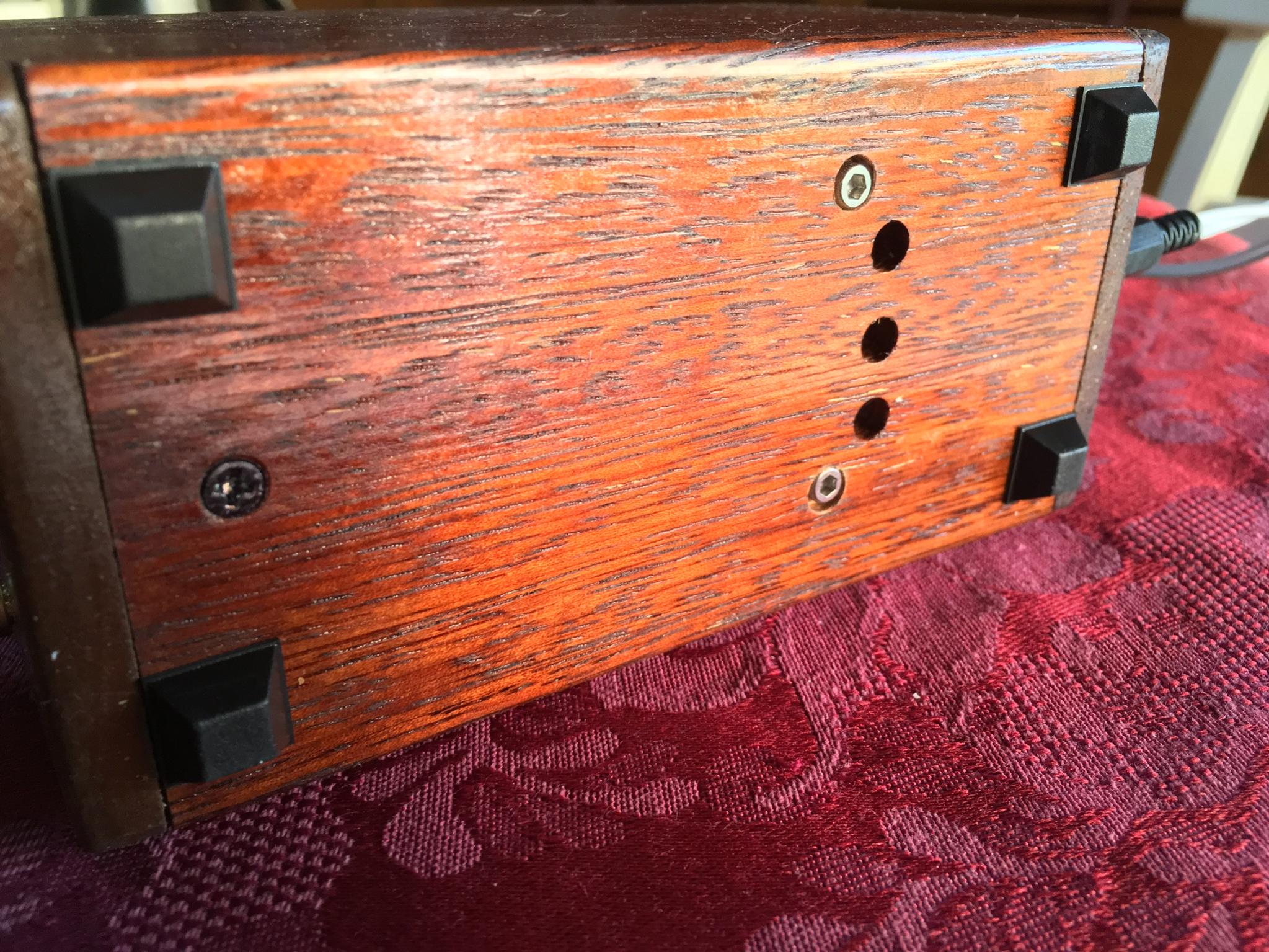

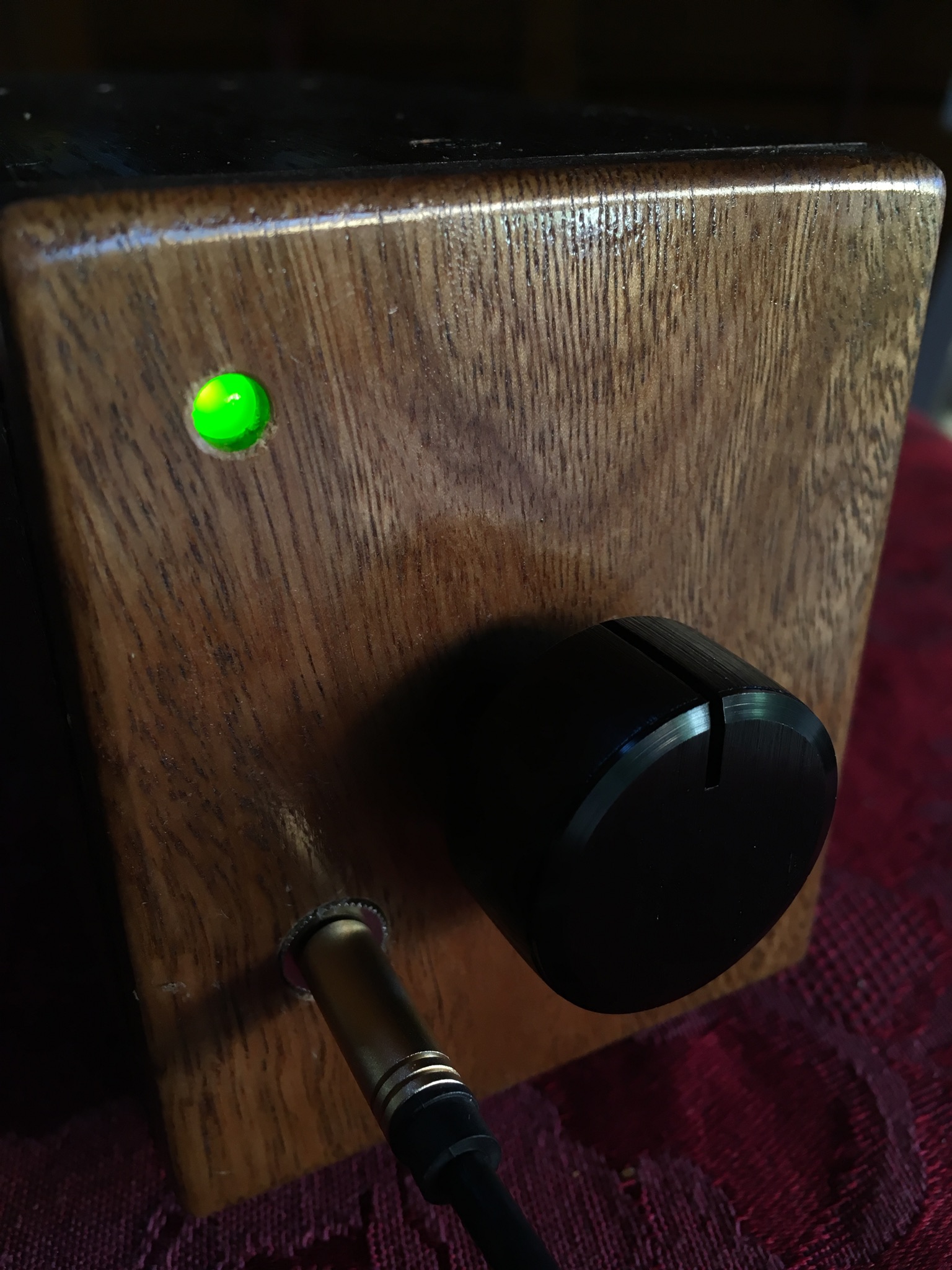

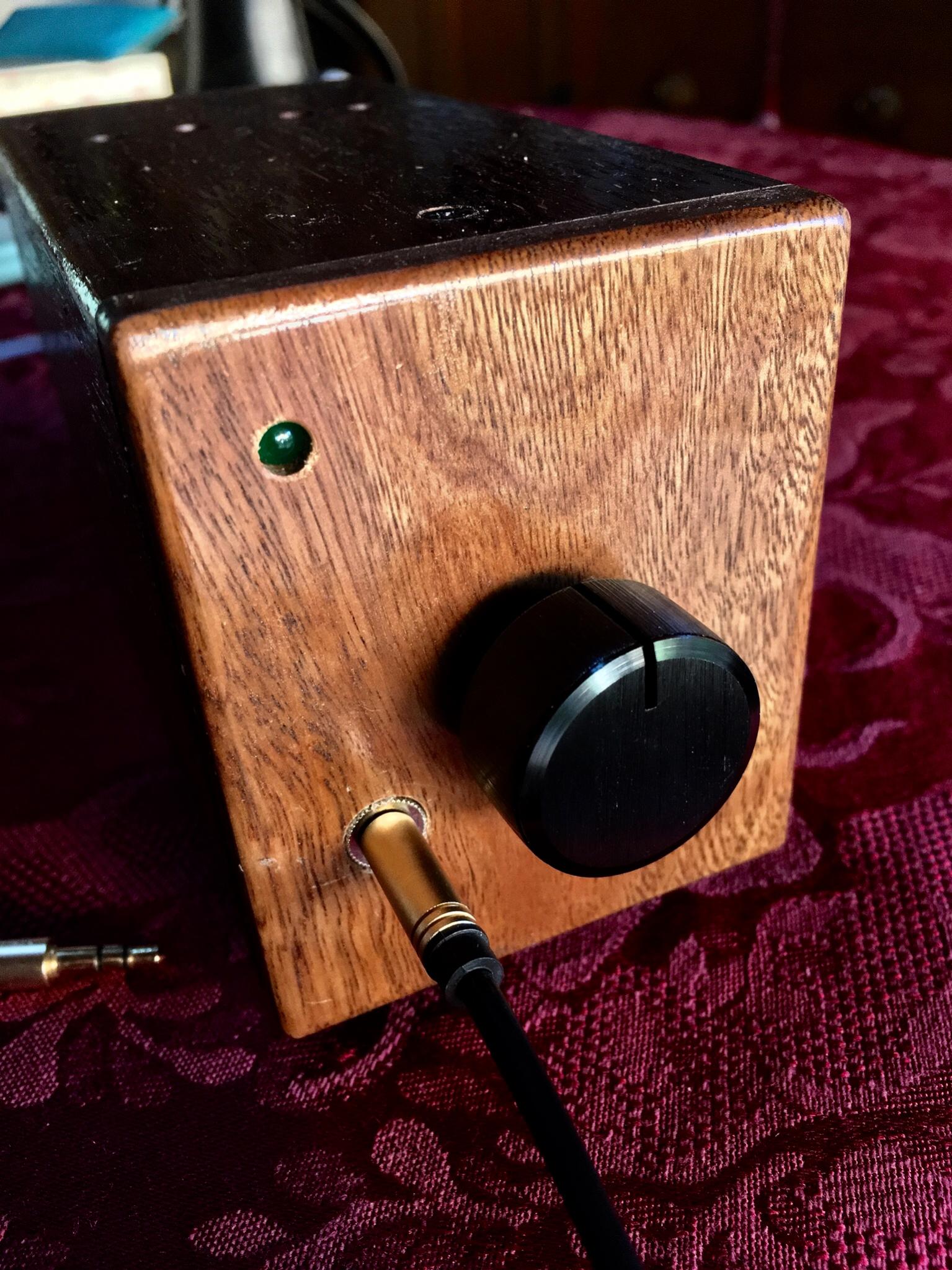

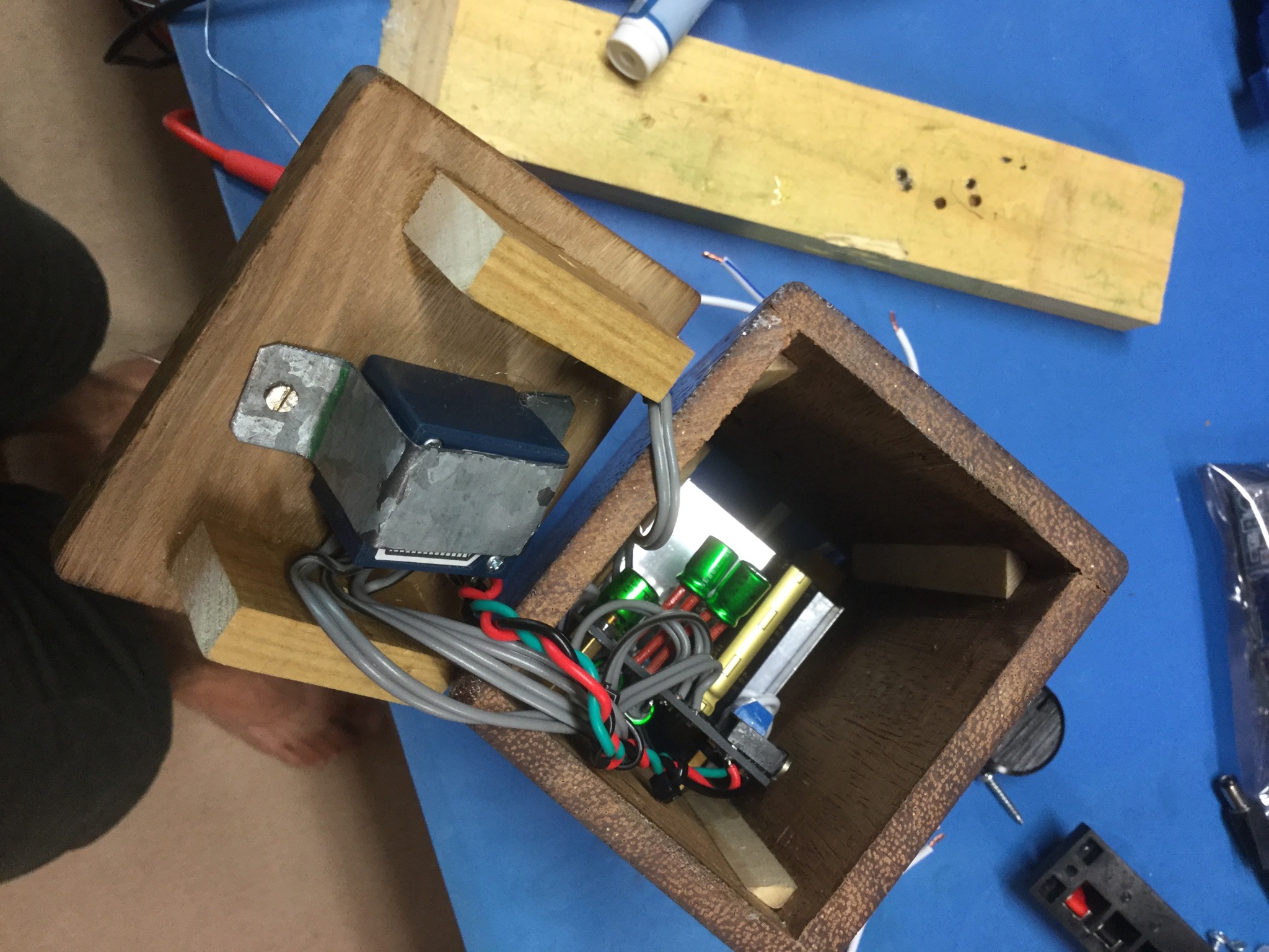

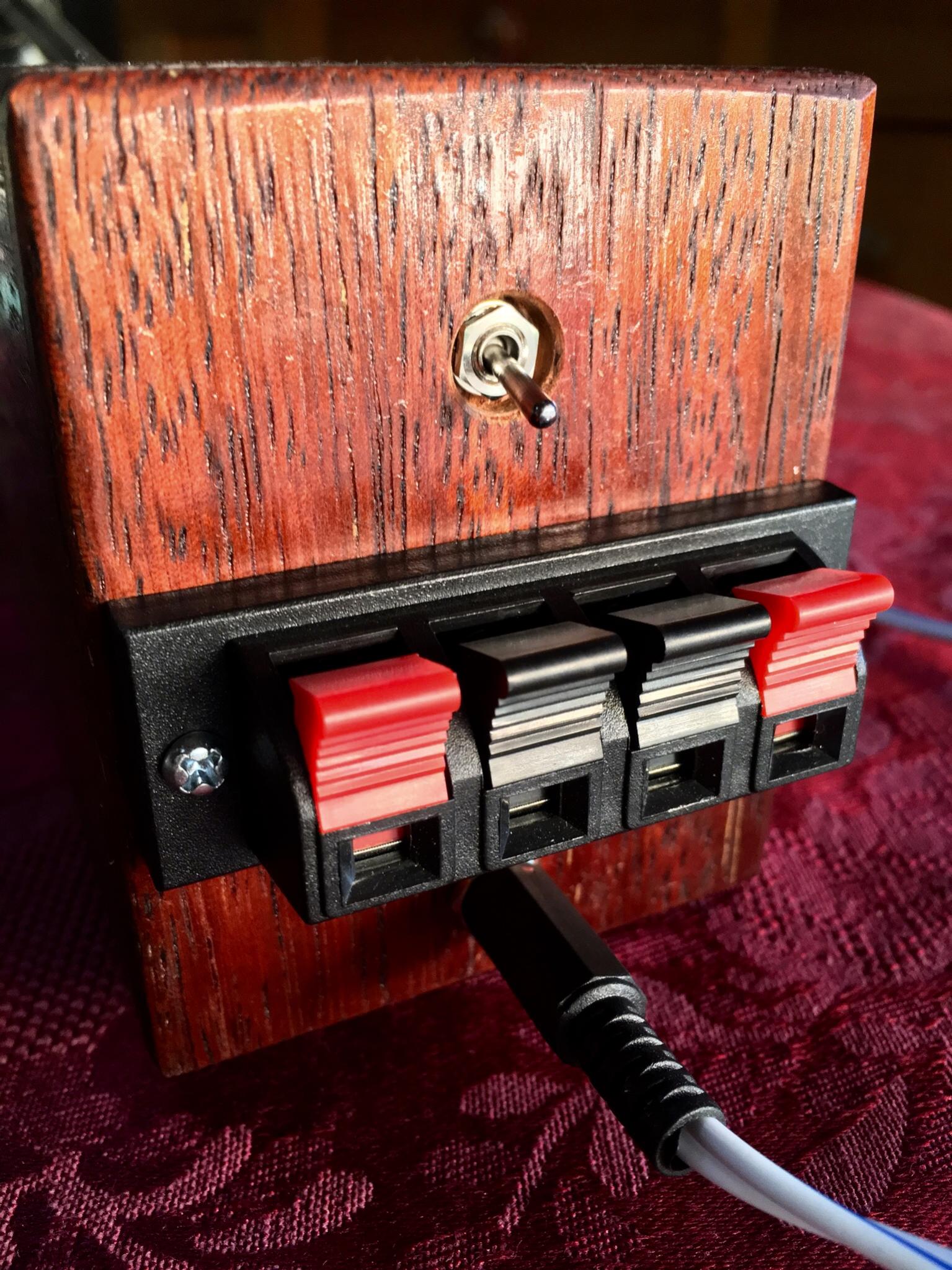

Just thought I would share my TDA7297 build. Just a bit of fun. Not an audiophile.
I bought an assembled PCB on line and used timber scraps and few common electrical parts for the case.
I performed the recommended capacitor additions and upgrades, changed the volume pot, and put it in a minimalist enclosure.
At the back is a speaker terminal block, power switch and power jack (5.5x2.5). On the front panel I have added the power LED and 3.5mm input jack, as well as the volume pot (not sure I like the black).
Inside I changed the LED to a low intensity 5mm green without changing the onboard current limiting resistor. Vent holes top and bottom neat the heat sink.
Currently running off a small 7.5AH VRLA 12 battery.
Into a pair of Warfdale 415 100w 8ohm 87dB bookeshelf speakers the amp draws max 1.87A at 12.5V that is 23.4 Watts peak consumption measured at he battery. Inrush current is 17.5A. I had the iPhone at max volume playing Brothers In Arms.
Reasonably loud in a small room.
Any suggestions for a nicer volume dial? Once have decided on one I will trim the pot to length.

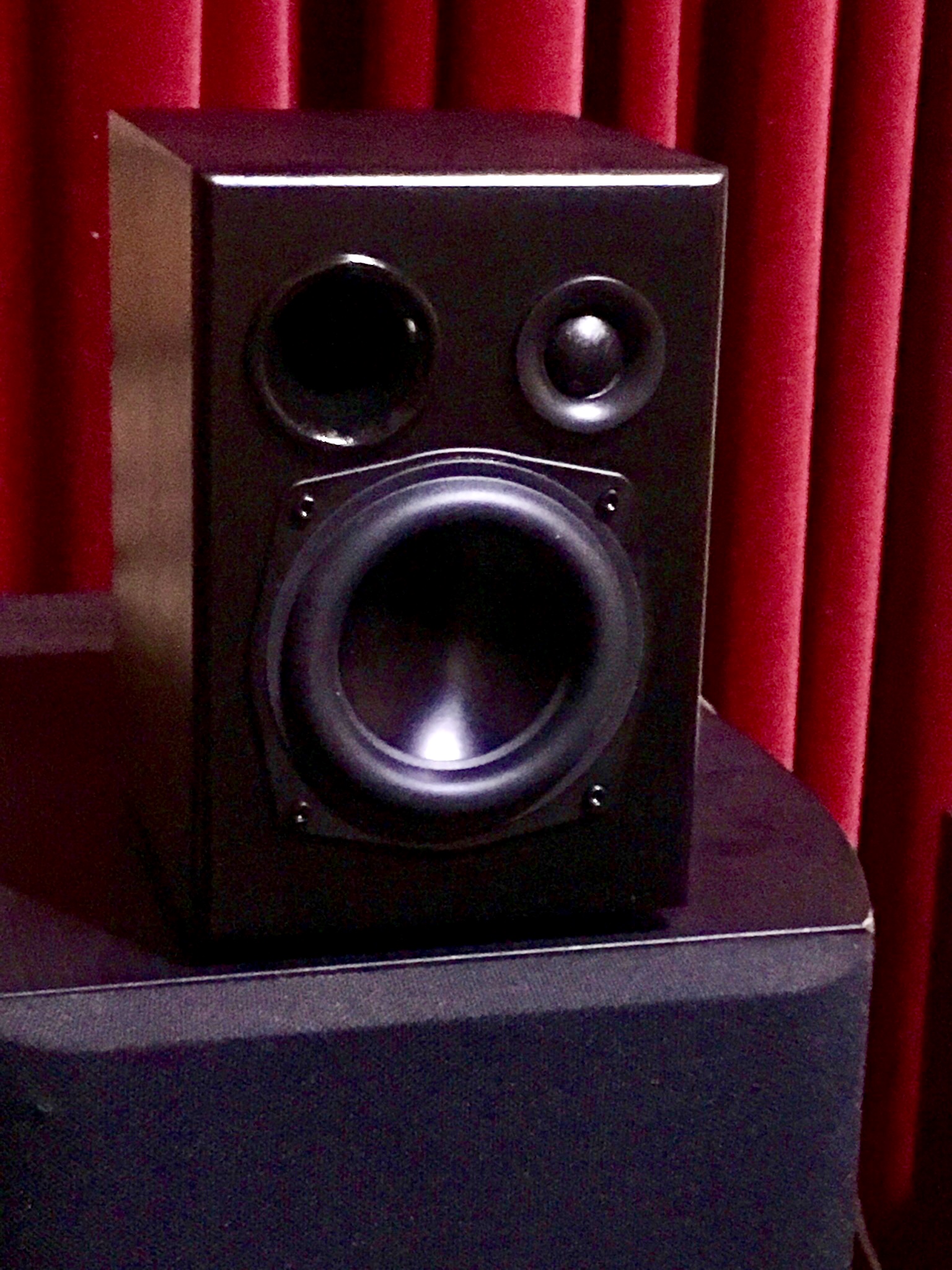

Helium speaker parts arrived today.
The port I ordered is a bit larger in diameter than the 3/4” in the original design on the Parts Express forum. This one measure more like 7/8”. Do I have to make a compensation? It is taking weeks to get the administrator to allow me to post on that forum to ask.

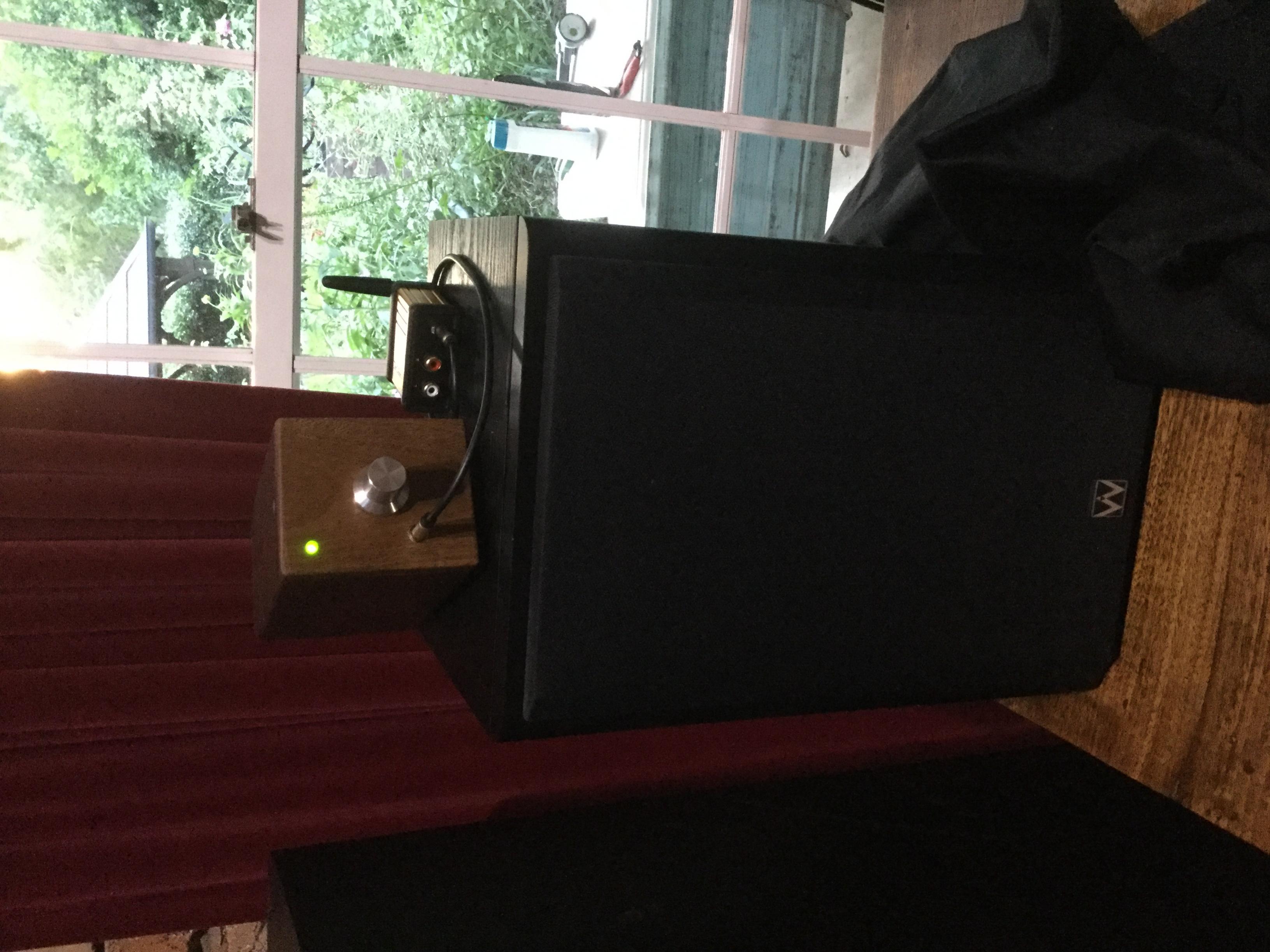

BUilt the Helium speakers. They sound great but might need a beefier amp one day but the volume is loud enough at 80% rotation and no clipping with the little amp. Thanks to Stellarelephant for the speaker build idea. I didn’t think anything so small could produce that much bass!
One question: touching the volume knob creates a bit of hiss when there is no input signal. I am using a SMPS with no earth pin, could that be the problem? Is there a solution? I was thinking about trying to insulate the knob from the pot shaft somehow as a simple solution.
