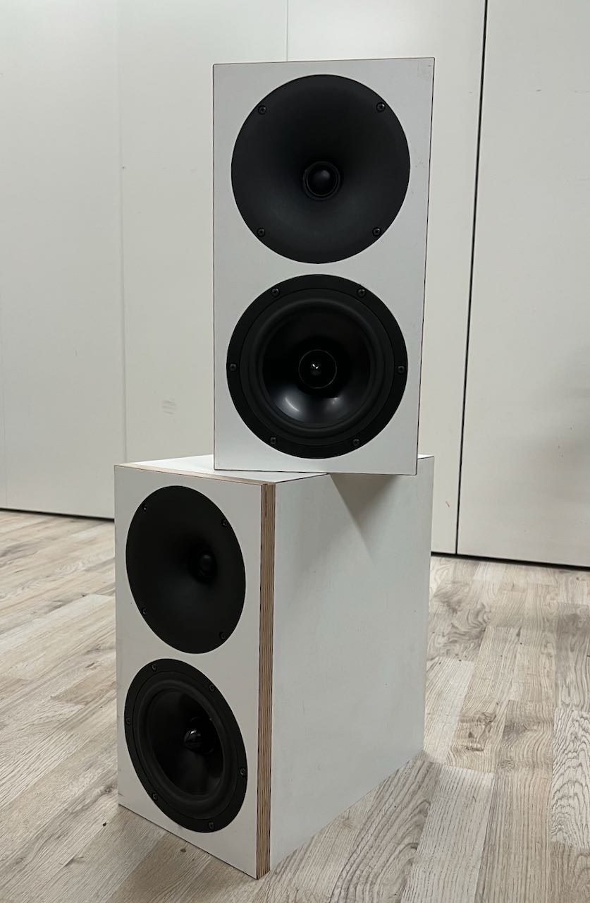

They look quite like what I built for myself recently…Lemme killing you softly with this one from sweden , 457 EURO for the pair :

These seem really nice at first glance but the off-axis measurements in the Hifi-Musik review seem a bit subpar... too badLemme killing you softly with this one from sweden , 457 EURO for the pair :
https://www.xtzsound.eu/spirit4?aff=2#!/Spirit-4-Matte-White/p/384936066
