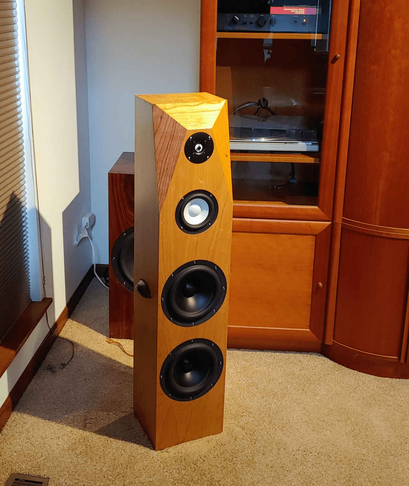

A passive version of this speaker could be built for $1000 per pair for drivers and crossover parts. You can read the thread and see if this kind of performance might meet your need.
https://www.diyaudio.com/community/threads/new-project-tower-3-way-with-twin-8s.378223/post-6816455
I would use a different woofer, probably the SB23NRX, and I would make the cabinet larger, and ported, since a passive design does not have the benefit of a DSP-enhanced bass response.
I would also use a waveguide on the tweeter, and then I would not need to do the extensive beveling around the tweeter. With a waveguide, the directivity goals can be met with a a simple roundover on the easy-to-build rectangular cabinet.
If you (or anyone else) is interested in replicating this project, I will help out all that I can, and I will share everything I know.
j.

Jim, How come the tweeter is so far from the woofer? A serious flaw fixed easily
It does look odd, doesn't it ... This post explains it
https://www.diyaudio.com/community/threads/new-project-tower-3-way-with-twin-8s.378223/post-7017084
One of the goals of this project was to try the "current best practice" recommendation of using 1.2xwavelength CTC spacing. In simulation it does well, and my extensive measurements confirmed it. It is a good method of getting a smooth directivity index and power response through the crossover region. I spent almost a year doing simulations and foam-board mockups to prove to myself it would work.
Of course if we could get CTC spacing of 1/4 wavelength we would do it... but the only way, really, is your way, by using a wide band driver crossed to a woofer at ~ 200 - 400 Hz. I prefer a different set of compromises...

Jim- I think it looks pretty good! Avalon-esqe
AFAIC, optimum is as close to a quarter wavelength as possible.
