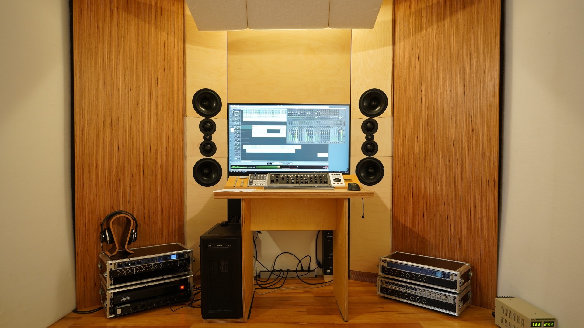

It reminds me of my comparison of an Adam monitor speaker to KH120 monitor speaker in 3 different rooms. Adam is built similar to a HiFi Speaker, KH120 with waveguide.I like this comment. It's what I feel like saying when someone makes the claim that beaming drills a hole in your head, which of course is not the same issue.
Adam has more bass (bigger LF driver for the same money) and sparkling highs. But sounded different in every room.
KH120 alwasys sounded like the KH120 - just in a different room. Having controlled directivity keeps your room response more natural, independend of your position and the room.
The Adam was nice to listen too, KH120 is a reliable tool.
Many people are used to big room reflections. In my listening room you have nearly no reflections and sometimes people are asking "where is the wide stage". This means people are used to these reflections and the "artificial" widening of your sound stage - and like that! So waveguides are not for everyone and every situation.
