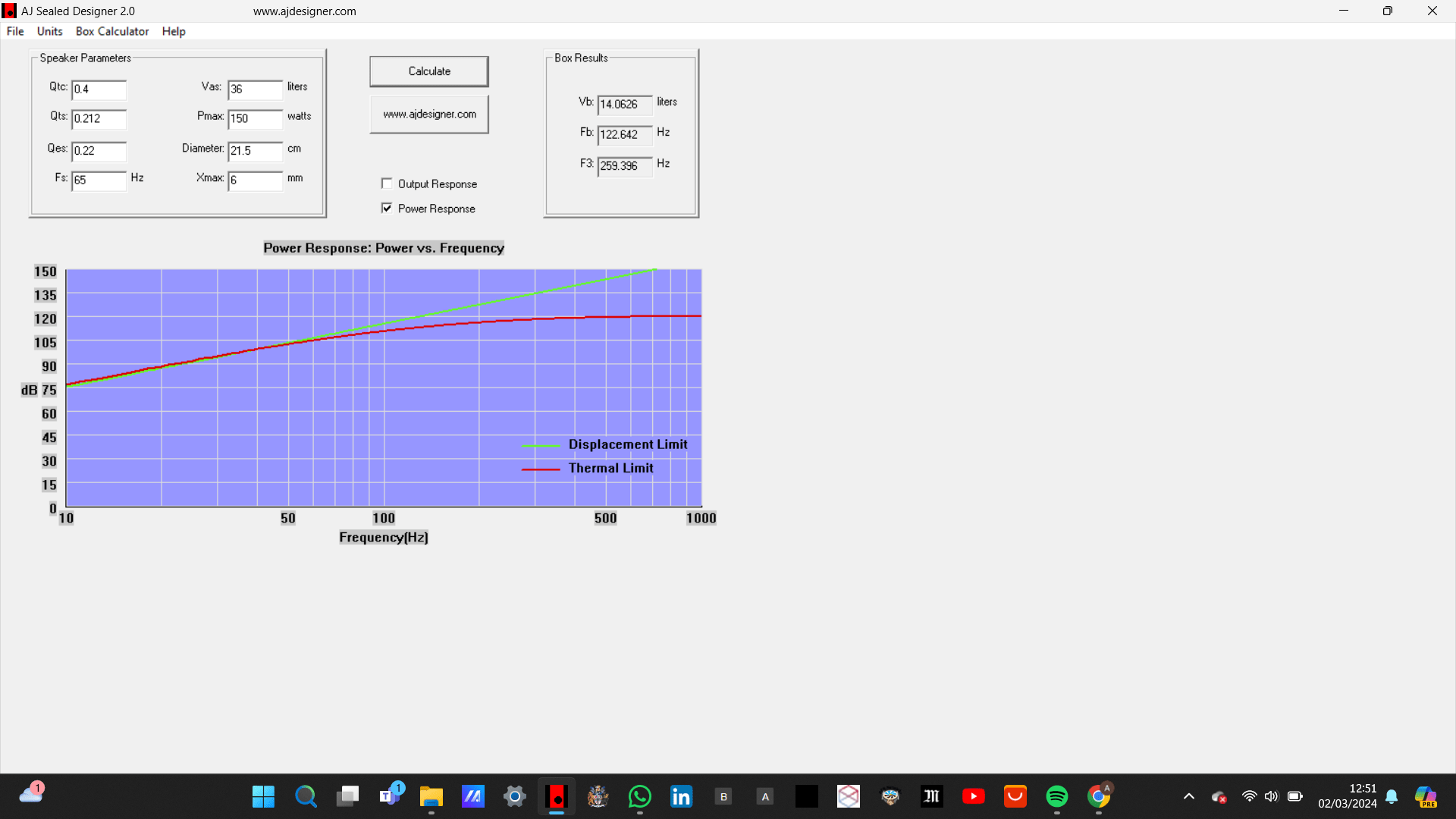

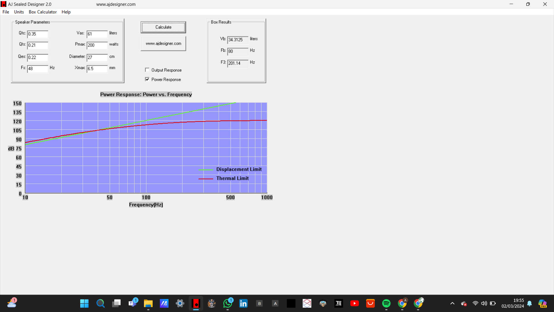

Using Jim's suggestion for driver diameter a single driver still holds 100 dB SPL at 1 meter, but the cone travel increases to 6 mm at 40 Hz... Thats too close to X Max for me and the cone will be "bouncing around" .... Too many "ghost echoes"!
The good news is that is still well (1.5mm to spare) within X Max and only uses 150 watts of power ie less than 22% of its AES rated power.
So a pair will hold 103 Db SPL at 1 meter at 40 Hz with 6 mm cone travel...It will work, but I would suggest moving up a size to the Beyma https://www.beyma.com/speakers/Fich...rs-data-sheet-low-mid-frequency-12P80NdV2.pdf (or the Fe version if money is tight) which will reduce cone travel back down to around 30% of Xmax... I will do a sim using Jims formula for driver size.

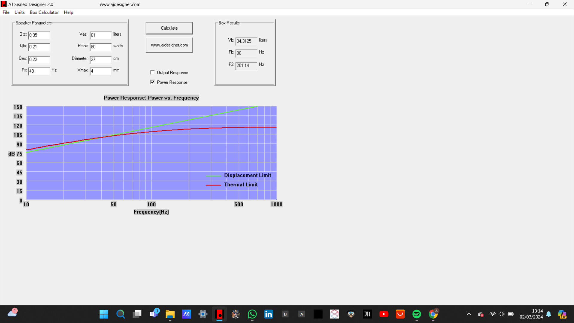

A single driver maintains a continuous 100 dB at 40 Hz with just 80 watts (700 watts AES rated) and X max drops to 4 mm (+/_ 7.5 mm X max and +/- 26 mm before damage...!) so well within all limits.
A pair will hold 103 dB at 40 Hz.
Single driver holding 100dB

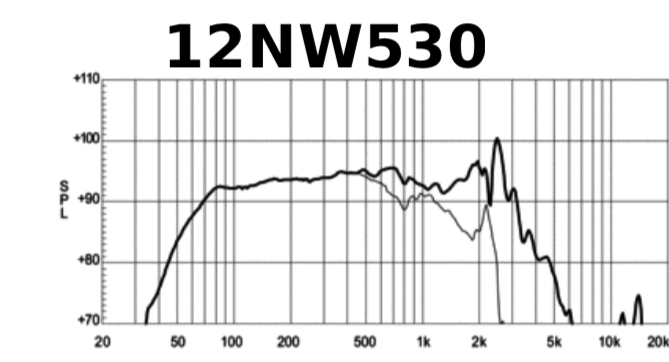

I just remembered I picked up some nice Eighteen Sound 12" neodymium drivers on a lark a couple years ago. They were cheap & I considered them for use in an Aino Gradient re @Juhazi but didn't go very far with them. https://www.eighteensound.it/en/products/lf-driver/12-0/8/12NW530
Tried WinISD simulation in a 30l sealed box: Down -14 dB@ 40Hz.
500W AES & 96 dB/W. So this driver could work very similar to the 12" Beymas @Hydrogen Alex suggests.
I have them on hand, and it's easy to cut another baffle for my test box. Have to try it. Maybe tomorrow.

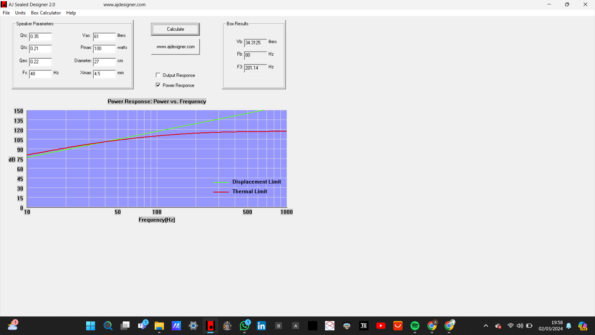

I have added a sim below using 100 watts which at 4.5mm cone travel is well below its Xmax limit of 7.5mm
Yes looking at -14 dB or - 15dB at 40Hz ref Zero dB or max level is alarming, but please remember the following... Its counter-intuitive but works beautifully!
A single driver holds 102 dB so a pair of speakers will hold 105dB at 1 meter (assuming zero room gain) at 40Hz ... Job done, no boost required, these drivers in 35 litres (remember thats a 40 litre cabinet allowing for the volume occupied by the driver and some bracing/damping etc) will hold 105dB at 40Hz with zero DSP boost applied...!

I have assumed the worst and run new some new sims (see above) and I hope that if mikeiss is willing to build up some test cabinets he can have a listen to the different driver loading concepts and give us all some opinions... I would really love to hear if someone else hears what I hear!
Nothing wrong with EQing the driver to the desired response, assuming the amp has enough voltage swing to push the driver to the excursion needed for the output.That means +15 dB boost at that frequency to meet the required bandwidth. Max power on tap from the Hypex FA253 is 250W. At full power, the max SPL (based on driver's rated 99 dB/w) at 40Hz would be 108 dB/1m. Assuming no driver power compression. Maybe 105 dB if the bass boost has to be higher.
I could try hunting for less pricey drivers with similar specs on loudspeakerdatabase.com -- if this approach really works. Any feedback on Alex's posts above?

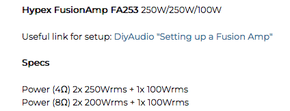

The Hypex FA253 can do 200watts (~40volts) at 8 ohms, and current limits to 250watts at four ohms, only 31.6 volts.
The 18 Sound 12NW530 sensitivity at 40Hz is around 76dB, at 200 watts (~40volts) may hit around 99dB.
